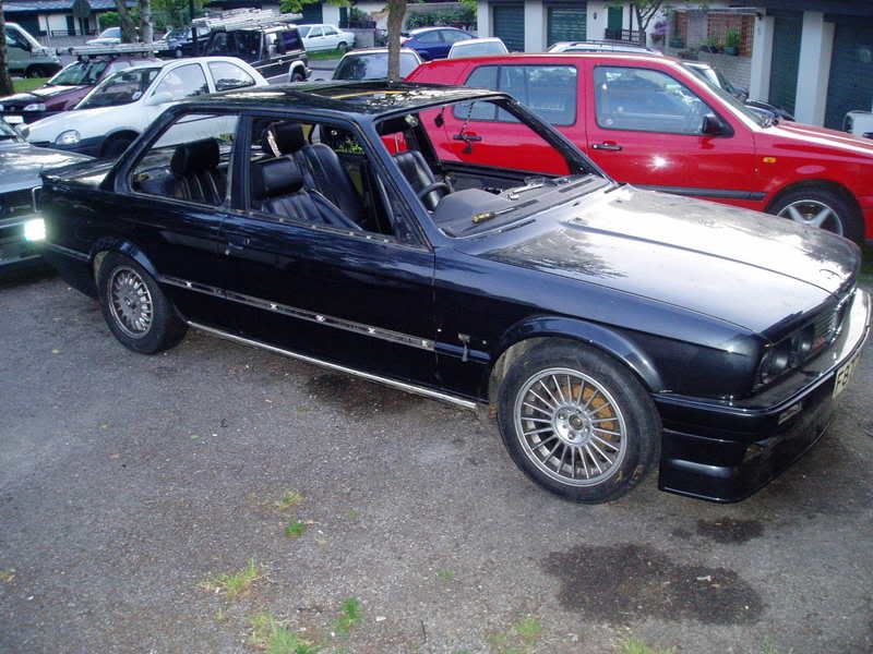

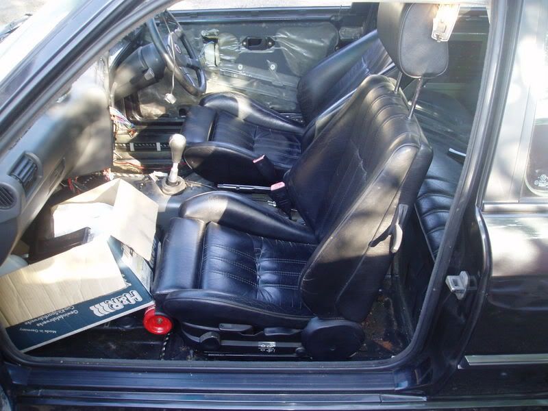

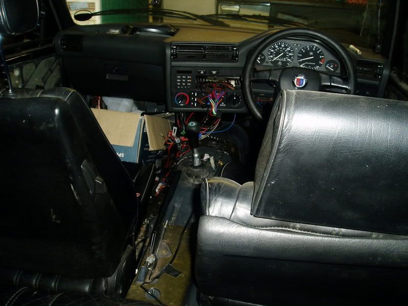

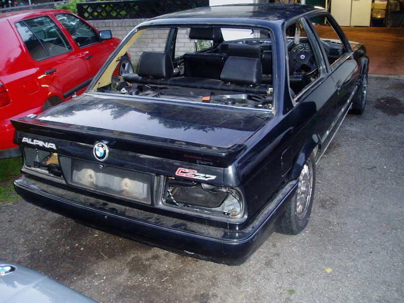

I finally bowed to peer pressure last weekend with everyone asking me/telling me to get on my other E30 instead of tinkering with £300 325's that i use as daily scrap!
TBH i've been a but scared of actually starting this for some reason, i don't know! But i have plucked up the courage and started doing something instead of talking sh!te about it at meets everytime i get asked how it is

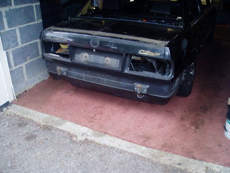

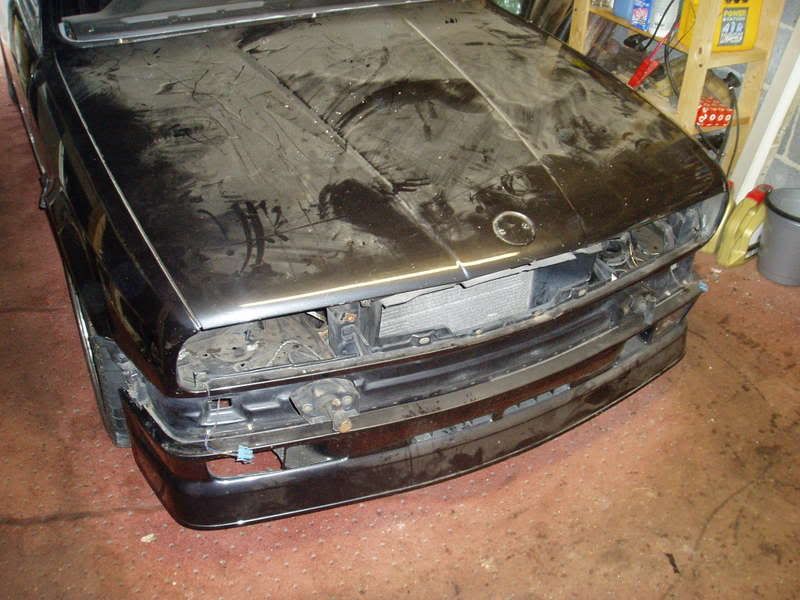

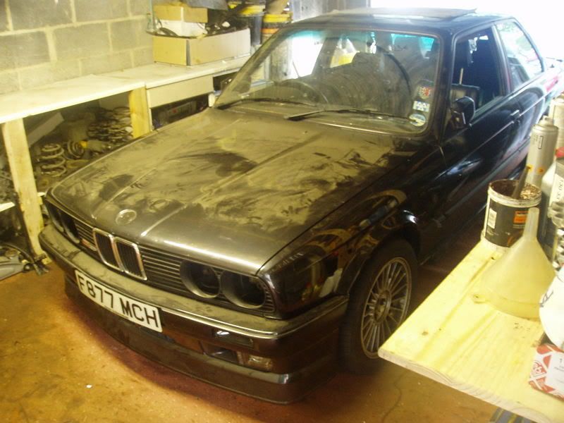

Anyway nothing special but it's a start just some snaps of how it was at the start of the week, which is how it's been for the past 6 months or so being a garage ornament!
and a few more of me stripping her down, just been doing a couple of hours each night this week, which is how i'll probably carry on!

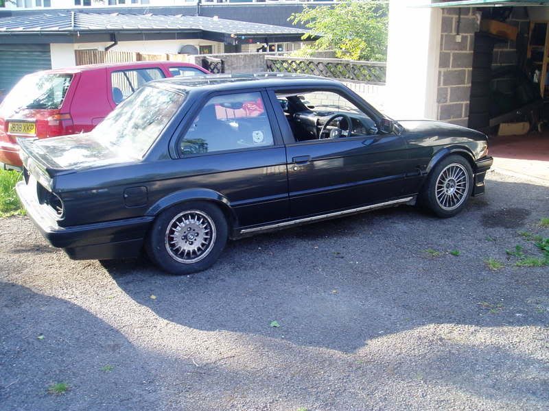

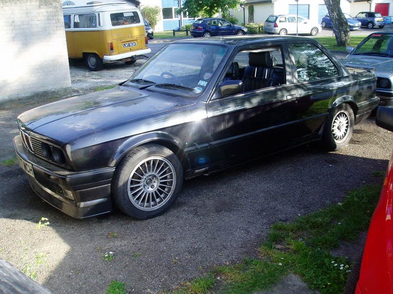

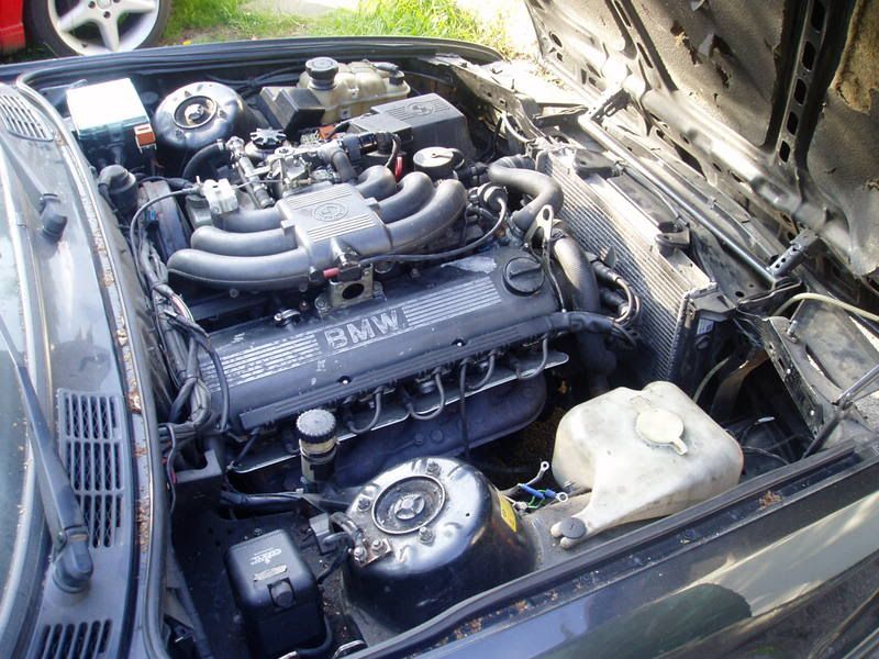

Here's a couple of it when it was on the road last year first!

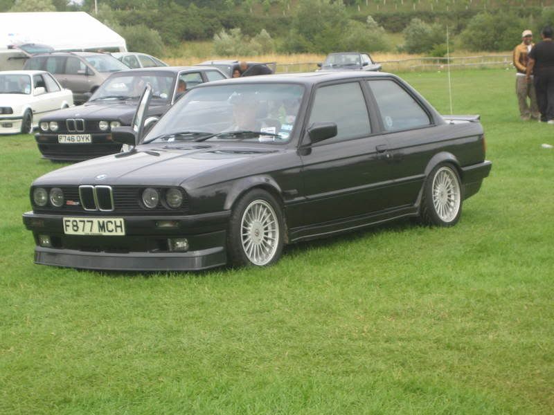

Gaydon last year
On the way from Gaydon showing the 2.5's how it was done :D I only drove 1 more time after this before i took it off the road :(
Here's a link to me old thread if you're interested after i bought it and was driving it and tinkering with it
Now this is how it is! These are a good few snaps i've taken so far

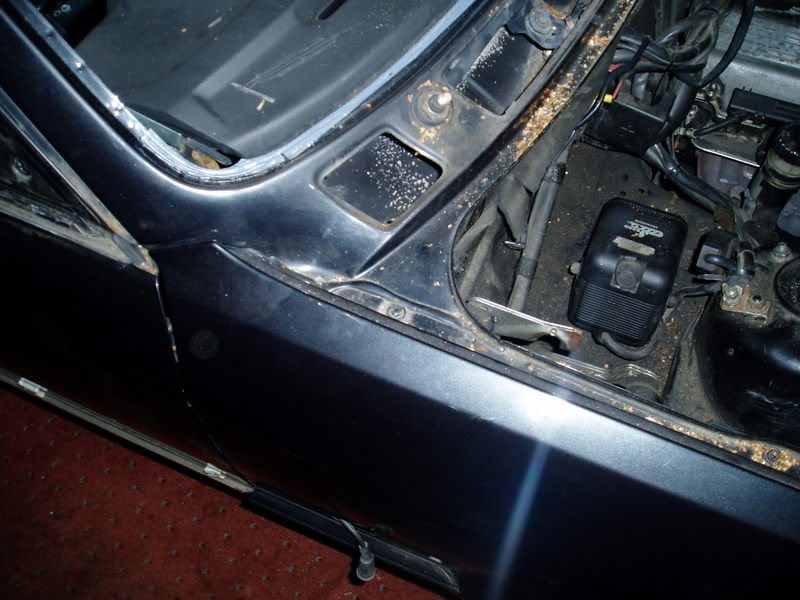

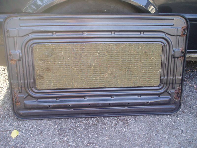

Nice sunroof panel........

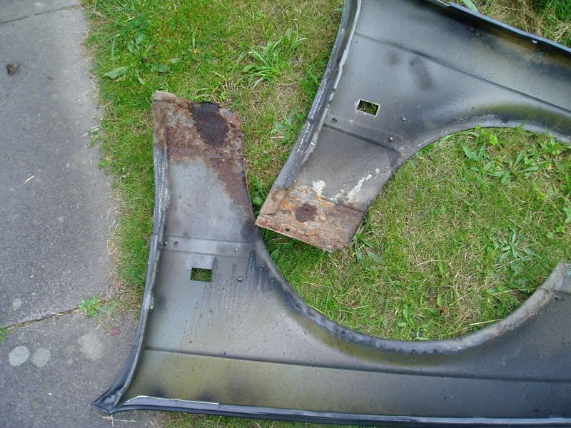

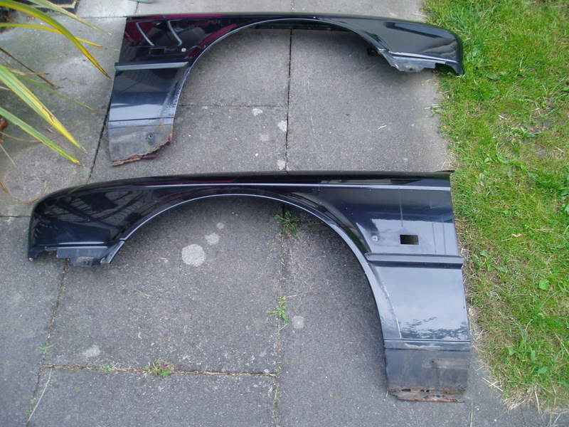

Nice wings
not so nice wings
BUT sport owners/Kos :wink: behold a scuttle!
otherside is the same before you ask!

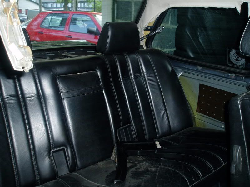

Glass and trim off, the gutter trims etc are so much fun :?
More to come when i get the time and things are happening.
I actually feel relieved a little now i'm doing something with it. My minds at a little ease as my touring is doing me proud these days and it's taxed,Mot for a year and running sweet.

I'm just getting on with it instead of worrying about stuff, like i do.
Bodywork is first and foremost, i never did this on my old sport and in the end it bit me on the ass with a £1000 welding bill to get it through an Mot.
It's not bad anywhere tbh but it's got a jacking point on one side......pitcures later! Good points are solid inner/outer rear arches, sills and scutle. Needs 2 wings,sunroof,bootlid and rear panel plus some welding on said jacking point. No doubt there will be more but my next door neighbour is a welding hero as he works for an oldskool VW garage restoring beetles and big money split screen campers etc. So the next few weeks months will be ridding the shell of rust. Then on to the paint shop! Where ever that will be!
Mechanicals i'm not worries about as they can be sorted anytime. Engine makes noises no M20 should.
Everyone thought it was knocking when i bought it, i put 3000miles on it and it never threw a rod out the side of the block so who knows until i pull it out and strip it down. It had had a rebuild about 400 miles before i bought it but the reciept for £1300 isn't inspiring. I could go on for hours but it wasn't a proper rebuild! compression is down on no.5 when i tested it. The oil pressure is low too so they never replaced the pump.
Spec wise i'm not sure but i will add a couple of extras to it no doubt.
At the end of the day it's a 10 owner genuine sytners C2 2.7 thats covered 119,000miles most of which i expect have been driven very hard! but it's got reems of history and all Mot's service book bla bla bla and all the important alpina bit are still with it.
Costs? hmmmm well i expect bodywork with the respray is going to be £3000
Engine and mechanicals? how long is a piece of string really. I could spend £6000 on the engine if i wanted but we shall see on that. :D I'm just after a nice 2.7, something like the GUG would be a good aim and ive got the exhaust to replicate the noise too!

Thu Jun 14, 2007 11:59 pm
Well i chopped in my aircon setup against this rear axle and gave him so cash as i got some calipers,braided lines and black diamond disks off him the last bits went on the touring for the ring.
Axle is all done thank the lord, new bearings,powder coated, dust sheilds, bushes brake lines it's like new. Doing the other bits to this spec shouldn't be too bad like engine subframe and front struts, plus new nuts and bushes.
I'm good at suspension so i'm not worried on that part or in terms of the setup i will use as i'm going to use a similar setup to my touring as it will be good for the road low enough and ok round the ring as when it's done she will do 1 trip i expect. It's got to be done!

Cheers guys will help spur me on!
Munky they were rare beasts to start off with and plenty have bit the bullet. I've got the remains of 1 cars engine and dash plaque in my garage
The engine is different to the "conversion" a little briefly, 2.5 head is used which is modded, cam/valves flowed. Bespoke ECU. The best M20 exhaust in the business still apart from the 6 branch. Custom mahle pistons with 2.5 rods and a 324td forged steel crank, as eta ones were found to break on the odd occasion at high rpm.
Suspension? offset front top mounts, roll bars,shocks,springs few other different bushes too. LSD
interior? apina cloth or leather if you wished to go with the dash plaque, gear nob,steering wheel and the intruments have alpina written into them.
You could of course have normal bmw trim, but they only came with sports seats.
Outside? Decal kit was a no cost option, you didn't have to have their bodykit or wheels either, mine has both. Some came with M-tech kits instead. you could have no badges or C2 badges
So as you could totally spec the car up how you like no 2 seem to be the same, my car was just a 325i not even an SE, you base it on a sport too,cab,4door,touring. Mine has windy windows with a 13 button OBC :? must of stretched for the alpina bit and not worried about alot of factory options. But i shall be adding a good few to spec it up
