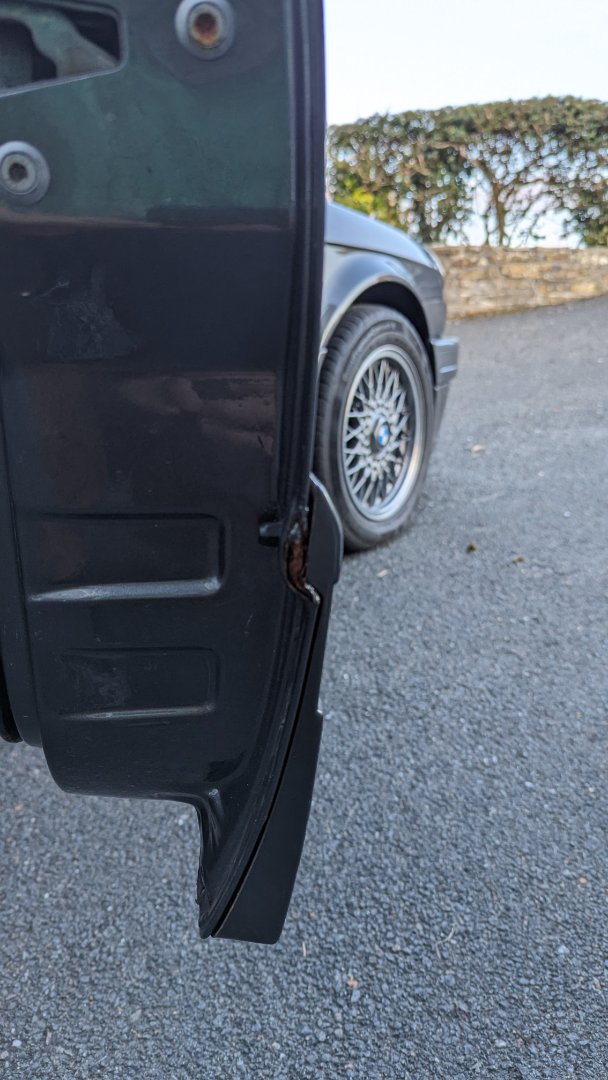

Owner has sent the attached pics of the underside.
What are peoples thoughts on the rust / condition please?

Rust you see is always the tip of the iceberg, but from what is in the photographs there is nothing that would worry me and it looks like it has not been in a high corrosion area. The fuel pipes look original and in good nick and they are the type of thing that can show rust.
That said, the bit on the door could be an issue and the Mtech pods are renowned for hiding rust. I would need photos of the usual places though like boot side pockets and inner arches, front corner "jacking points" (that are not jacking points) front lower scuttle etc etc
All the suspension bits are consumables and easily replaced and to be expected on a 30-40 year old car no matter how well kept.
All depends on price though, I would still need to go over it with a magnet and give a few places a gentle poke with a screwdriver. :D
