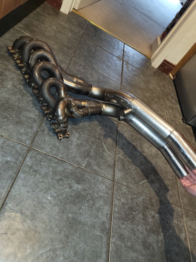

Hi all! Ive just finished making up my rhd s50 b32 headers to fit full e30 supersprint s50 system. Just wanted to show you as im very proud! The welding is not done by me but everything else. (Design, measurements, cuts and tacks). Ive just handed them over to be welded up on the downpipes. Had to drop the subframe to get them out.
- Posts: 6207
- Location: leeds
Awesome mate, Fantastic to see proper Engineering from start to finish
Nice to see you left the welding (dark art !! )
Not many good engineers left now , looks like you have joined my club.
- Posts: 28649
- Location: Staffs
Great job Ross, nice to see the X pipe further back too

Thanks very much guys! I have to say it was very hard work which im sure you know. I was wondering about x pipe position. Most say it needs to be by the gearbox, is it a good placement further back? Im sure supersprint must know what they're doing.... my primarys are ofcourse shorter than theirs, so theres a little more distance between the collectors and x pipe than their design.

Excellent work, Was the science behind the R&D or just bending pies to fit with equal length?
Jealous of the pipe bending , impressive work there alone

The bends in the primaries are from the S50 but the number 6 needs to be changed to fit. They are virtually impossible to replicate and even BTB cannot do it. They do something similar to this whn making manifolds for the S50 conversions. They did one for a M52 conversion on here, but at a pricefixedwheelnut wrote: ↑Thu May 11, 2023 10:13 pmExcellent work, Was the science behind the R&D or just bending pies to fit with equal length?
Jealous of the pipe bending , impressive work there alone![]()
Good work though

'Manifold' is one lump like the cast iron m20 sort. 'Headers' are individual tubular pipes like this.
There was no pipe bending involved here, just cutting the headers up and using parts of the old headers with purchased mandrel bent sections cut down to all fit togrther.

Also these are not equal length. I think if i had another go, i could get them closer to equal. Therefore i have a bit of a subaru rumble to the engine at lower revs.
Here is the finished pipes before i fitted them!

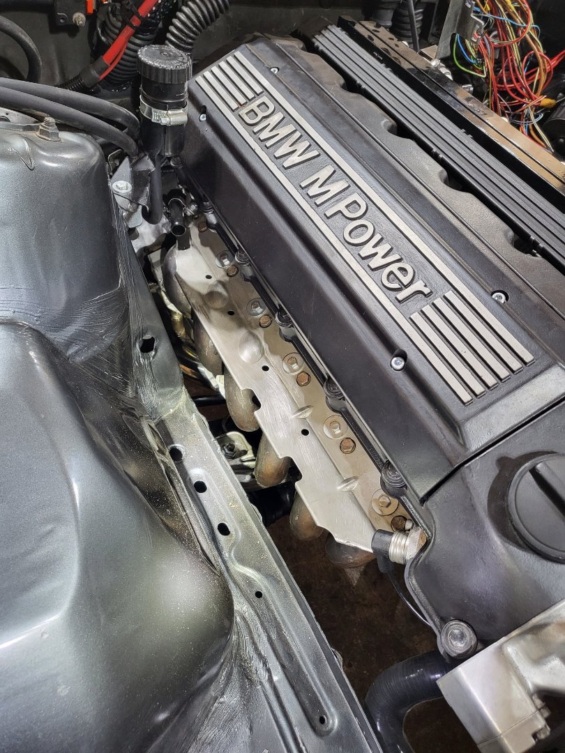

As you can see they are a tight fit

No, what you have is a tubular exhaust manifold, very nice too.RossDavies wrote: ↑Sat May 13, 2023 7:22 am'Manifold' is one lump like the cast iron m20 sort. 'Headers' are individual tubular pipes like this.
If you do it again it helps if you can get pipe bent as if you see the BTB version it is a work of art (but costs appropriately) They cannot easily replicate the 180+ bends in the manifold primaries so they still need an S50 manifold to work with but they bend the rest. Their manifold is flowed correctly for the S50B32 when done.
They will be getting my S50 manifold when I can stump up the cash but I think for what it has cost you have an excellent result
Are you getting the Supersprint centre section with or without the silencers? I have looked at the Supersprint before but decided against it on the M20 because it was too loud, went with BTB and Eisenmann in the end. Not sure what I will do with this one now Fritz has stopped making them.

Theres no way in a million years i was going to pay BTB what they are asking for the headers. Plus their exhaust system looks *#@% in my opinion. My custom headers and supersprint system (has center resonators too) is not at all overly loud, and the car will keep up with an f80 m3 so the system works great with the car.

Out of interest what exactly didn't you like about the BTB exhaust? Were you looking at the single or dual pipe system? I have to admit I don't like the Y-pipe single system but there is no question about how well it works. Sometimes things that work well don't look pretty but most things I have had from BTB do both. Had no problem with Supersprint stuff either.RossDavies wrote: ↑Sat May 13, 2023 1:49 pmTheres no way in a million years i was going to pay BTB what they are asking for the headers. Plus their exhaust system looks *#@% in my opinion. My custom headers and supersprint system (has center resonators too) is not at all overly loud, and the car will keep up with an f80 m3 so the system works great with the car.
I agree BTB are not cheap but I tend to find you get what you pay for. If you think E30 stuff is expensive try getting an exhaust made for a 911
If you are taking on F80 M3 regularly what have you done to the diff mount and boot floor? That engine was fine in my E36 evo for the 11 years I drove it but that was a properly mounted 210. My other half's Z3M tore the single hanger diff off the car along with the boot floor before the car turned 3. Mate's S50B30 swapped E30 did something similar. Something to keep an eye on.
You might want to tell Supersprint they got it wrong tooRossDavies wrote: ↑Sat May 13, 2023 1:49 pm'Manifold' is one lump like the cast iron m20 sort. 'Headers' are individual tubular pipes like this.
