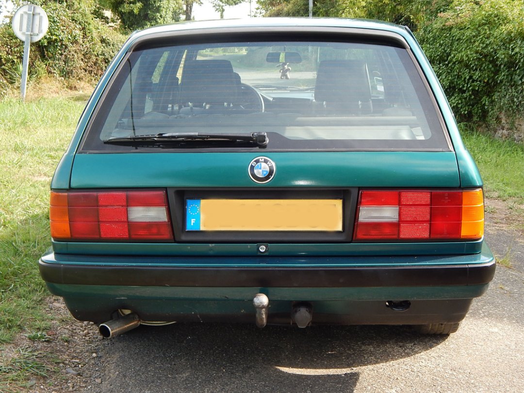

Having been told by my 'MOT' man here in southern France, down near Toulouse that my car had too much rust and too many holes for the new regulations I would have to get it repaired for the next time , that would be in two year's time... The list of work covered the usual things for an E30, driver and passenger footwell corners, holes in the sill around the jacking points, tow hitch ,minor holes in the chassis around the rear suspension mounting points, tailgate and more than a few holes in the floor where the heat shield studs had rotted through. I guess I have been a bit lucky in that the roads down here are not gritted in the winter, most of the snow is up in the mountains, so people either carry snow chains or change to winter tyres. The first job was fix the rear tailgate, fortunately I managed to find a 325 Touring in a BMW specialist garage in Toulouse, that was by sheer luck as the Touring is very rare down here, I have only seen one other in 18 years, apart from the scrapper, and that was a tourist.

Then round to the back to sort out the tow hitch, though it only showed a bit of a rusty 'bleb' on the outside, inside as you might expect, was a very different matter, but after some careful surgery and a bit panel bashing I made up a new section around the tow 'eye', welded it in and gave it a lick of paint.
