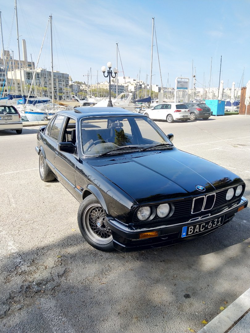

Hi everyone, about a year ago I started restoring my '85 323i. This is my first restoration and quite an experience too. In this topic I would like to document the resto while sharing it with you guys. If anyone has any tips feel free to share. Plan is to take it back to it's original Polaris Silver color and adding the Mtech 1 kit. I hope you like it :)
Just before the project commenced.
It was exported from the UK by it's previous owner who was a Maltese national living and working in the UK at the time. When it was time to come back to Malta he brought the car with him. It was pretty difficult for him to sell me the car after almost 30 years of ownership.

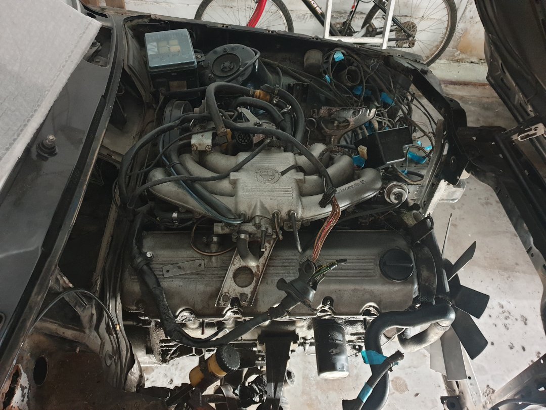

Trim and interior were the first things to come off the car.
Engine ready to be removed too.
Engine removed, the rest of the drivetrain soon followed, sady don't have any decent pics.

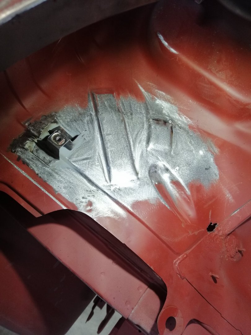

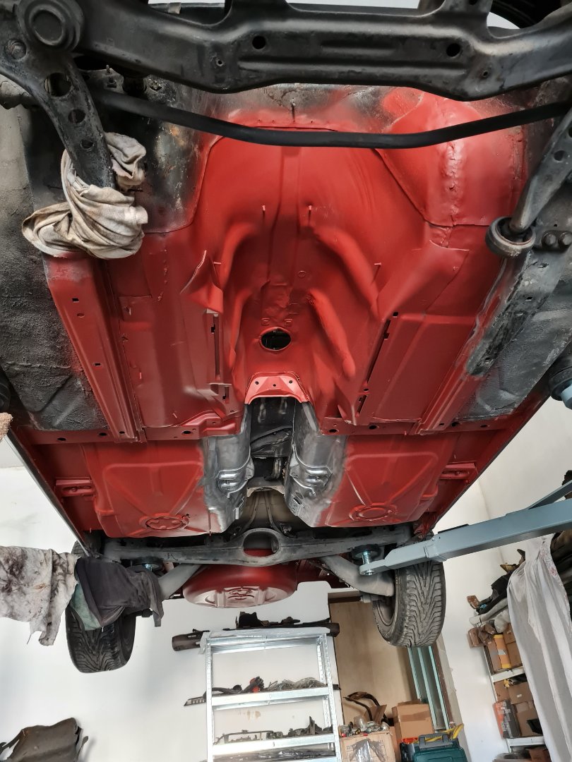

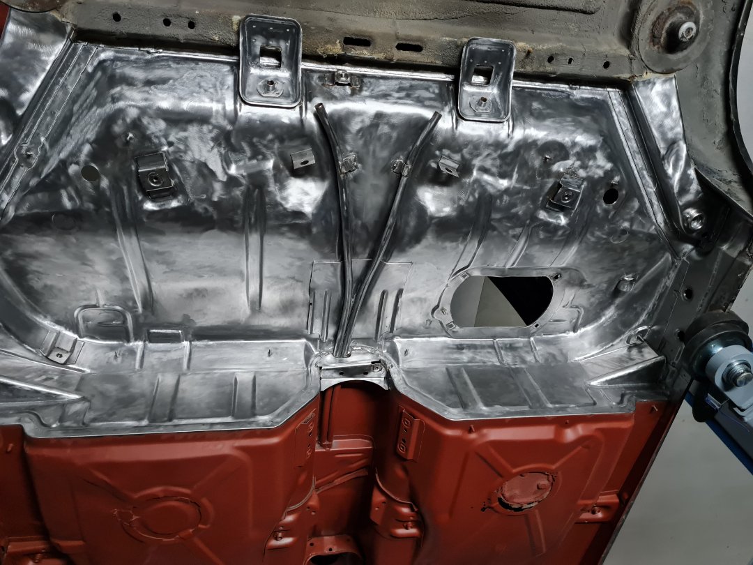

With the car stripped down to a bare shell, I started stripping the underseal off the underside of the car.
Stripping the car revealed a very solid underbody with very minimal rust considering the car was used daily for almost 30 years. After 3 destroyed drills, lots of hours and patience I'm almost ready with just one wheel arch left. I hope to get the car into bodywork soon so I can get some more updates for the thread.

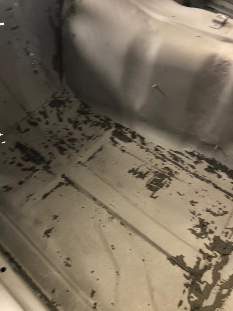

Hi all sorry for the lack of updates. There's not been much work done to it lately. The doors, bonnet and boot lid have been removed. I have removed the interior sound deadening. Apparently 323i's had it also in the boot and it weights a total of 15KG. Don't know any info why only 323i's had it.

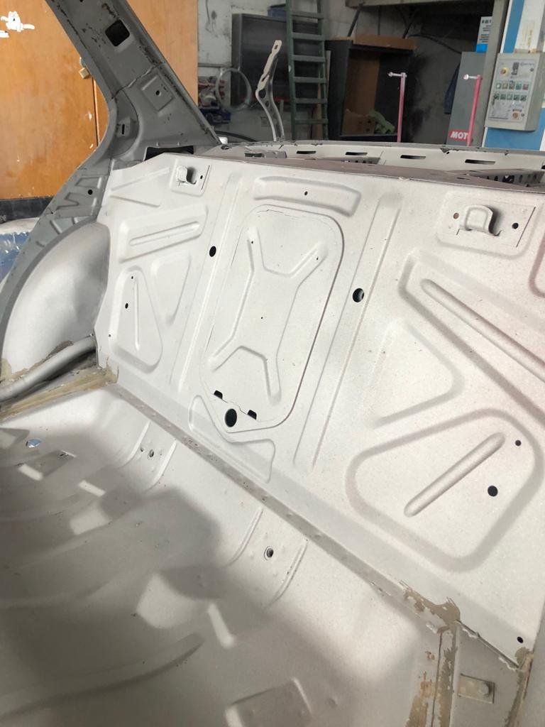

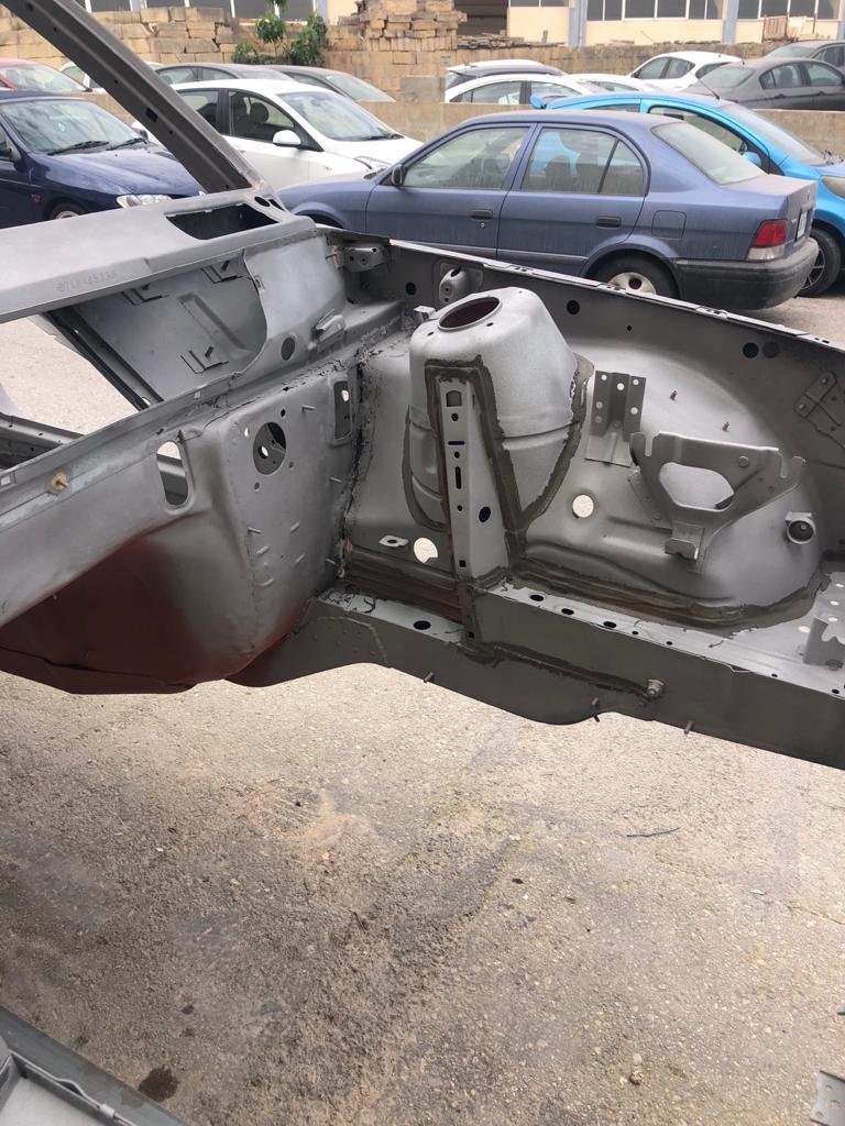

As promised in the last post I've got another update. Car has gone to the soda blaster's today. They will be blasting the interior and engine bay. The exterior parts will be sanded to bare metal by the painters so as to minimise damage to the surface. Should be ready by tomorrow and next week the welder should get a start on it.

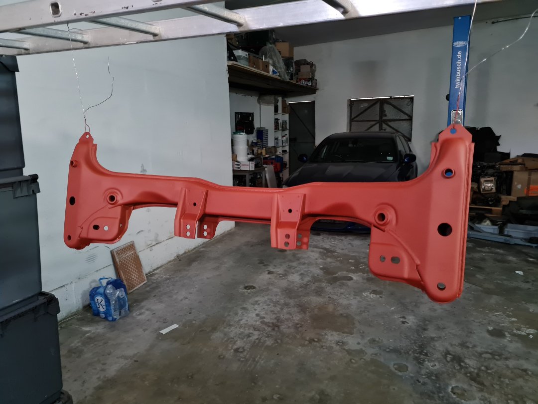

In the meantime I plan to keep you guys updated with the suspension refresh. I'm currently assembling my zinc plating kit so I can get a start on the front subframe.

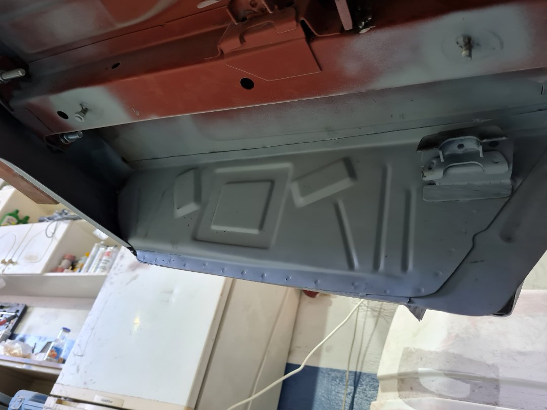

Lat week car was ready from the blasters and back to the paint shop. I had these pictures sent by them.

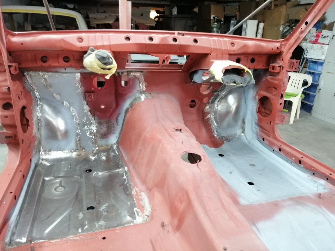

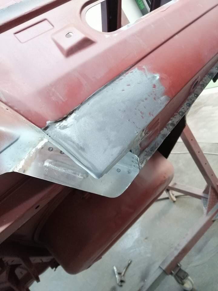

Car should now get all the rust sorted with many new body panels to get it in as best condition as we can. All panels have been delivered to the panel beater but he will have to fabricate the firewall pieces himself since I could not get hold of E30 Garage Norway to buy them too. I've used Valcas garage for the floors, square pads under front floor. I've got the Klokkerholm front wings, I think they should fit well with some minor adjustment. Rear panel may need to be replaced too since I had a strange issue where the right tail light had 2 screw mounts at the edge broken to make it fit and still poked out about a mm. I hope to get another update soon the panel beater should be working full blast on it so it should be a matter of weeks.

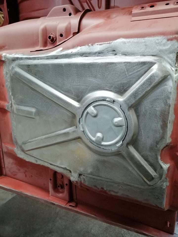

But we have another update. Car has been ready from metal work for some time now. It has had loads of work done to it to get it to a stage where I'm happy with it. Pictures for your viewing pleasure. For those who want to see al the photos they can be found in this Facebook Album: https://www.facebook.com/media/set/?set ... 768&type=3
The Klokkerholm wings I had did not fit well and would need a lot of work to make them right. We have now bought a pair or RHIBO Maxicar wings from Italy. Car had one of them on and it fit well. We still have to test fit the new ones on.

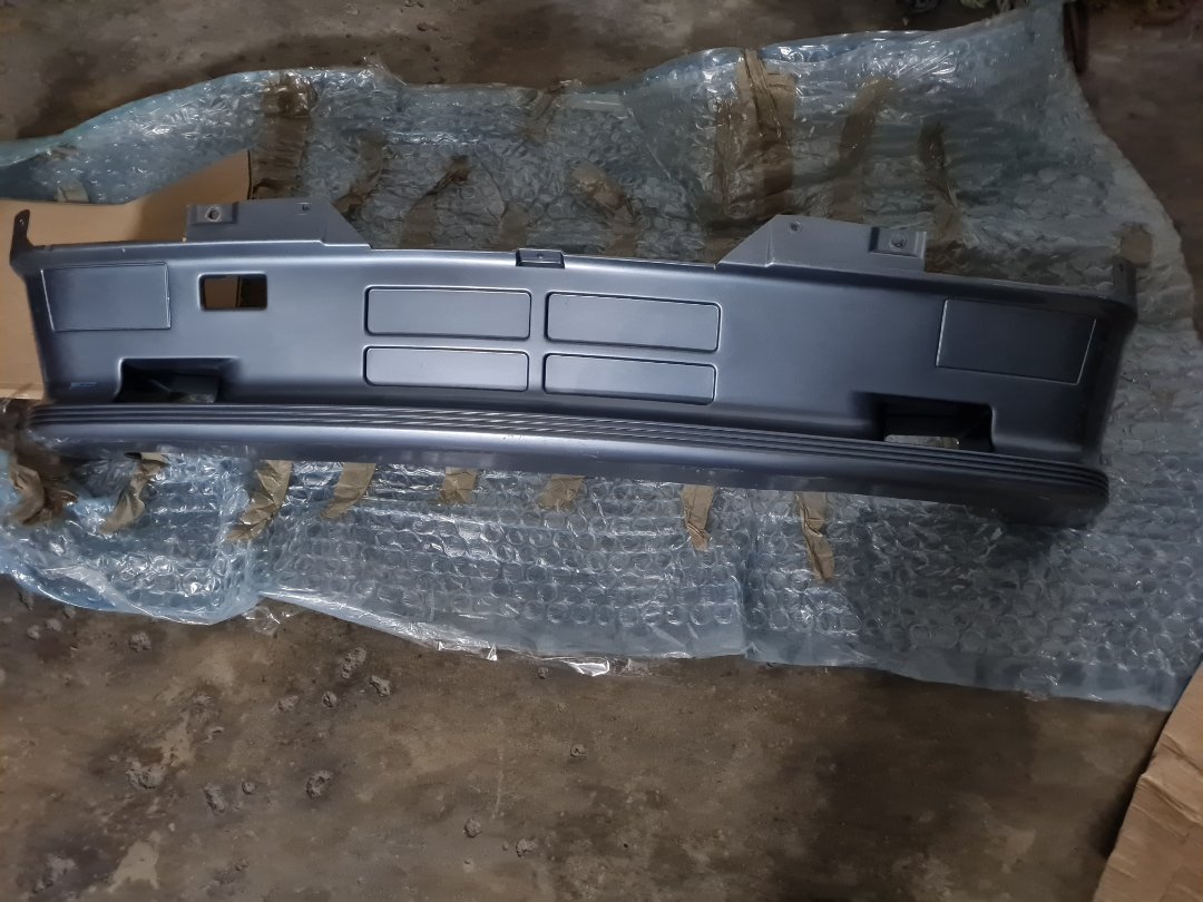

While the car is waiting for paint. I have managed to buy an Mtech 1 kit and OBC which I wanted to retrofit. I bought some new wheels too.

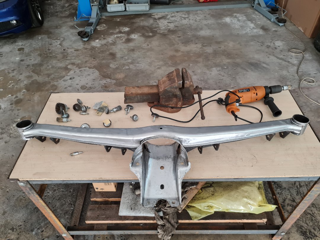

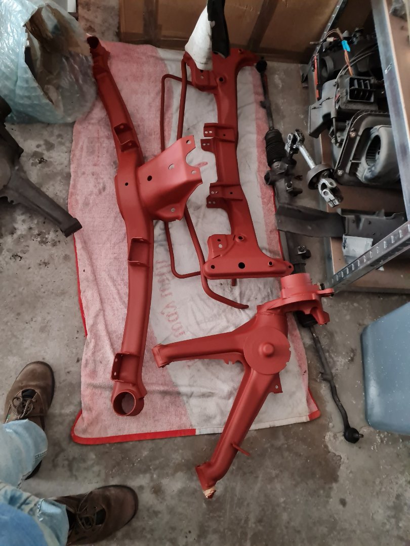

Lately I started working on the suspension I am stripping them down to bare metal with a wire wheel and priming with Forch L239 Rust Stop Primer. I am planning on spraying them in sating black 2k myself. What are everyone's toughts on this?

Certainly nice to see another 323i getting some love. Few enough of them now. Going well :thumb:
One thing to check is the 323i had the early pre-facelift front valance. That pre-dated the Mtech1 spoiler which came in on the later pre-facelift around '85. Although you have a very late 323i from the first photographs it still has the early front.
Alpina spoilers before and after '85 are different fitment . I would check the fitment while you still have time to alter things if needed. I am not 100% sure about the tech1 fitment to an early car but worth checking.

Satin black for the suspension arms and cross members is correct.
