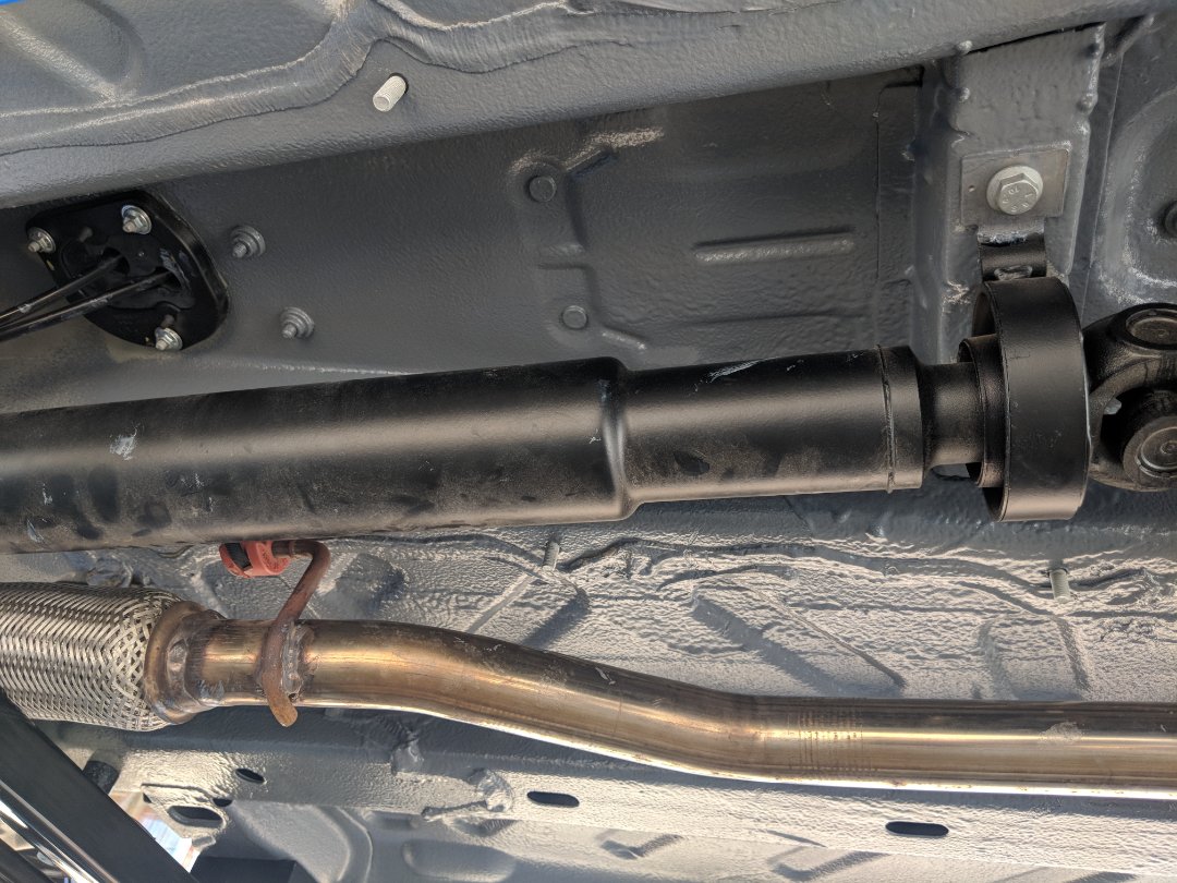

- Getting rust proofed. Barry @ BMR recommended a place that uses wax and cavity injection as opposed to outright rubbury coating that some places do. Hopefully will get this done at Barry's recommended bodyshop
- New exhaust. Nothing wrong with the current exhaust, but it's a bit too loud for my taste. Barry recommends genuine OE, but that's ££££... need to think about it. Regardless, I need to fit a new heat insulation tunnel (aka exhaust heat shield), the carrier bracket and the plate that attaches to it
- Do up the leather interior and
- Misc body work, e.g. external trim repaint, bumper refresh
Brianmoooore
- Posts: 49359
By rubbery coating, I assume you mean what is commonly known as 'schutz', and I'll echo Barry's recommendation and more.
Never, under any circumstances, apply this stuff to any vehicle you want to last indefinitely. It's purpose is to stave off the crusher for a few years, as well as to hide corrosion from the prying eyes of the MOT tester.
It's fine for a few years, but then it starts to lift, allowing moisture to get between it and the metal. The moisture has nowhere to go, so just sits there, eating away at the metal, and quickly rendering the car past saving.
If you want to add to the factory underseal, where that has lifted, usually for no more than a short distance from an edge, then use the proper two pack polyurethane stuff from 3M, or for small patches, you can use polyurethane sealant from a tube, shaping it with a tool and white spirit.
twenty
- Posts: 598
- Joined: Wed Jun 24, 2020 11:43 pm
- Location: London
Excellent, thank you!
Brianmoooore wrote: ↑Sun Aug 30, 2020 7:40 pmBy rubbery coating, I assume you mean what is commonly known as 'schutz', and I'll echo Barry's recommendation and more.
TurtleDesignTech
- Posts: 250
- Joined: Tue Sep 15, 2015 11:00 pm
- Location: Hampshire
Highly recommend the 3m 2 pack poyurethane (and 3m sealant in a tube).
I sprayed my parents Panda Cross 4x4 with this a few years ago - they drive it around Europe and take it up the mountains in winter.
New cars these days have sod all for underseal, so I did it this first month they brought the car and put bin bags around all the supension and driveline components to mask it off.
On an 30 year old car though you really need to remove most of the drivetrain and give the underside a serious clean down and fix any properly fix any rust you find.
Personally I would also want to paint it afterwards in the original BMW beige (see Barry's M3 restoration thread).
twenty
- Posts: 598
- Location: London
Thanks. Looks great. The underside clean is the part that I need to get going with. This week I'm getting someone local to just look at the wheel arches and remove any rust and repaint as needed. After that I need to take it to Barry @ BMR Performance where his bodyshop will hopefully be able to do the cleaning and underside spraying.TurtleDesignTech wrote: ↑Tue Sep 22, 2020 7:33 pmHighly recommend the 3m 2 pack poyurethane (and 3m sealant in a tube).

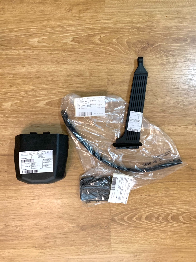

More new parts in preparation for a new exhaust. After a lot of listening to YouTube videos and opinions from various folks I’ve decided to go for the stock exhaust. Will go for a two piece system and currently that comes down to £744 straight from BMW Classics. Not bad really.
I’d have loved to get a Supersprint but looks like it will be even more expensive than stock.
Also ordered a knee panel but instead of the genuine BMW one, which is made of vinyl and can flake as witnessed in mine went for an ABS plastic version that looks and feels like the original but a lot stronger. Downside is it came all the way from Australia and I had to pay crazy shipping and then VAT on top making it almost as expensive as the BMW part haha.

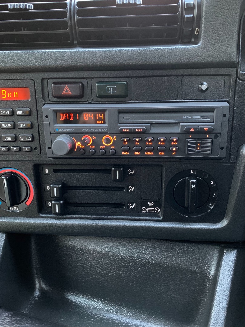

Fitted the Bremen SQR DAB and upgraded speakers and twitters. Way to enter 21st century for sure.
Have also gathered all the underside parts that were missing apart from a new exhaust. Currently on back order and I have no idea when it will be back!

So the last piece of the underside puzzle arrived today. About time!
This means I can fit the underside heat insulation items, rear carrier, engine under tray etc. also at the same time.

Fitted the Scorpion exhaust. Discovered during fitting that the old back box was form a 320. The car is now a completely different beast. Responds better and the straight six sound even better. Only thing I don’t like about the Scorpion exhaust is under lower rev there’s a noticeable drone. So much so, I ended up with a headache the first few times I drove it. Sort of used to it now but just for this, I wouldn’t recommend Scorpion to anyone.
Discovered (accidentally) that water has been depositing in the left corner of the boot right under where the antenna unit is and there’s a massive patch of rust under the carpet! Need to get to a body shop. Still debating a full restoration vs localised fixes.
Ordered tons of new parts, new washer bottle, coolant bottle, various hoses, terminals, connectors, wire covers (from M42 car), seals, knee panel etc. that’s sitting at home gathering dust! Feels like I have no time for anything! Also ordered new car mats matching the beige carpet from Germany. Will update when I get them.
At least managed to do a bit of interior facelift. Starting with refurbishing the stalks, fitting cruise control (not faulty working as luck would have it found the tab on the bowden cable broken) and Momo hub and steering wheel which I think has radically changed the interior.
That’s all for now.

More bits and pieces acquired that I still haven’t had time.

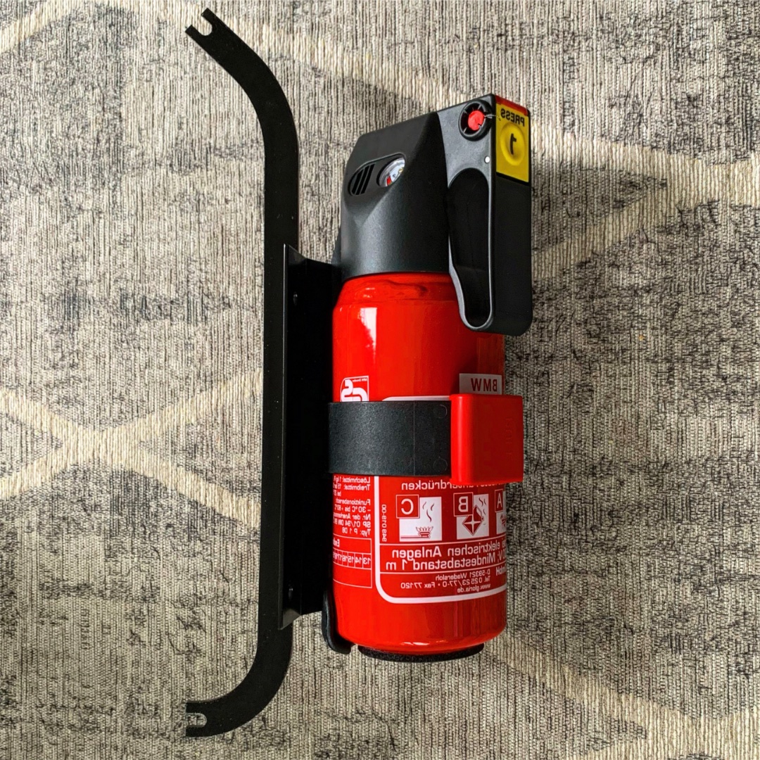

First stop is the fire OE extinguisher, complete with bracket. Although BMW no longer makes the cradle type bracket, luckily, the extinguisher (both from BMW as seen here and Gloria, the ORM) comes with a plastic bracket that nicely lines up with the metal bracket. Keen readers will observe that the metal bracket I have is for a LHD, sadly I couldn't find a RHD version so the orientation of the extinguisher is wrong haha.
This one is a little hack that I came across in R3VLimited. It’s a 318is wiring cover (comes in three parts but the inner holder is NLA, luckily not important) that fits the 325i M20 fine. There’s also a second part, not pictured here that you can get for the cover to extend all the way to the battery for a clean look. Since mine is a cab and I don’t have battery in the boot I didn’t get it.
