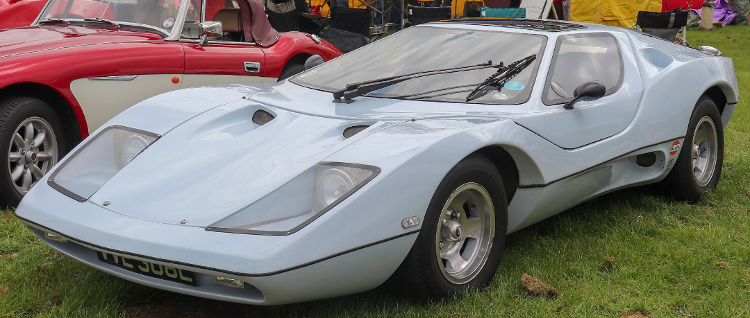

Meanwhile my Eagle SS has to sit outside its home.

Good luck with the repairs. The Eagle SS caught my eye. If I am correct the design is based on a design called the Nova - Uk origin. A company with many troubles and buyouts etc but for the last two years of production 1978 - 1980 was made in my home town of Mirfield here in Yorkshire. Great looking futuristic car!

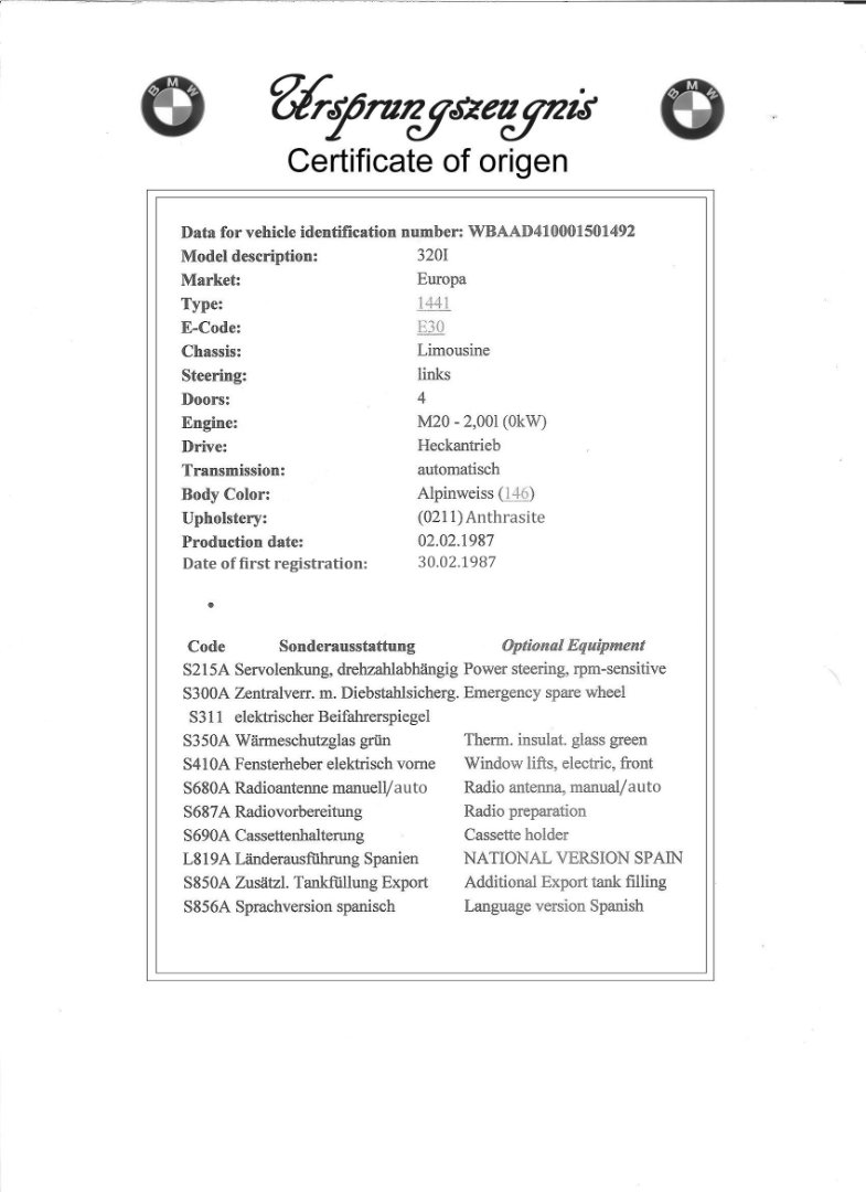

So that's why she has a 'M' badge not a M3 one. She has the whole kit since new according to the one previous owner.

Unfortunately not, that has been the argument with Linea Directa (Direct Line in UK) I tried to get 'classic' car insurance and the best quote I got was over double my current one, over 300€ TPFT+-
I sent them photos of the car pre-prange and various 'for sale' adverts in Spain, none of which were under 3,500€ but they still insisted it was 'just an old car', Even if I had a H plate, which would cost at least 800€, It wouldn't have made any difference.
I am afraid the Spanish know the price of everything and the value of nothing., Anything 'historical' is bulldozed or crush in the name of progress, tourism or development, AKA corruption.
The procedure for getting a H plate is enough to put most people off, even lawyers.
1/ Certification from laboratory of engineering in Malaga certifying it is genuine and original, (what they know anyway), 200€
2/ Special ITV (MoT) 150€
3/ Report by 'engineer', who probably doesn't know an E30 from an E36 that it is original and safe. which duplicates the first two anyway. 160€
4/ Pay all road tax up to date, (Road tax is local not national and varies from municipality to municipality. currently about 85€ a year for a car.
5/ Pay a VAT of 20% on valuation, again varies and it's THEIR value.

As I am in the process of preparing the wing and bonnet I was wondering what paint to buy for spraying,
I was going to use spray cans but then I saw the price and at least 8 cans comes out expensive with shipping and possibly not the best finish so as I have all the spray gear I need a liter of ??? ,
I know it's a base coat without a clear coat and it's 146 Alpinweiss but is the original a water, acrylic or cellulose based?
I am thinking 1Ltr would be enough for a bonnet (hood) inc internal ribs and a wing?
Everyone has the right to reach the level of their own incompetence.

Post Tue May 26, 2020 1:39 pm
Ukhozi wrote:
Tue May 26, 2020 11:45 am
as soon as someone answers by question about paint used on 1987 cars.
To be honest it is a bit academic what paint it actually has because you can get a reaction between what should be the same 'type' of paints 30 years later.
You need a paint that will not react with what is underneath it. If you are getting 1l mixed up then I would ask the paint factors doing the mixing as they will have the knowledge/information as to what their paint systems will go over.
A lot will come down to what you can get and what you can spray with your equipment (HP/LP?)
Obvious caviat not to spray 2K paint without proper equipment as it does not take much isocyanate to spoil your day.
