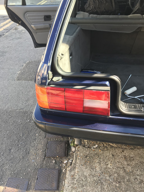

So I got back from holiday this week and decided to do some bits on the car. I'd ordered a replacement rear drivers side lens as the one that came with the car was smashed and cracked which I fitted yesterday, as well as using contact adhesive to temporarily fix my seriously sagging headlining. It's so good to look out of the rear view mirror and not to see a saggy grey mess!! 8)
Finally, I completely replaced the windscreen washer fluid pipe from pump to jets as it had corroded and split.
Some pictures below. I'm terrible with taking pics as I go or using my phone in general so I must make an effort to get better at that!
^ that's the old lens
^ the new (to me) lens fitted

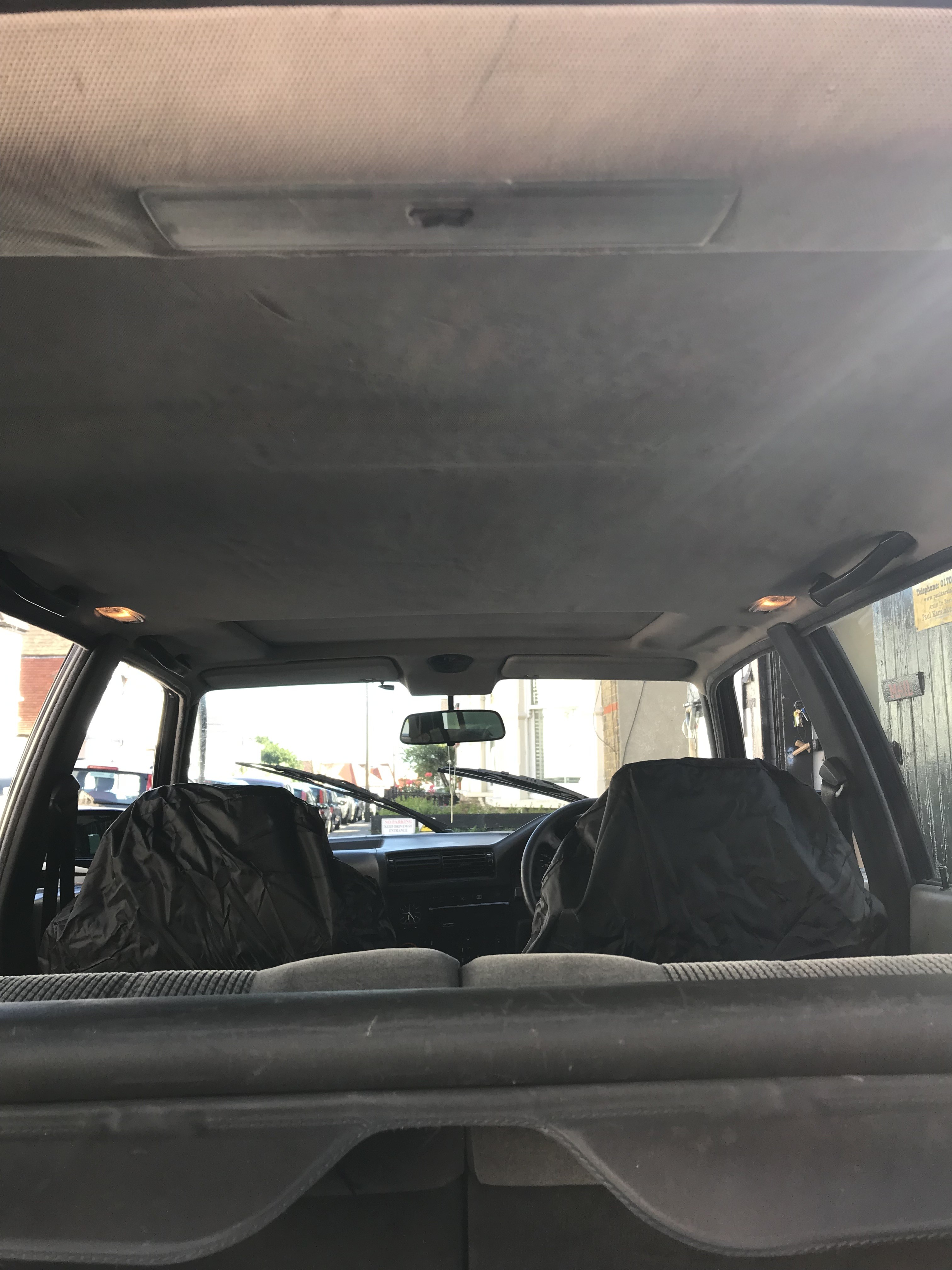

^the sagging headlining fixed. I took the rear boot light out of the headlining and pulled the grey cloth down around it as far as it would go before very generously spraying the adhesive in the hole, covering as much as possible. Unfortunately the foam is pretty dented but it is so much better than the sag!
