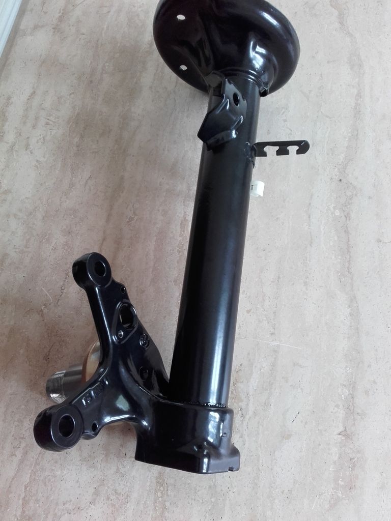

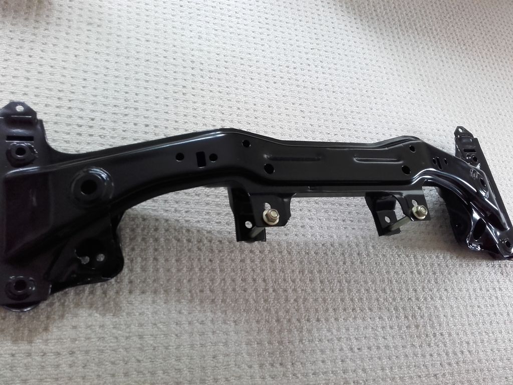

So the first real steps are happening now after a bit of time sourcing stuff I don't have ( still need a mint 55L fuel tank ) and selling off stuff I don't.

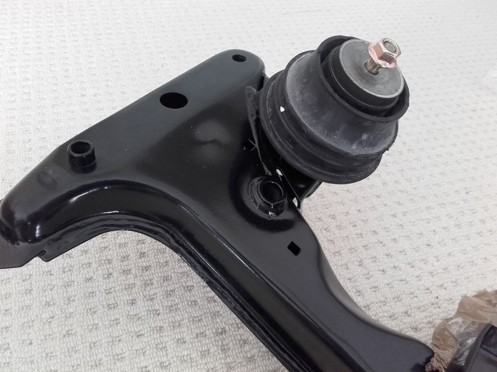

So the plan is to have all the suspension and underside of the car refurbished first and then put away while the shell is done so it can quickly be built up and mobile.

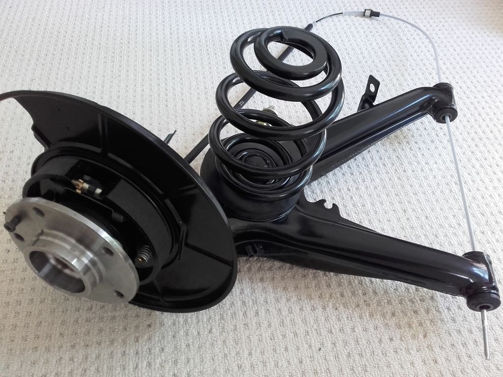

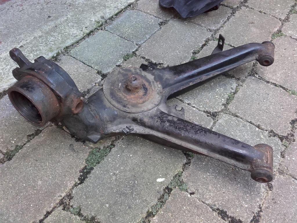

The front and rear suspension is all apart and the front subframe is being weld as that had a small crack around one of the engine mounts and is receiving a reinforcement plate.

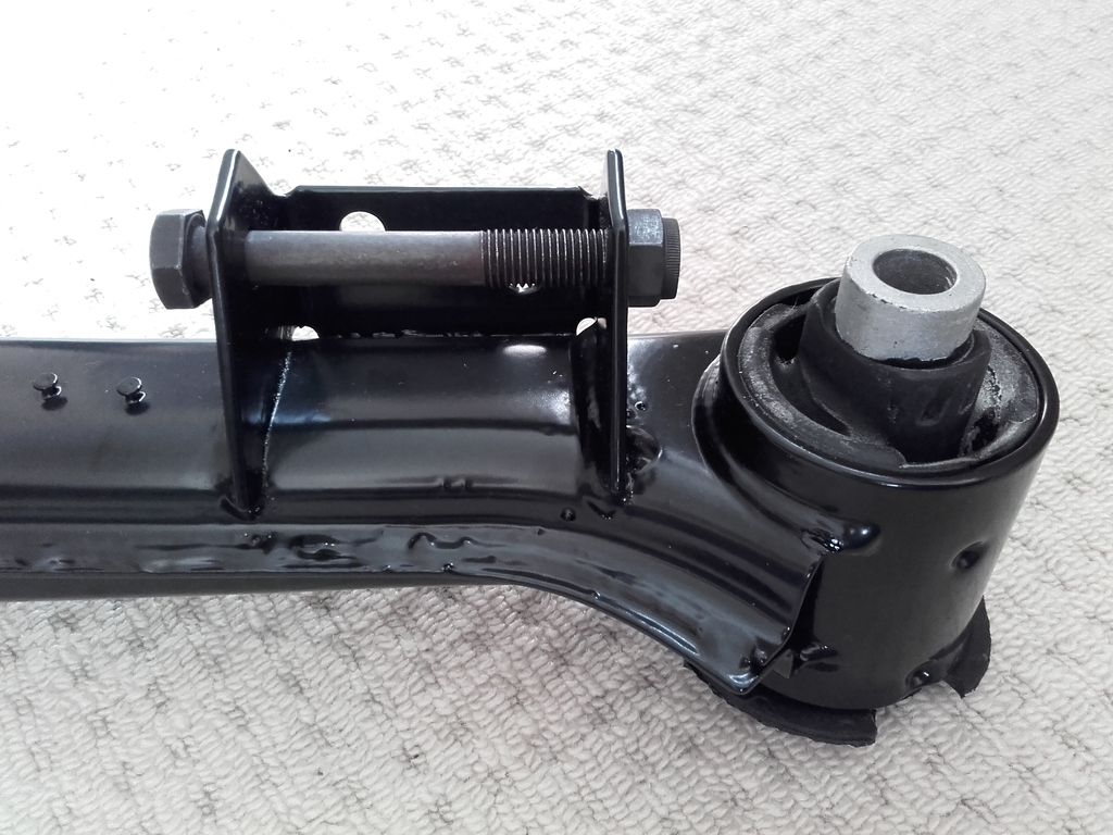

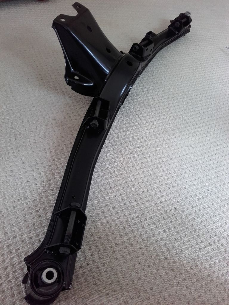

I've pulled the bushes from the rear subframe and added that to the pile of parts that needs to be blasted and receive a coat of satin black paint.

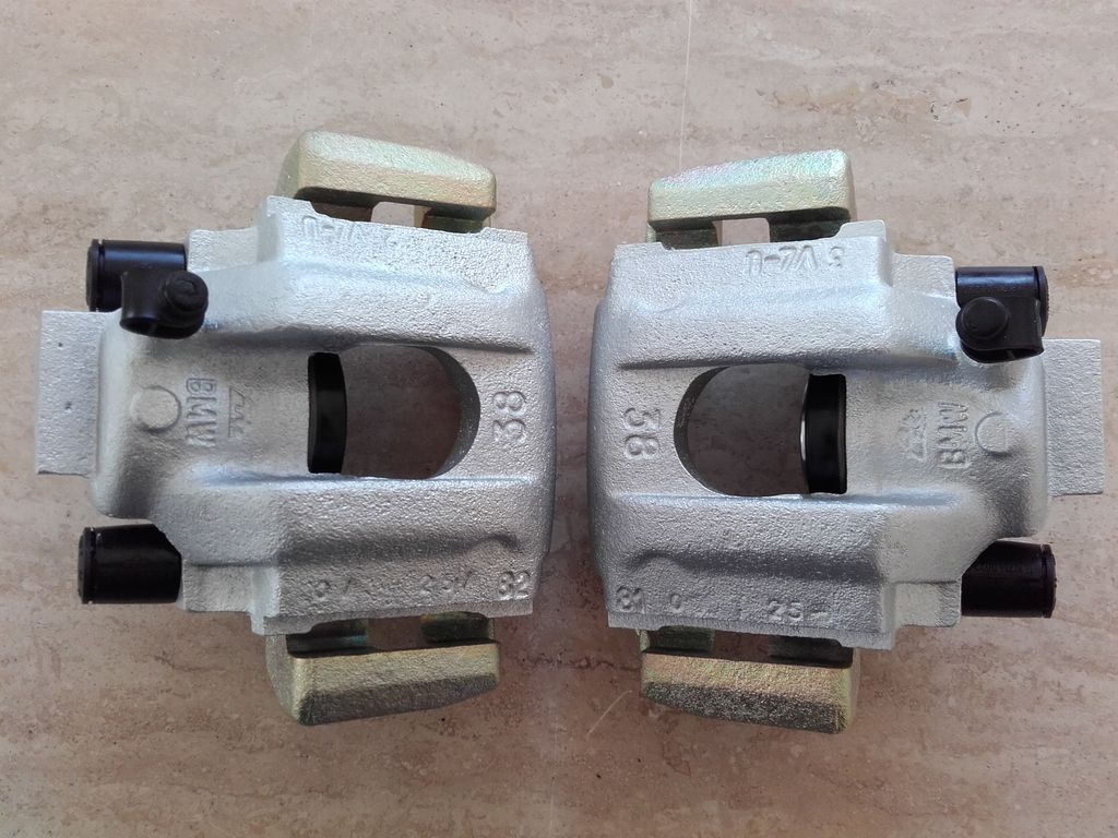

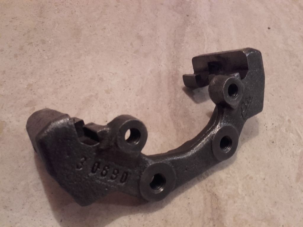

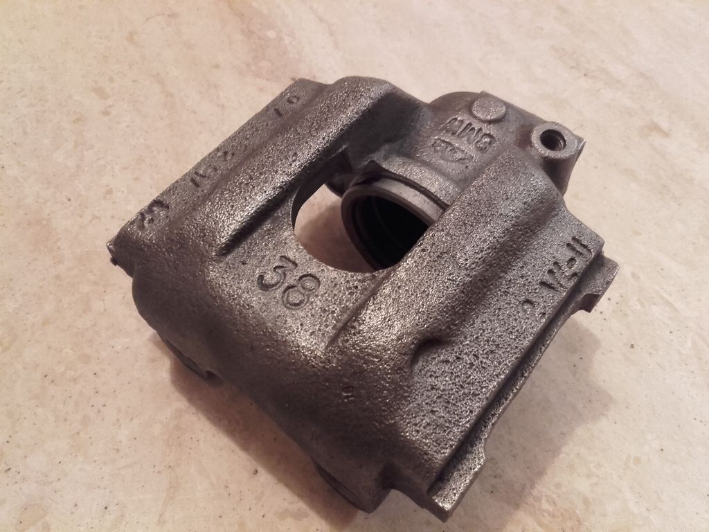

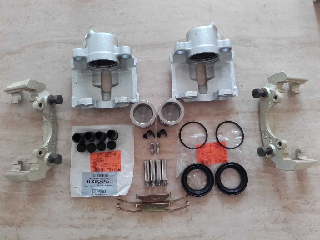

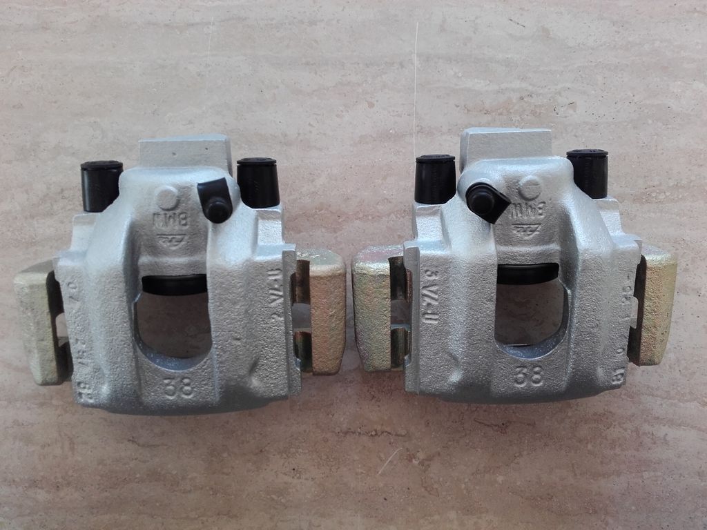

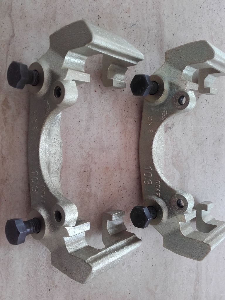

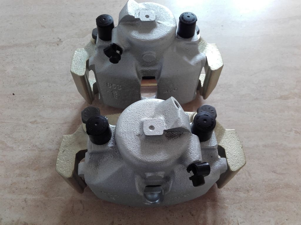

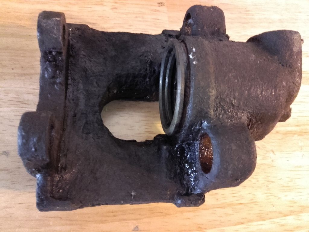

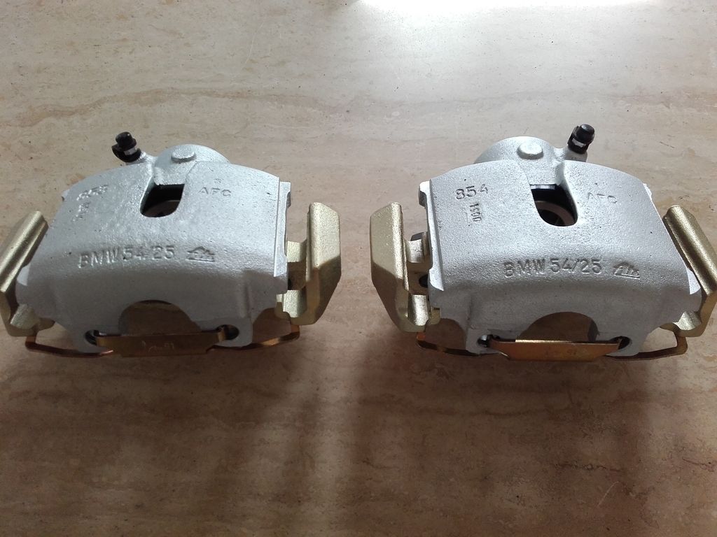

The brake calipers and brackets were pretty nasty after years of use and then being chucked in a box for 8 years. As I stripped them down, i was wondering if corrosion would have set in around the bores or seal area, but with just a light clean they are perfect. The outer surface however needed a serious de-rusting but looking good and are sat in a box awaiting a visit to the plating shop. New parts for the caliper are already here and have new ATE bushes, some stainless bleed nipples, and ATE seal kit and new pistions for the back calipers and hoping for some stainless items for the front.
Looking better and ready for plating.
Caliper brackets cleaned up nice too.

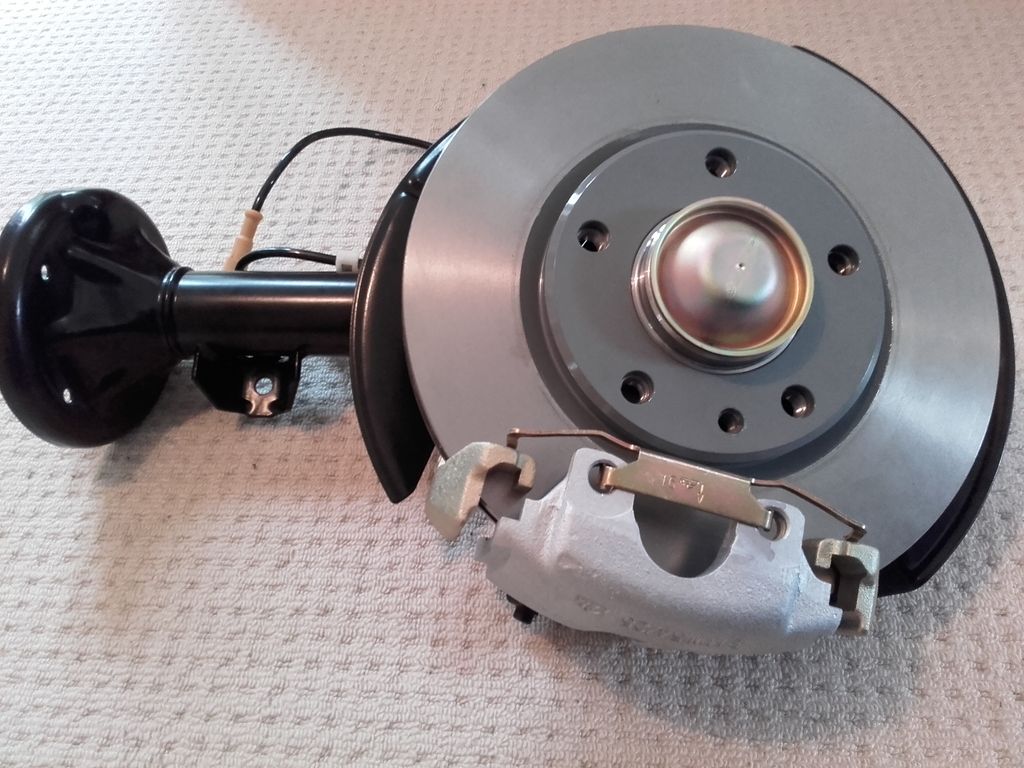

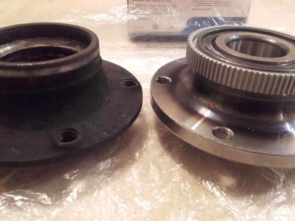

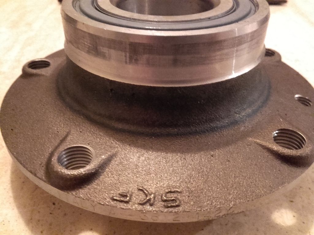

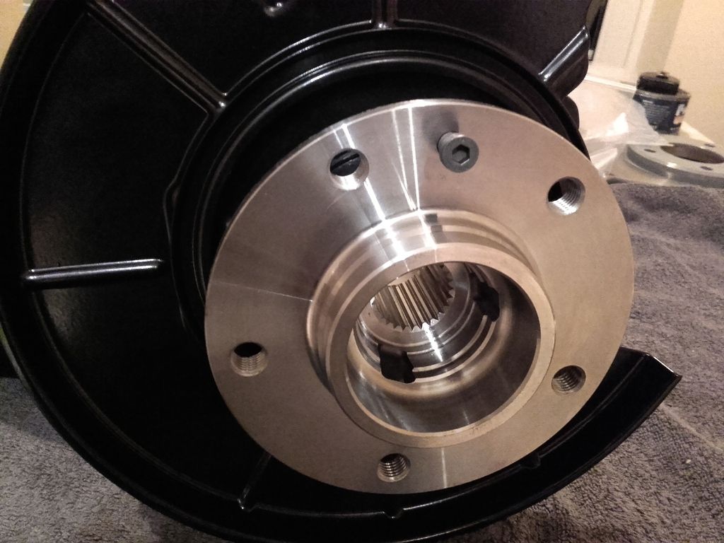

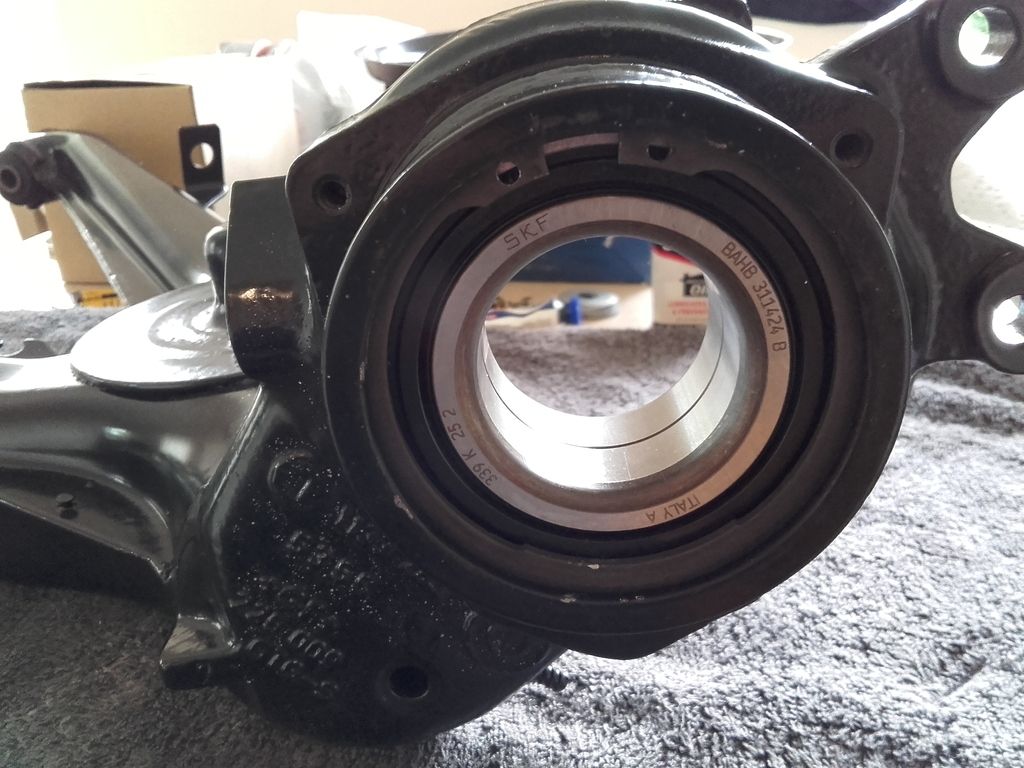

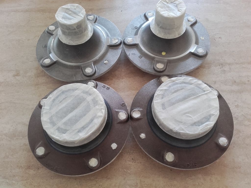

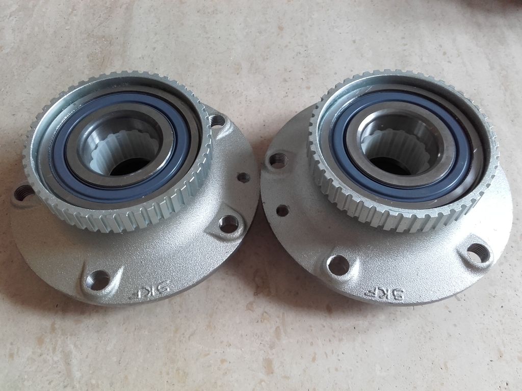

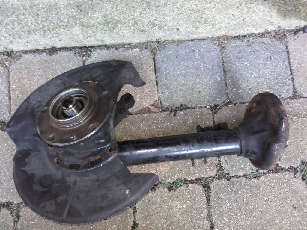

New front hubs are needed on the front and I thought I'd try and save a big pile of cash but not buying the expensive BMW dealer SKF made part, but use the well known trick of buying an E28 5 lug hub which is identical and swaping over the ABS rings which are different.
So had 2 new SKF hubs delivered and was disapointed to find they are a different design hub and heavier ,although still a replacement.
This pic shows the difference between the tatty original and the SKF replacement.
These were thanfully accepted as a return and it took a bit of time to find another SKF set that were of the correct design, as seen here after I've removed the ABS rings.

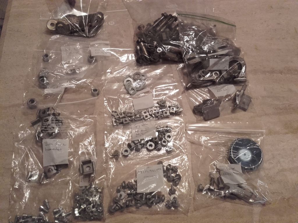

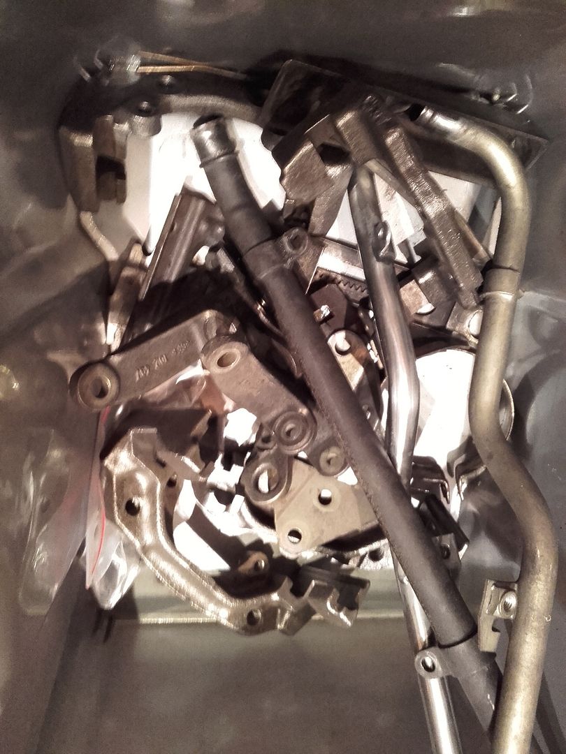

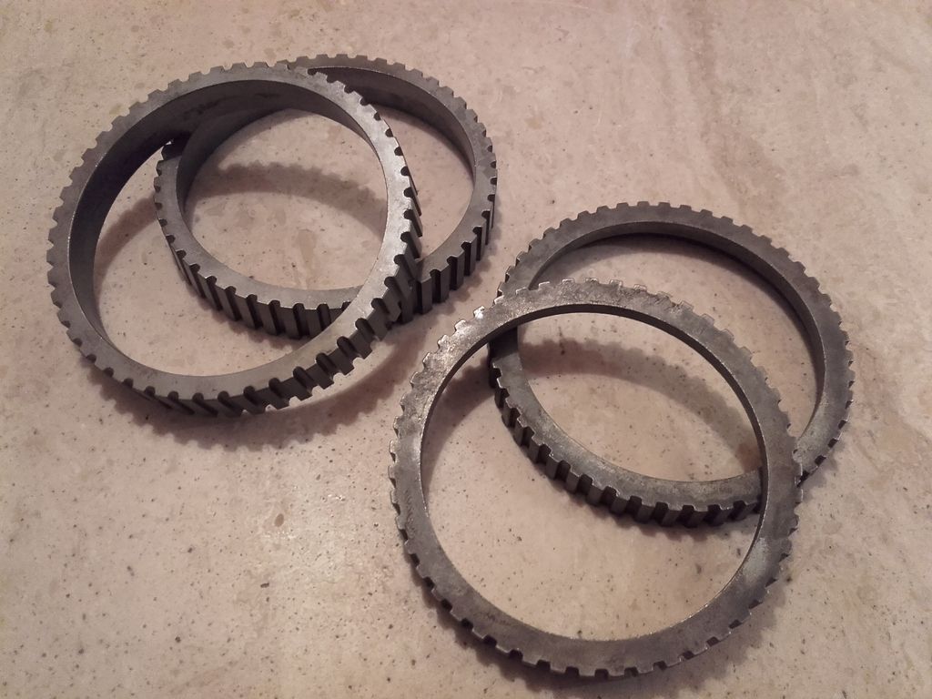

The Rear ABS rings have been removed and chucked in the box of parts for zinc plating

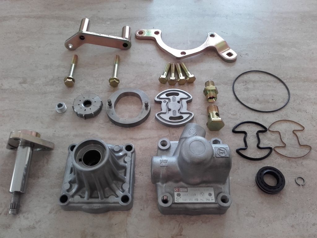

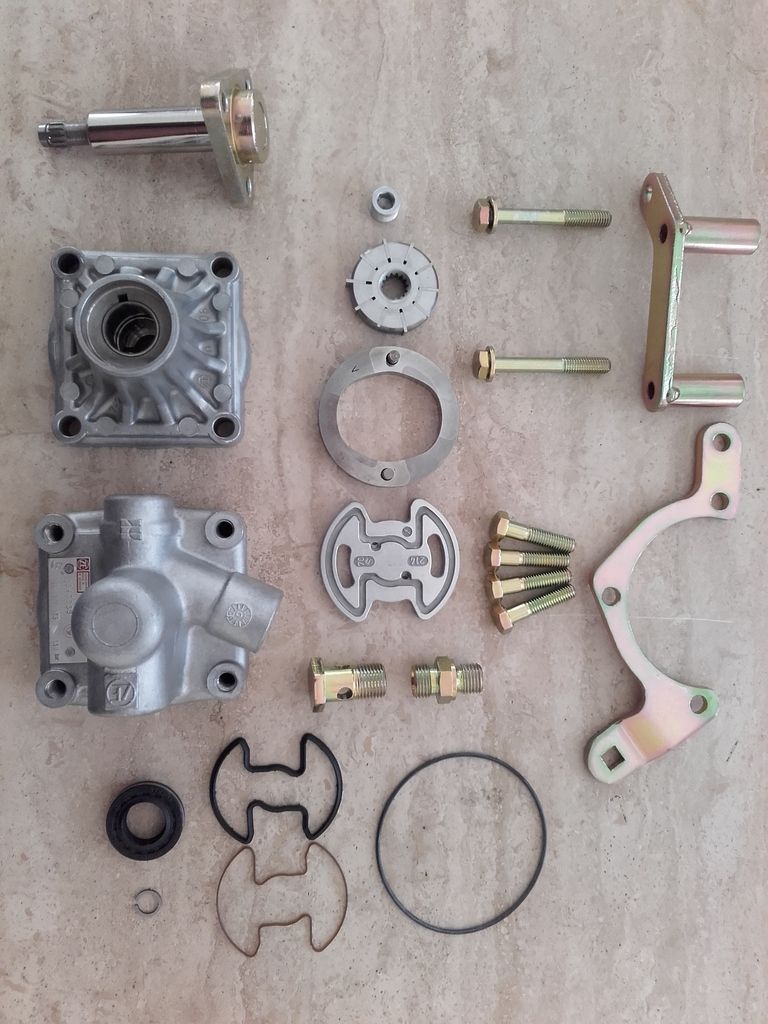

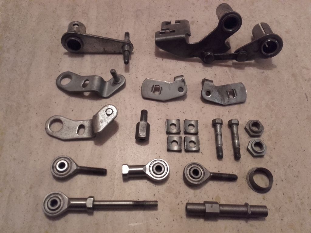

Mixed bunch of old and new bits that are going off for plating with zinc and yellow passivate.

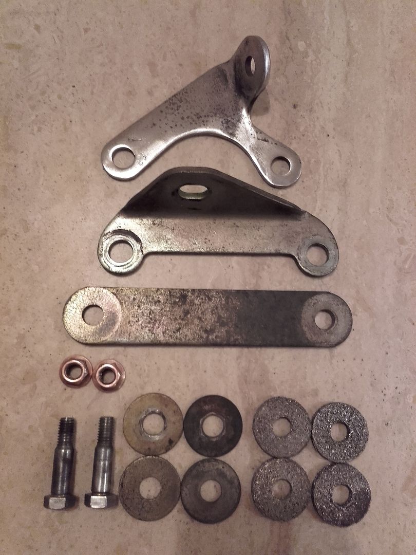

While sorting bits out for plating, this exhaust manifold bracket and be chucked into the plating collection
Few more random bits that maybe as well be plated at the same time.

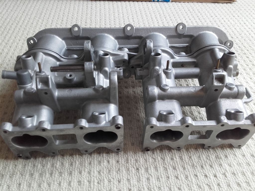

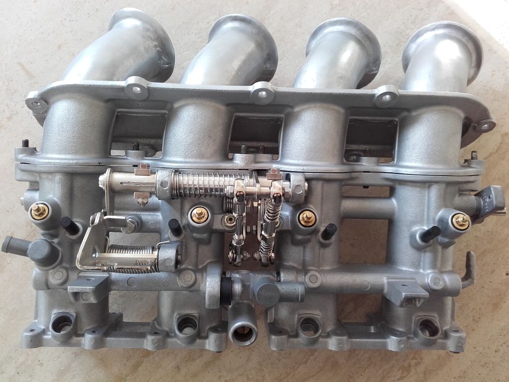

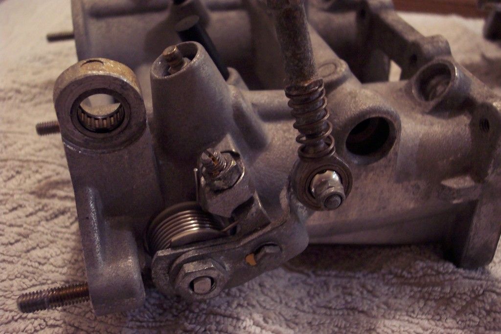

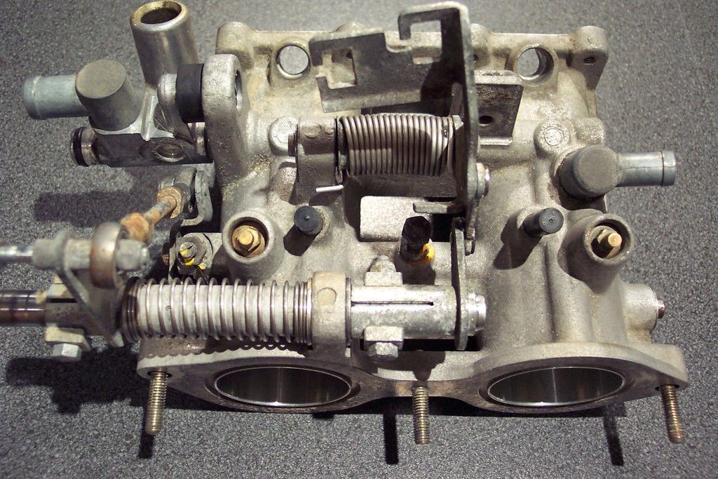

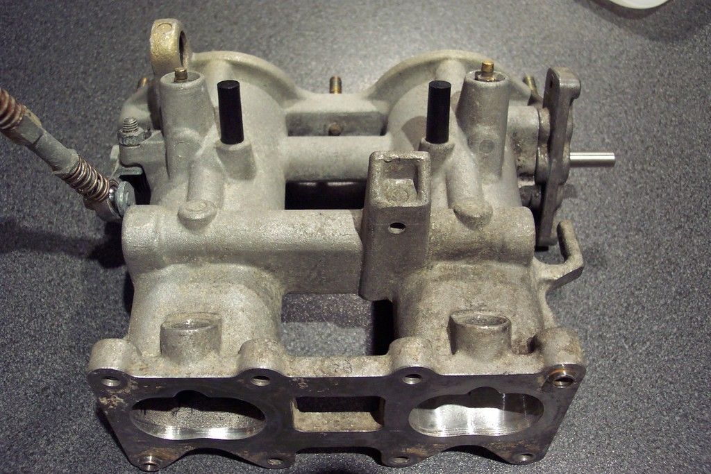

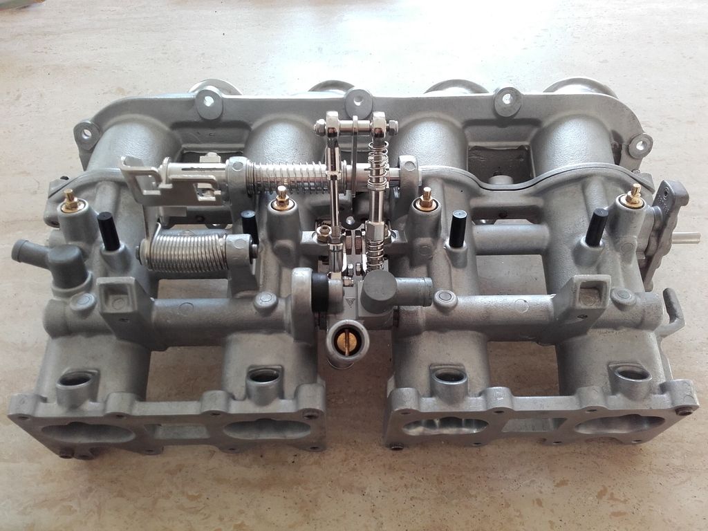

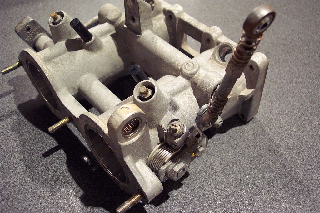

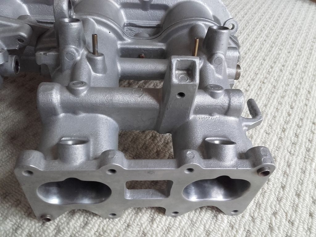

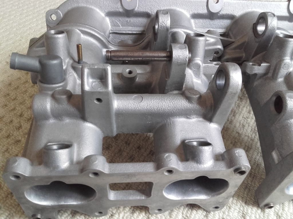

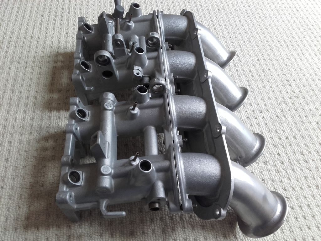

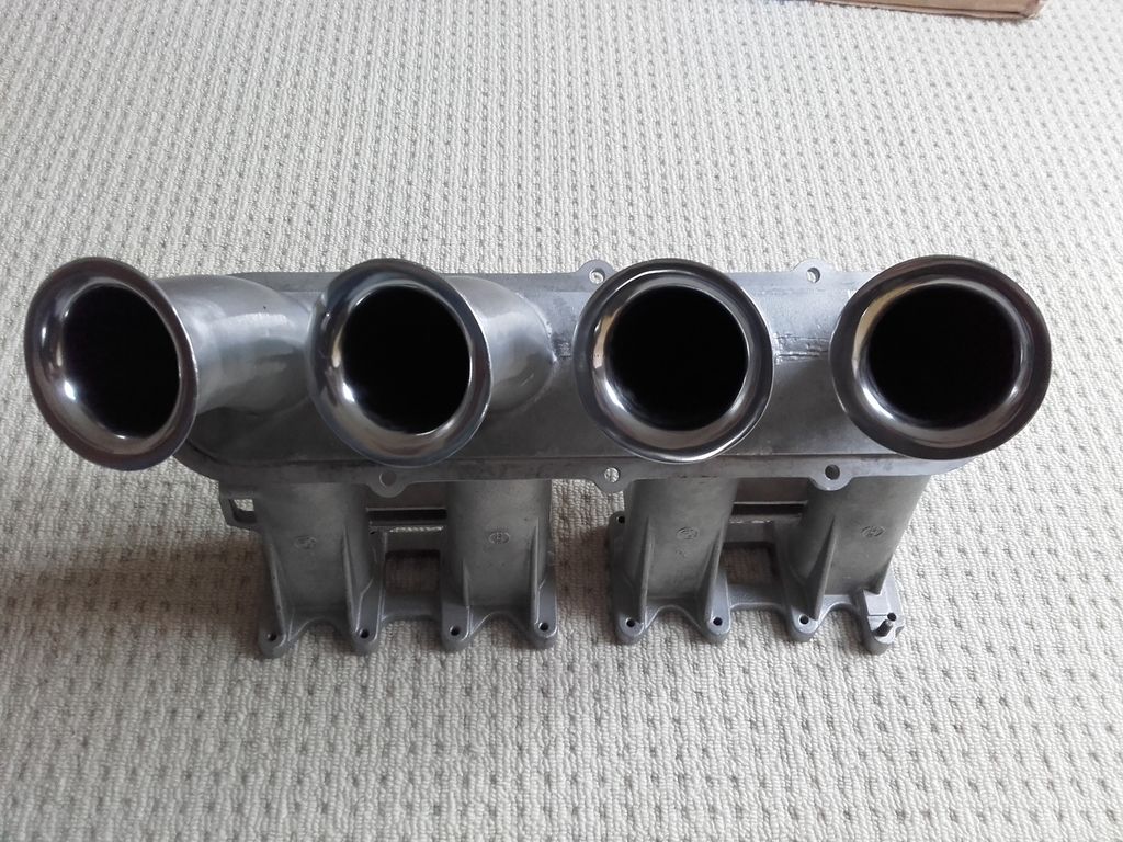

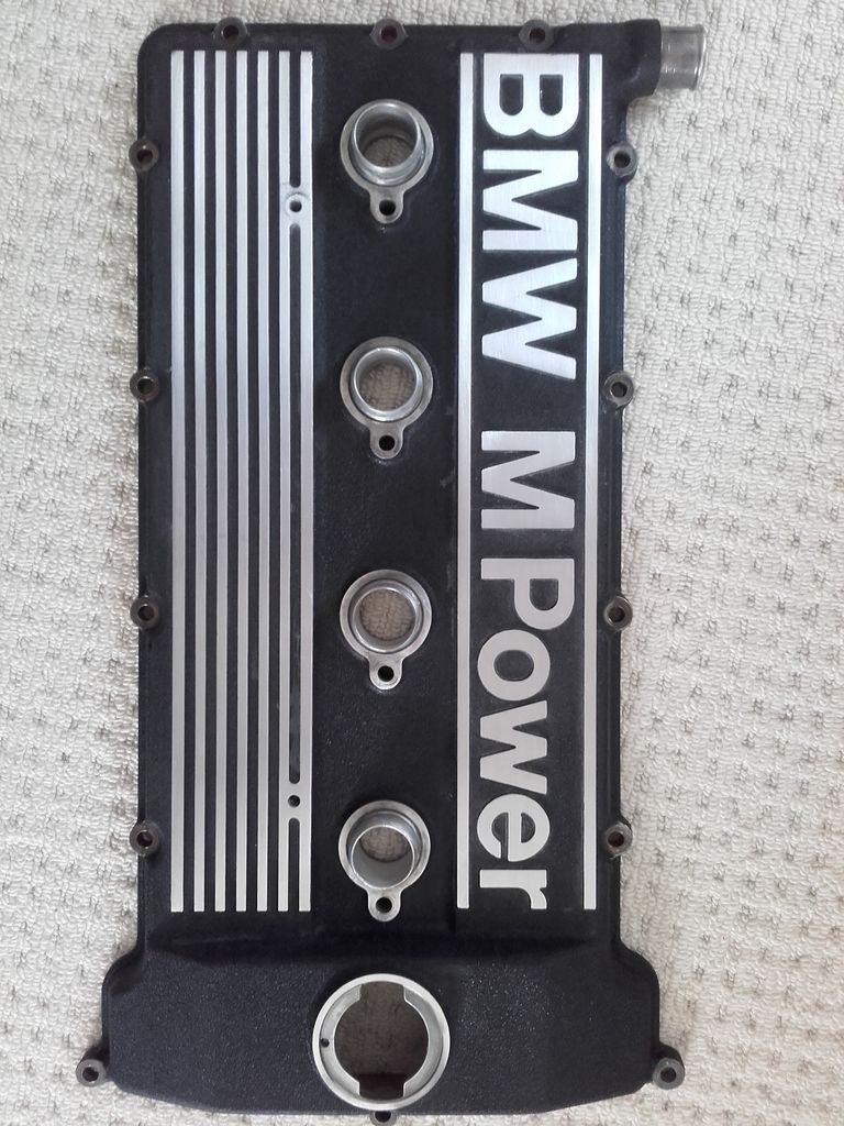

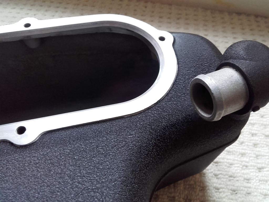

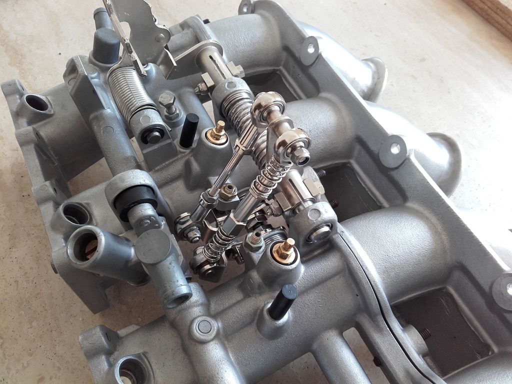

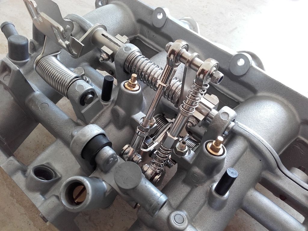

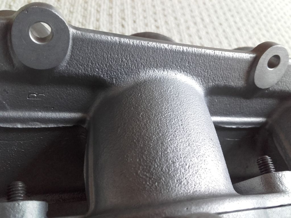

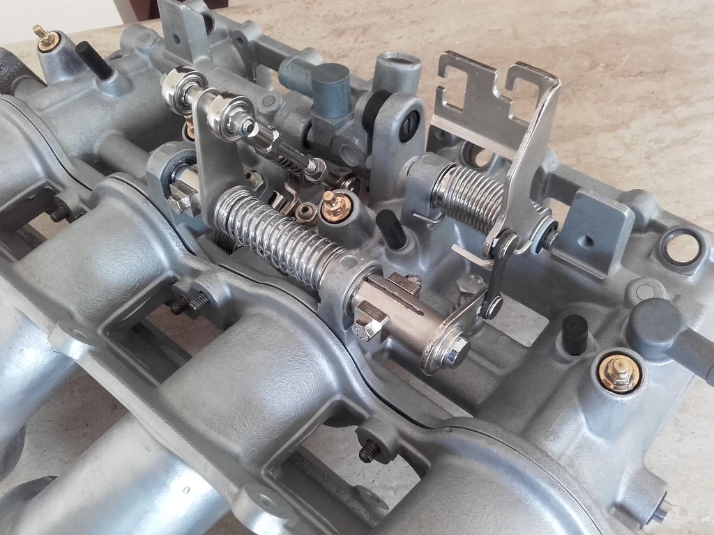

The plating company also does chrome and nickel plating, so pulled the throttle bodies apart and took the bits I want plated. Originally I think they would have been just silver zinc plated, but I'm thinking I'll add a bit of bling and go with a nickel plate on these bits.

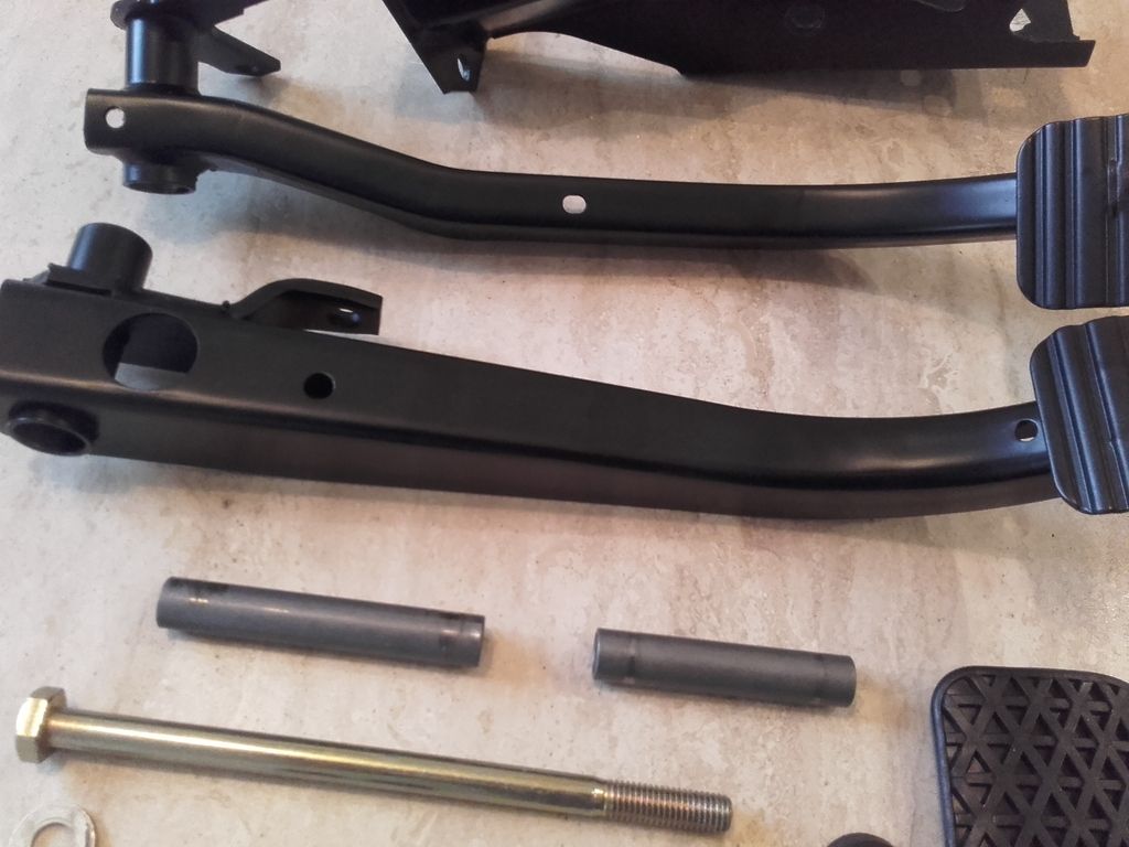

Next up is to hopefully get all the suspension bits away for blasting and painting along with the plating all complete . Once they are both done, there is a pile of new parts here ready to rebuild everything.

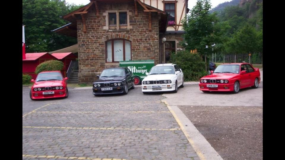

This was taken around 10 years ago, previous owner before me and the other 3 heading out to nurburgring :)
I know those cars and I think some of the owners vaguely. Wasn't UJB Kevin's Cecotto ?
Had a check back at my past Nurburgring pics and found we were all there at the same time, 28 ”ŽJune ”Ž2005. I take yours is the white one ?
The white one is still with its same owner from 2005, Kevins was the J reg in pics which I now own :) he now owns UJB which he said will be restored, pretty sure he said its an EVO 2?

Was a good weekend. I think that was 9 UK M3's there for that one.
I got the cars mixed up. There was a chap called Kevin Payne who had a Cecotto of which I'm sure the last part of the plate was UJB too.

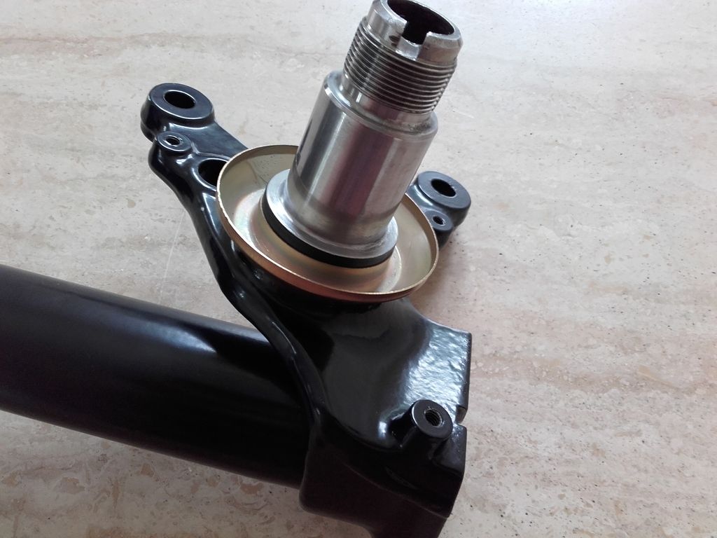

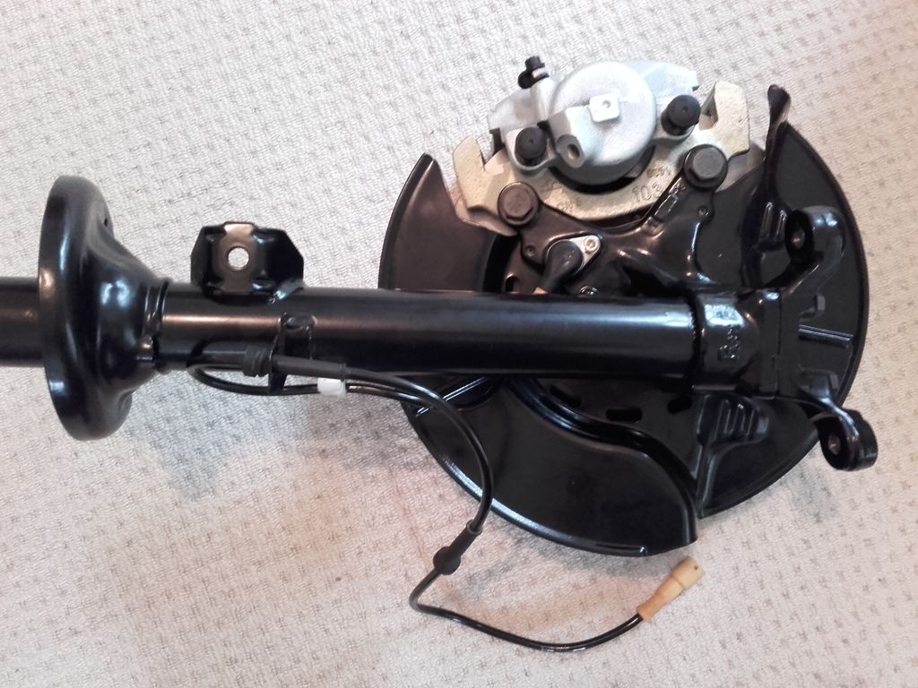

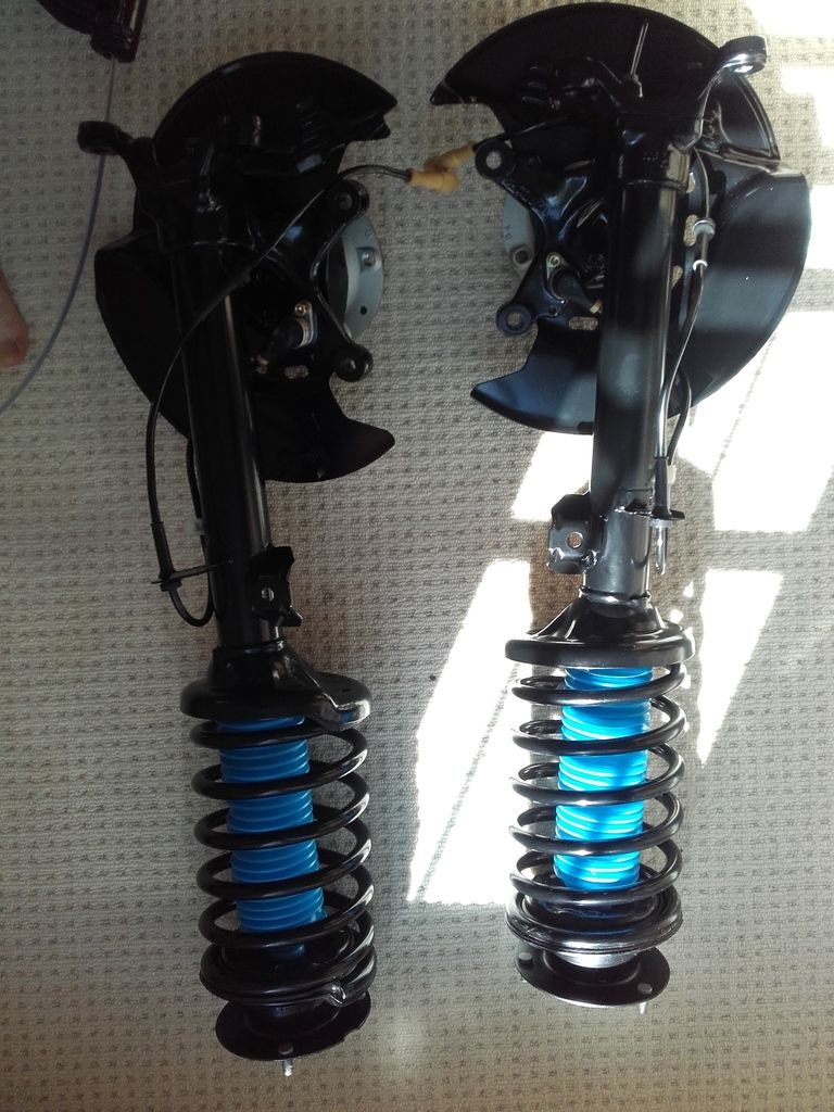

First up is the suspension and the front struts have been off for powder coating.
New hubs were bought and painted. E28 hubs ( SKF brand ) with the ABS rings plated and swapped over.
New cover placed knocked into place and spindle cleaned up.

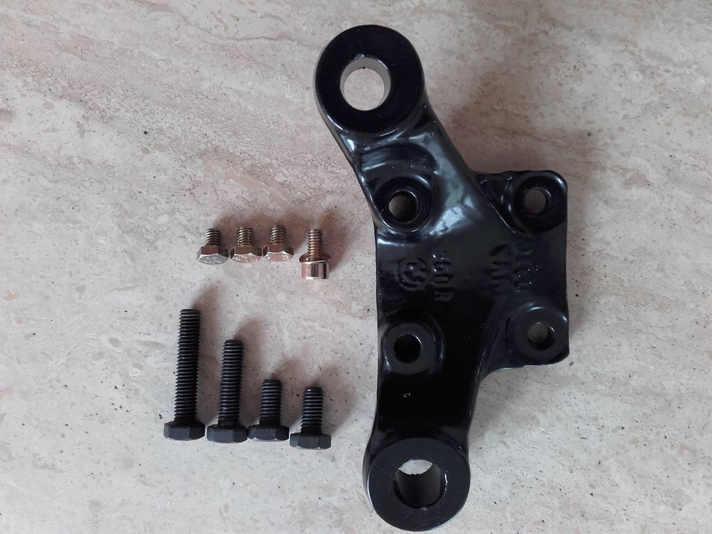

New 10.9 grade bolts for the steering arms and some new bolts for the backing plate and ABS sensor.

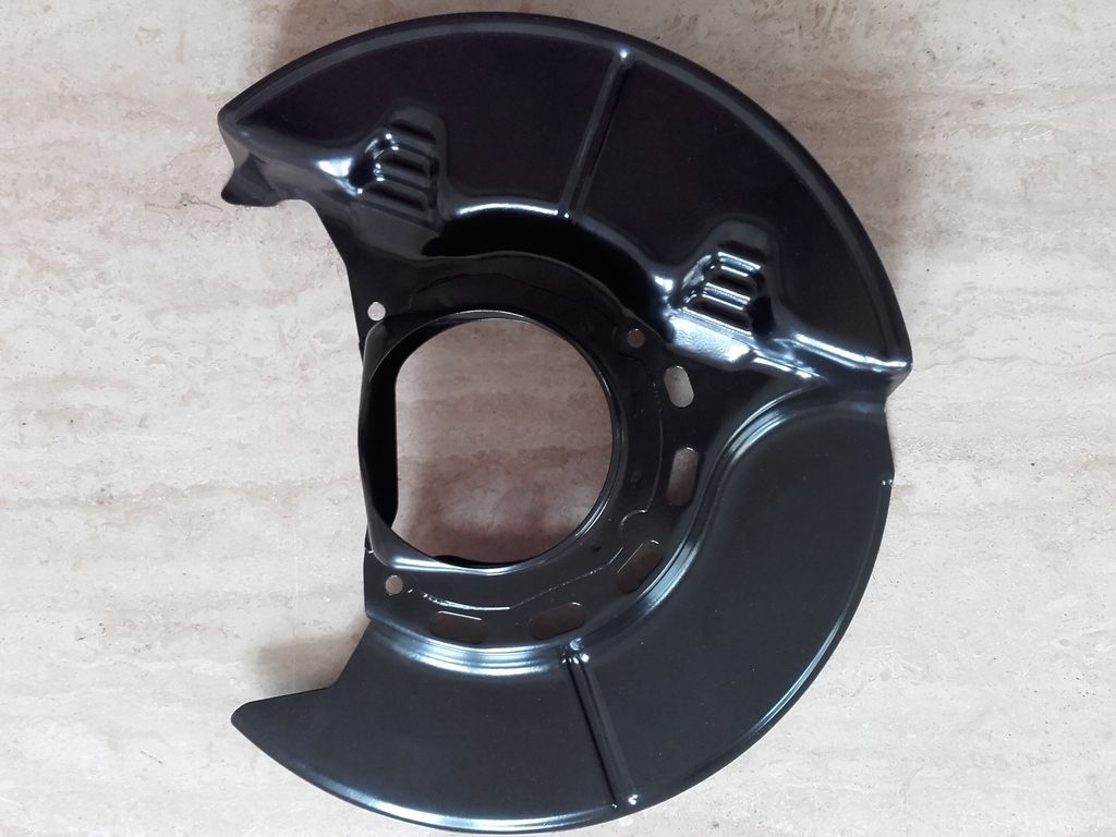

New backing plates purchased.

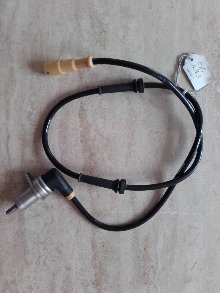

The original ABS sensors were checked and all found to be OK and given a clean.

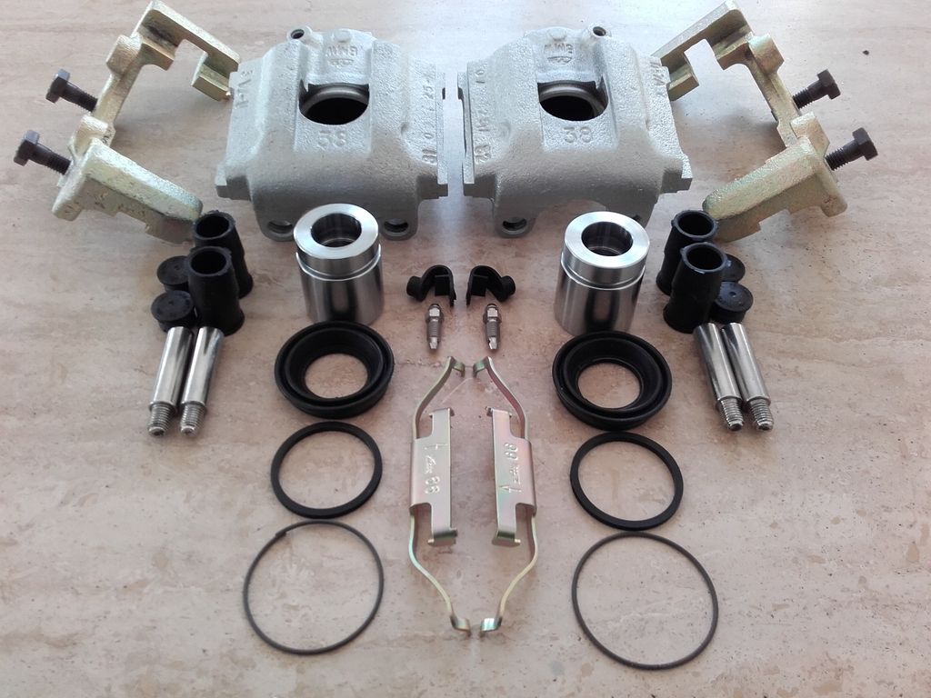

Front brake calipers have been cleaned and plated. New stainless pistons on the front, new ATE seal kit, new stainless bleed nipples, new 10.9 grade bolts, plated caliper carriers, sliding pins cleaned and given a buff up on a polishing mop and replated brake pad rattle clips.
Everything fitted to the strut to check everything.

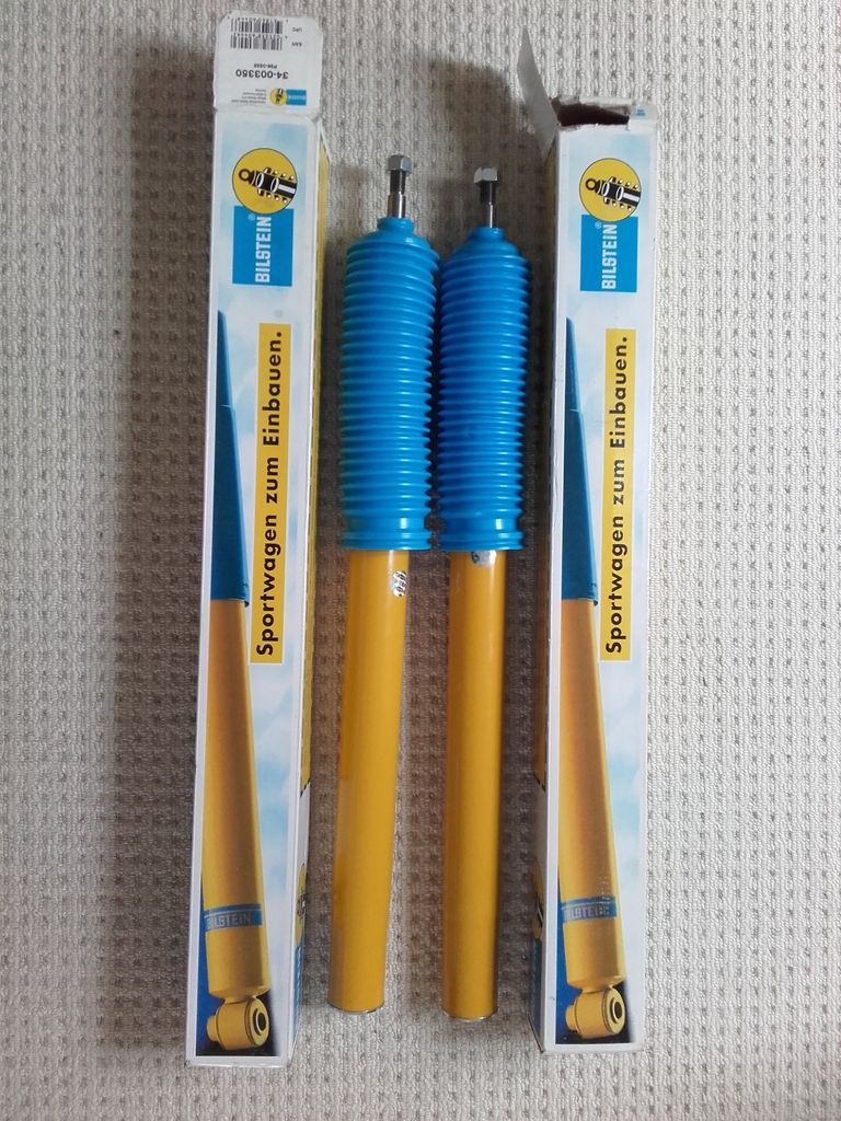

New Bilstein B8 dampers purchased.

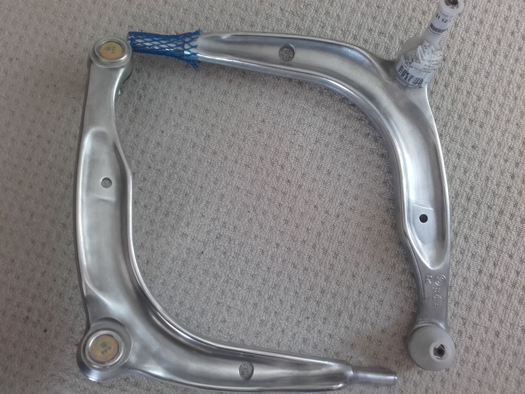

Some mega expensive control arms purchased. Late spec cars like mine had these as stock, so obliged to fit these.

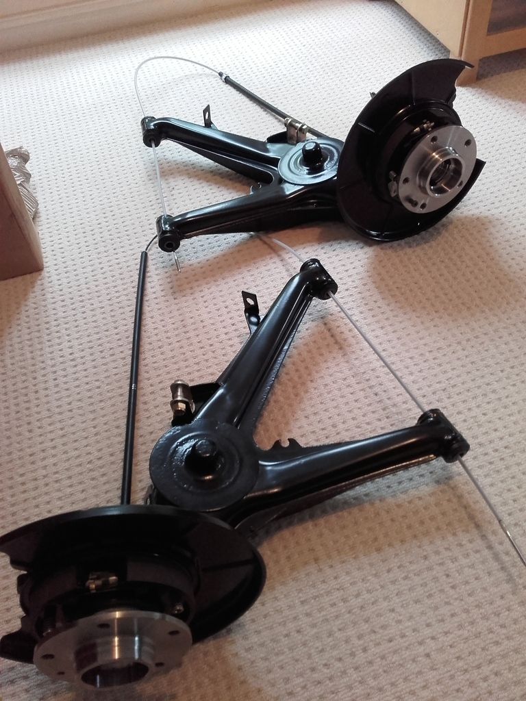

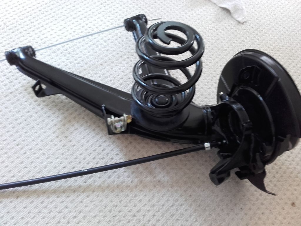

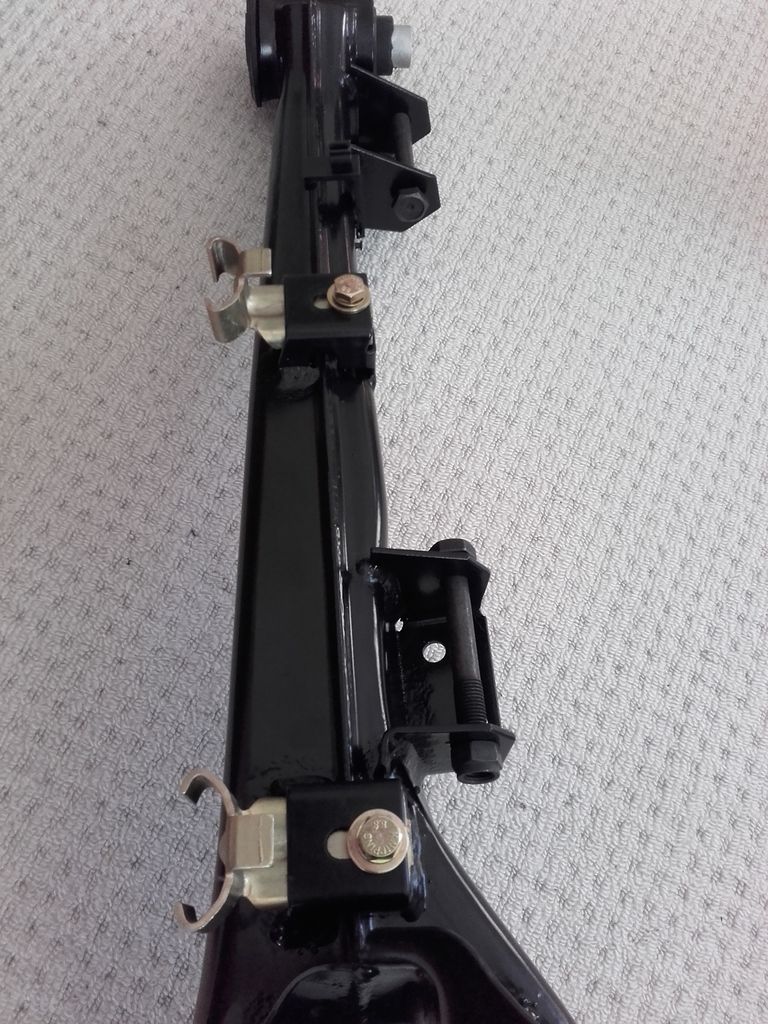

Now the turn of the rear and the rear swings arms have some reinforced roll bar mounts added and were powder coated along with all the other stuff in semi-gloss black.

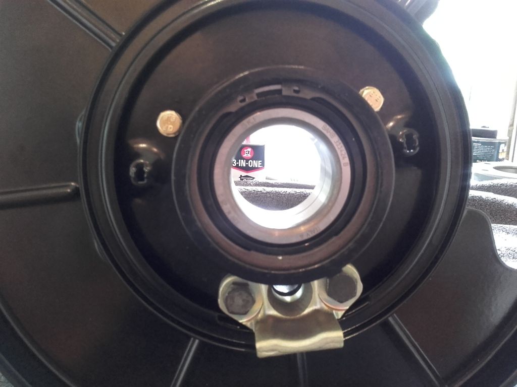

New SKF bearings were purchased and pressed in place. Anyone know the part number of the blanking plug missing on the swing arm in the pic ?
New backing plate in place with a smear of sealent behind it to stop water getting in. New hand brake cable bracket and 10.9 grade bolts in postion.

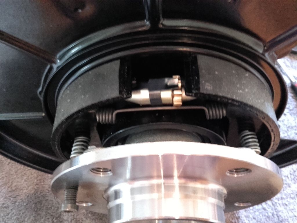

Got offered a mega deal on a new set of hubs, which I bought even though the original were fine and pressed these in an put a new disc retaining bolt in place.

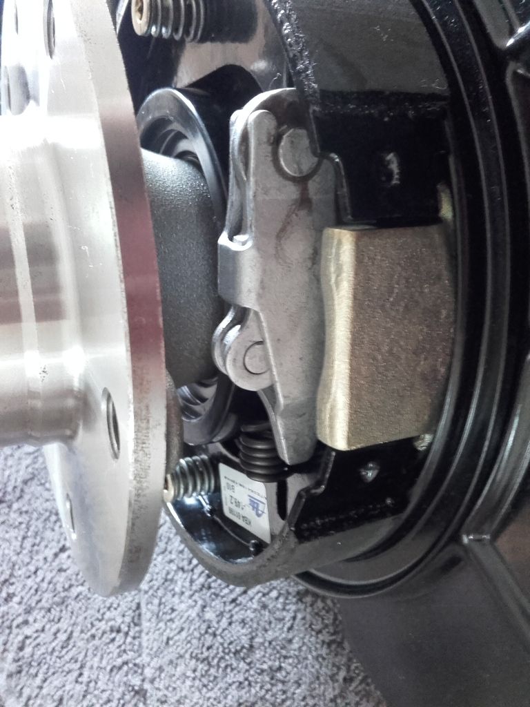

Some new ATE brake shoes in place with a mixture of replated and new handbrake parts and new spring kit.
Some new ATE cables.
New genuine bushings pressed in place and the brackets for the Racing Dynamics anti roll bar kit.
Powder coated springs and new spring pads.

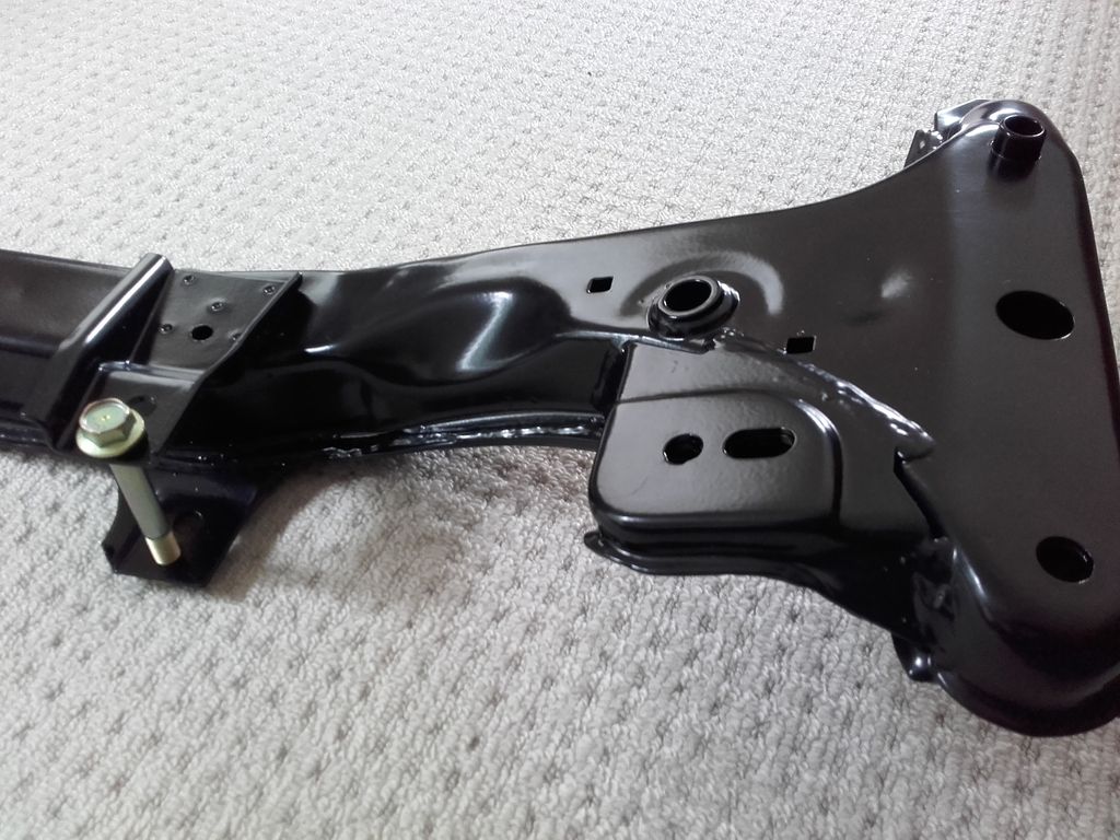

All this lot will mount to a freshly powder coated front subframe.
Reinforcing plates have been fitted.
With new engine mounts....
Waiting on the correct B10 wave washers.
On the rear we have again freshly powder coated bits.
Used the wheel bearing puller to fit new Lemforder bushings. New 10.9 grade swing arm bolts in place for storage.
A new set of Bilstein rear dampers are in storage ready to fit with new Lemforder top mounts.
New exhaust hanger brackets in place. Used an extra washer on these as the specified on seems too small.
Rear calipers are same as the front in their rebuild.

Been doing some engine parts too.

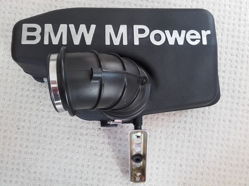

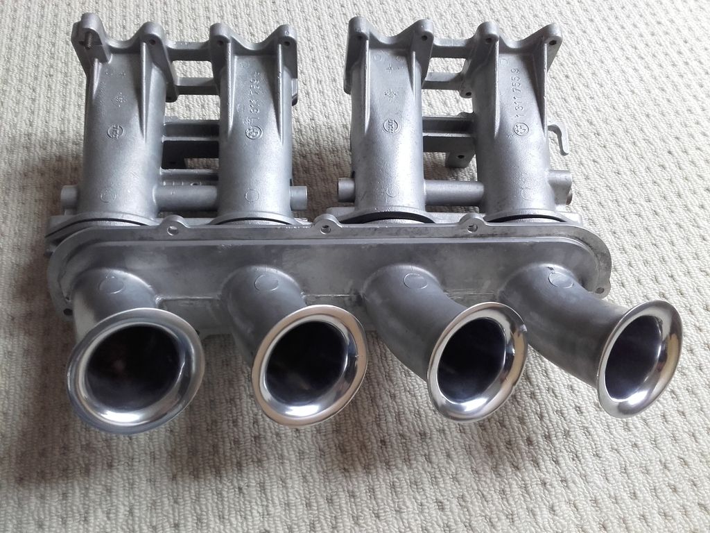

Started with the throttles, which on this late model Euro spec are the larger 48mm variant.
They were looking a little tired so a full strip and clean was need. A little bench mounted bead blast machine was slow going but provided satisfying results. The various brackets were given a dull nickel plate to add a touch of bling over straight zinc plating.
The port mouth to rubber block was also port matched and shaped to fit the only available intake gaskets. The always lose elbow was held in with some Loctite compound.
The intake runners were cleaned up and given a polished lip. I doubt there is any BHP gain, but the rough cast look was annoying and just didn't seem right . Anyway, very pleased with the results and a nice crowing glory to an S14 engine I think.
Before
After
The manky studs bugged me after the pics, so pulled them out and chucked the in the next bag of bits for zinc and yellow plating.

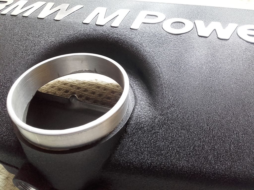

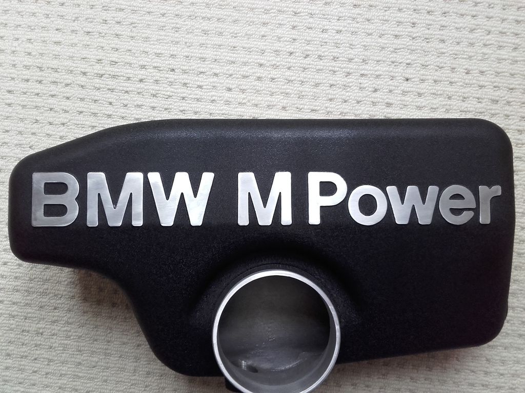

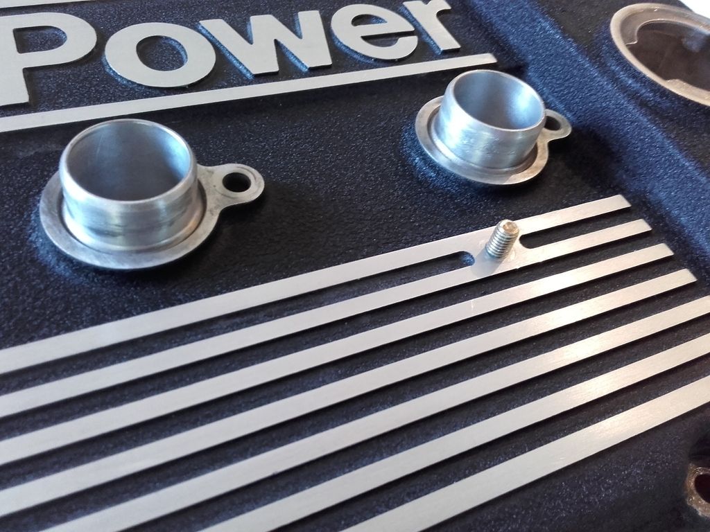

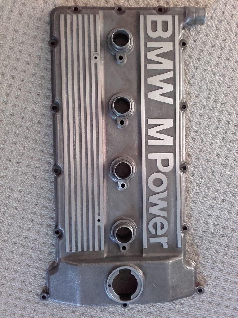

Next up is the cam cover. This was a spare I bought and thick with red powder coat. Using Nitromors was a complete waste of time, but manged to find some stuff on ebay with took it off without too much hard work.
I used a can of VHT wrinkle paint and sanded the raised parts back with some 240 grit paper as it didn't want it too shiny.
Same thing on the plenum too.

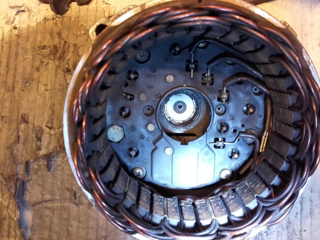

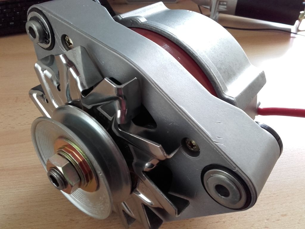

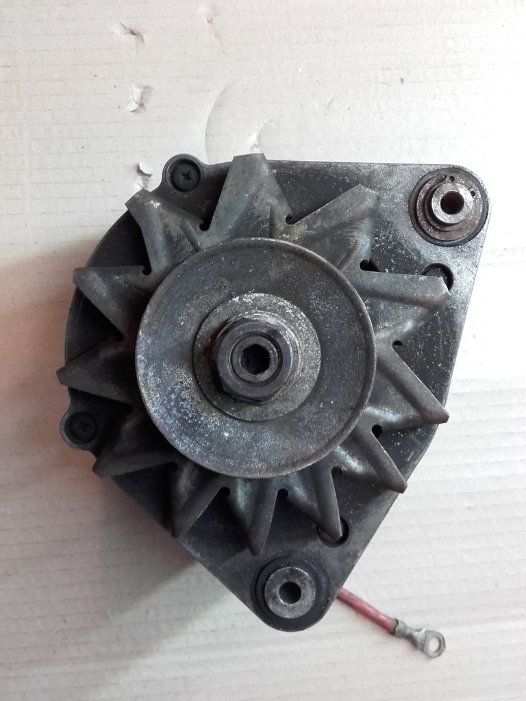

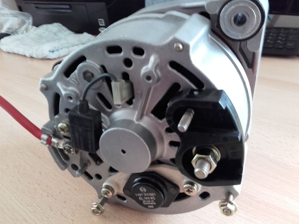

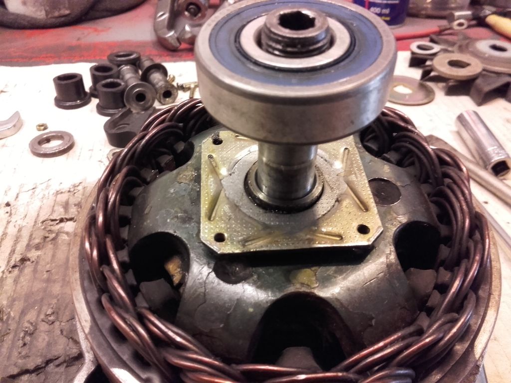

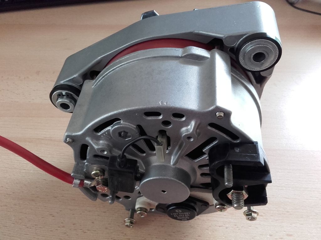

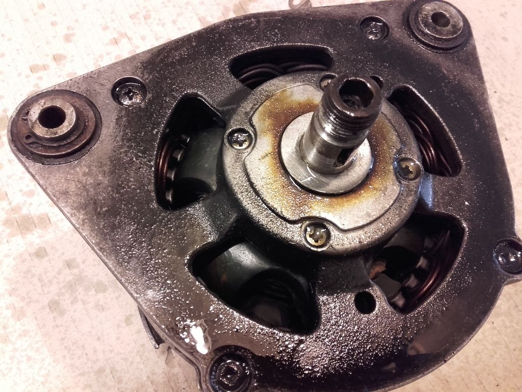

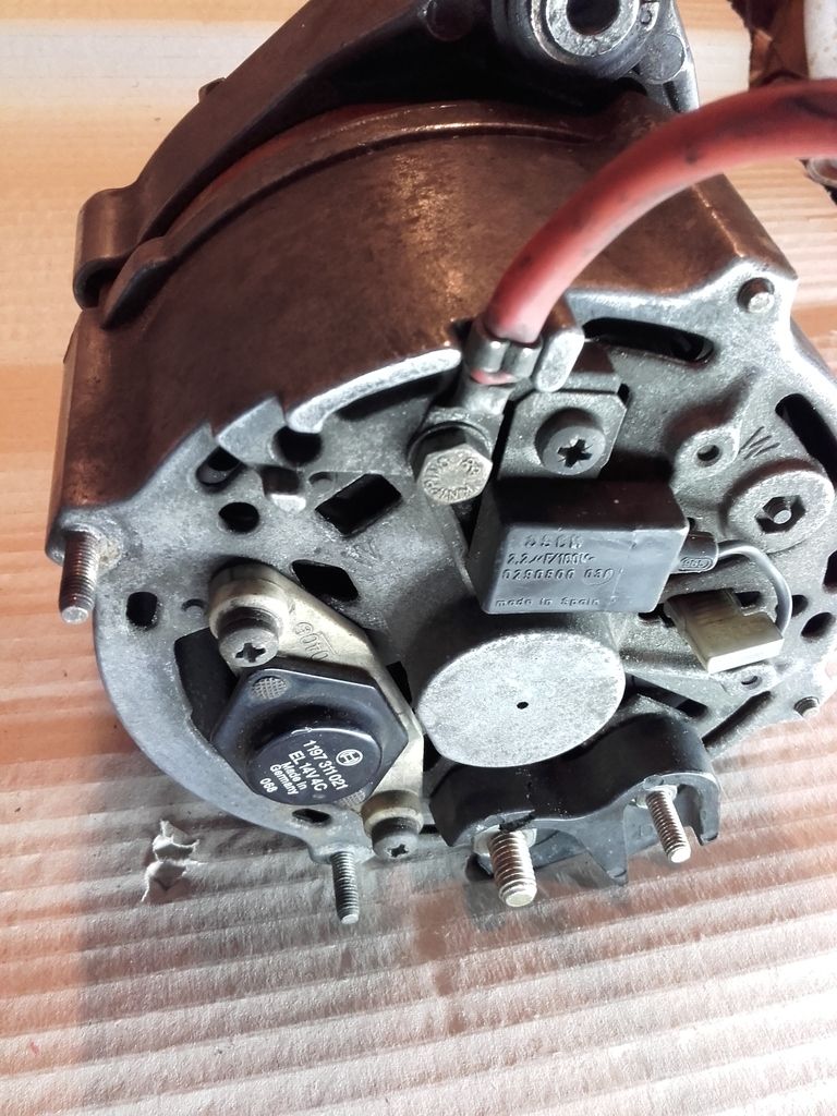

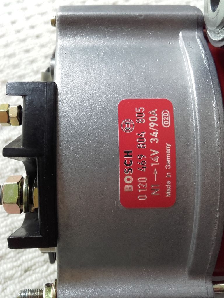

Next the alternator may as well have new bearings, brushes, mounting rubbers along with some replated parts fitted along with a clean up and bead blast of the casings.
Before
Rebuilt
After the bead blasting you could still see the area where the Bosch sticker was which looked a bit odd. An enquiry with Pukar Designs offered the solution in a repro sticker to finish it off nicely.

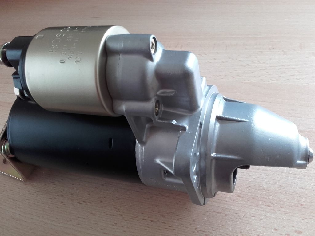

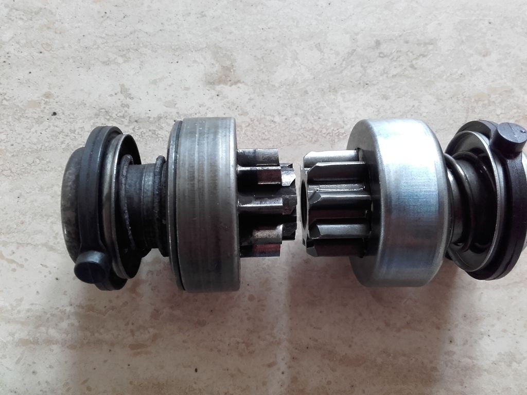

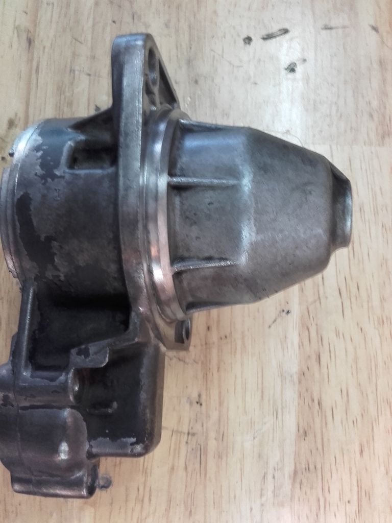

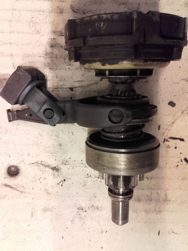

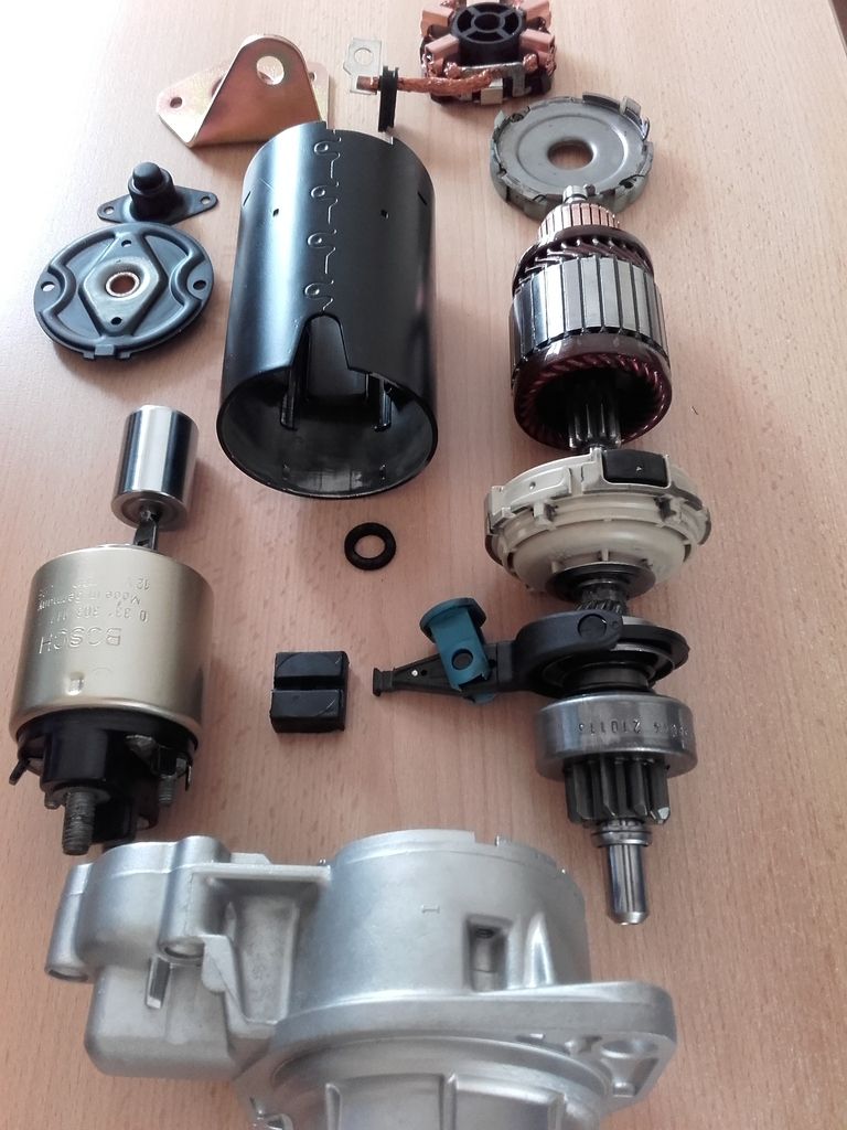

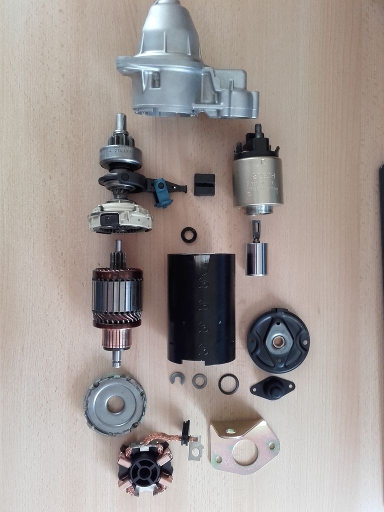

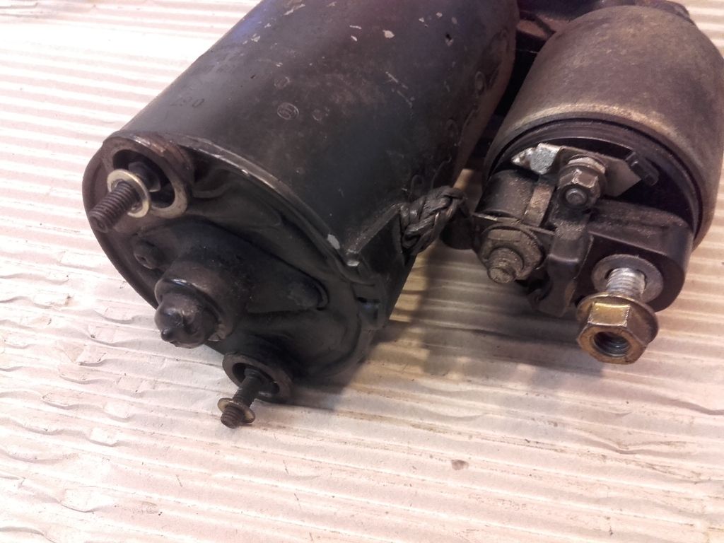

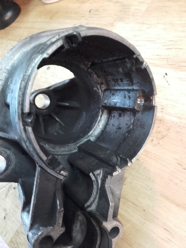

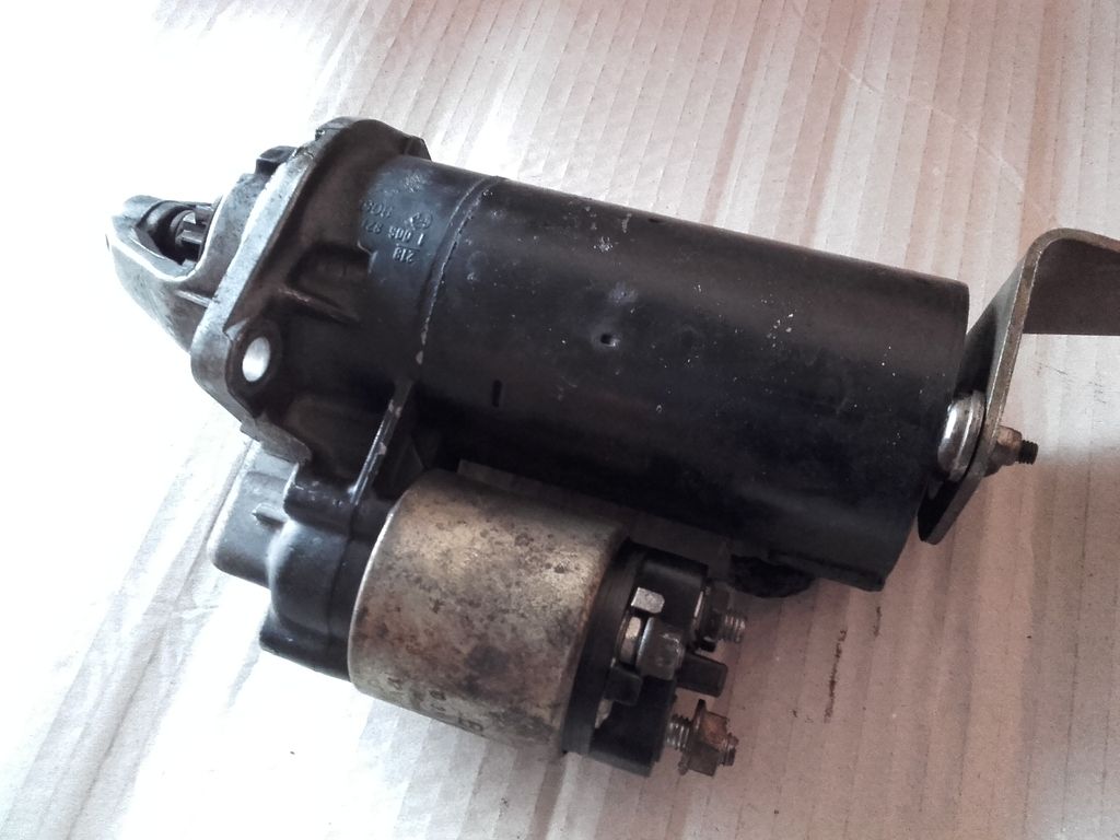

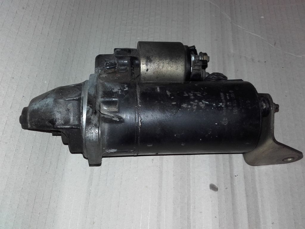

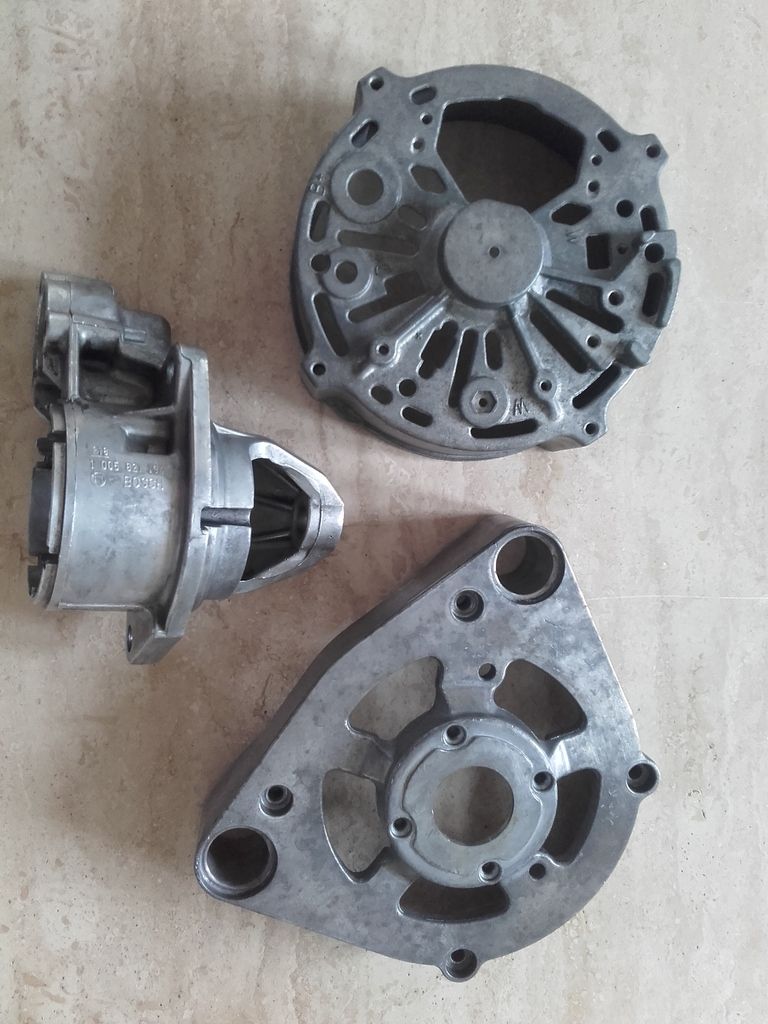

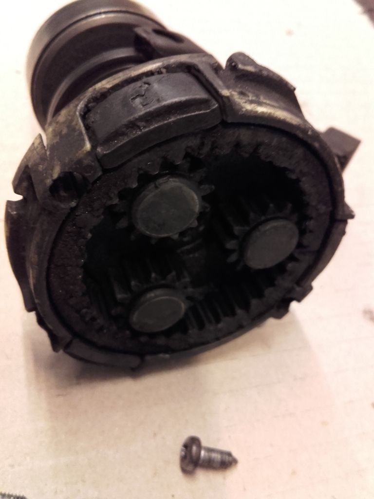

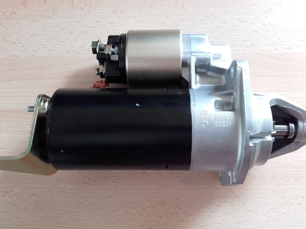

Next up is the starter motor, which from the marks on the body looks like someone has given it a whack or two at some point.
Nose off.
Pinion and plant gears out.
Years of gunk and brush dust.

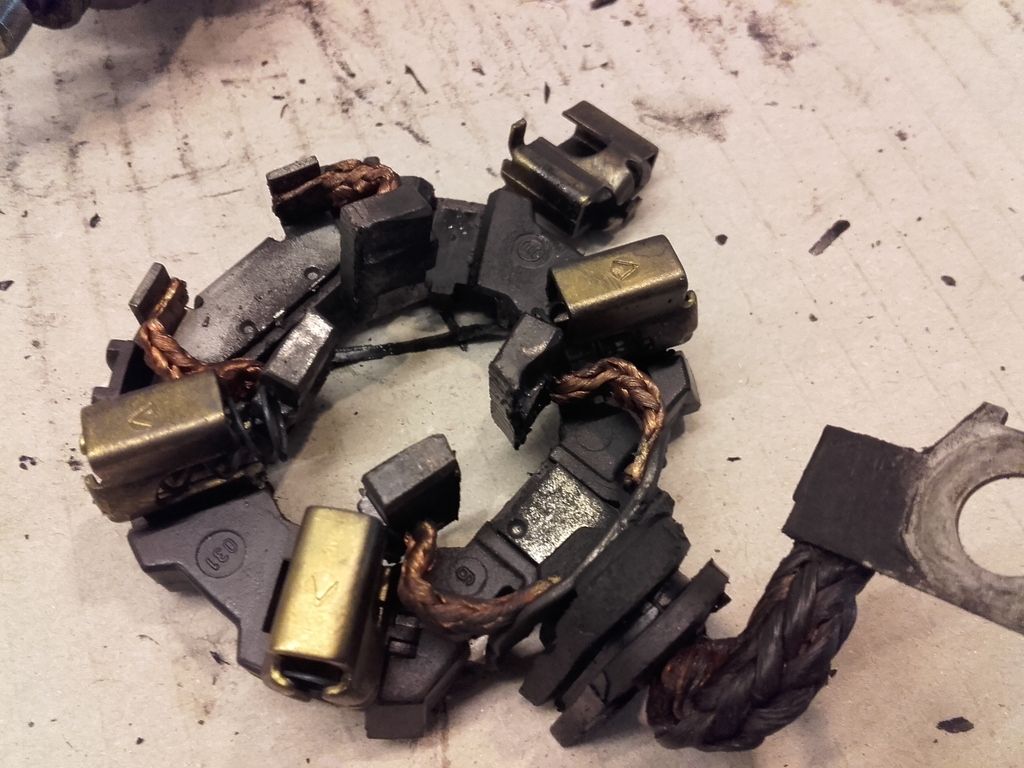

Old brush pack wasn't too bad.
Old and new shows the amount of wear on the pinion.

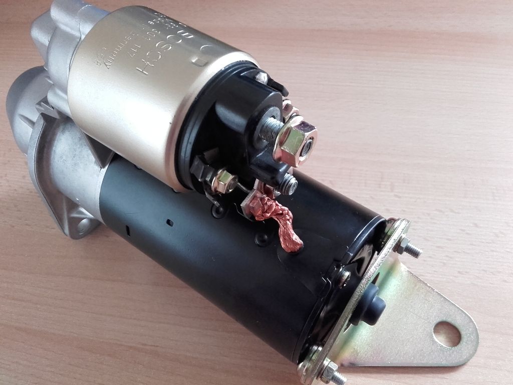

The body gets a coat of paint, so too the solenoid, new brush pack , replated bracket, bead blasted nose cover, new brass bushing in the nose and rear cover, cleaned up surface area on the end of the motor and new plated nuts and bolts.

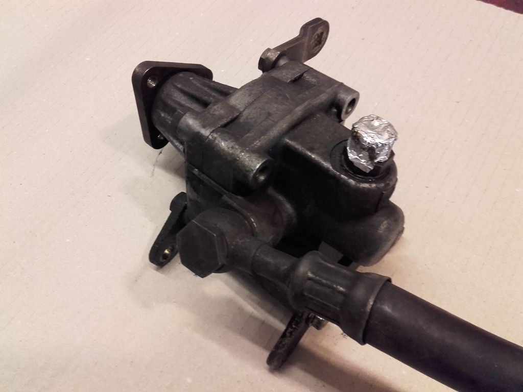

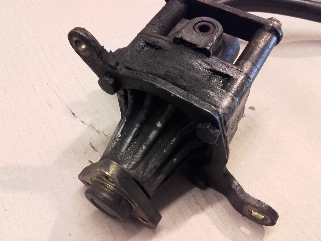

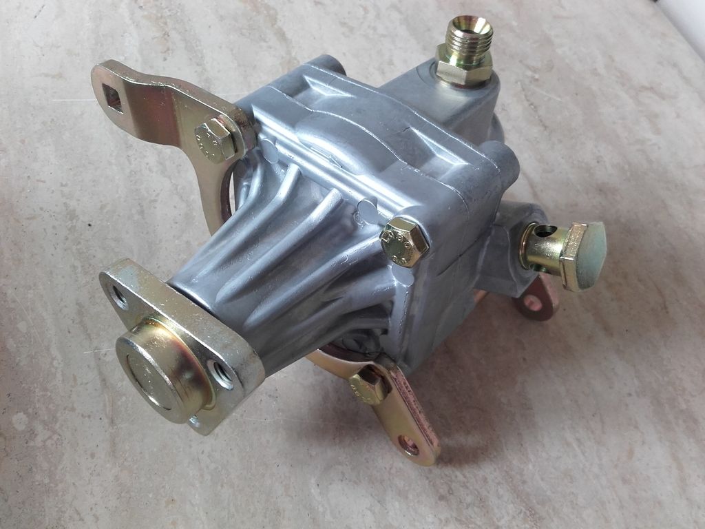

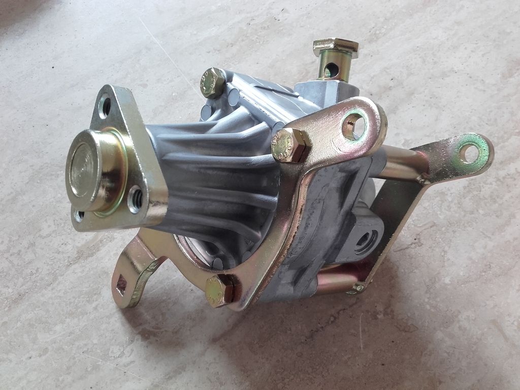

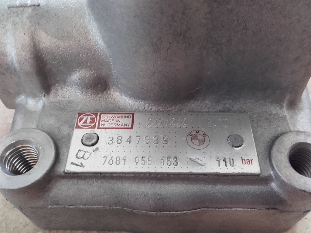

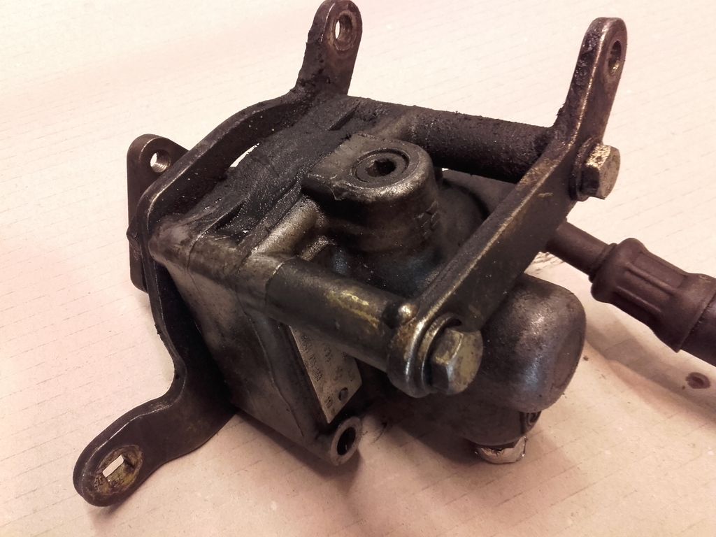

The power steer pump gets some attention next.
The body of the pump got a clean in an ultrasonic bath and came out nice.
Brackets and bits been away for plating and a new seal kit purchased.
All together again.

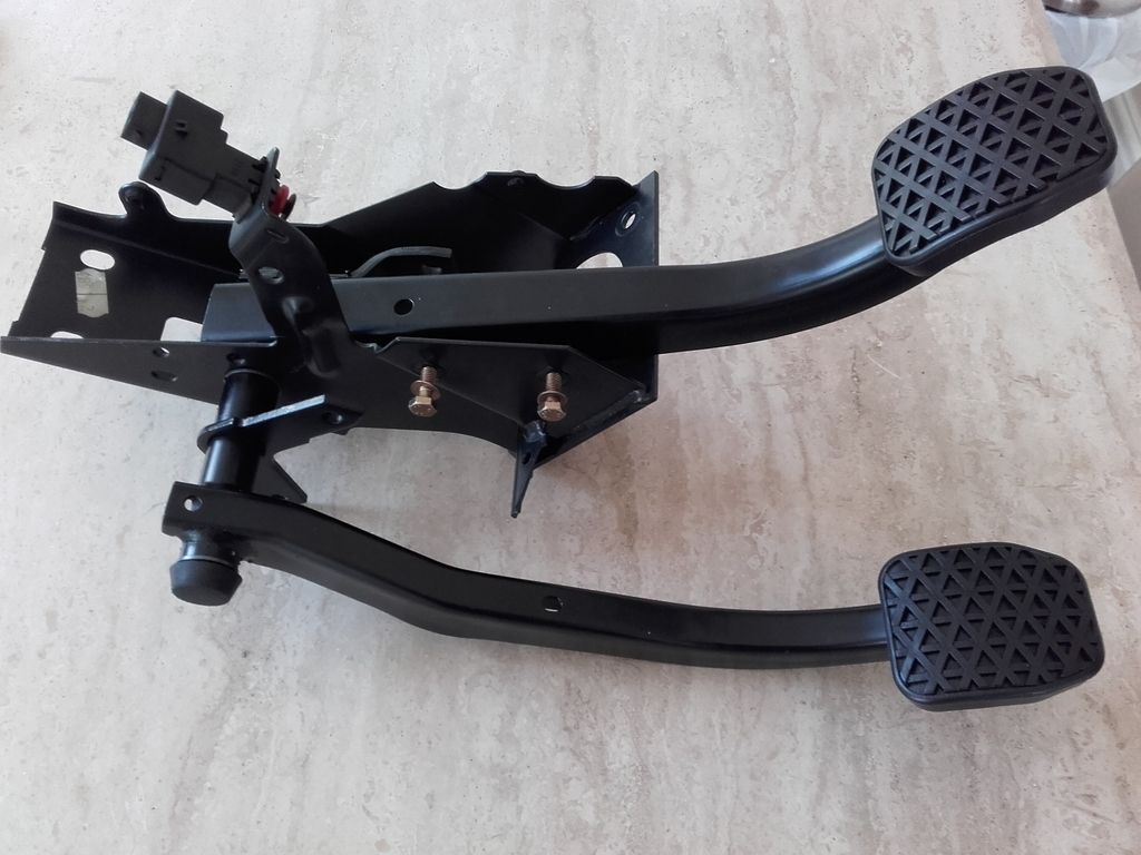

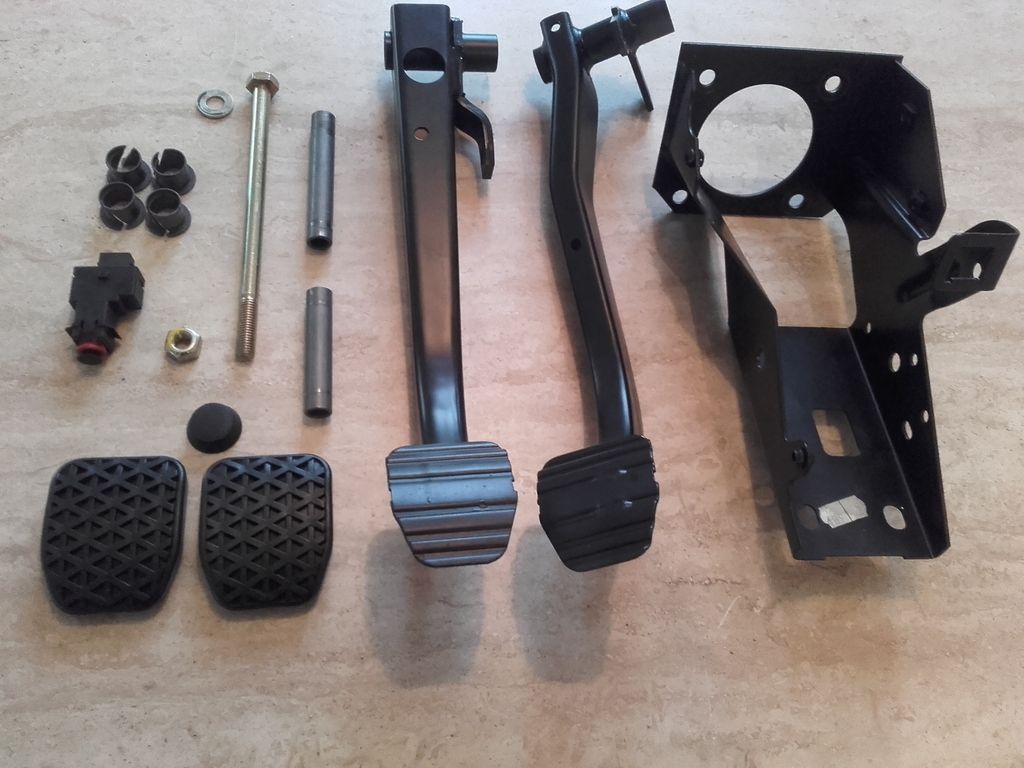

Pedal box has been part for a lick of paint and some new bushings in the pedals and new rubber pads.

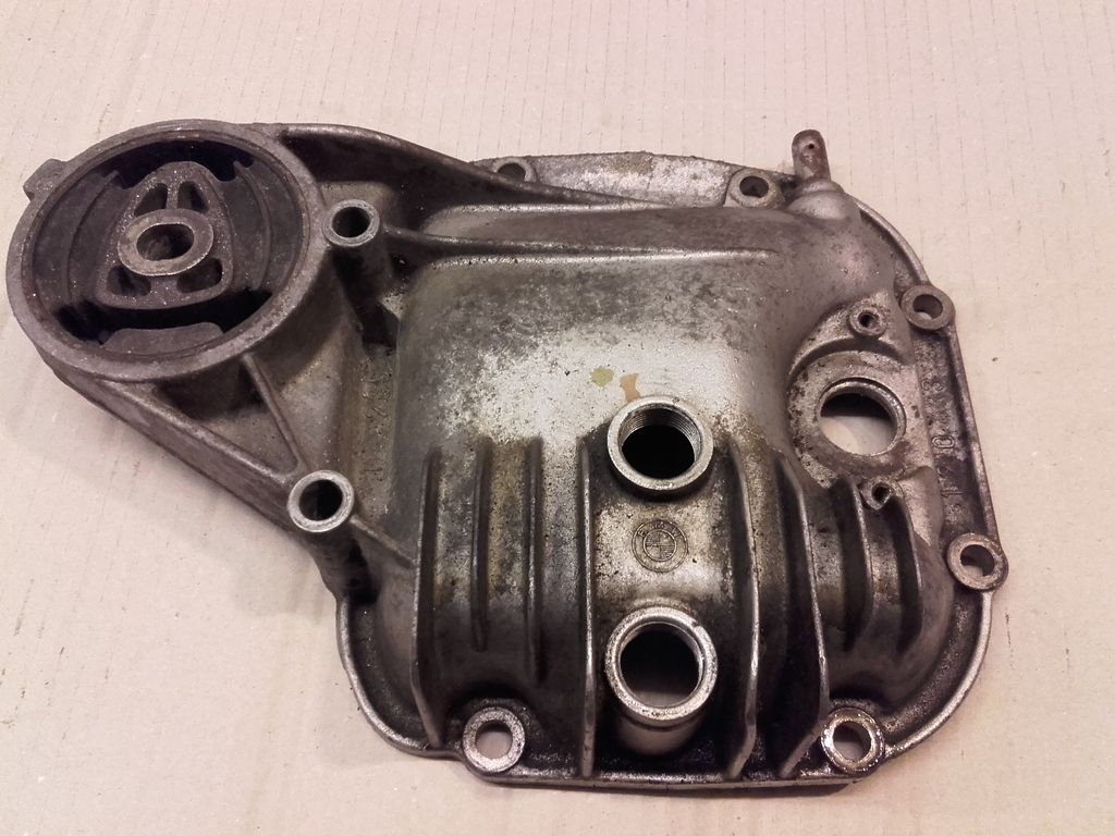

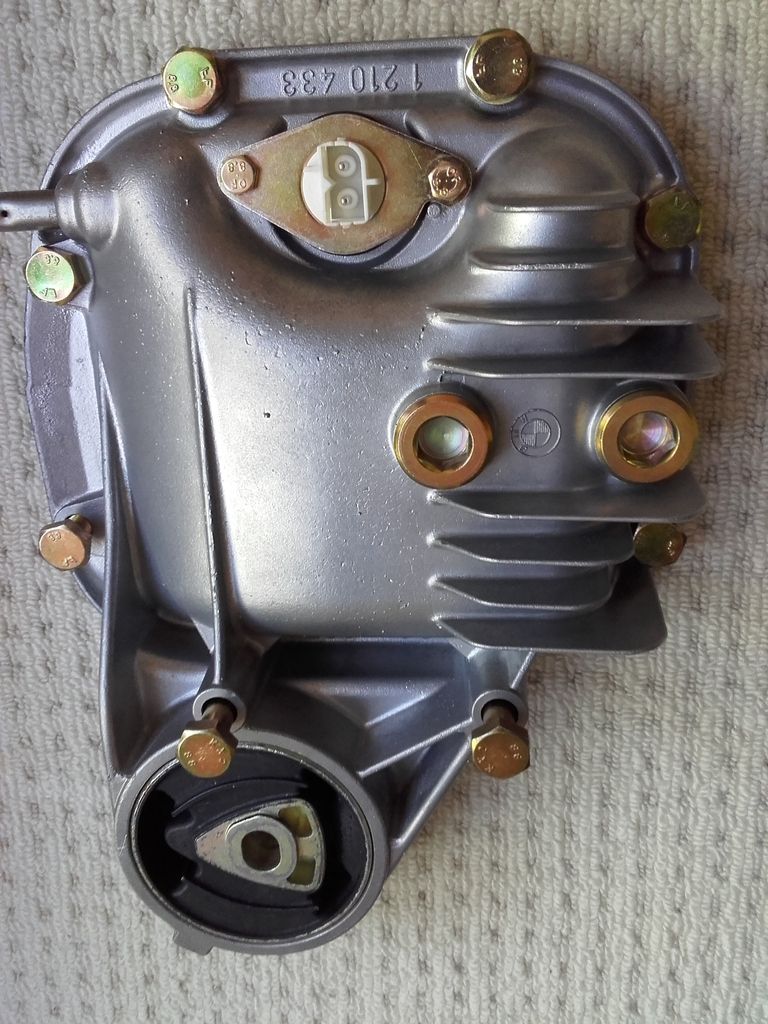

The original diff cover was replaced many years ago with an M Coupe finned cover. I got a replacement and bead blasted that and fitted a new mounting push, speed sensor and had the bolts and drain/fill plugs plated . Just awaiting the correct washers.

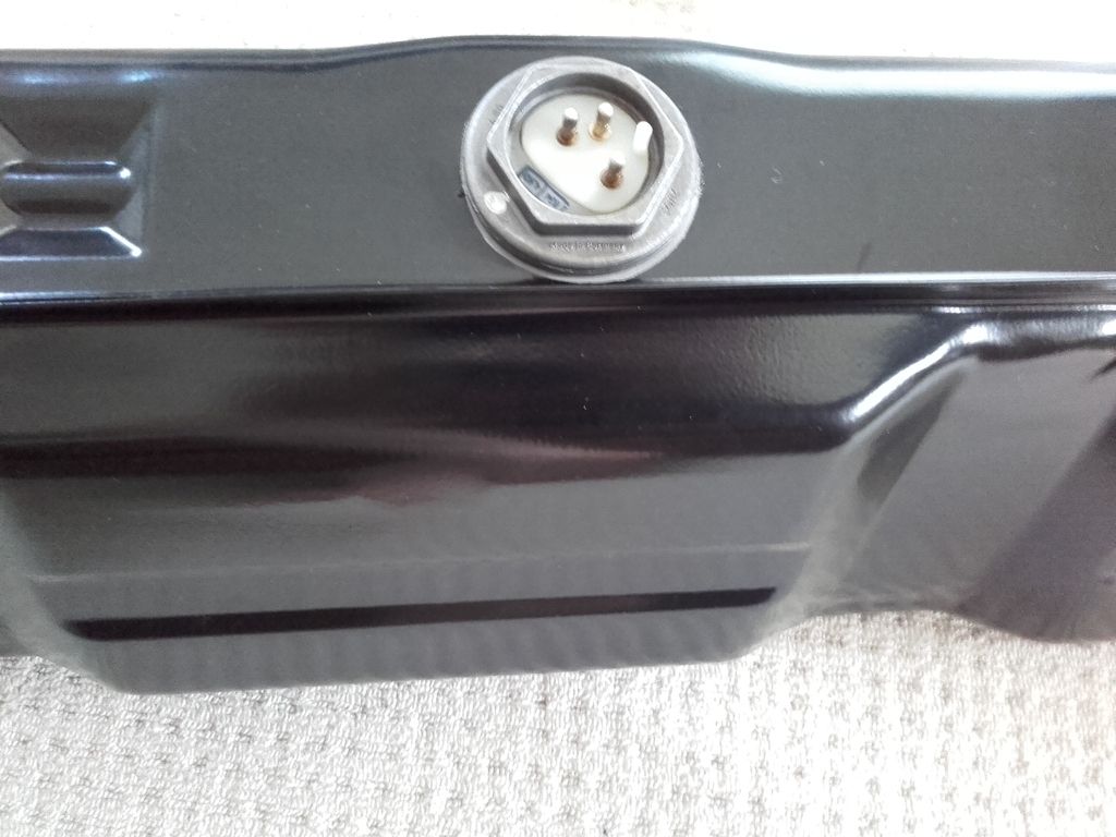

The boot mounted long range fuel was inspected and found ready for powder coating, so thats come back and had the sensor refitted with a new O-ring.
