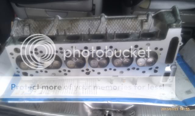

the head passed the pressure test and needed a skim so i'm picking it up tomorrow.
so am i going to need a thicker h/gasket now then ?
it's £70 odd quid from gsf :(

Should be OK with a standard thickness gasket as they will only skim a few thou off.
Mon Jul 22, 2013 10:17 pm
i'm not sure if it's ever been skimmed before and bmw would of taken it off when fitting the steel liner block so they might of re-faced it .
i think i might just have to shell out on the bigger gasket to be safe .

Ask the guys who are skimming it how much they have taken off, the thicker gaskets are generally 10-20% thicker.
Mon Jul 22, 2013 10:42 pm
just spoke with dan after you raised this Neil and he said get the standard one all day :D
cheers mate 8)
Tue Jul 23, 2013 2:57 pm
got the head back today and it's had 12 thou taken off so i need the thicker gasket now .
gasket and head bolts ordered from gsf and a small gasket ordered from bmw for the rear of block heater pipe fitting .
it's all about the block threads now .
