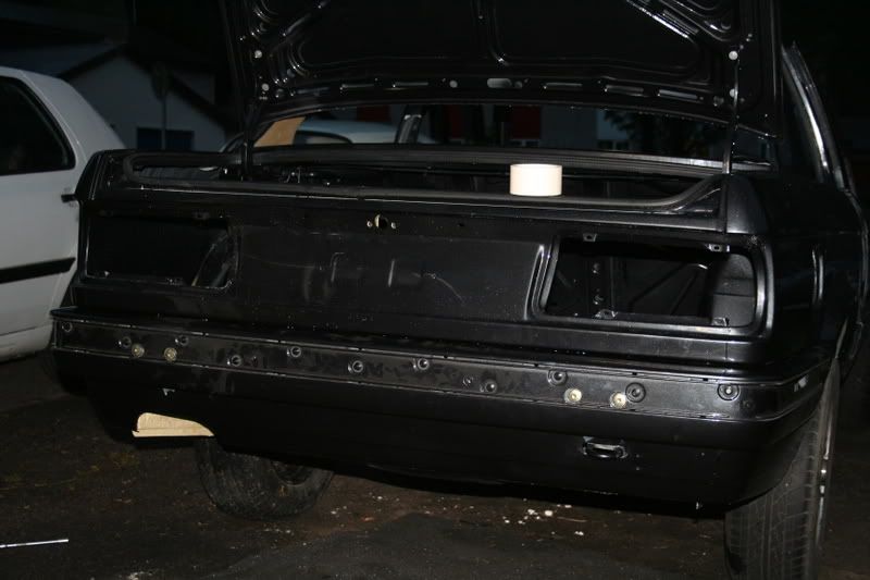

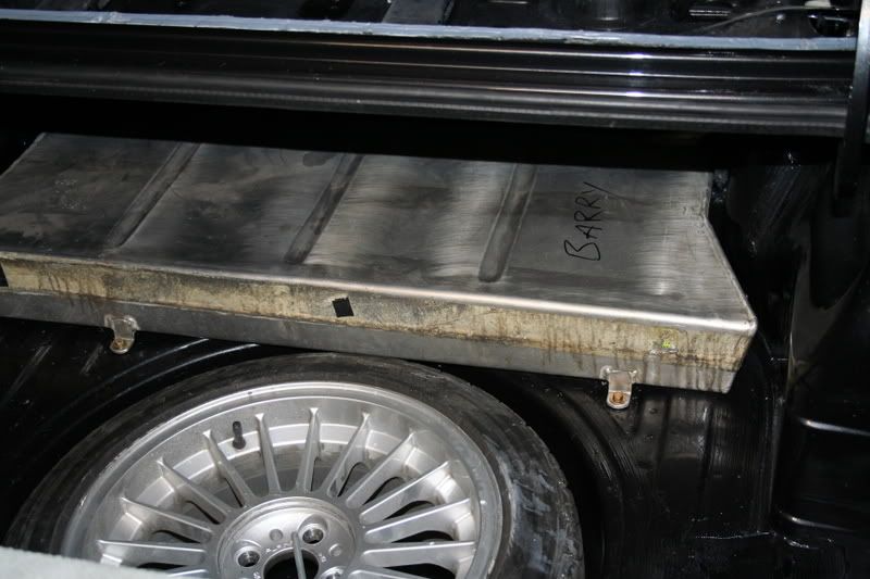

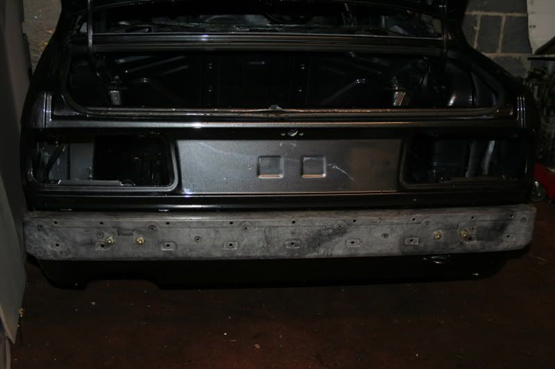

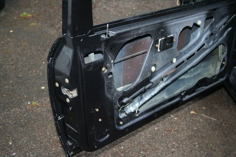

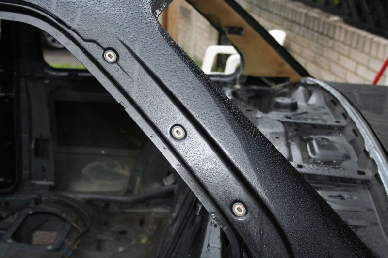

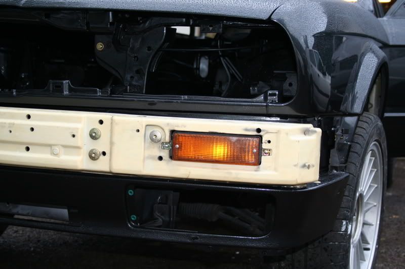

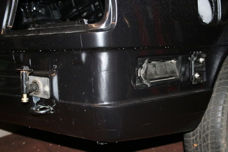

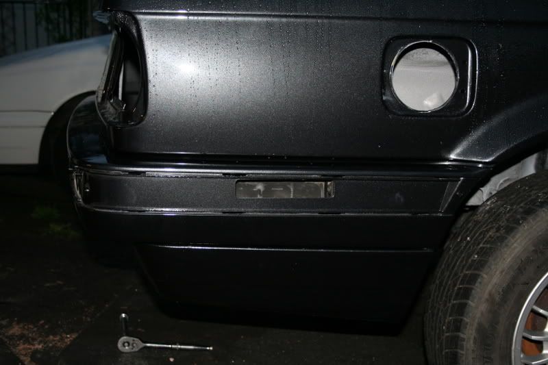

- Posts: 22697
Been at it all week in the evenings for a few hours. This is going to take ages! lol but we are on the home straight right?!
lots of new clips,grommets,nuts and bolts all coming out the play now.
It got wet today as it's going to get wet when it's washed so....well you know
door holds itself shut now, i will do the other side but i've lost a bracket which holds the door handle mechanisim (sp) in place. said part costs 74 from bmw so no major drama. Then i noticed the door latch screws are a bit sad looking so i've got some new ones. They are cheapo non galvanised ones in silver. BMW and their cost cutting
I'm loathed to use them. If anyone has 6 original shiney ones drop me a line!
Rear sunroof drains are connected up after the roof action. I've only put the bumper on for space reasons
Getting the rear bumper together and everything all lined up probably took an hour, but when everything has been apart and the no marks to say whether brackets are in the right place a took a while to get the gaps to the rear quarters as good as i can do.
Alpina long range fuel tank is in only temp. I've had to drill 2 holes in the boot floor for fixing purposes
and there needs to be another in the iiner arch for the breather pipe
I need more bravery for this! the 6mm holes got me in a cold sweat!
So thats where we are at at the moment. One trip to the main dealer already and another list of bits coming along nicely. Loom should be going back in soon when i've got a day to attack it and i've got all the other millions of clips in place. Glad i've taken a load of photos as i can't remember all of it. My memory homoness is serving me well so far though

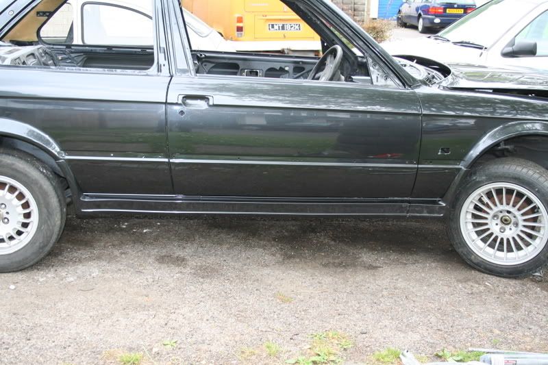

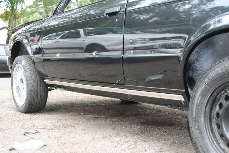

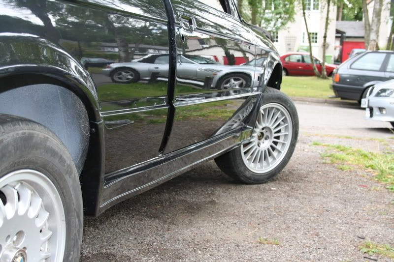

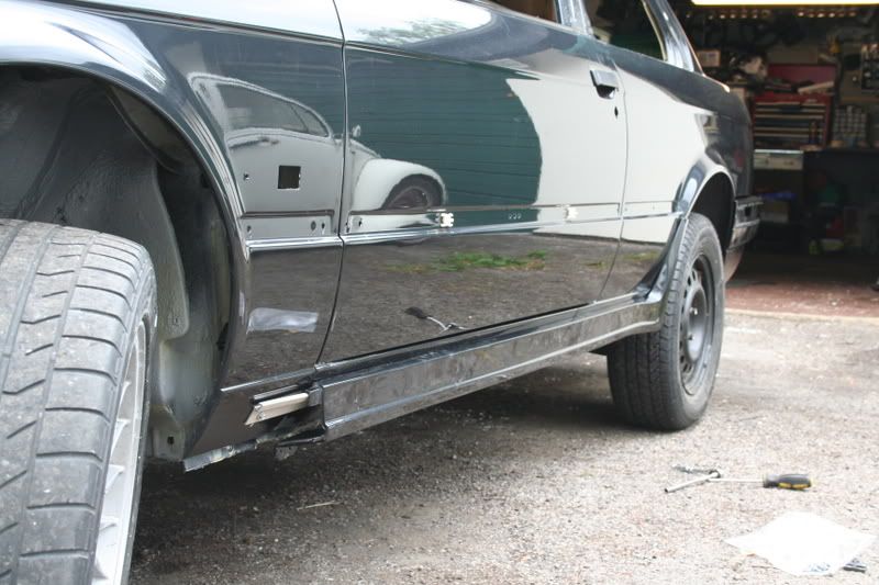

- Posts: 22697
side skirts on today
nice rail with holes all along the sills
not alot of thought went into these when alpina thought these up imo. When i came to strip these off for the paintjob these rails where held on with bloody self tappers. luckily they hadn't let the sills get destroyed by rust. They are full of waxoyl now anyway. I've replaced the self tappers with 8mm bodywork nuts the same as which hold the front wings,valence etc to the car
nice, numberplate screws they used with the black caps, so i've done the same!
finished article, very similar to m-tech 1 sport skirts. Drivers side is better than the passengers, but these are a real pain to fit on straight. When i bought the car i think the apprentice fitted them new as they were on p!ssed.
I shall get the sound deadening this week ordered from bmw so i can get the cars loom back in and really get stuck into it. Going to be a bit tricky getting the hole lot back through that small hole in the bulk head. twas similar getting it out
