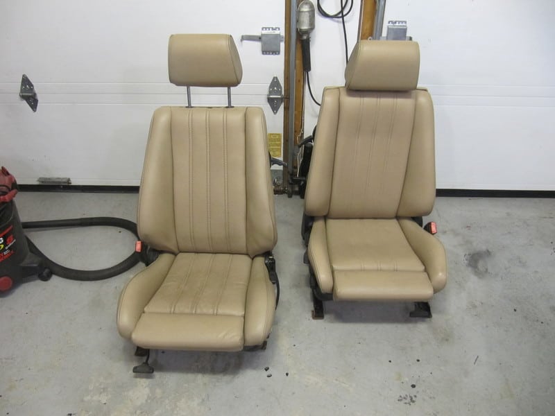

Not to be neglected were the original sport seats seen here in their original tan:

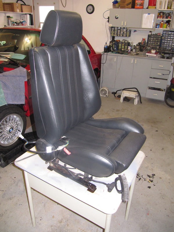

I sent these off to be professionally dyed. Here was the result:
I then removed some rust and repainted the rails.
Very nice and they will match the new black interior nicely!

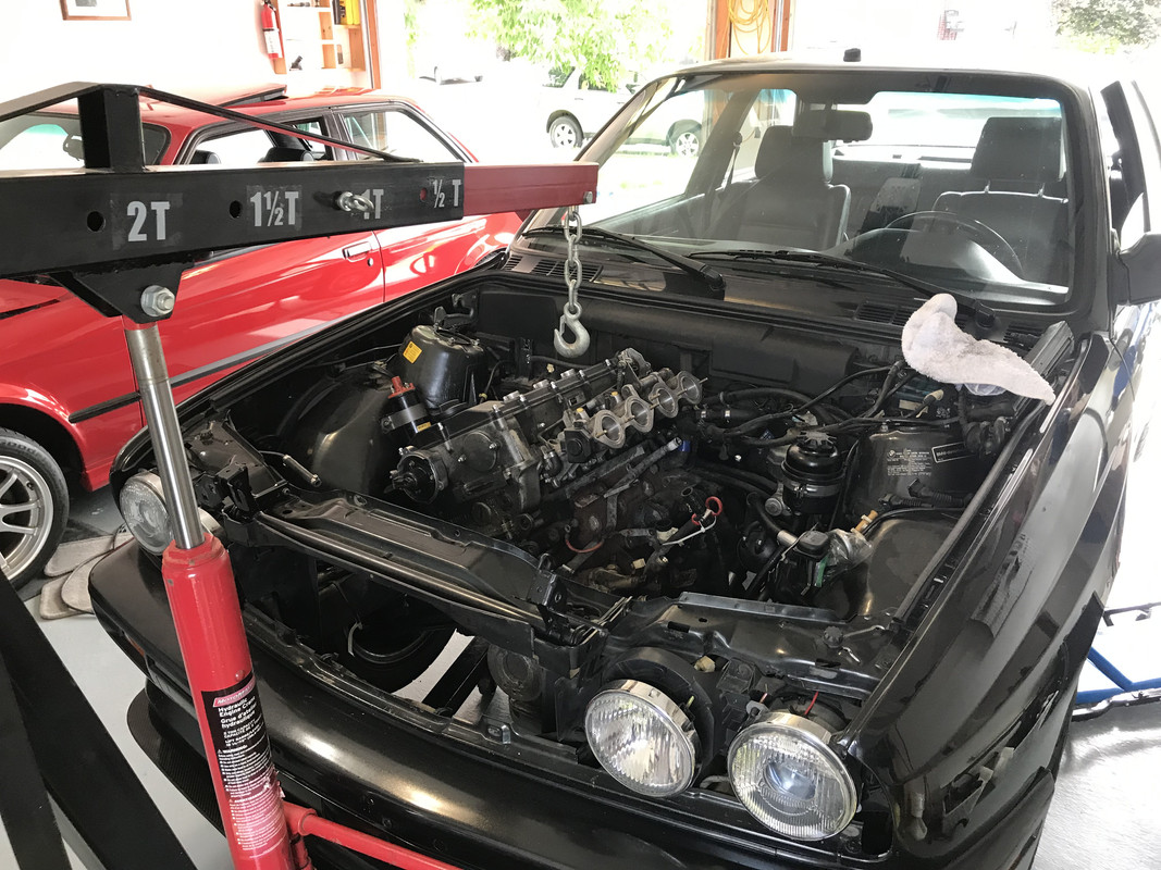

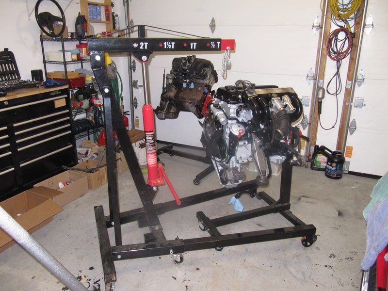

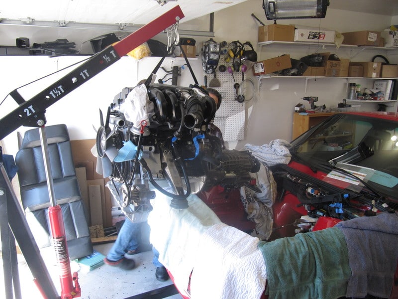

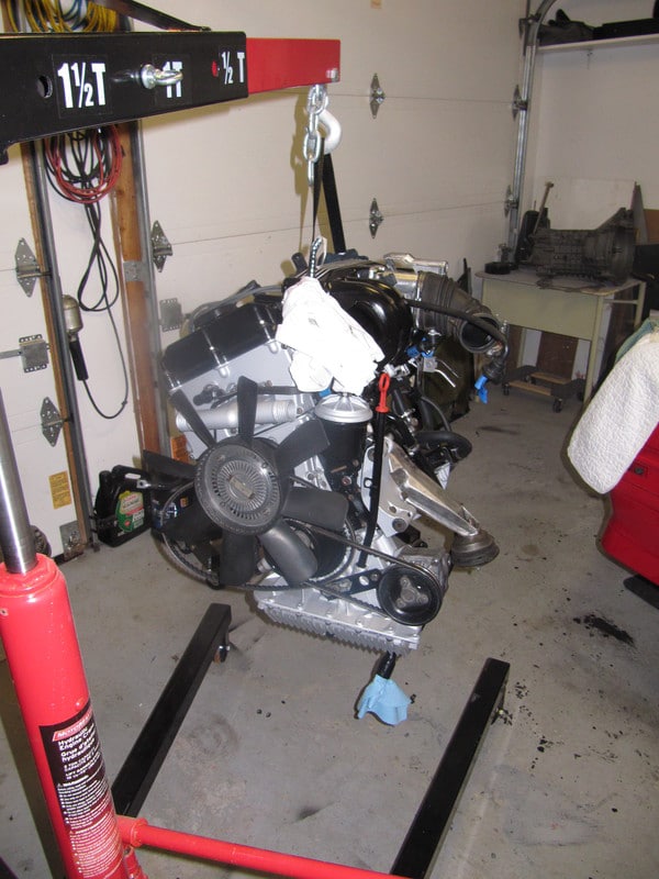

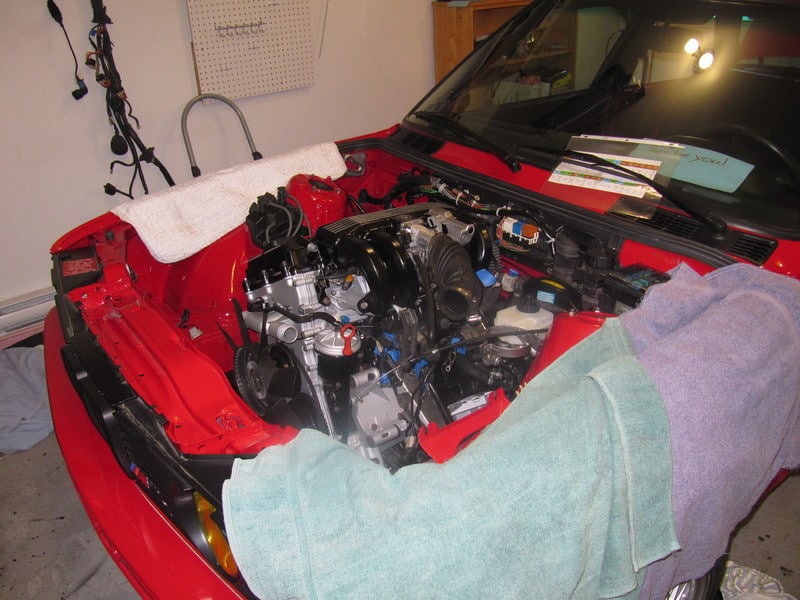

With some days off work the engine was begging to get back in the iS..
Now was the time for any last minute checks - look at all that space in the engine bay!!
Got my buddy's lift:
And wasted no time getting the M42 hooked up..
Done..

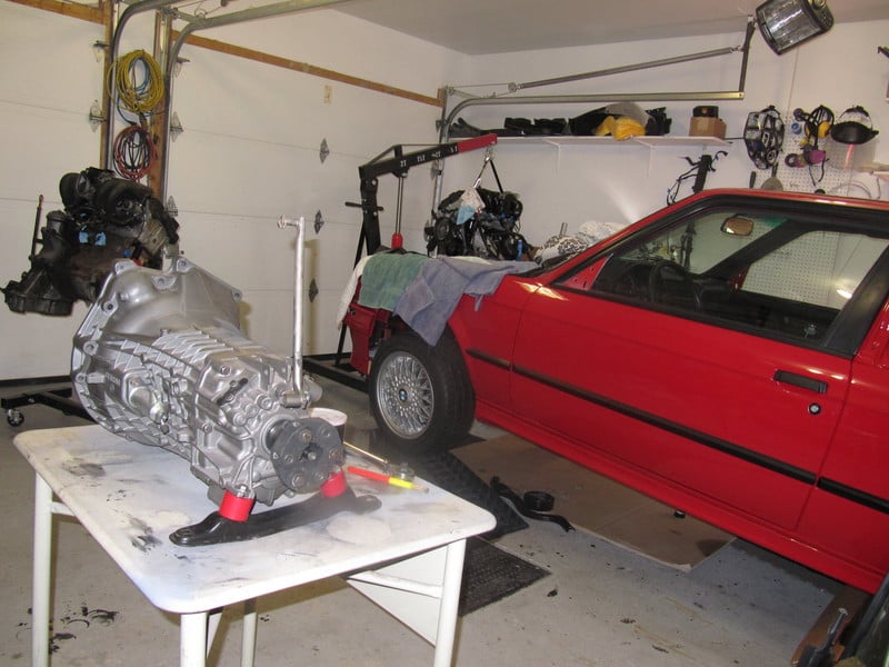

Split_S
POR 15 junkie
Posts: 529
Joined: Sun Jun 16, 2013 11:00 pm
Location: Canada
Post Wed May 04, 2016 10:38 pm

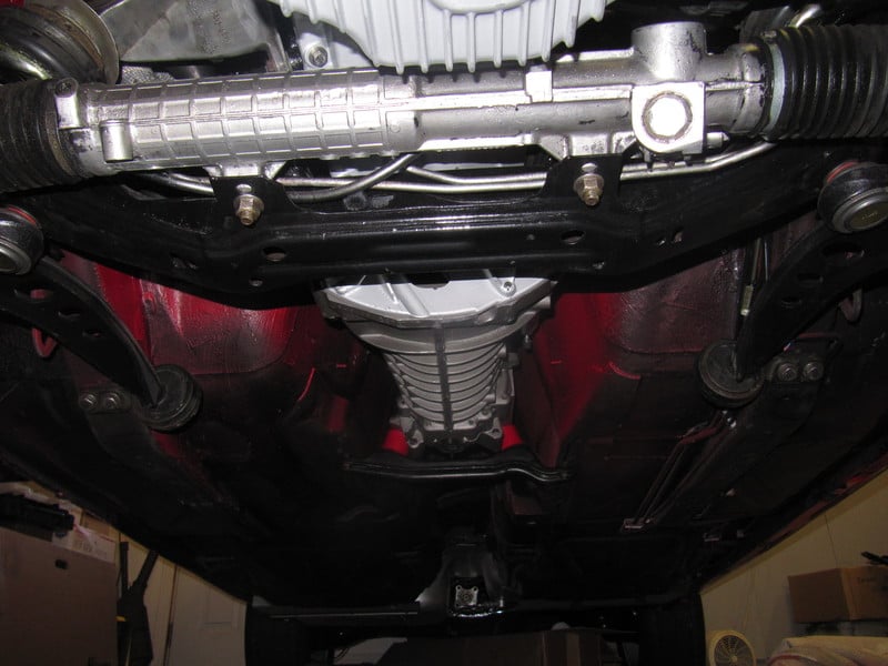

I decided on matting the transmission right away and to avoid having to do it while laying on my back under the car. GOOD DECISION!! It was a B@TCH getting the tranny onto the engine as I didnt have a clutch centering tool to line things up.. Still, it IS doable.
Tranny waiting to get bolted on. Note the car is up on ramps: I figured I would need the extra space to get the tranny through without scraping the floor...
This is not a one-man job. I called my father and my buddy Sam over to help.
With the tranny bolted and torqued on we swung the engine into position:
At this point I stopped taking pics as I was laying under the car guiding the engine in while pushing the transmission into position. It's funny how I realized at that point that I wasn't 20 years old anymore!! :D
The engine needed a good 60 degrees of tilt or so to clear the firewall. It was a slow going finicky process but fairly straight-forward.
DONE:
I don't know about you but I'm starting to think I may just finish this thing!! 8)

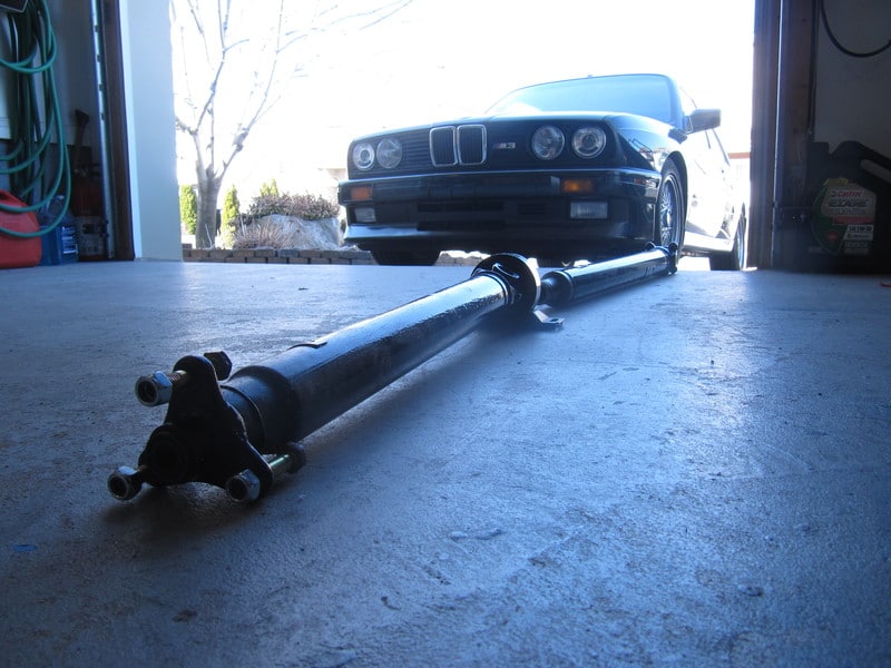

Next up was the driveshaft which wound up being a problem as the two halves wouldnt join up.. I had to file the channels by hand to get them to mate up..Once done though things went well...

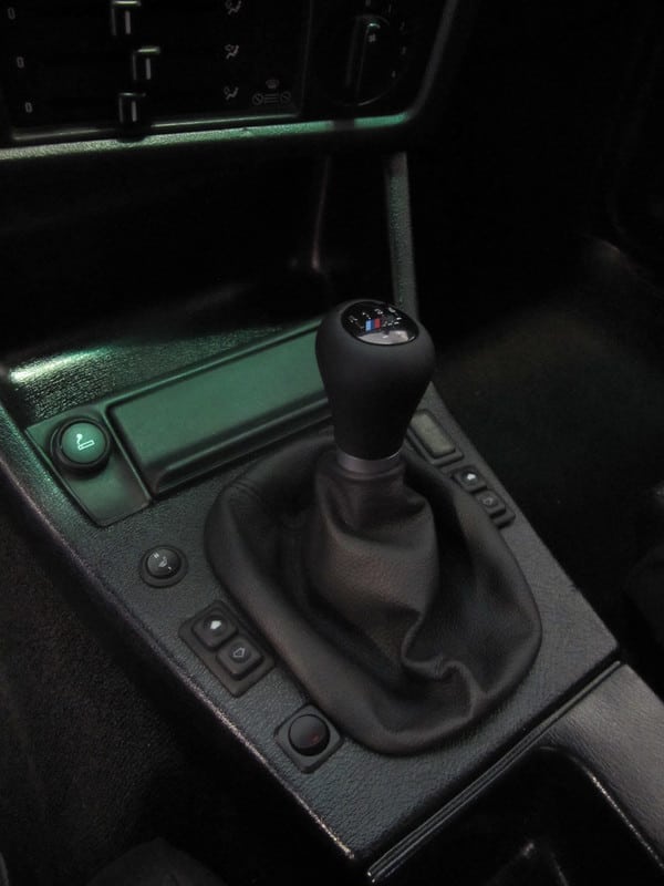

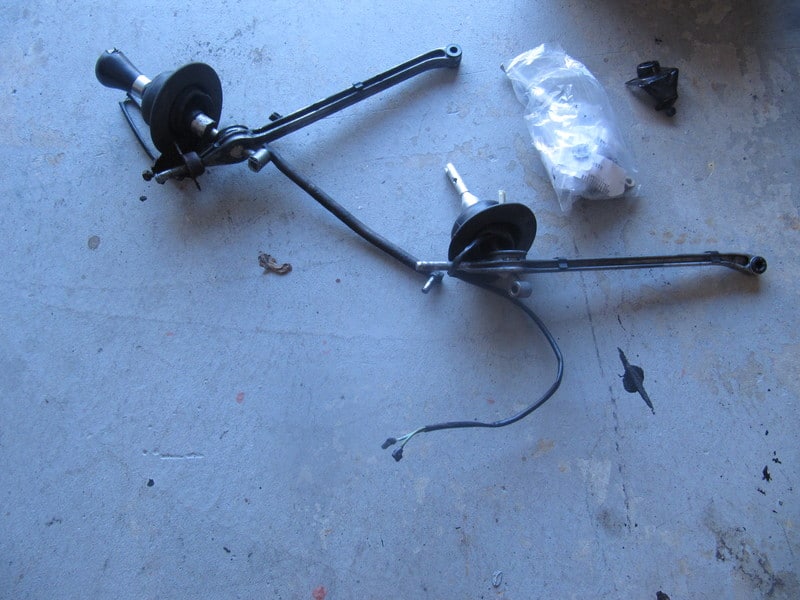

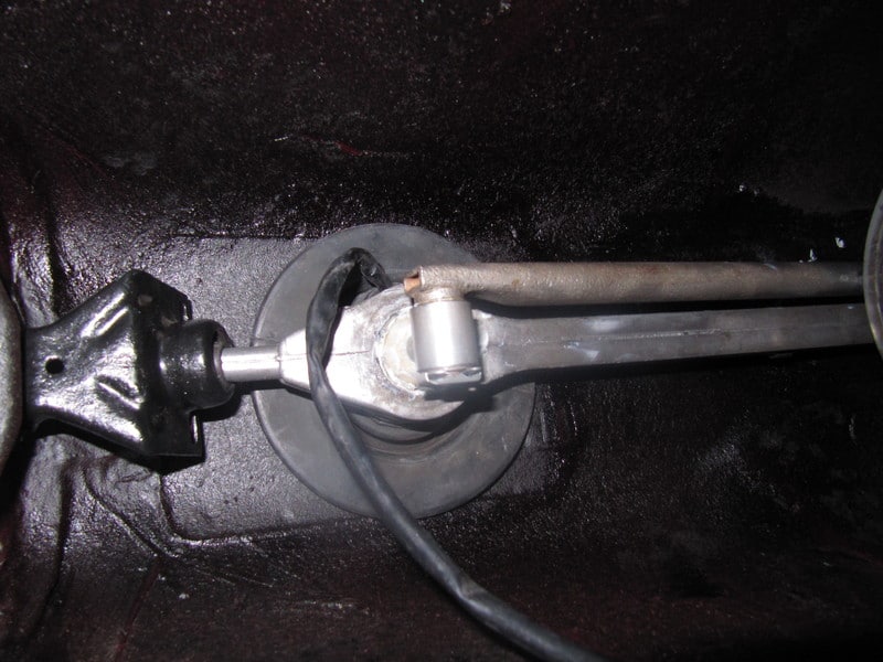

With the driveshaft in I then had to choose from 3 shifters.. I went with the short shifter that was in #2 and kept my Z3 shifter kit for later...
I decided to keep the vibration damper... That would prove to be a mistake as once it was all in there was some slight rubbing and I wound up taking it out..
And the final result... sweet... 8)

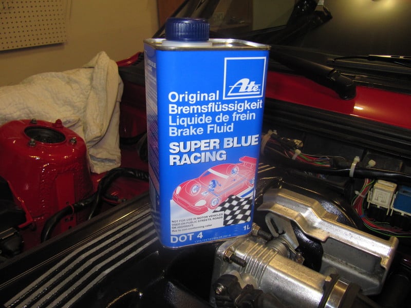

I then bled the brakes using my pressure bleeder which works great...
I put in Super Blue Racing fluid.. why? Who knows... :D

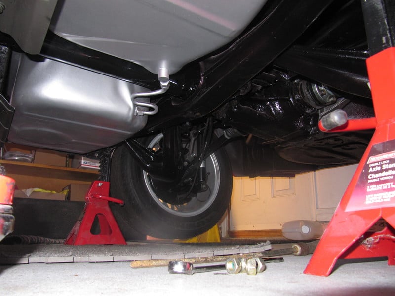

Amazingly I had TWO loose fittings and pissed brake fluid all over the floor. I couldn't believe it! I had double checked everything but I should have TRIPLE checked everything...

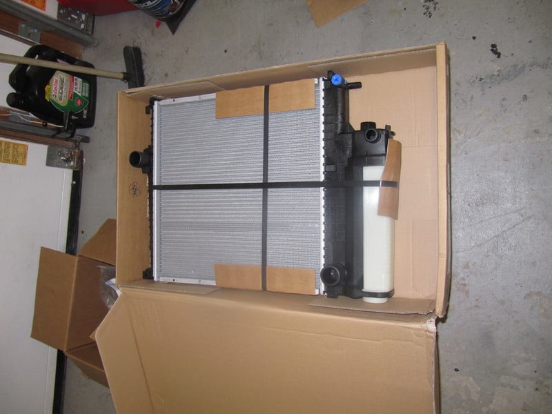

With the brakes and clutch bled I threw the rad in...

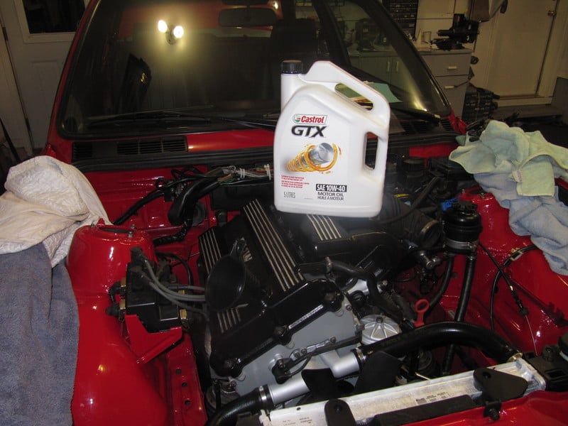

I filled this with EVANS waterless coolant.. No water = no corrosion, lower pressure. ALL good..
Dyno oil for the first few 1000 kms to break in the engine...

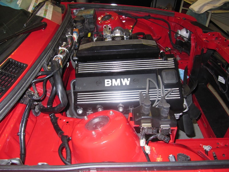

With all that done I started the engine.
NOTHING.
No crank.
NADA.
:eek:
After a full day of searching it wound up being a loose nut on the ground wire on the starter to the solenoid.

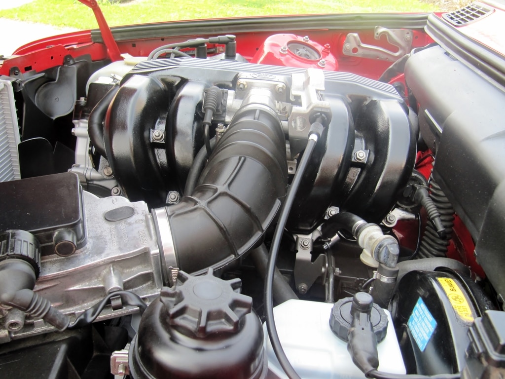

I STARTED it again..
It idled very poorly. It idled better when I disconnected the AFM. Weird.. For two days I struggled with this. Then I remembered the ICV valve.. The one Id totally forgotten to clean... See note 7.
With that done the idle was beautiful!!
Nice, 900rpm steady. 8)

5) Check your rack and pinion for play BEFORE you put the engine back in.. Guess what I have to do now???? :cry:

7) Clean your ICV valve. Use diesel or WD40 to get the carbon out.. Easy to remove if you FORGOT to do it when it was NOT in the car... :roll:

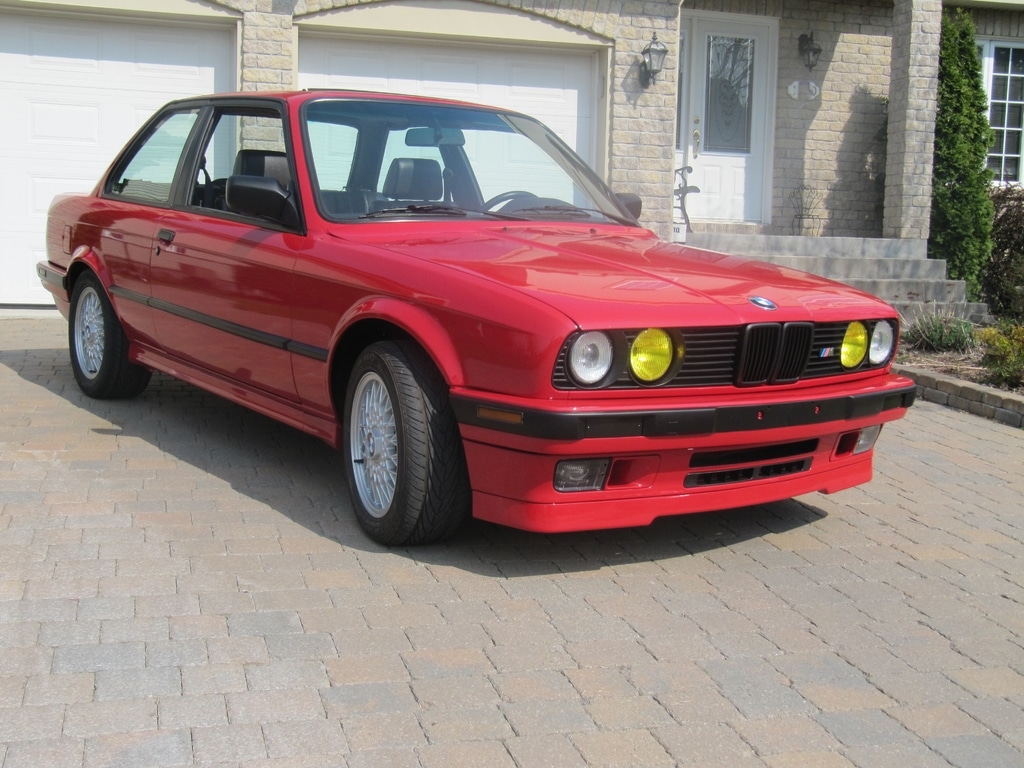

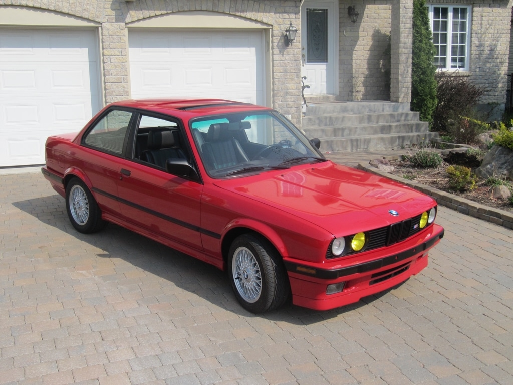

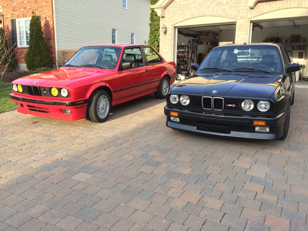

So after almost three years of agony, bliss, moments of terror and confusion, countless bruises, cuts, endless hand washing and tea breaks I humbly present my fully restored 1991 318iS..

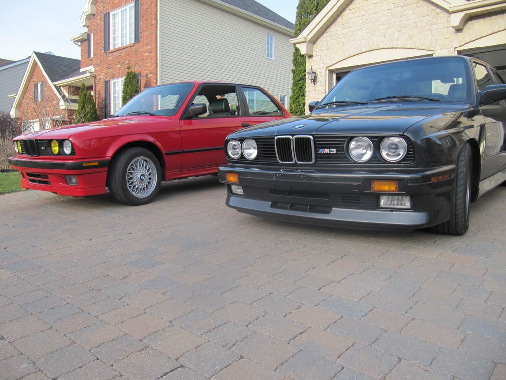

Of course two is better than one...
Cheers and thanks to all who commented and helped get her done! 8)
Hmm..That M3 looks a bit tired beside the iS... maybe I'll pull the engine and get her on a rotisserie .... I wonder if she'd be nice in black and how much a carbon fiber intake costs.......

an epic journey for you and us all who have followed this restoration thread. Well done !! and she looks beautiful from every angle.
My advice , for what it is worth, is forget about the "restoring" the M3 until next year and spend all your spare time out enjoying the iS experience. you will love it.
PS: I finished the makeover, not a full restoration like yours, of mine last month and have put over a thousand miles on it already. fantastic car.
Well done again.
cheers
Jim

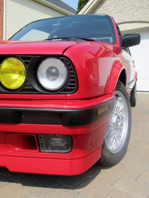

ah: Glad you're an OEM pedo - so am I. I have 3 other kidney grills and swapping them out takes 10 seconds.. The yellow on the lights is simply a vinyl covering, the lights are OEM. I like the look - for now!
DanThe: I have actually been working so much and Ive been stymied by a slight play in the left hand front wheel (9 and 3 oclock positions) that I haven't gotten an alignment done yet - so I have barely driven her. Ive swapped out the tie rod, had the rack rebuilt and now the only thing that's left is the hub is somehow "loose" even though it doesn't have any play with no wheel on...
Ive put these wheels on and there is way less play so I am getting the alignment done today... From what I have experienced driving her however there will be some interesting comparisons to the M3 to come...
Crappy cell phone pics...
I have three other sets of wheels for her so I will have some fun swapping them and seeing what I like.

Car is still perfect... new wheels.. looks good...
Was doing about 120km/hr in this pic.. cool freeze frame effect...
Some fall shots taken a few weeks ago near my home...
the M3 is a bit stripped right now... rebuilding the S14... just because I feel like it....
