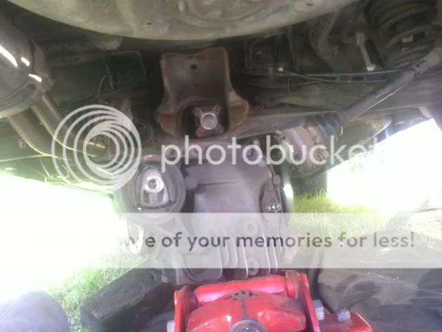

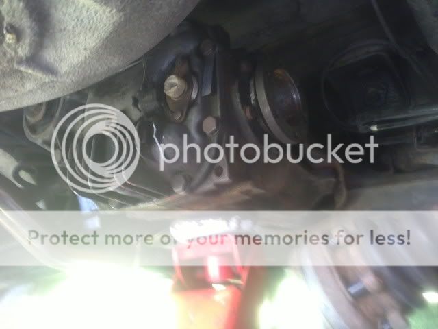

after moving house i found some time today to change the 3.64 lsd which has a whine for another 3.64 lsd that i hope is good with no problems.
some Diffin action !
out ya come.
ooh a £500 note :D
new diff .
need some spade connectors for the speedo plug ^unless [silly thought ?] a 4.10 is the same ??
nearly home, the nice courier man broke a cooling fin :cens:
job jobbed and easier than last time :D .never drove the car to test it yet.[starting doing other smaller jobs]

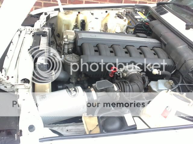

new air intake.need to cut a hole out of the headlight backing cover for it to sit nicely .
there's still some mtech 6-pot springs to go on the front as it's too low and put the strut brace back on.
i bloody well hope that's the diff swapping finished now!

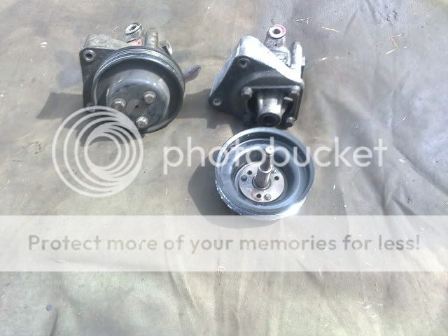

i found out what happened to the power steering 8O
another job sorted and the Diff is good and quiet 8)
it's starting to behave itself @ last!

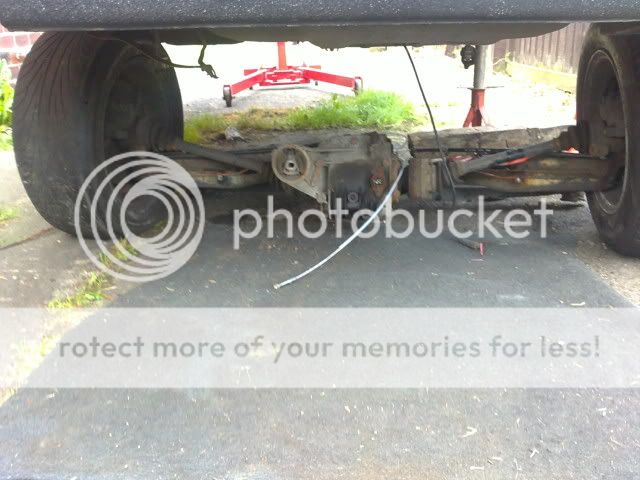

after the pod shenanigans the only way forward i feel is the full arse end rebuild and replace.
i don't want this again :(
the shame of it :o:
and the doner victim ! av it :twisted:
off to mr topless for some guidance in the near future.
resistance ist futile :D

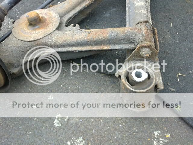

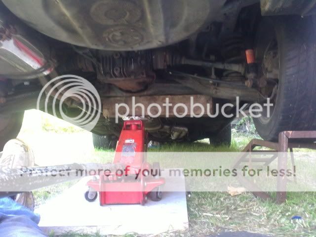

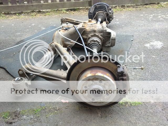

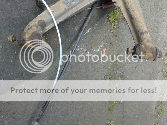

removed the entire arse end from the donor victim today which wasn't too bad but the end parts snapped off still even though they had been replaced not that long ago :(
new discs,one new back plate and a pair of new h/brake cables that came out as they should .
the main part i wanted [good beam bushes] evaded capture though :roll:
looks like new bushes all round now then.
any recommendations for something that's not going to be too harsh and offer a bit of comfort , i've been looking at power flex ?? seems to be yellow or purple ones available what's the difference in these

You don't want any of that junk on your car Mick.
The reason they broke off is you lowered it down in one go. The weight off the trailing arms and diff snap them off. :D
Sun Jul 31, 2011 9:05 pm
more hast less speed :cry:

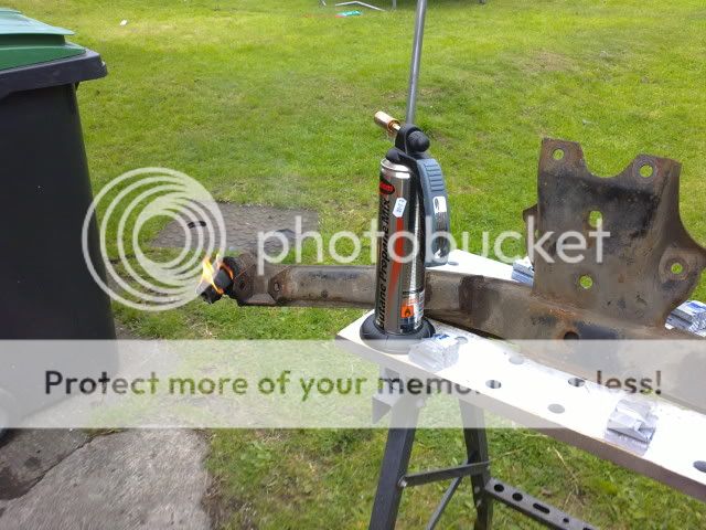

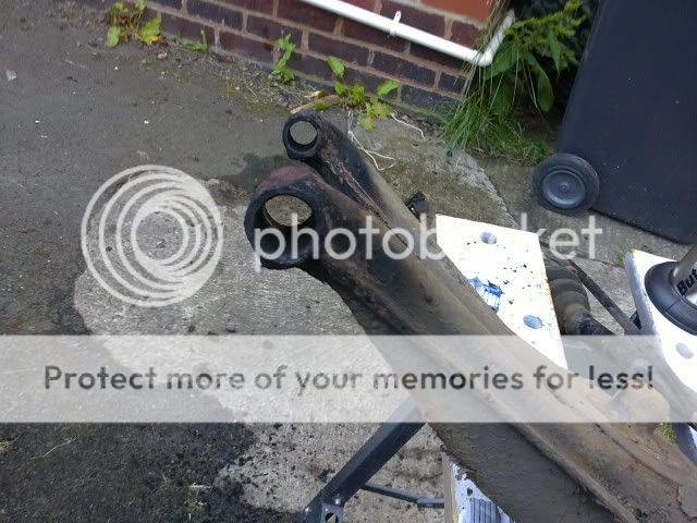

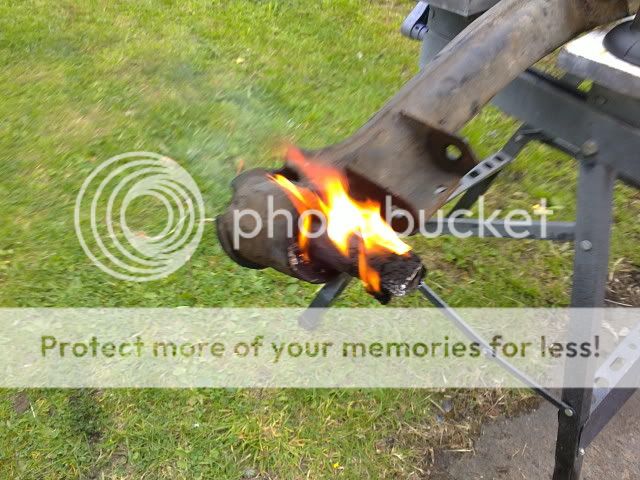

bush removal time :twisted:
watching the metal insert pop out like a turd was a pleasant surprise,i thought it would take longer than it did after 5 mins of burning .
the trailing arms weren't as dramatic,but there out now
dropped the beam off for blasting and primer and collect it around 4.30pm tomorrow all for £10 8O i love the north east me :D
