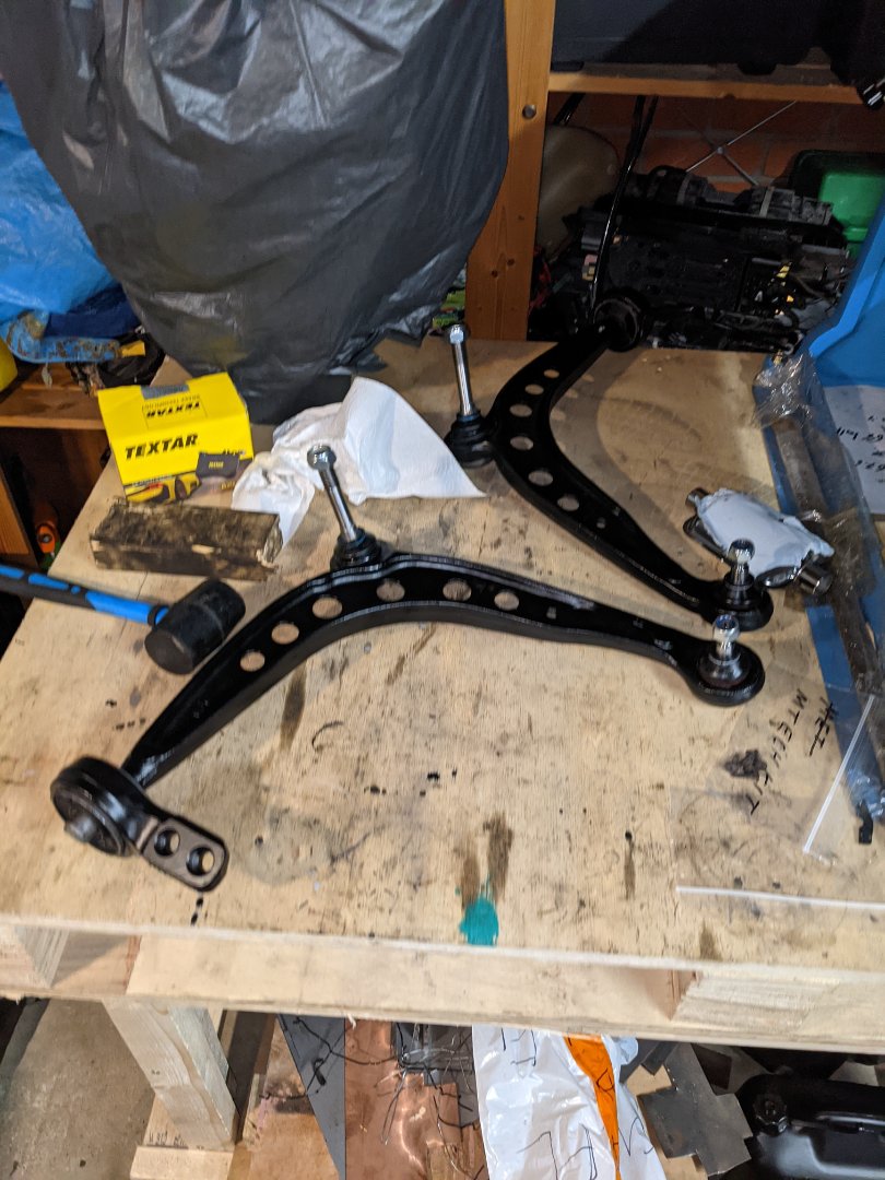

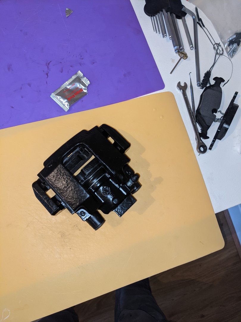

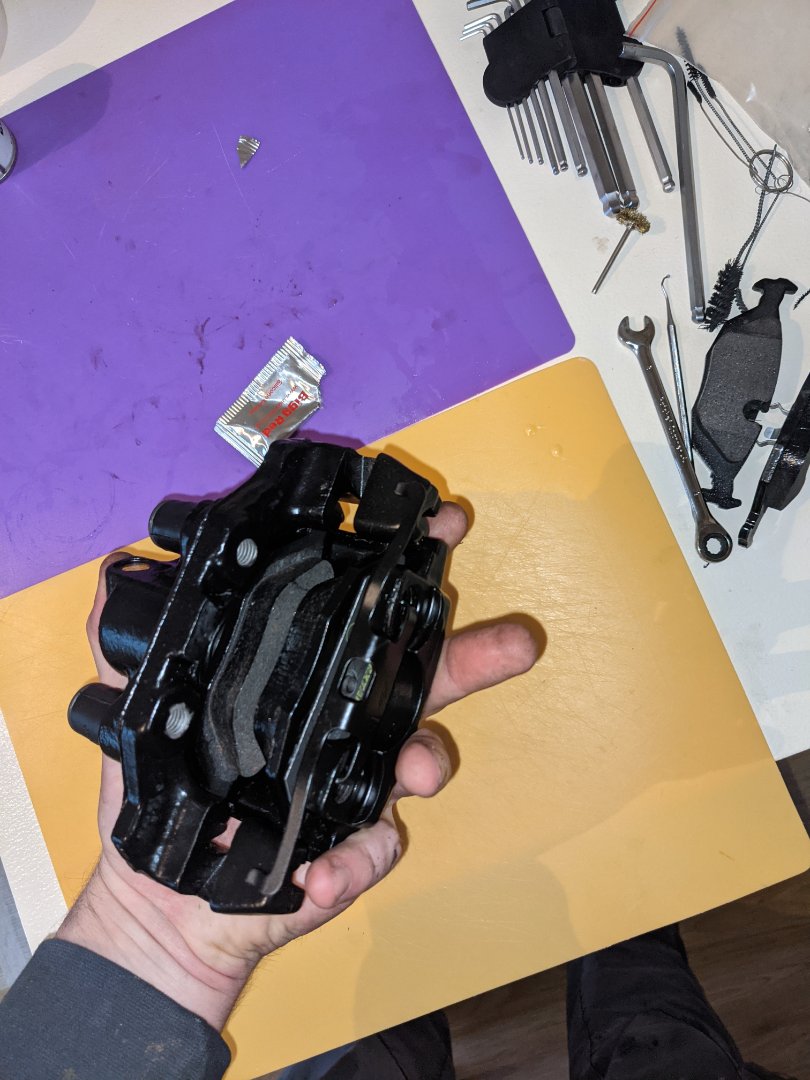

Getting all the parts painted.
I used two coats Jotun jotamastic 87 epoxy primer with their Wintergrade hardener and then one coat of their hardtop hb polyurethane topcoat.
I'll be writing a guide on how to spray these paints effectively as it took quite a lot of experimentation. They are fantastic alternatives to powder coating and if you have a compressor then you can do it cheaply at home.

Looks like a good result. How hard is the finish on that stuff?
I've painted lots of stuff like that in 2k gloss black, looks great but the finish is definitely softer than I'd like.
onthames
- Posts: 615
- Joined: Sun Feb 14, 2021 12:47 am
Hard as nails. It's a marine paint used on ships + oil rigs etc. It's seriously tough stuff

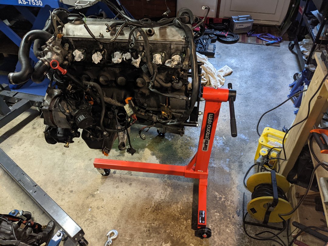

Few photos of some stuff I'm doing
onthames
- Posts: 615
onthames
- Posts: 615
onthames
- Posts: 615
Basically, this has turned into a full blown nut and bolt restoration. I want the car to be the same as it came from the factory, or better/OEM+
