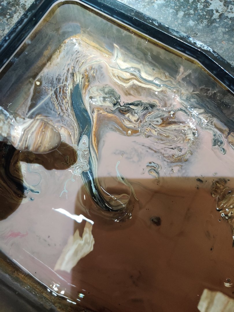

The fairy liquid worked a treat. I flushed it twice with fairy liquid, twice with water and now filled with anti freeze. There was an issue with the automatic transmission. It started making some weird noises. It's not the first time.
So a couple of months ago, I pulled it out of the garage and was working on it in the workshop. When I finished, I went to go and put it back into the garage and halfway in, it lost all drive. No forward or reverse gears. I checked the fluid and it was low on the dipstick, I topped it up to the right level.
Fast forward to last weekend, I was driving it into the workshop and it lost drive. Checked it again and the fluid was low on the dipstick. So I topped it up again and all was well.
Today after doing all the coolant flushed in the workshop, I was reversing it in and it lost drive again. I checked the fluid level and it's way above the normal level. The gearbox was making some weird noises but after switching it off and back on again, that went away.
So right now I'm not too sure what to do with the gearbox. I don't know what the next plan of attack is. I could drain the fluid again but I'm unable to drive the car to get the oil hot enough to clear the torque converter.
Any ideas?

You need to stop the water and gearbox oil mixing!
There must be a leak in the gearbox oil cooler built into the radiator.
I wouldn't run the car until you have made sure that there is no water in the gearbox.
Ben
Ben

Finally got around to changing the transmission fluid and filter. I undid the drain plug and what looks like a strawberry milkshake came out. I took off the pan and there was atleast a few cm of sludge on the bottom so I'm glad I did remove it. New seal and filter in place. The transmission is shifting a lot better, no more nasty noises as of yet. The magnets did have some gritty material on it so I'm not sure how bad it's worn inside. I don't think the filter has been changed before.
We'll have to get it out for a drive at some point to get the fluid up to temp and do a flush. It took about 3 litres to fill.

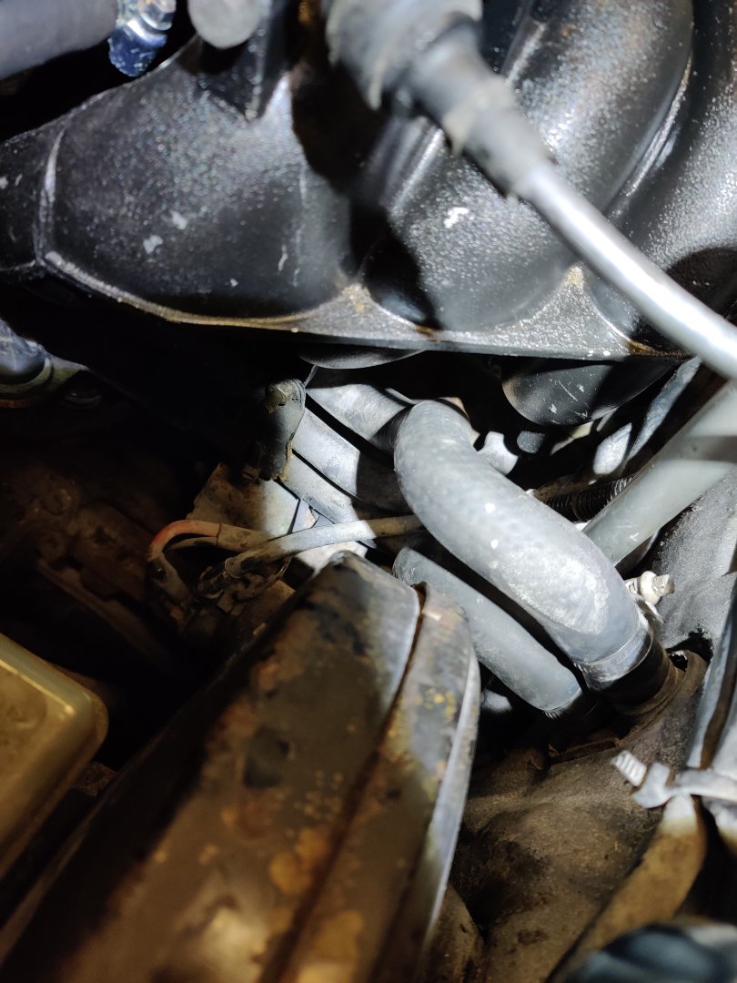

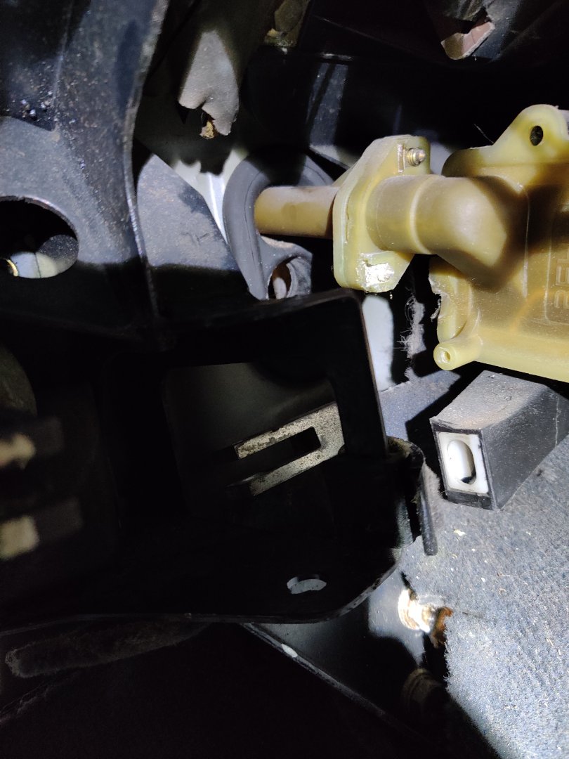

This weekend I wanted to get the heater matrix reconnected and hopefully leak free. I need to order a heater resistor as well as it only works on the highest fan setting. I started pulling the interior out, I found the immobilizer and that the majority of it was disconnected so that became my first priority. Everything is out on the passenger side. The main bundle of wires goes behind the cluster so I'll pull that out tomorrow.
After looking at the temp valve, that's the source of the leak as its rusty and in bad shape. So after the immobilizer is out, I'll pull the temp valve and attempt to rebuild it with a new o ring. Hopefully that will cure my leak and I'll be able to reconnect the heater.

Top tip before undoing the heater pipes inside, undo both pipes in the engine bay and blow an air line down one to get as much out engine side before removing pipes inside.

I got the pipe with the valve out, I was trying to undo the other pipe but can't seem to get anything on it as the bolts are on the other side. Any tips, I'm at the point where I'm thinking to leave the matrix, I have spent a little while trying to get that out. I had to remove the brake pivot to get to the Phillips screw. I'm sorting out the valve at the moment and I'll try once more with the bolts holding the other pipe in.
Any ideas

Couldn't find anything in the WIKI about replacement but this is on R3V

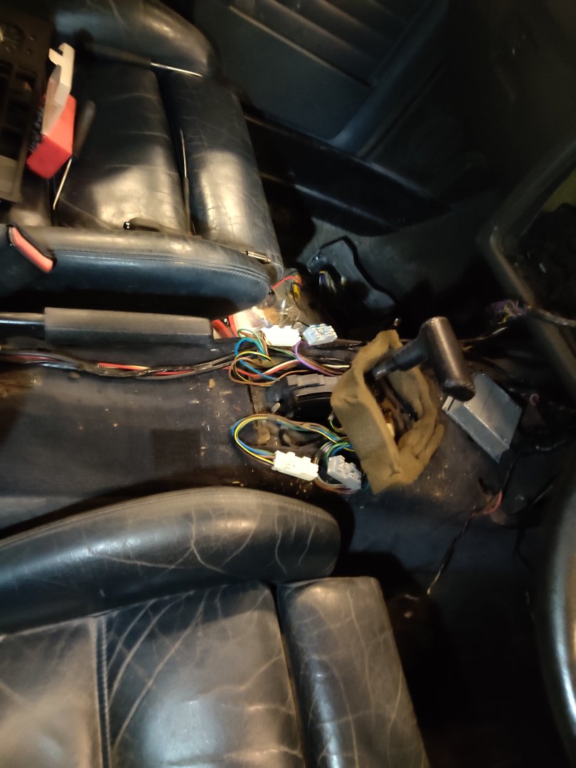

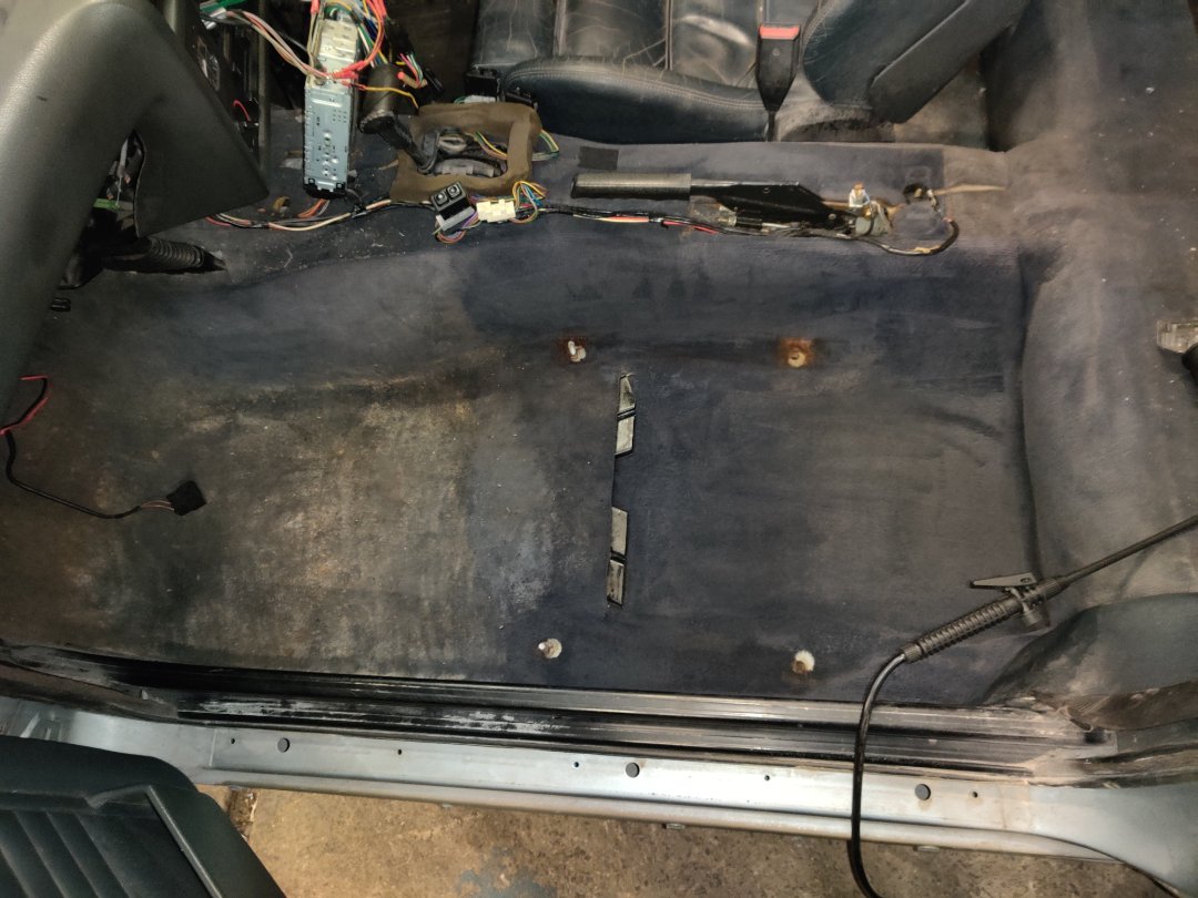

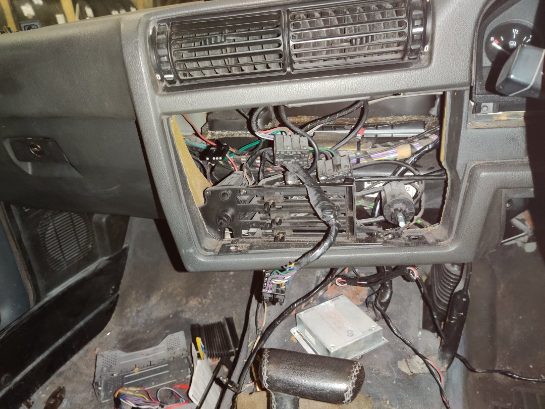

I removed what was left of the immobilizer, there were some wires going to the central locking module which I removed and found that a lot of the wires had been joined by crimp connectors. It seems like someone cut the loom and decided to crimp it all back together or at least that's what it looks like. There are 2 connectors that aren't connected to anything, a previous owner changed the speakers and ran his own speaker wire from the headunit so could these be for the speakers. Another good thing out of this weekend is that all my windows are working, it was the passenger side switches that are not working. I've read that they are common issues and they just need a clean inside. So that's another job to do.

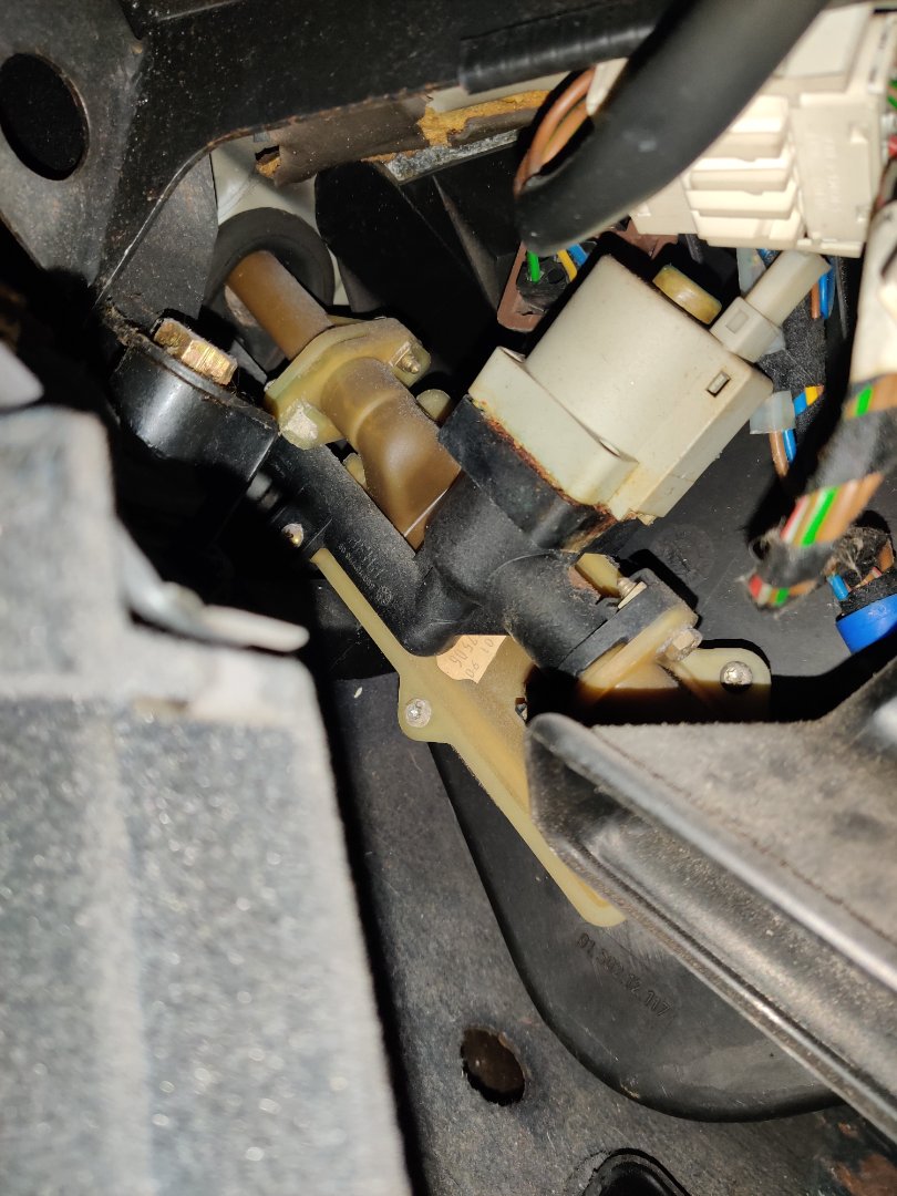

So today I got the valve back together and the new heater matrix fitted. I reconnected the coolant lines but the top line was not getting warm. The engine temp did climb above the halfway mark and I shut it off. I was bleeding it repeatedly. After reading another forum post, I read about an air lock in the cylinder head and a post from Brian about loosening the top heater core pipe, removing the filler cap and blowing into the overflow pipe. I'll try that tomorrow and see if we get any heat. The engine got up to temp but no warmth in the car. The lower pipe was hot but the upper pipe was still cold.
A lot of bits had to be removed to get the matrix out. I'll put it all back together once I've got the heater working as it should. There are no leaks anymore. All the o rings were replaced.

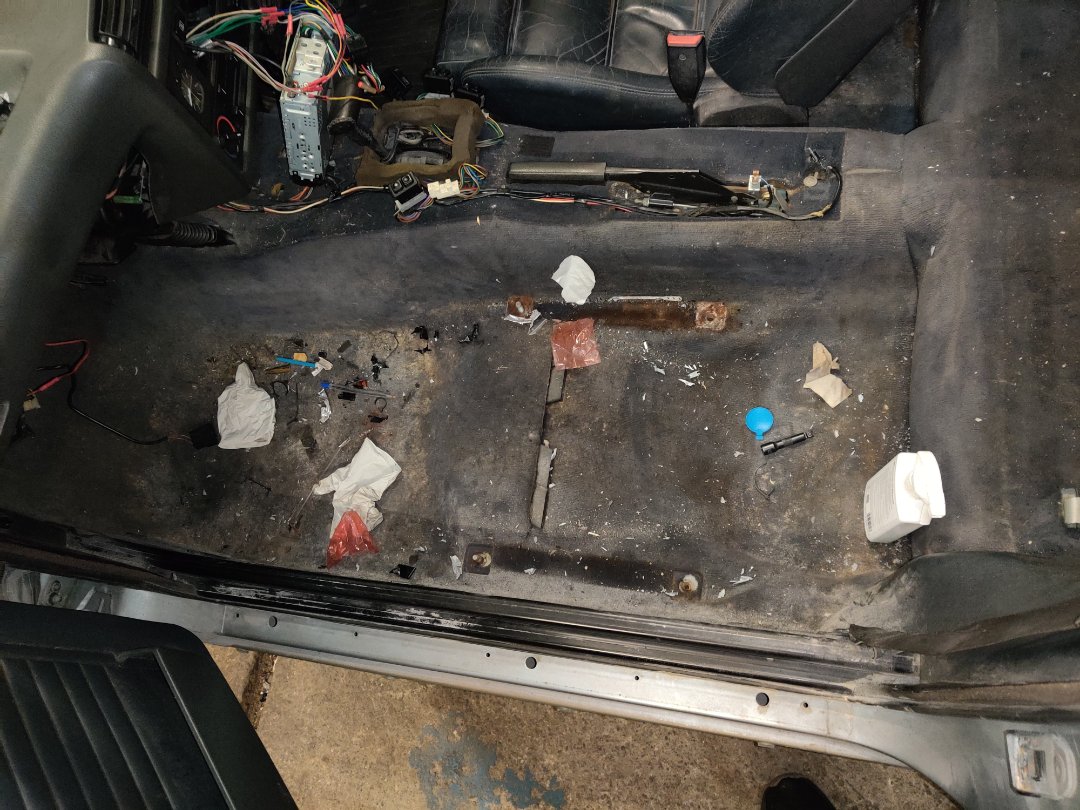

I replaced everything that i removed yesterday. Apart from the glovebox and centre console. The heater is now working properly. I opened the blower motor box and found it full of bones and rubbish so I'm guessing a rodent made it their home for a little while. Once clean I sprayed some WD-40 on the motor and it sounded a whole lot better than before. I think the resistor doesn't need changing right now as it works on all speeds.
The only things that are not working or I haven't looked into are the horn, interior dome light and front fog lights.

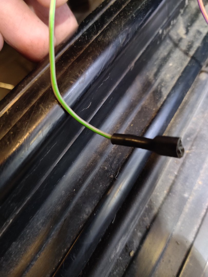

I need to buy a new connector for the coolant sensor as one of the wires came off and the connector crumbled to pieces.
The ABS light made an appearance and was on when I shut the car down. I will be renewing the brakes and components before I get it on the road so I'm not too worried about that but I'm thinking it might have something to do with me moving the brake booster around while I was pulling the heater matrix.
Really all it needs is for the interior to be stripped before paint. The guy still hasn't come to give me a price but we'll see. I may have another project on the way soon.

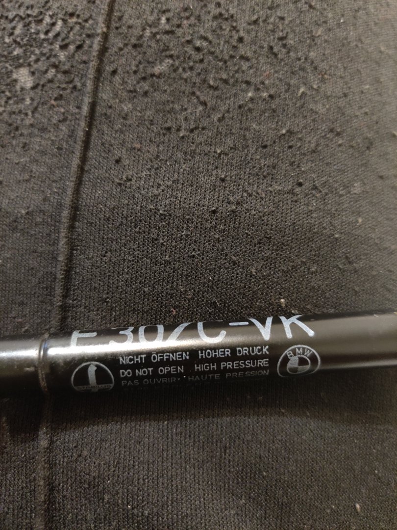

The horse shoe struts were a bit of a disaster for me. I chose to buy new ones from Amazon instead of trying to get the originals re-gassed - unfortunately every set I ordered turned out to be a slightly different size. I now have the two originals and a further four new ones that don't fit

I've seen some stabilus struts on autodoc I think. 20 quid each and the OEM was a stabilus one also. So I've contacted SGS about then, if they can't regas them I'll probably just go for the new ones.

I took the back seats out to check out the rear demister but didn't go any further, I just cleaned it all up. There's an audio and power cable going into the boot so I think there's a sub in there behind the boot lining so that needs taking out.

I spent today removing the interior and cleaning the carpet. I did want to do some wiring also. Removing the crimp connectors on the radio and the central locking module and soldering some wire in but it got a little late so that's for next week.

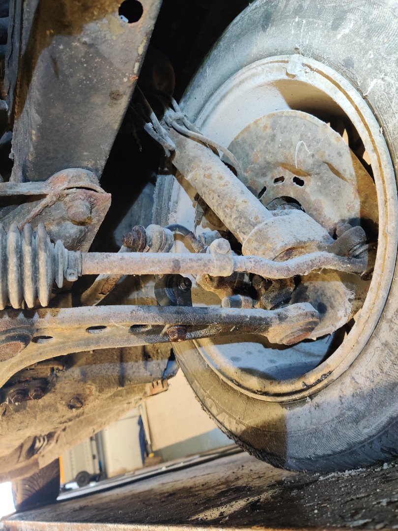

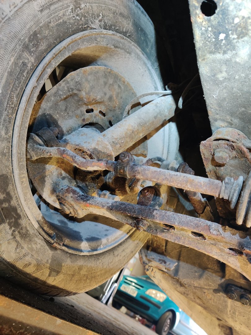

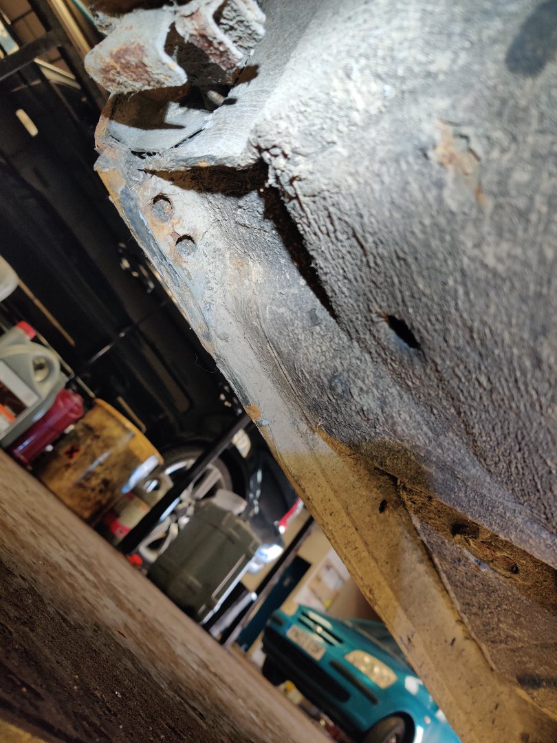

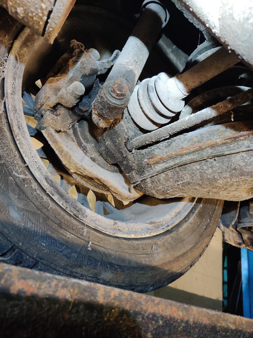

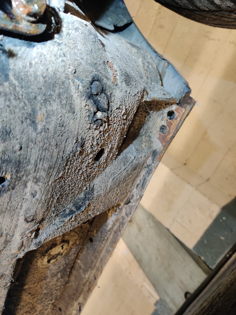

Had a good look around underneath today, there very little rust, it had been undercoated previously and it has held up pretty well. There are some areas where there is some surface rust and others where moisture has got under the coating and caused it to rust a little. But overall pretty decent underneath.
I put WD-40 on all the front and rear suspension nuts and bolts in preparation for when I start to refresh it all. Control arms really need to be sand blasted and then repainted as they are quite crusty. There is a huge layer of dirt on the underneath but it's kept the rust at bay.
