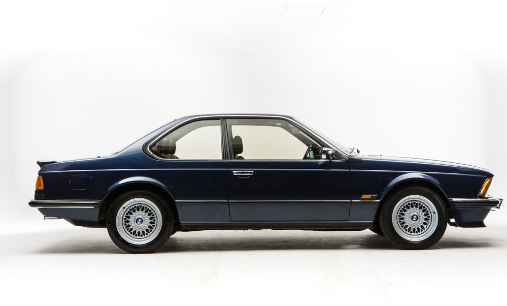

Agreed but there lies the problem, cathing up. To do a proper job (like Split_S's list few posts below) you'll easily pay what i payed for a twice as economical '98 Hyundai Excel which lasted 4 years of daily driving without a single penny spent. Thinking of it i might have changed the oil & filter once. But yes, once sorted though that road with e30 won't disappointBrianmoooore wrote: get yourself a good one, catch up on the maintenance, and an E30 will be the most reliable car you can own and the cheapest to run. Certainly more reliable and cheaper to run than any modern stuff.
You include BMW in that?Split_S wrote:Plus there simply isn't anything out there that looks even half as good.
All 80's Beemers are gorgeous imo and if i had the luxery of beeing able to own 3 cars it would be my current e30 (wouldn't be able to trade for M3 for emotional reasons) and these 2
