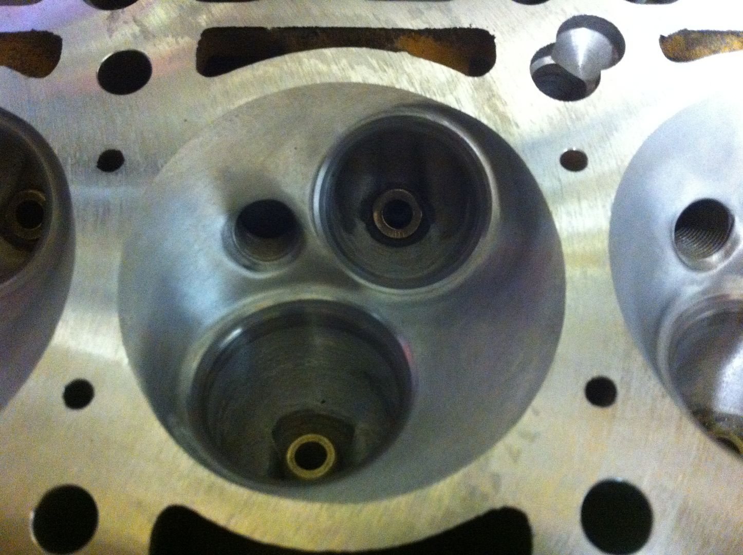

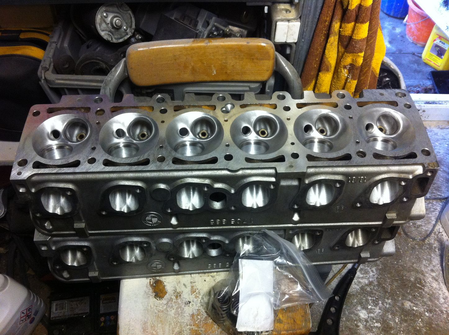

Check it out, the headwork has been done! hemi style chambers now ala Alpina stylee. We are back in business, kind of as my Dad STILL has the pistons. Only 6 months now but good things come to those who wait ya?
A massive thanks to jon bmw for sorting this out down at the engine room in the dark depths of the Janspeed workshops. I've forgot mateys name who did the work
but a massive public thankyou for it. It looks a nicer job in my eyes to the last head
This head is fullyoverhauled in my eyes and ready to go now at last

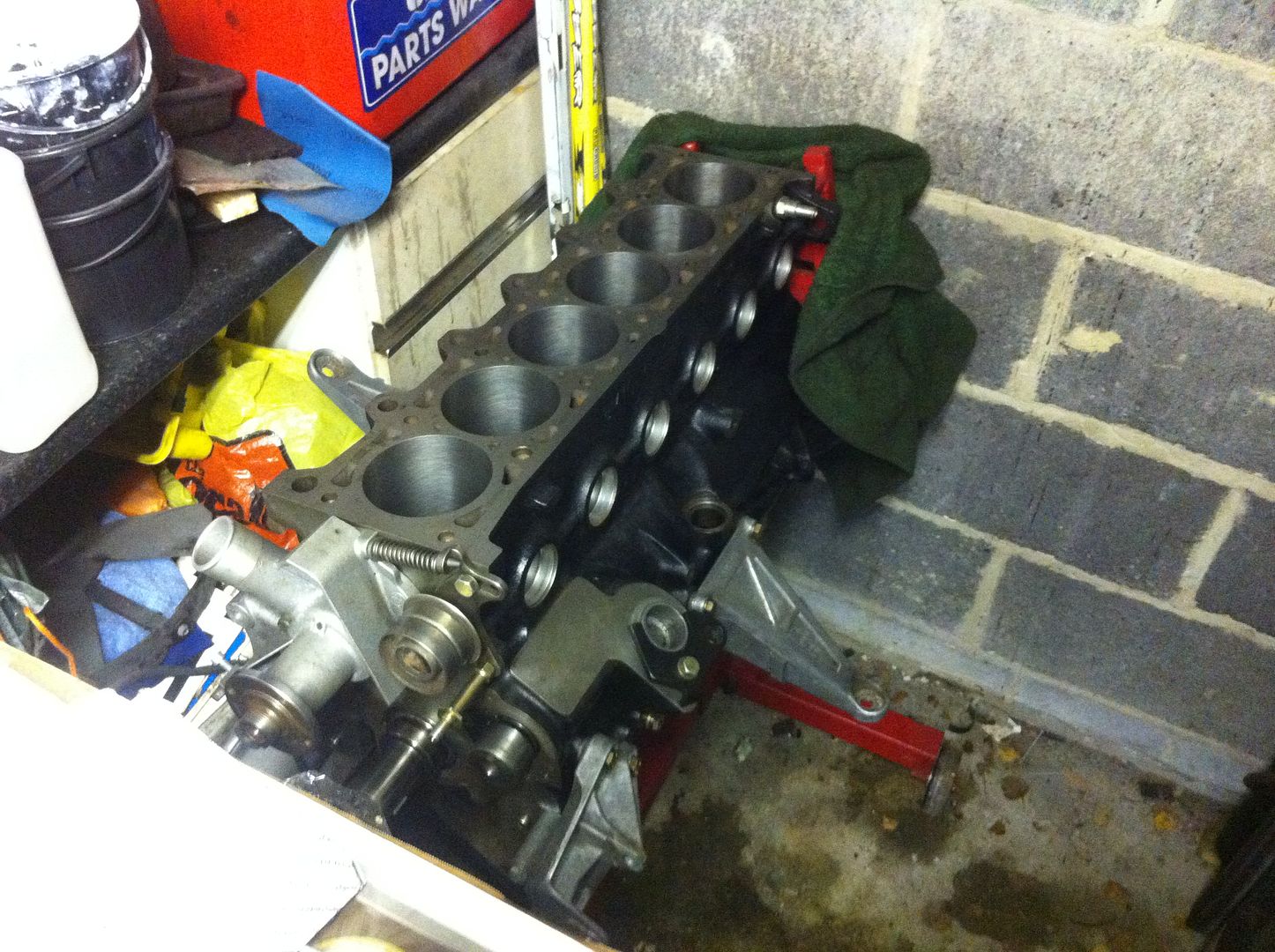

As promised i am making progress on this, here is the latest so far

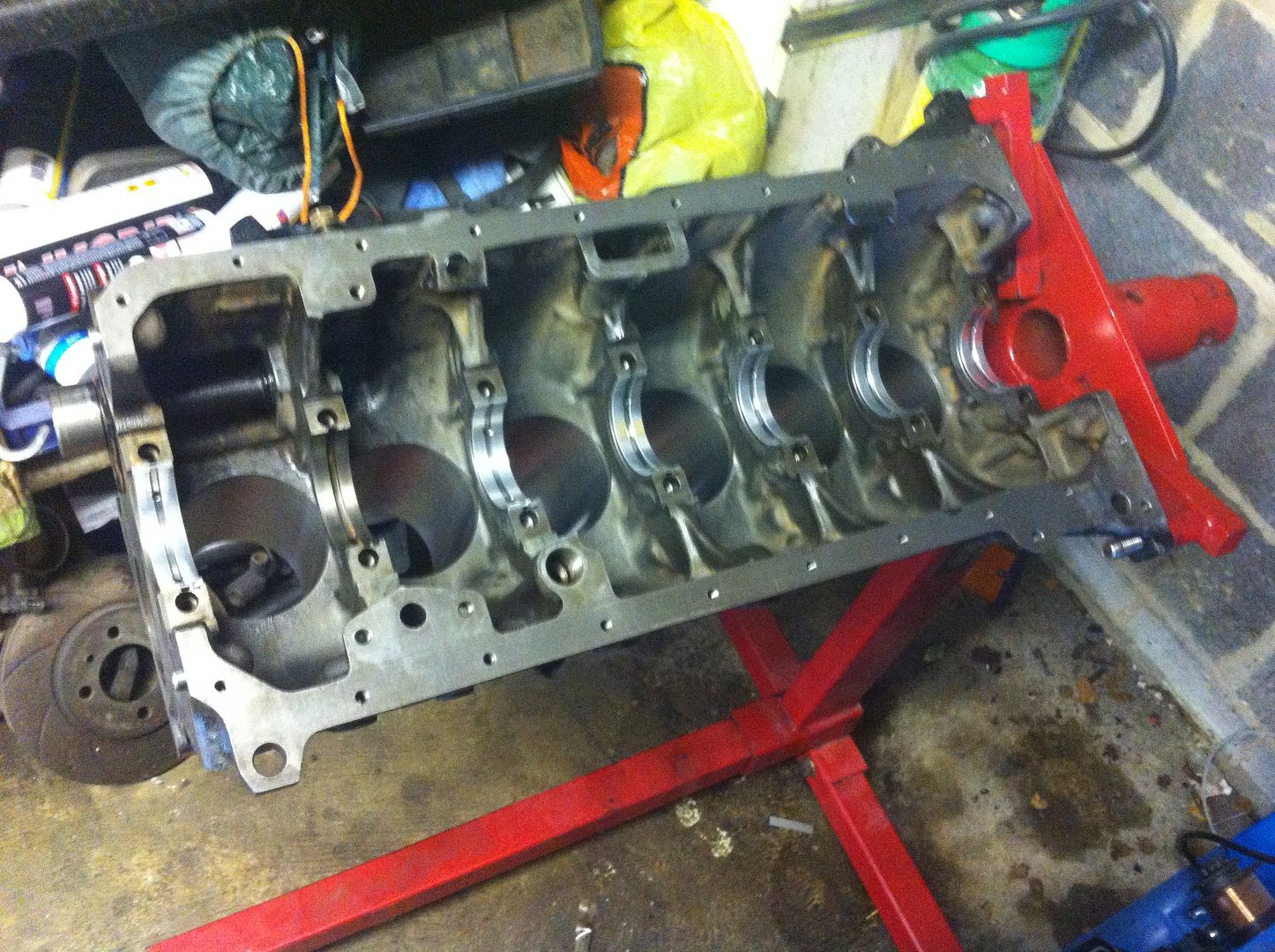

The block ready to go again, all its had is a hone since its last use and another clean/degrease

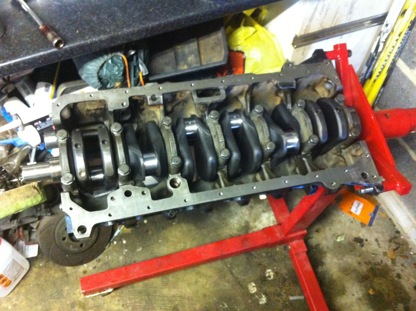

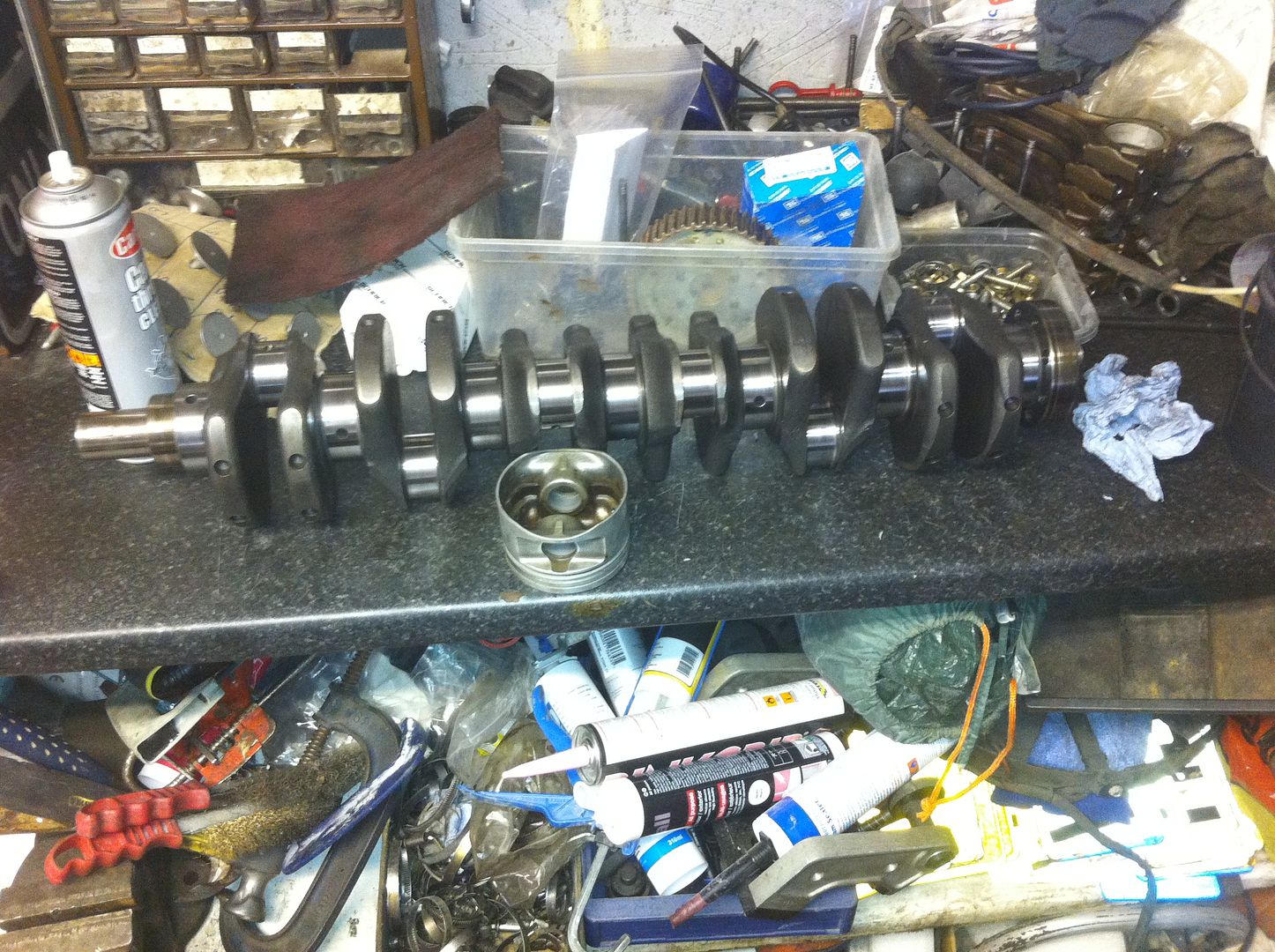

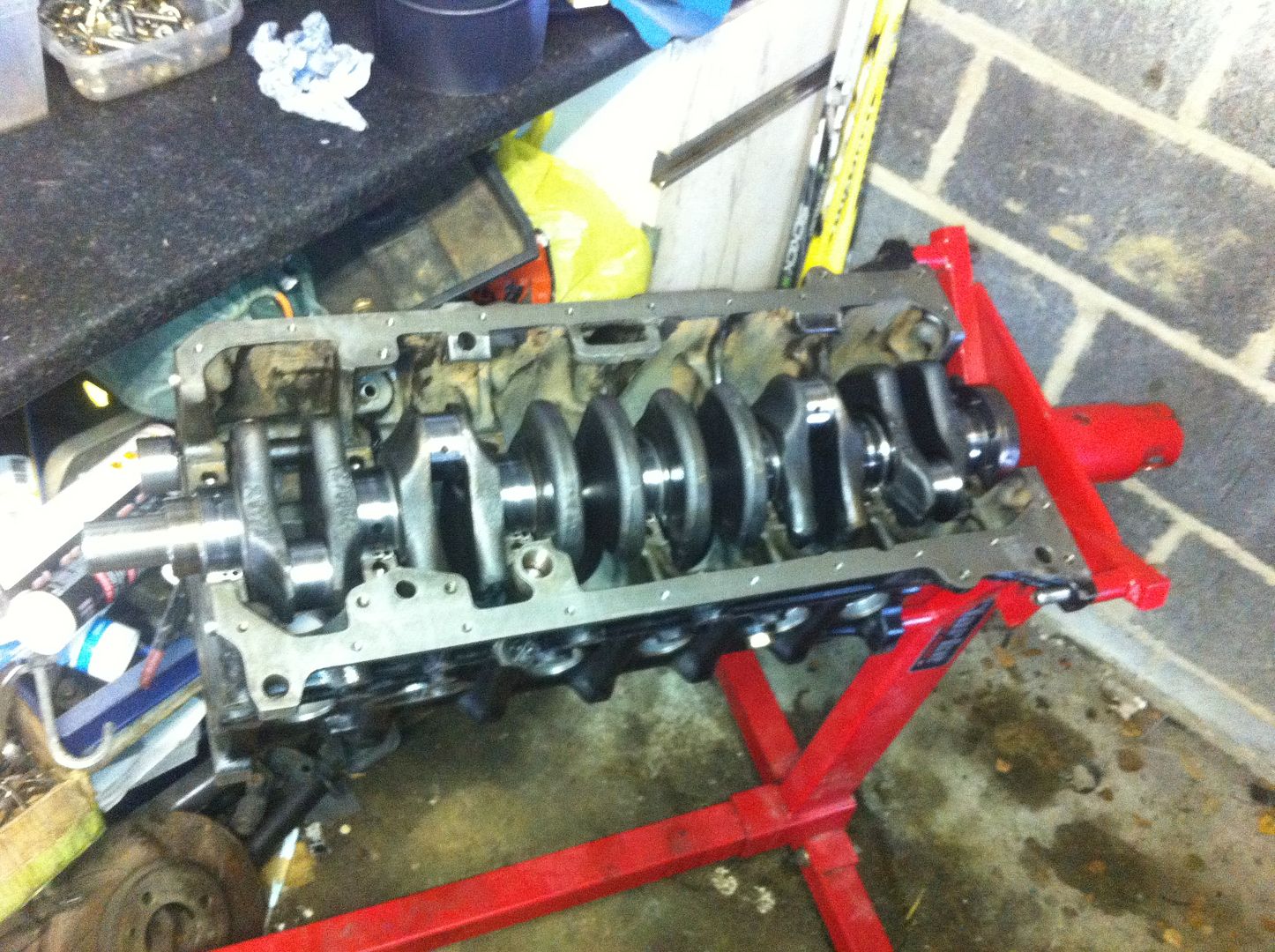

Crank and shells, i bought new shells
Crank in and main end caps torqued down

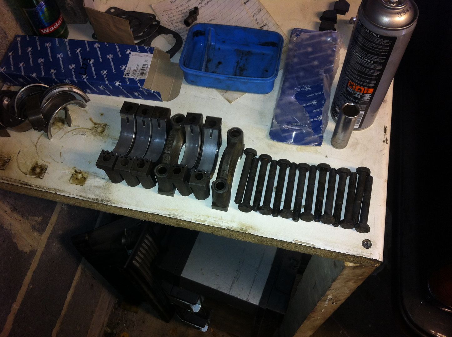

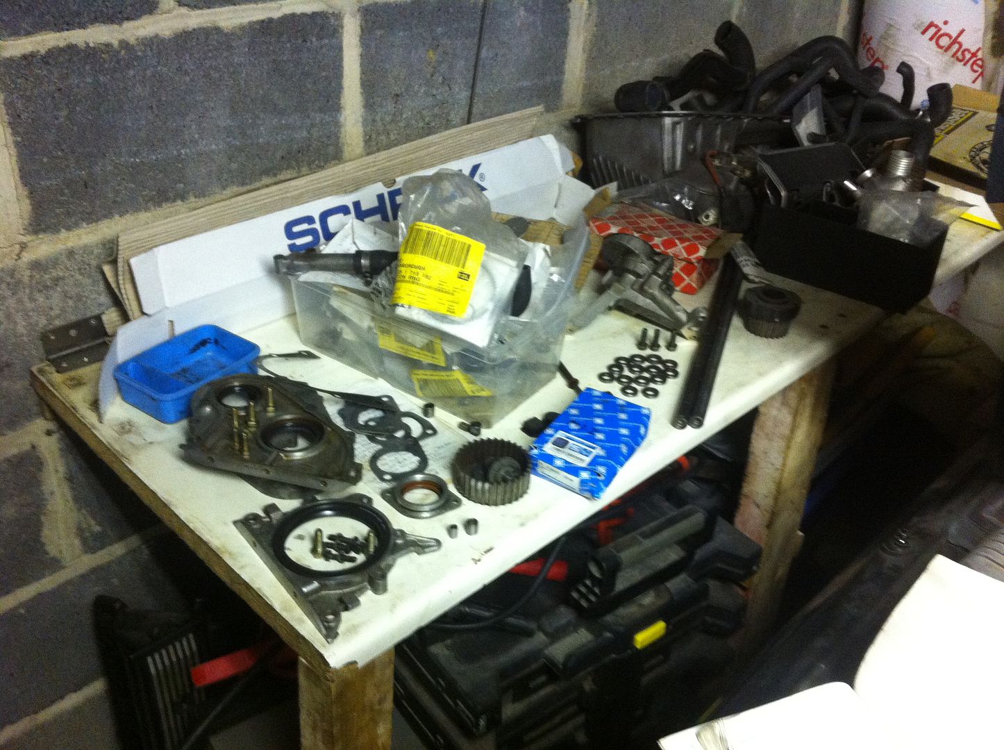

A few other bits bolted on
genuine headgasket set, not ruinously expensive tbh, plus head bolts,cambelt etcfinding and laying out all the rest of the engine. I've got all the bits needed for reassembly now.

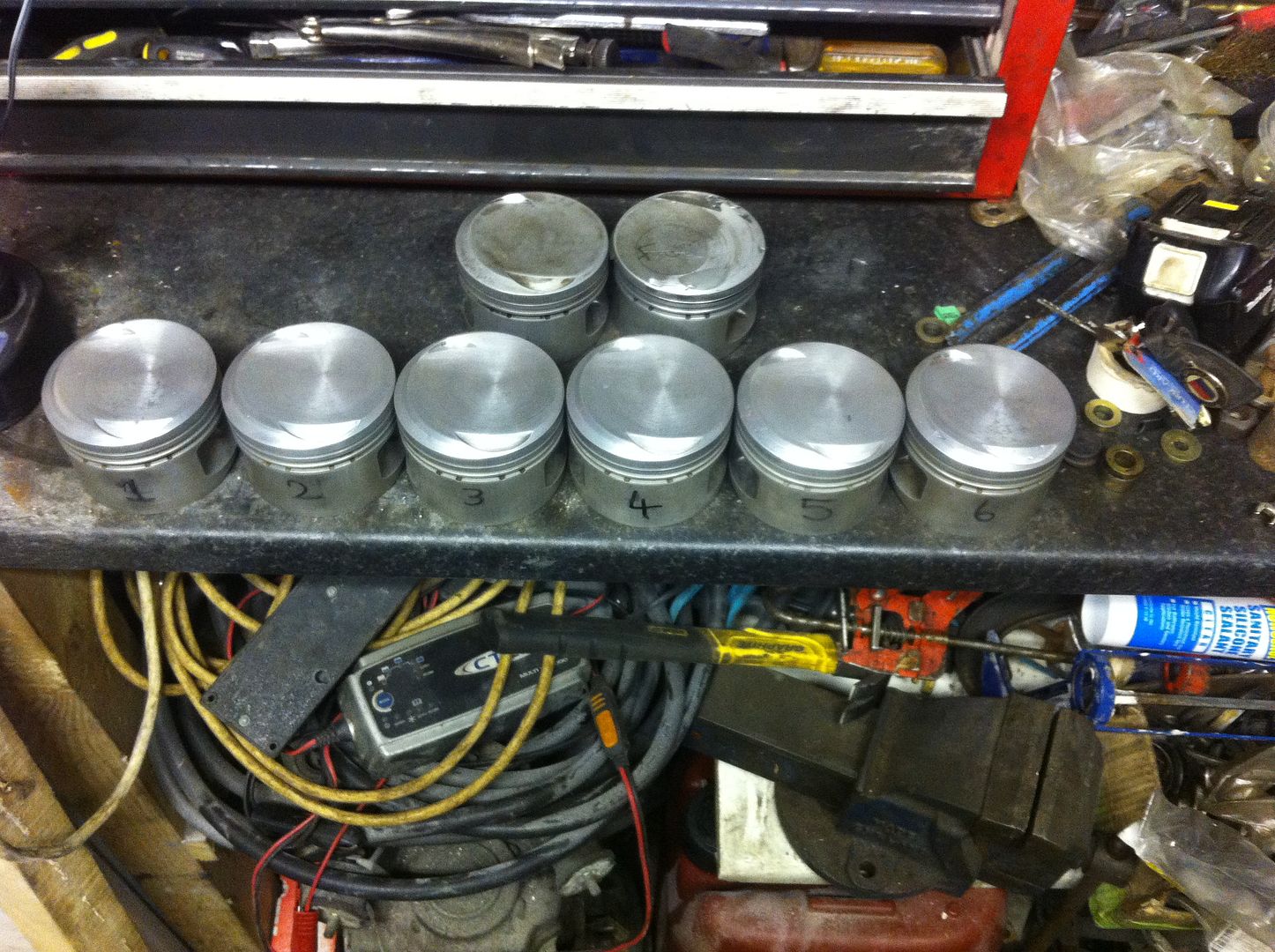

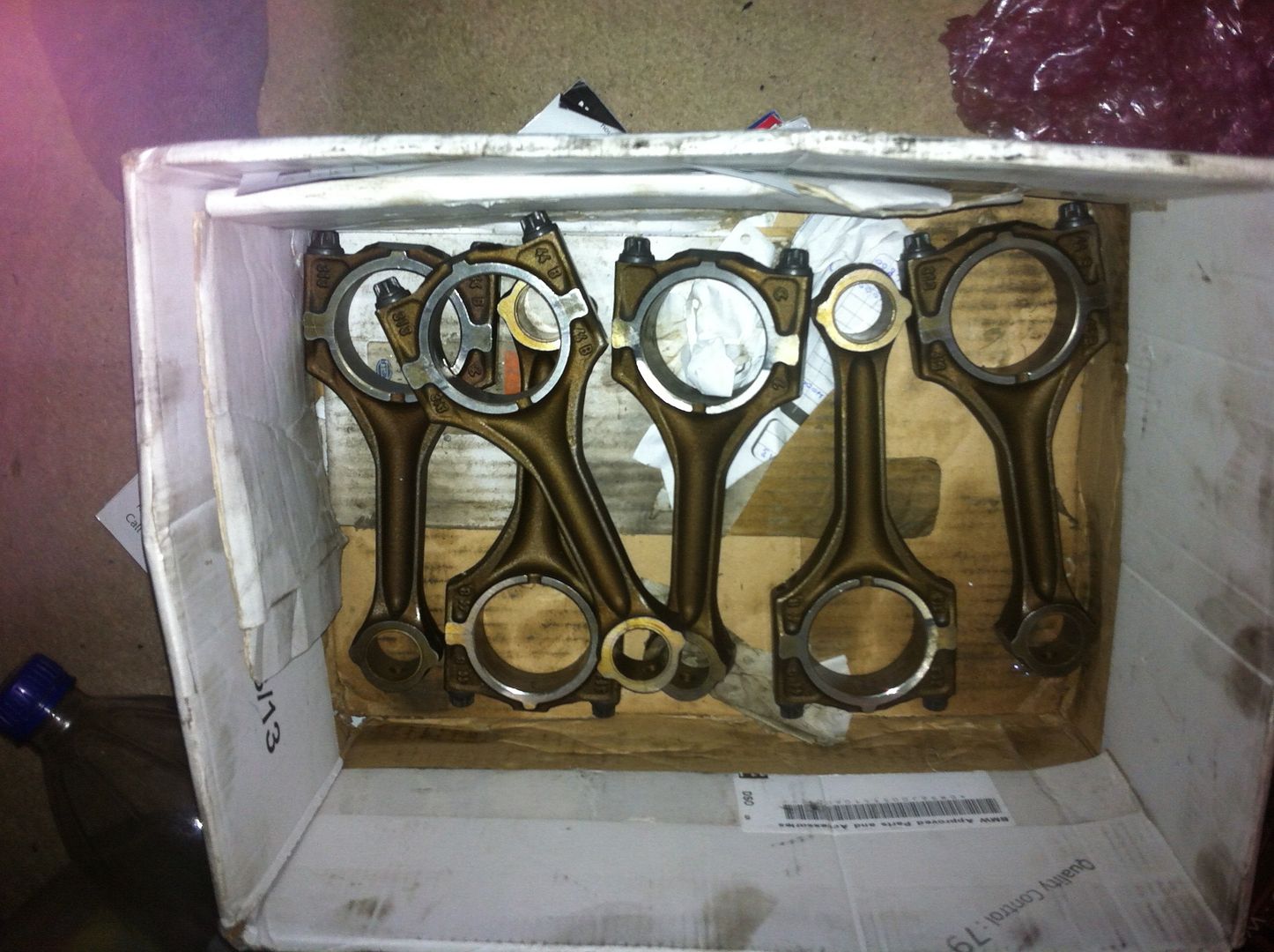

The rods - i got another set of M52 ones of Barold, and pistons are being balanced, and then the task of measuring a few things first to make sure i can get this camshaft fitted and dialled so it runs properly
I need to measure my valve to piston clearance first with the piston at TDC with a DTI and then go from there. I need to have 2.5mm spare above the total valve lift of the cam for it to be safe so they have told me if i understand it right. TBH if this is ok which it should be, i'll get the machine shop to set the cam up, i'll just build up the head and the bottom end and let them have it.

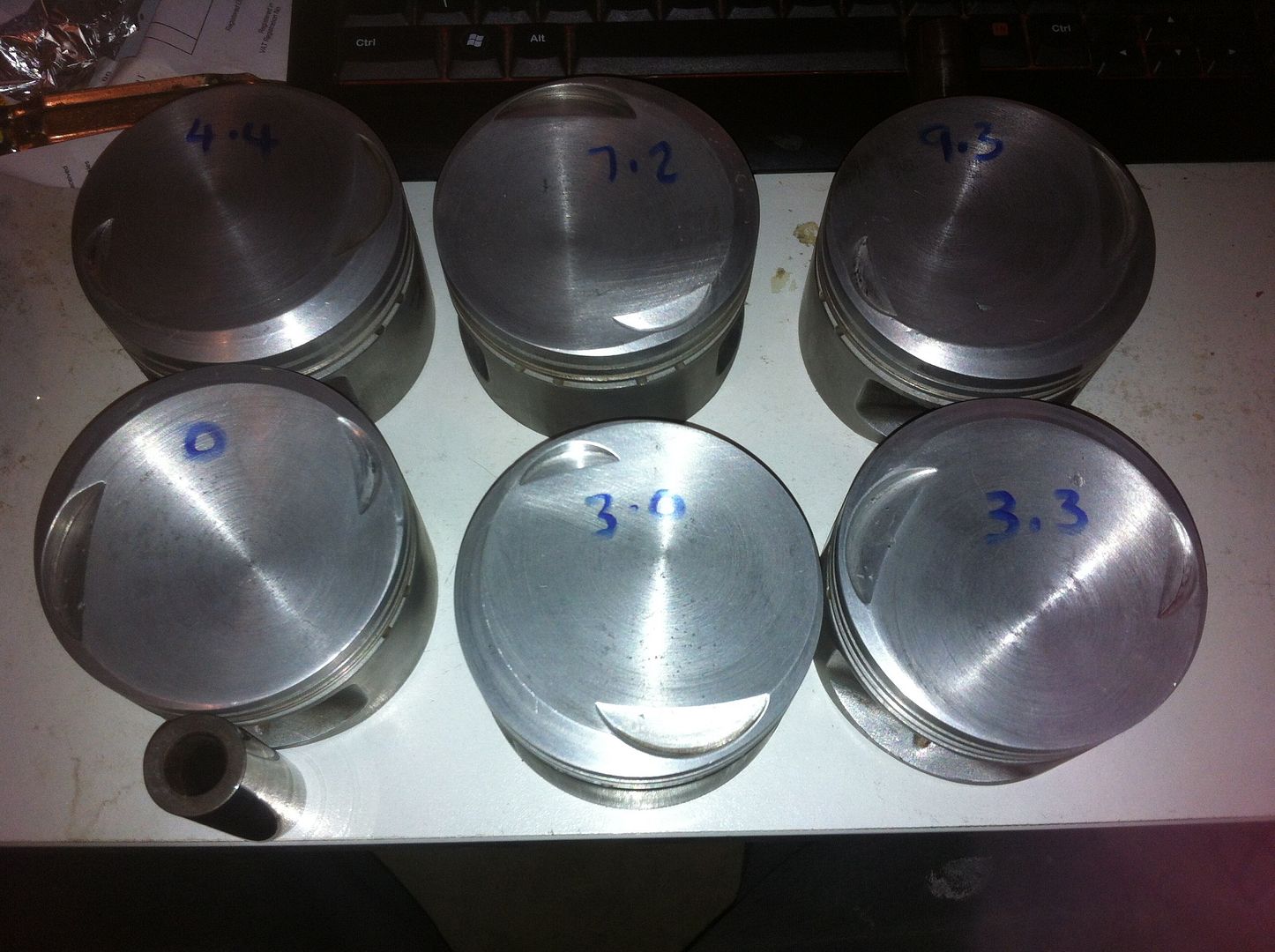

Right good and bad its never smooth, my rods are balanced up no problem
Nice picture, onto the pistons
They said they can't balance them because they've been done before and theres no where left on the pistons to take some meat off the balance them. You can see the differences between them in grams as its written on them. They reckon most decent factory pistons are balanced to a tolerance of 2-3 grams per set. They balance customer stuff to 0.3 gram difference max if not equal according to the scales.
So they said for what i want they wouldn't use my set i'd made up
I'm now looking down the barrel of a new set which i guess i was all along. Now i can cough and buy a set of Alpina slugs and they will be the same 25 year technology pistons like i have and lots of money. Or for slightly cheaper they can measure up one of the originals and get me a custom set made up with all the added bonuses of todays tech like better spacing of pistons rings, forged, teflon coating, total seal rings, oil feed for the gudgeon pin, a little lighter. From the likes of JE or the machine shop i use are a UK distributor for Mahle. Who they reckon make the best pistons, but they are seriously slow/ un reliable timewise with their custom/race piston manufacter
I need to still assemble the bottom end and work out my exact TDC with a dti guage, my total valve lift and then my total valve to piston clearance. If i've less than 100-120 tho between the piston and the valve when its fully open then i'll need some deeper valve pockets on the pistons to get a safe clearance.
Good job i have cash monies from the e34 sale. This is turning into a seriously expensive mistake! Time and money wise

A set of Salter digital scales, and do them yourself with a dremmel or just rub the base of the piston skirts down on some coarse emery and a sheet of glass. There will be somewhere you can shave off 3 grams surely..............? After all, the shittiest Bic biro weighs 6g.
3 grams is 4-5 peanuts!
