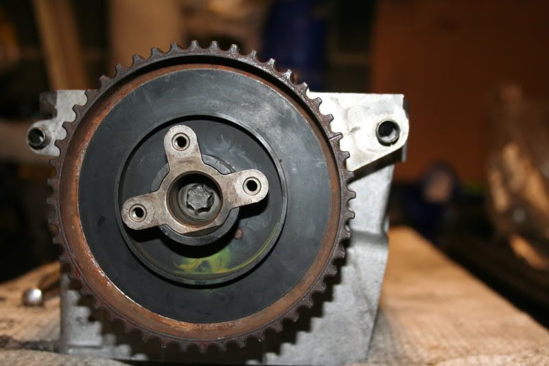

As e30topless said, there are two dowels in the stick.
So, 180 degrees out is a distinct possibility...

Mon Jan 09, 2012 11:02 pm
the sprocket for the cam only fitted in 1 of the holes the other was/is smaller or something. I remember looking at it and thinking the same thing as said. I'm sure of it. Easy way to check that is with the cam cover off and look at the cam lobes with it at TDC. Mind you if it was 180 out as such it could make sense as the crank spins at twice as quick at the cam. So the valves will never hit and the compression is spot on........................ :?
I know the crank sensor is right because if its plugged in to the other socket you don't get any spark. Makes sense. Barry and me tested this by earthing a plug on the cam cover!
I shall get the spanners back out when i get in from work again. Plenty to crack on with, can't throw the towel in yet
But the vibration damper thing could be it also?! I just grabbed the cleanest must unrusty one for balancing when i had the bottom end done. F**k that could of been a waste of money. I'll whip it off and compare it to the bronzits 2.5 engine see if it looks different.

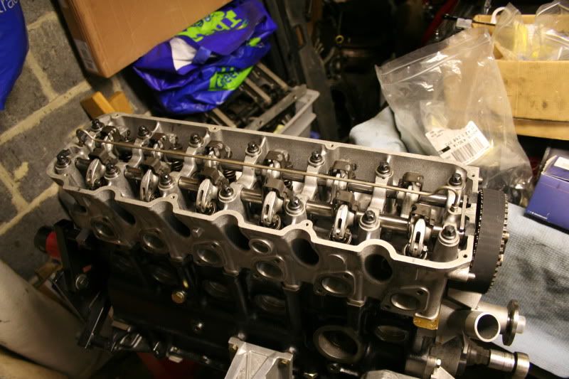

cam is deffo out ..
No1 valves are slightly open, the cam lobes which should be sitting on the bottom of the cam here aren't ... they are up top :eek:
Valves on No2 are closed more than No1 so it must be....

In that photos, cyl 1 valves look closed to me. :?

This is correct. Both No1 lobes pointing up?
Errr, or pointing down even. :roll:

Demlotcrew wrote:In that photos, cyl 1 valves look closed to me. :?
Just noticed Si has a socket on the crank here so the timing may not have been lined up at this point :o:
my theory could be completely wrong here, but worth checking ?
More than 3 teeth out and valves are bent = no compression. I'd be rechecking that the cam timing isn't 180 degrees out, but my money would be on a faulty pulse sensor - the one that goes around the plug lead, plug leads on wrong on the cap or a coil that isn't knocking the right number of KV's out.
