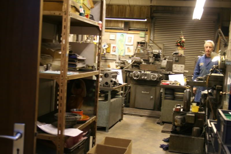

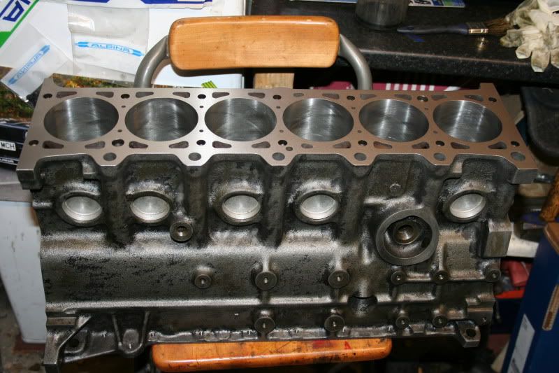

Another day, another workshop, this time my old mans joint. GP precision grinders
Caught! lovely block on the side.
Bit better, my dad at the front, lots of ladies on the wall to help the day go by. You will never ever see as many burgers in one place as you will here. Worth a visit on its own. Strictly no munters. Anyhow here is what he's done. So we've gone from this
To this...................

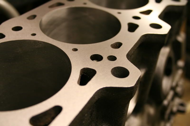

Lovely, best finish in the business. Good enough for F1 engines,gearboxes,diffs good enough for me! once the liners were flush as such with the blockface then it was a further 2-3 thou off to get it like that. Not even a human hair thickness taken off.
He reckons the block was as flat as a witches tit, no high spots or twists which is good. You can hardly see the liners now really have to look at an angle with the light right to see them now.
The wise old men of the workshop recon its a bad idea to disturb the core plugs? I think we can leave these in and replace the other side as they are manky and rusty. They all think its a bit mad but they're old and experienced and what the f**k do they know?!
If your ever feeling down during a visit
The men are here for you!
Shameless plug but if you need a head skimming, block etc and local drop me a PM.
So next will be painting it and then onto bolting shiney bits back on. The postman has come literally as i typed this. My bottom end gasket set from CharlE30 thanks there.

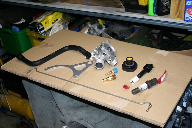

Look what the fatman in a red suit bought me, most kind! Prize engine morsels. The spray bar was bent which i think isn't on for something that used to be £11 but is now £40. Made me think back to last years crimbo list was bits of trim etc. Which made me realise this year gone i've made some good progress on this as the list this year was engine bling.
New thermostat housing is my particular fav

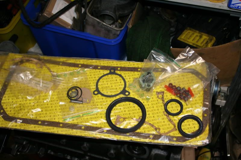

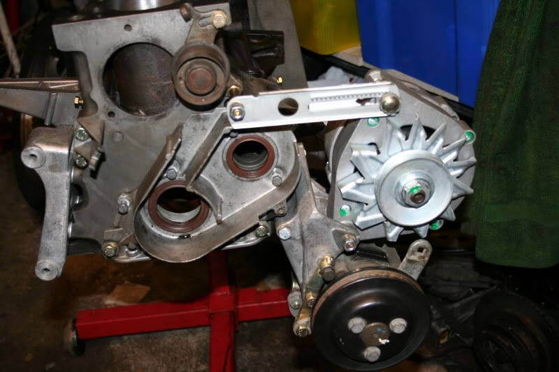

Picked this up off CharlE30 (thanks again) goertz bottom end gasket set. Saved me a small fortune from BMW just for the oil seals alone
Your thinking whats this? Me messing around. In my wisdom a while ago, i bought rather alot of nuts and bolts new. A big box full of bags and not knowing where it all fits. From BMW you have the odd bag of 10, or 5 etc so this actually took ages. As it throws you off trail. Checking with RealOEM along the way to make sure really helps. I shant do that again

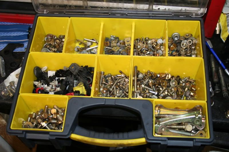

Heres my treasure box, Trev thinks its sad but he gave me this box thing. I hoard all the shiney nuts,bolts,speed clips,washers,plastic clips, odd little bits that are often missing or broken on E30's. Taken from every E30 i've broken nearly. Comes in very handy all the time for when you buy new from BMW and they turn up and the bolts are silver or black. I hunt through here and often come up trumps. Its my favourite box in the garage and thats why it gets a picture and a whole paragraph. An essential thing for the OE restorer
Sourced me 6 ones like these for the lower cambelt pulley, instead of the black sh!te BMW gave me, they just go into stock for a lesser wagon. Normally the touring!

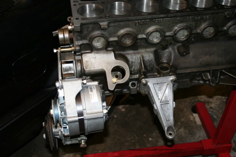

From bolting all the gear to the block i could see i'm missing a few bits so i'll get those ordered. Luck must be on my side as i was handed a brown envelope Crimbo day. Funds from my departed Grandfarther. They shall be put to good use to keep this ball rolling so off the BMW 2moro for a haggle on core engine bits and beat the VAT man!
- Posts: 13595
I save every shiny nut and bolt I come across !
- Posts: 15841
I never said it was sad Si! Thats why I gave you the box. I have 3 on the go now but you are always too quick on the breakers for me to secure any.e30topless wrote:Every respectable BMW owner should have one of these !Simon13 wrote:
Heres my treasure box,![]()
Actually, we're both sad w4nkers really!
Loving the stat housing. Not cheap these I would suspect and not something I even considered on my lump. But thinking on it, it's a focal point on the engine. It'll make a good build the tit's!
