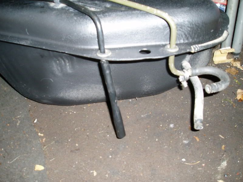

Might be of use Trev, that pipe just hanging down is the vent pipe. The other system on the later cars uses a "S" shaped rubber pipe here and connects to that long metal pipe which runs along the nearside cill. The "C" shaped one connects to the fuel filter and then goes onto the fuel rail. The other feeds eventually to the Fuel pressure regulator. You don't need it imo this way is fine, pyf, my old 4 door were all early 88 cars plus the red one and vent this way.
If you follow the pipework back this vent ends up at the breather bottle in the offside arch. No way fuel is coming out this far unless you had a massive massive pressure problem with something blocked elsewhere!! lol
Beather pipes from the tank to the bottle in the arch taped together as per factory spec! I've just ordered 2 more of the big cloth pipe, which at £20 a go isn't funny and i found one new! I though i'd used it. You can't really get muddled when connecting these up as the 2 plastic pipes are different sizes. Anyhow i've pulled that through so ready but waiting for some more parts to arrive from the dealer and i desperatley need to get my fuel filler neck re powder coated.
Anyone want it? Trev? or i'll ring up and cancel one on monday

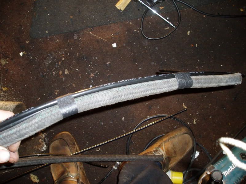

I found this on RealOem whilst looking for clips, loom cloth tape for the engine bay etc. 53p for the roll, love it
Part No. 61 13 6 902 588 for all the resto homos out there

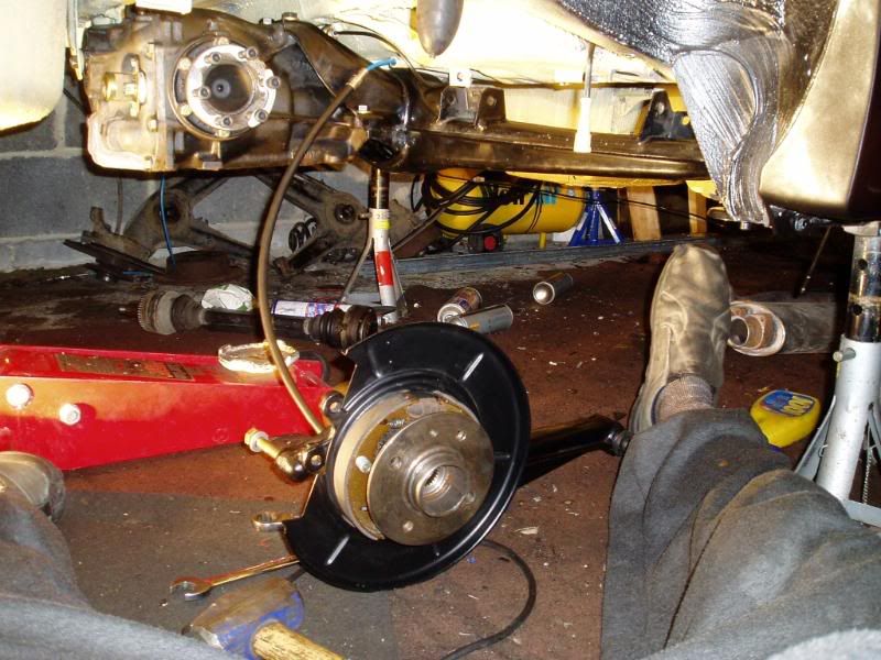

Heres one i bent up earlier, a right fiddle generally when the beam is fitted so why make life hard?!
25m of tape for 53p, bargain, i'm gonna need two!! large sections of my harness tape is quite literally falling apart.
What did you use to bend the brake pipes??
I thought about the brake pipes as we fitted the beam, oh well, its need to be a rolling shell, and i havent got some of the brakes pipes i need yet anyway, onwards and upwards :D

I bent the pipes with my hands and used a socket on the tight bits. The steel dealer pipe doesn't bend like copper though
I had an orignal t-piece with the 2 pipes on it as a template to help too.

Need to bend brake pipe? -
http://cgi.ebay.co.uk/CAR-MECHANICS-BRA ... 2314wt_941
The lines will go in easy with the tank off/beam in place, just need to be a bit more careful when fitting the tank but it will go in without hammering and prybars :)

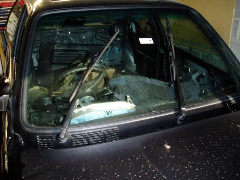

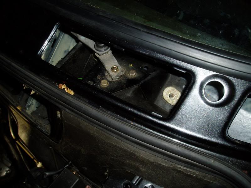

Wiper motor, this is officially the worlds fastest wiper motor. Bit of a waste on this car though. By the time i had got to this stage of sourcing a shiney nut to crown my achievement i'd spent 2 hours getting there! f**king about with the linkage
This was the wrong way round :? As in opposite side to how it is now. Took stripping the touring down to work it out! plank. Barry you missed a bit with the waxoyl 8O

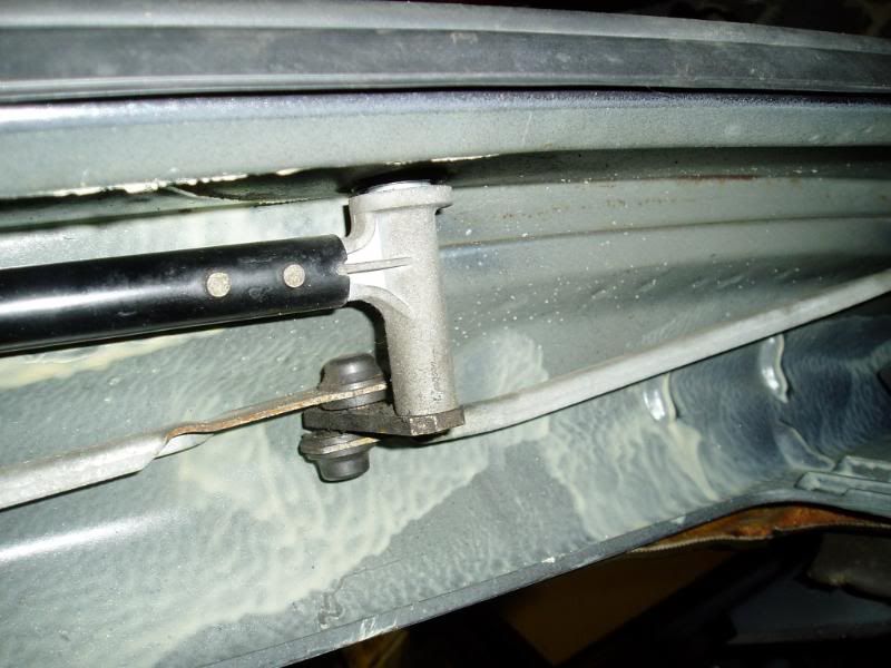

New arms in, nice. Skanky old wipers though, no point in new ones for it when we are still an age off finishing i think. Parked in the ghetto position

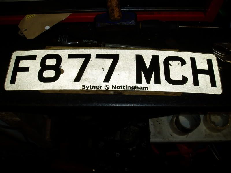

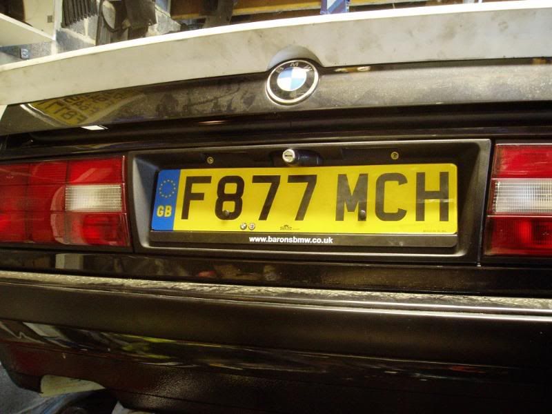

Second attempt on the numberplate. It did have stickers on it but kept falling off so the screws have come out. Won't fall off now. This took me ages also, i couldn't line the holes and screws up. I measured it all the mm. Must be lack of smoking today impairing me. Very odd working on the car and not stopping for a tab!

Post Sun Jan 03, 2010 6:06 pm
Loving your work Si, not big fan of the euro ID number plates though. Doesn't Dave H have some of the original typeface for the old style plates? It would look good with some Sytner Nottingham logo addition too!
Post Sun Jan 03, 2010 6:18 pm
thats the plate that was on it when i bought it. It looks to be fairly old but its not original as its had a few plate changes in its life
Does this look Original to anyone?

Post Sun Jan 03, 2010 6:27 pm
Simon13 wrote:Image
Yep looks like the real deal to me, old style larger font, single colour lettering at the bottom.
Any chance you could send a close up picture of the lettering at the bottom of the plate, would like to try to get that replicated for my turd, its a Sytners Nottingham car too, would look good i think when its finished.
Royalratch
Posts: 4921
Post Sun Jan 03, 2010 6:38 pm
I went back to super minimal, non EU, non German nonsense too - looks rad although a nice little BMW dealer caption may look more 'authentic.'

Post Sun Jan 03, 2010 6:43 pm
Ratch
I also think the pre 2001 old sytle larger font plate would be more in keeping as well.
Although as you know refitting such plates is a legal no-no, but when fitted your average copper aint gonna know is he, all he will see is a early 90's car on a "H" plate with what appears to be normal style plates of that period :D
When you buy them of course they will only be sold to you as "show plates" winkeye

See the Reg in Si's car here /\. Well the Original reg on my car was.............F363 EDV. These 2 cars must of been converted at the same time. Pretty dam close worth sorting this out and getting the original plate back? Would look good at a show next to each other i think! but do you need MOT though?
I like euro plates plus these have the bmw/alpina logo on them!

Euro plates suck ass. Along with the EU. Just my humble opinion of course :)

Post Sun Jan 03, 2010 7:21 pm
You can try to get the plate back Si but I'm not sure how much faffing you'd have to do or whether the DVLA scummers would even entertain such a wild goose chase?
Bollocks to this 24v scrap!
Post Sun Jan 03, 2010 7:44 pm
Yeah, you have do it through the DVLA i think as they hold all the those old regs. Simon told me he had to send off his log book,mot etc. And it was alot of aggro!

Post Sun Jan 03, 2010 7:53 pm
For the stupid amongst us, bear with me here......, i take it your car was already registered as F363 EDV, "DV" meaning an Exeter registration.
Then i'm guessing sent to Sytners Notts for the conversion and re-registered ending in "MCH", "CH" denoting a Nottingham registration, i'm confused :(

No no, the car along with Simon's Dolphin car were both registered to SMB Exeter (Which is called Ocean BMW main dealer now? i think) as their first registered keepers. Mines led a multi owner and much harder life than Simon's! As i am the 11th owner. So we think they were possibly 2 demo/company car Alpinas for the south west region at a guess
Mine went onto its current reg in 93, it was sold by a dealer in my area so i guess the private plate taken off and the sytners reg applied.
The cars were converted BEFORE they were registered is my understanding, mine converted and then held back for the "F" reg! Should of been an E really. Clear as mud. I don't think sytners registered them all. They just converted them.
Post Sun Jan 03, 2010 8:25 pm
The Alpina green 4dr C2 2.7 i broke was sold new by L&C tunbridge wells but registered originally with a Nottingham RA reg.

Simon13 wrote:Yeah, you have do it through the DVLA i think as they hold all the those old regs. Simon told me he had to send off his log book,mot etc. And it was alot of aggro!
Twice I've transferred my "personal" plates off cars onto new ones and both times the "donor" cars got their original plates back.
Simples!
Posts: 15846
Post Sun Jan 03, 2010 8:38 pm
Simples!
That seems to be the norm now. I always get the original back but it was not like that before. Vehicles were re registered using the next available age related plate from the area the docs were processed.
it was like that until the mid nineties I believe.

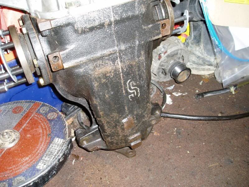

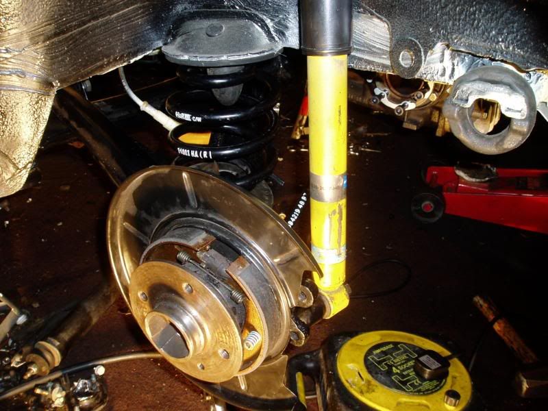

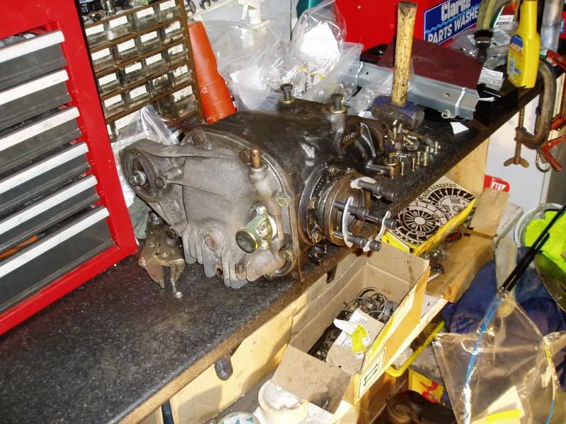

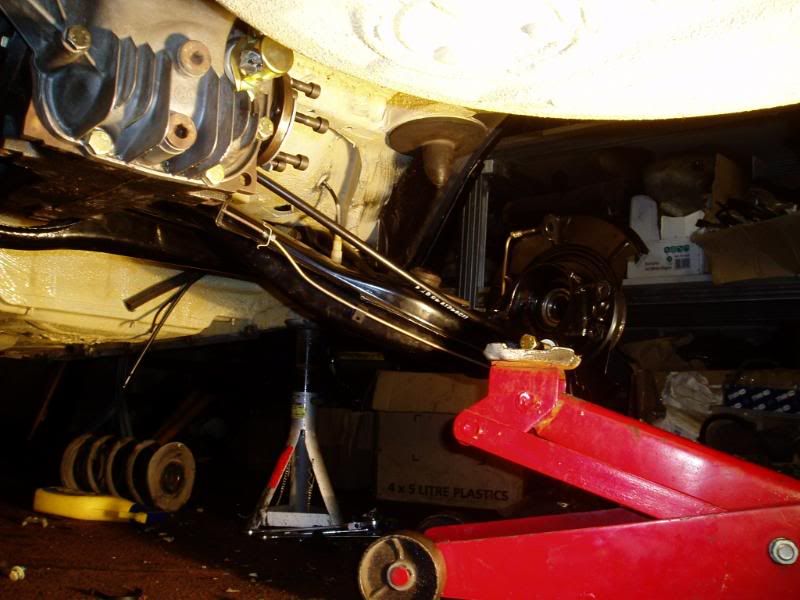

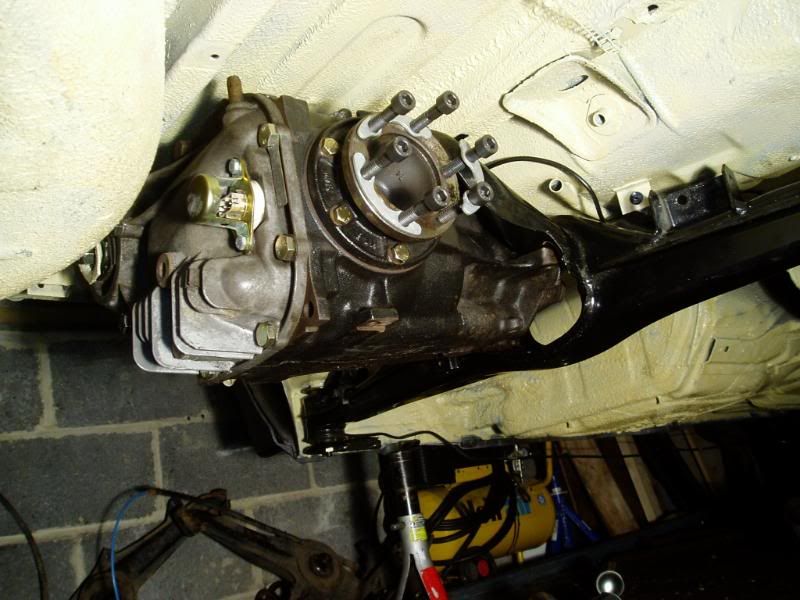

My nice slippy diff here shes a 3.64, as the car came with this from new and the 2.7's drive nicely with these. With some new bolts and sh!t

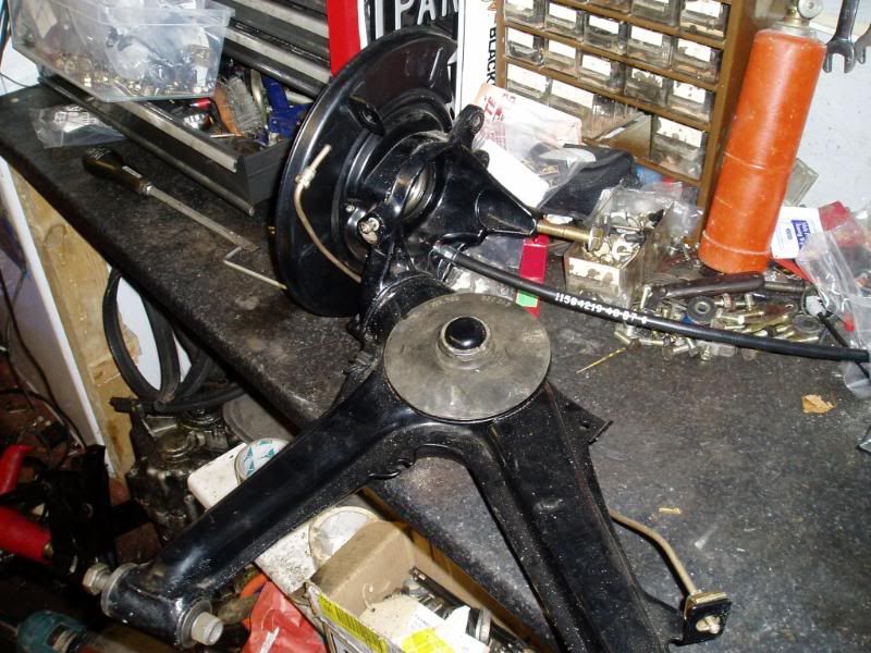

Onto the car
Refurbed trailing arm, the rubber spring cup is the 3mm thinnest they do from the dealer! 5mm would of been a better choice i expect

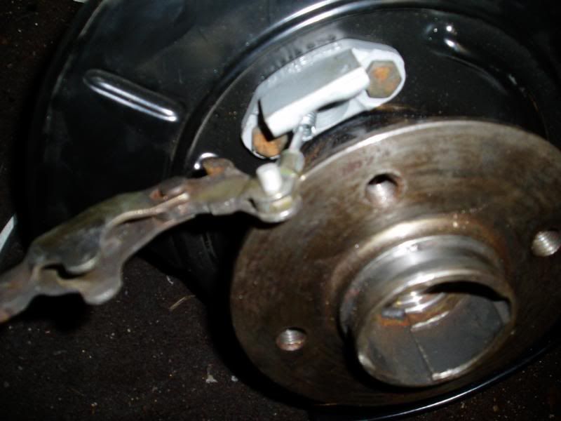

The end of the handbrake cable or bowden as bmw call it. This little slug just slots in nice as pie, it can't fall out either. Now i tried getting one out of the old arm. It was welded in i can't get it out. Pointless story so....
Ready to roll

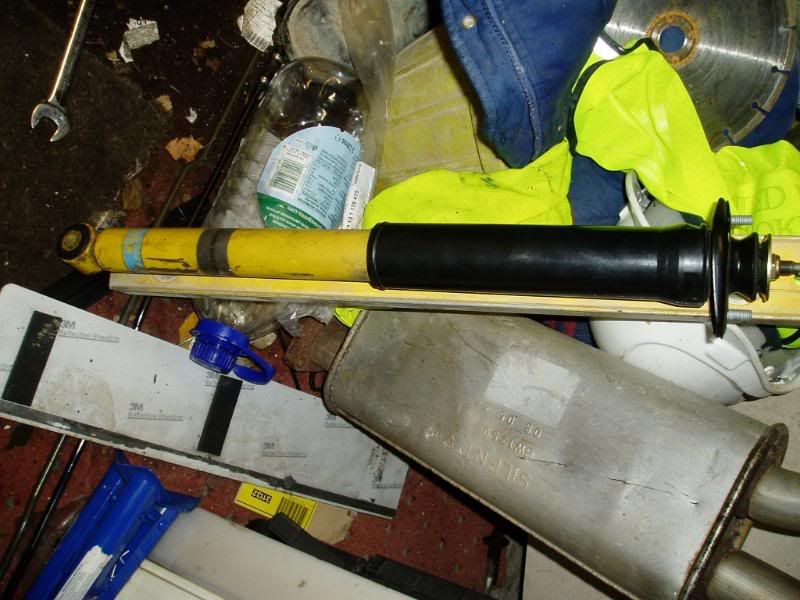

ahhhh a Bilstein, a B6 to be precise. This is just bilsteins spec or aftermarket replacement. Had them on my old sport, they've covered about 30,000 miles. These are one of the main cogs in the 13's favourite suspension setup! All ne collars nuts and top mounts which are.............................................e46 M3 cab ones 8)
Spring in also, H&R cupkit :) my favourite

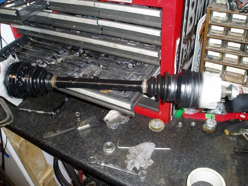

Halfshaft drying off, i've just cleaned them up and put a lick of paint on each end. The CV joints on these 2 are pretty good and theres no cracking,splitting on the boots so happy days i'd say. Just fed the rubber to help them along the way

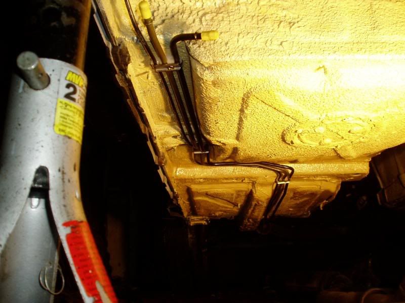

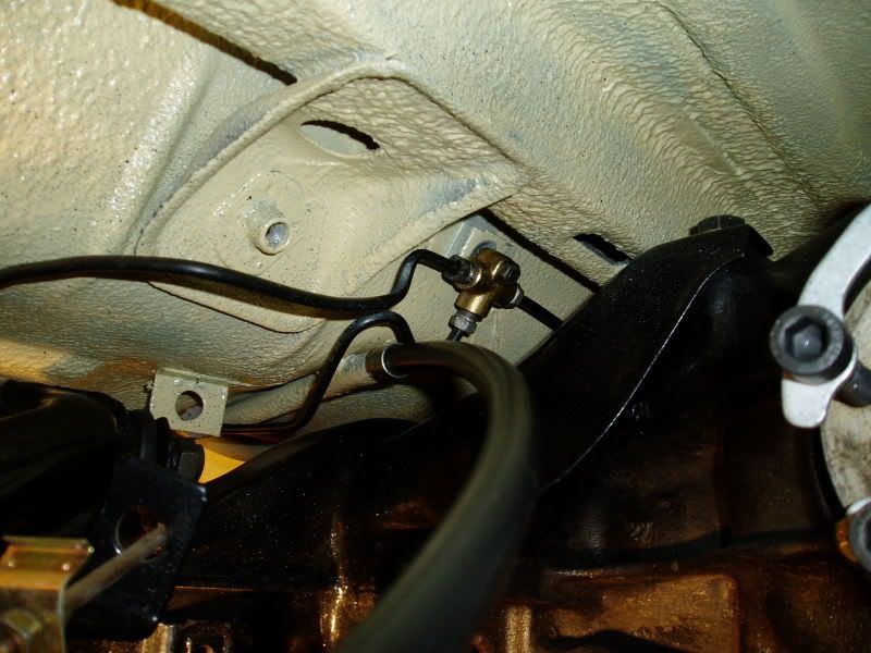

Front to rear brake pipe, plus the fuel lines in.
Barry can i have my roll bars back please, good progress its all coming together nicely. Waiting on a few bits re the fuel system but thats one of the themes of this type of project waiting!!

Post Thu Jan 07, 2010 10:58 pm
Simon
Great progress, i spy lots of shiny newness under there.
I'm sorry thou your "S" on the slipper is pi*s poor compared to Trevor's :D
