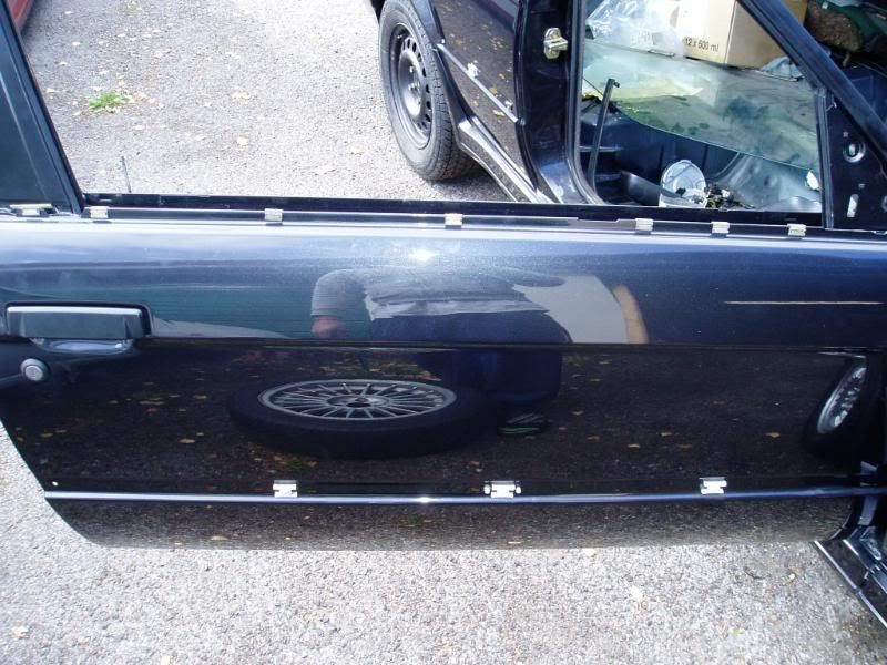

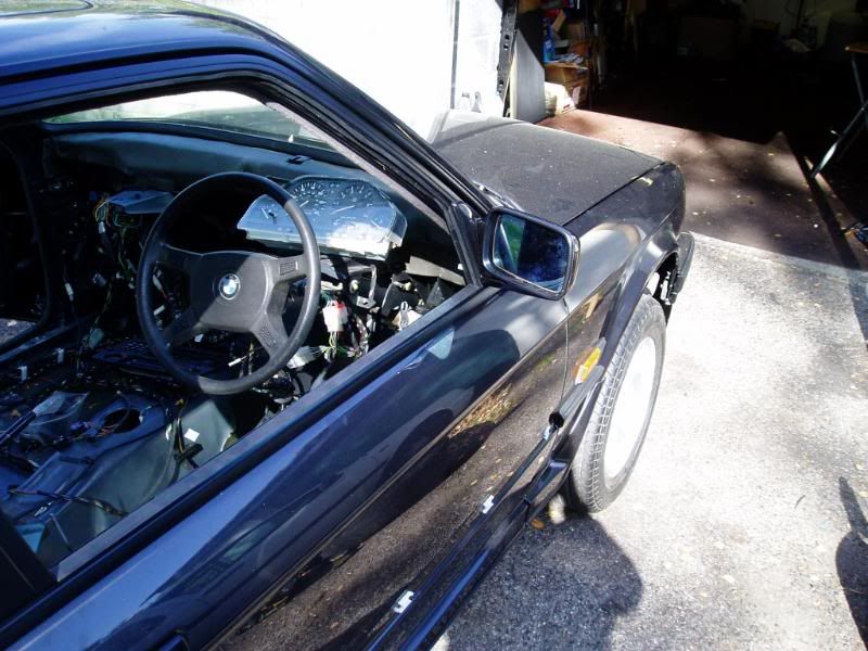

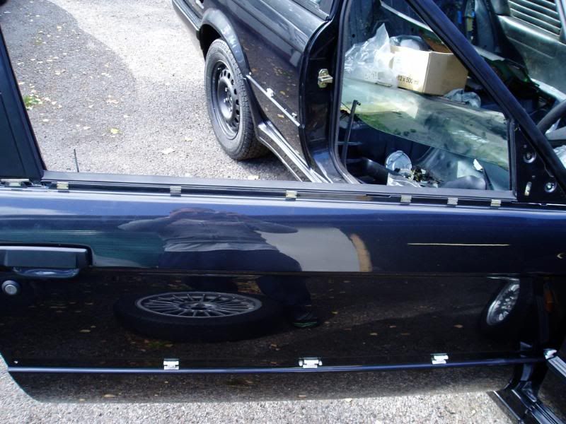

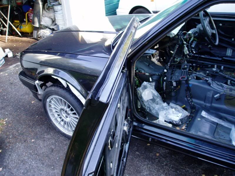

Small update,
The ever on going bloody doors! i wish we could blow them off lol

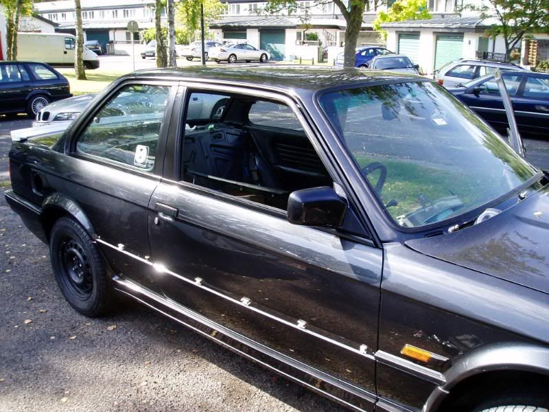

clips on
weather strip on (new)
shadowline trim on, along with a wing mirror! i wanted a blind spot one which are NLA new so Nelly sent me this one which is also heated. So fitted the heated loom to the wing mirror, while i was there
Nice. Trim is such a fun job on new paint, what happens when you have to fit it twice? you cry as none of it comes off without a fight. Glad its done
What i am finding is bits are going or have gone NLA which is a bit annoying when you can only buy for one side! like this rubber which runs along the top of the door. I've thrown the old ones out in my wisdom also :?
Doors aren't too far away now from being done and dusted, horay! Which will mean its weather tight and we can start underneath at last

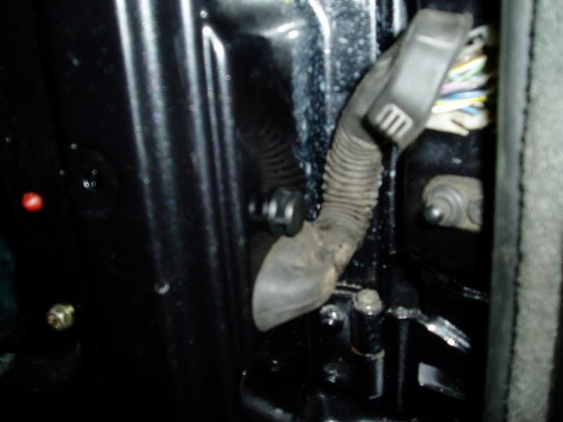

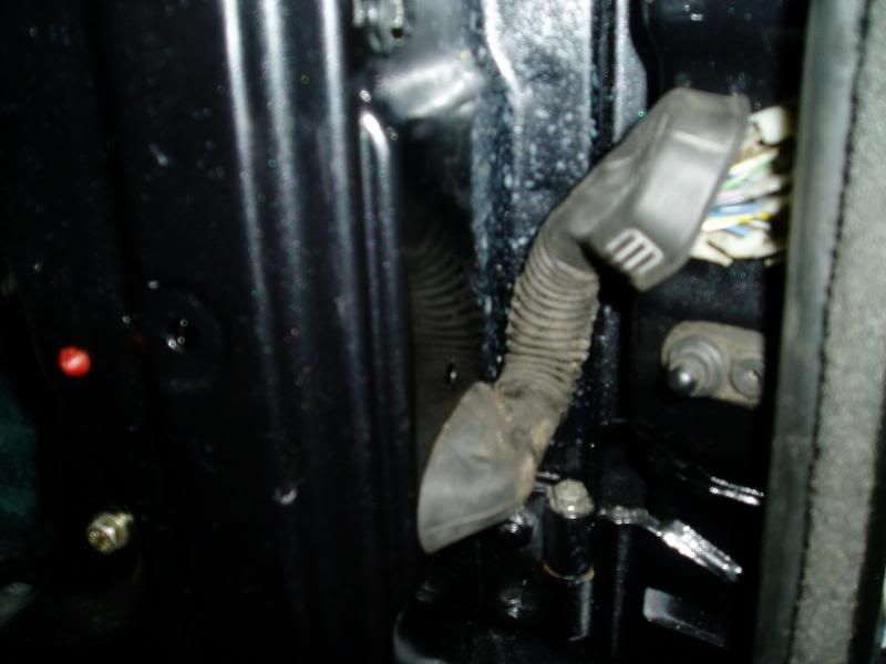

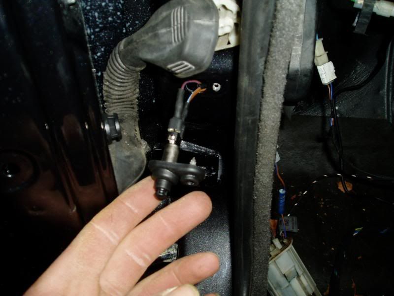

nice 5min job this eve which has had me in a pickle for a while
these f**kin door pins for the poxy interior lights! They always play up and i couldn't understand why the interior light stayed on and the e/w and sunroof stayed powered up with the doors shut and ignition off :? I thought i'd fubared my e/w conversion! As she was sporting motorsport windys originally
eureka moment in shower did shed some light and also doing the obvious thing. Check another E30? Oh look theres a touring on the drive fook me i'll have a look. So another trip to the dealer
I was missing these bloody plastic things!
So while i was there 2 new door pin switches things, they were only a fiver each so it would of been rude not too. Plus they are always knackered! Anyhow thats cured it all and we are cooking on gas and everything is working as it should i can report. I need 2 new ones anyhow as i needed the double pin ones as i had retro fitted electric windows
Seems minor but my electric skills are strained by all this!

the shadowline trim is clipped on as you can see, wing mirror off before you start. work from the b pillar to the front. A screwdriver or strong flat blade with the window wound down you can prize it up. from the inside if you get me, and lever against the door to do it.
The rubber weather strip might come off with it and bend and end up fooked. But these are still available!

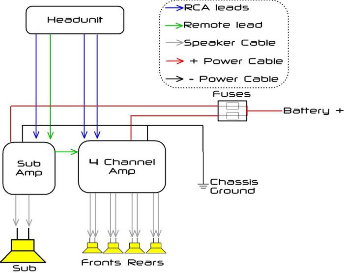

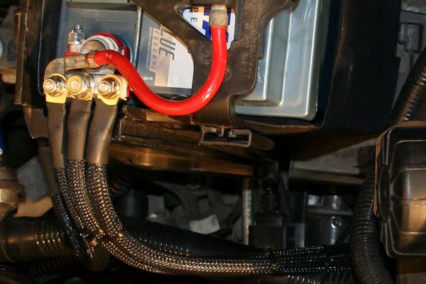

As requested young man, a very basic setup:
Let me know when your ready and I'll bring down some braiding and stuff to tidy up the wiring, you can even use some heatshrink!
:wink:
Mon Nov 02, 2009 5:36 pm
Thanks Bert making sense already to the numpty!

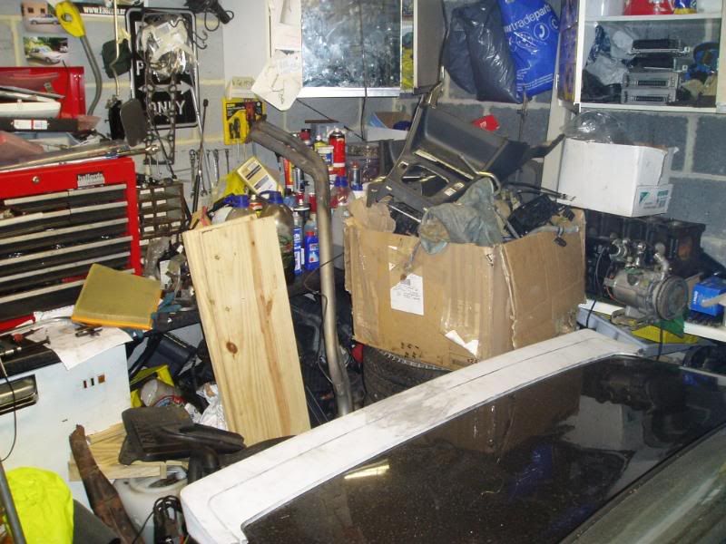

This is mainly a big thankyou to Trebor B7 "Sharp" I'm undertaking an epic garage re shuffle to change it from a storage pit of e30 sh!te to a part storage one. So i present some new racking
Trev sorted this out for me and gave the idea...... to get the ship and my sh!t inshape! Now this is half done but by racking out this half and storing all the gear on this. I'll have enough space to walk all around the 2dr. ~Most importantly though i'll be able to work on it in the garage through the winter providing i sort out some more lighting!
Its all stacked up here though! :o: but i'm well excited at sorting out this mess!

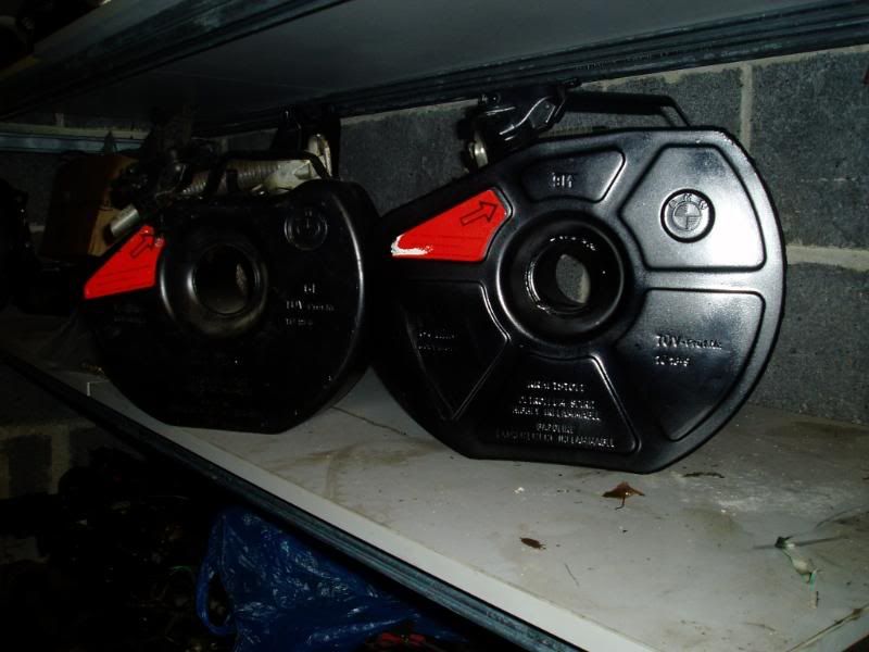

Any how as always i've been collecting more new parts and trinkets for the build
Which one mofos?! 6litre or 9! love it 1 for each alpina. The 9 is way more mint so thats going in the 2dr and the 6litre can slum it in the touring

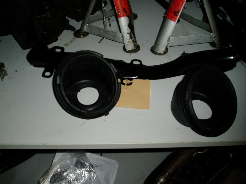

Fuel filler neck rubber thing i ordered 1 and bracknell sent 2! hehe the metal bracket for the breather pipes in the arch too, it was 27 sodding pound! Also got the pukka fuel tank, new lines front to rear brake line and all that gumf together.

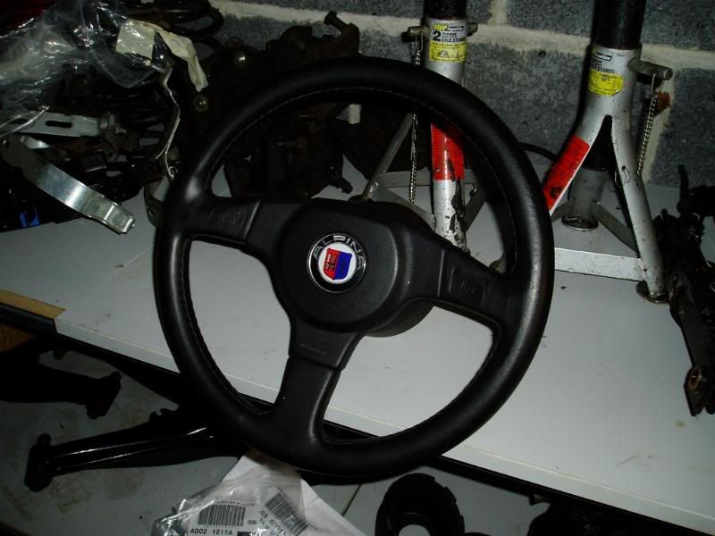

Aquired this in a deal with Kos with a 4 spoke version going his way. A Trip to Demlotcrew for a minor refurb. Shes come up a treat so thanks to these guys

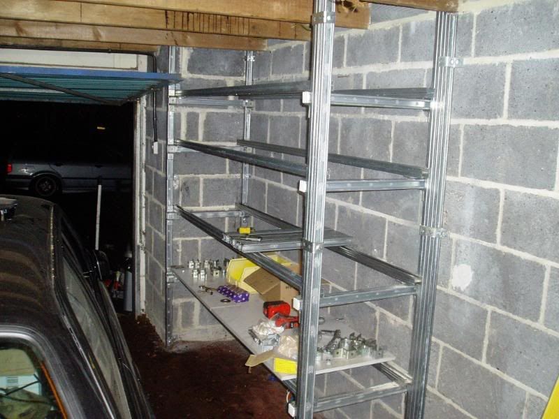

It don't look like thats going anywhere fast!!! All a bit "over engineered" for a garage what?
Done well getting it built. I'll try to get to Aldershot 1 more length ASAP and a few brackets.
Been thinking some more. Move the fridge to under the light switch and extend the bench using the shit down the other side?? Nothing like a long bench. Should have put a vice on the xmas list as well winkeye

Thu Dec 17, 2009 9:40 pm
Well done chaps, I've also just had a massive clear out of my garage and got the M3 in there and it has really given me a kick up the arse to get going on it again.

Thu Dec 17, 2009 9:41 pm
Nice bit of racking that Simon :D :D, i would advise one of those little infrared heaters as well, it was bloo*y cold out in my garage tonight.

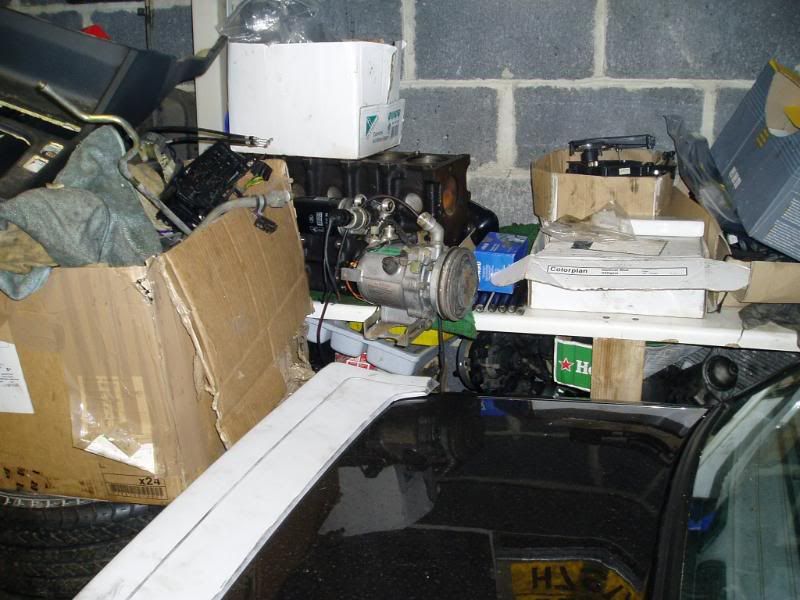

Pictures taken a few weeks ago, looks even more like a bombs gone of it now....
Thu Dec 17, 2009 9:46 pm
looking great si , nothing like a tidy garage for inspiration !
mine was full to the roof, but now most bits have been fitted I can move, almost !
Paul I'm envious ! I would love a double garage :)
Thu Dec 17, 2009 9:54 pm
Well my garage is 12 foot wide! and e30 is about 1600mm if that wide. So i'll have at least 2 foot around the car doesn't sound much, but thats loads of room to walk around get a jack under it etc and work plus its pretty long also for a single garage where its parked when its clear i can walk around the front and rear.
Yeah that steel cover is a joke Dan i bought one a year or so back for £10 but its ended up on my pina touring instead last winter when it had its own mechanical overhaul. F**k me it got it sideways tonight!
Amazing how much space a car takes up when its stripped down and your storing carpets, interiors rear beams and arms, wheels, spoilers, stripped engines,trim and fuel tanks. I'd love a double garage! I'd love to have the room to keep the pina touring next to it as really it deserves its own garage space when not in use. But we use it all year round but thats what they're for
