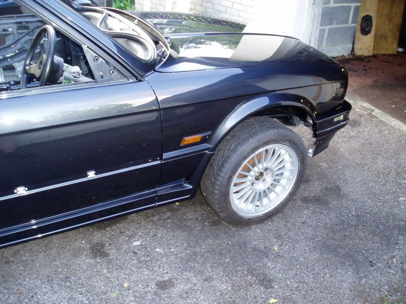

Fri Jul 24, 2009 12:27 am
:burn: back to the top!
So after a 9 month lay off, mincing around and wasting money on certain tourings which shall remain unamed we are back to the main focus!
Selling the Red one has made funds available in the kitty for the 2dr, the only real downside being my trusty J reg white E36 4dr 316i hub cap meister rocketship is back on the driveway for another daily stint with MPG's an M20 can only dream off
Any how only minor but in the right direction. The OE homos will be please with this choice
Orange indicators and side repeaters! lol As some might know all of this is NLA, in true hording 13 style i have vast stock of these so these where the best i could find. Out came the tooth brush, polish and back to black!
Orange kinda goes with black so its ok me thinks

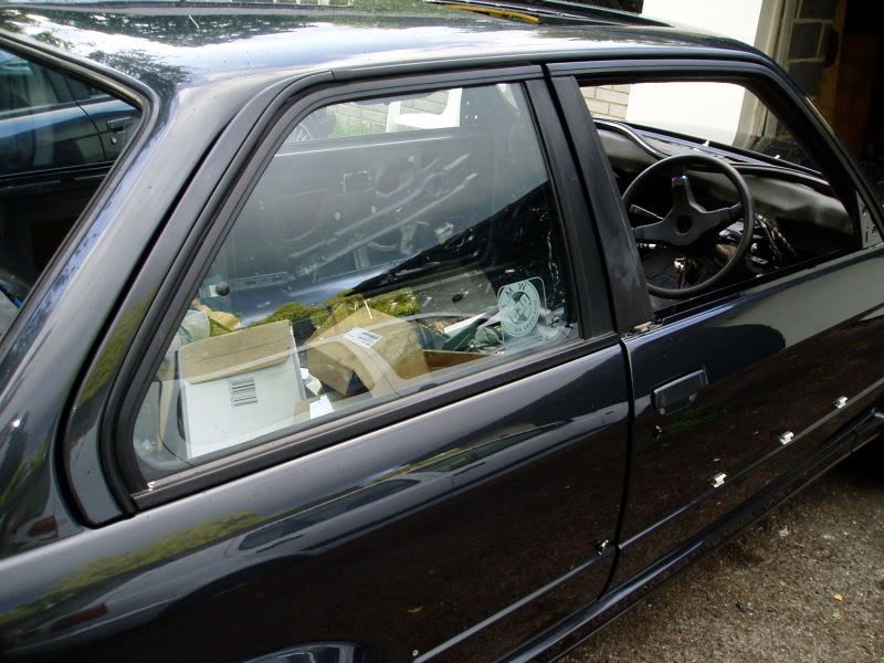

After playing around trying to repaint the C-pillar trims i bit the bullet and bought 2 new ones this week, £30 each :clin: fitting these back on means the long shadowline gutter trim can go back on. This wasn't as traumatic as i thought it might be. Alas only drivers side could be done as the new passenger side trim is scratched! So i'll be taking that back, after waiting 3 days for it to come from Germany.
Then i took a step backwards and nearly removed the black head line as i though i had done it wrong. Turns out in my mind i hadn't made the mistake i originally thought :hammer: Which was not clipping the metal bar to the sunroof tray. Which i did tonight and it looked a mess. So i'm going to put it all back to how it was 2moro night after work! deja vu
