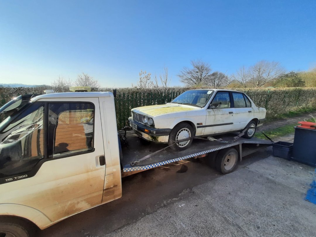

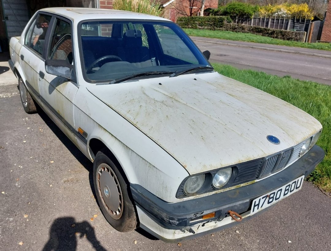

After a few months of waiting, pricing things up, garage clearing and diary organising, the day finally came and the car was picked up and moved on a bright Saturday morning from Bristol back to Hampshire. Shout-out to James from ARMovements on Shiply, really professional service at a competitive price too. The car is now at her new home in Hampshire, and after a bit of a clean is ready for work to start. Seven odd years of moss and muck and other detritus was making her look a little less than optimal!

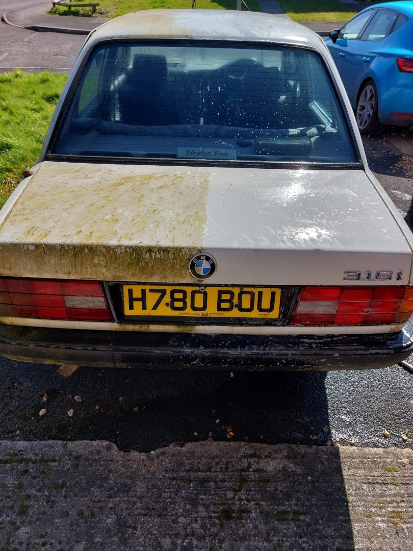

I also took a quick "half and half shot to illustrate quite how bad it was at the back of the car too...

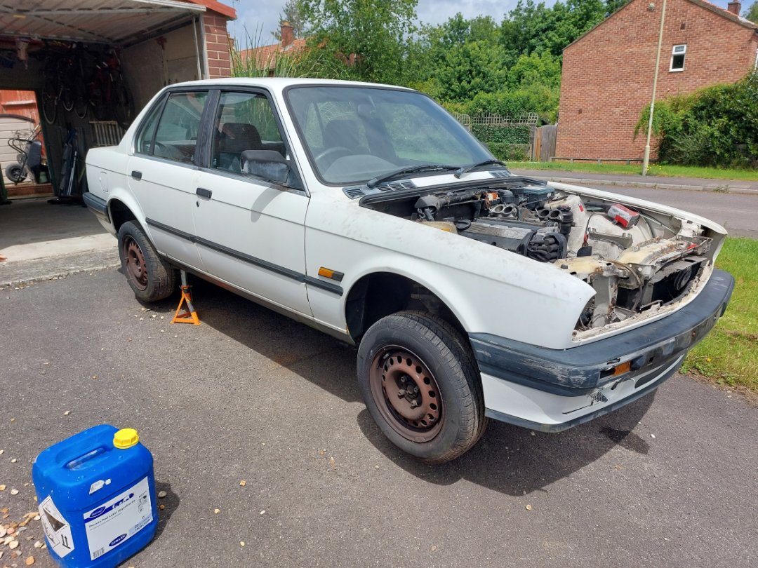

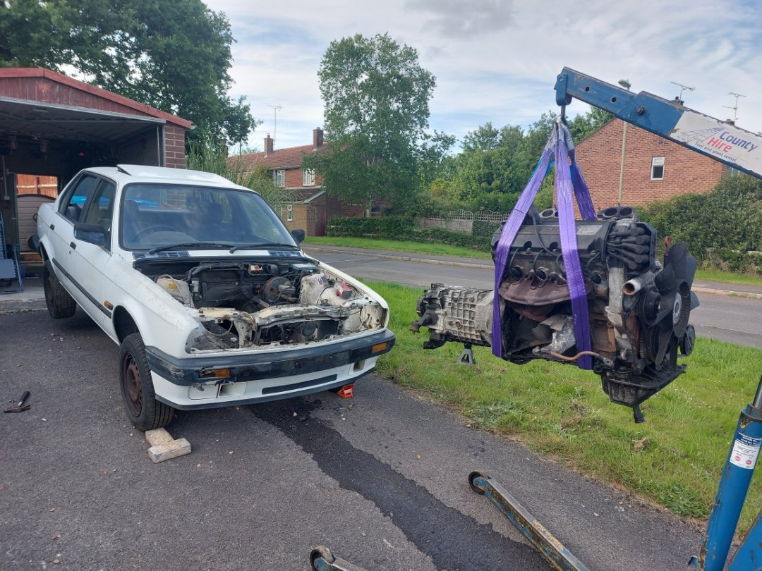

It has been a little while, but recently a clear weekend, my wife being away and some mates being free all lined up... it was time to remove the engine. After removing the bonnet and most of the front end trim, the car was ready to go up on axle stands and my mates and I could start taking everything off that needed to come off in order to lift the engine out.
The exhaust was easy enough but a bit fiddly to reach at the front end. Same again with the gear linkage, slave cylinder etc. Where we really encountered difficulties was in getting the driveshaft off, as the bolt heads were surrounding by a large collar making access very tricky. In the end we removed the engine with the front section of drive shaft attached and then managed to detach it from the gearbox more easily as we had a bit more room to access things. Still a fiddly job though!
After everything was disconnected it was time to start lifting the engine clear. We dropped the front down to give us more of an "angle of attack" and it came out really easily in the end.
The engine is now safely on a stand ready for the next stage of the job - break down, clean and fix the engine, as well as clean up the engine bay and steering rack. Its evident the car suffered a monumental oil leak at some stage in its life because the steering rack and front subframe is absolutely covered in the stuff.

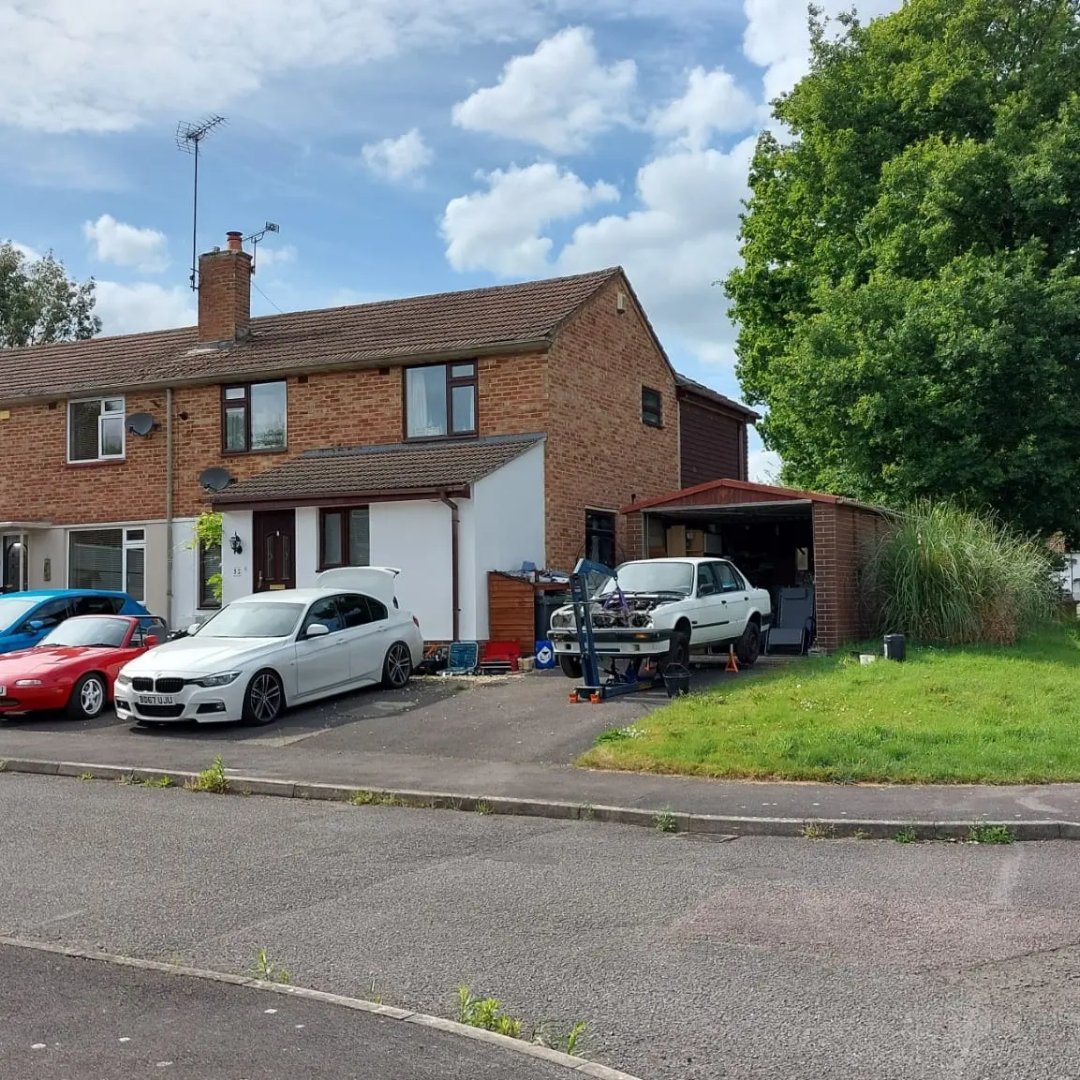

I really like this last image of the car, whilst its up on stands because its alongside my friends more modern 3 series - definitely prefer the old style!!!
