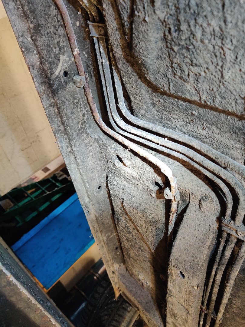

Brake lines look solid but the fuel line is rusted and does need to be changed.

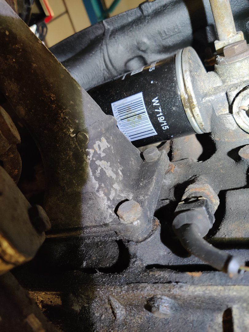

Oil filter is a known problem, and there's a kit of modified parts available for a permanent cure.

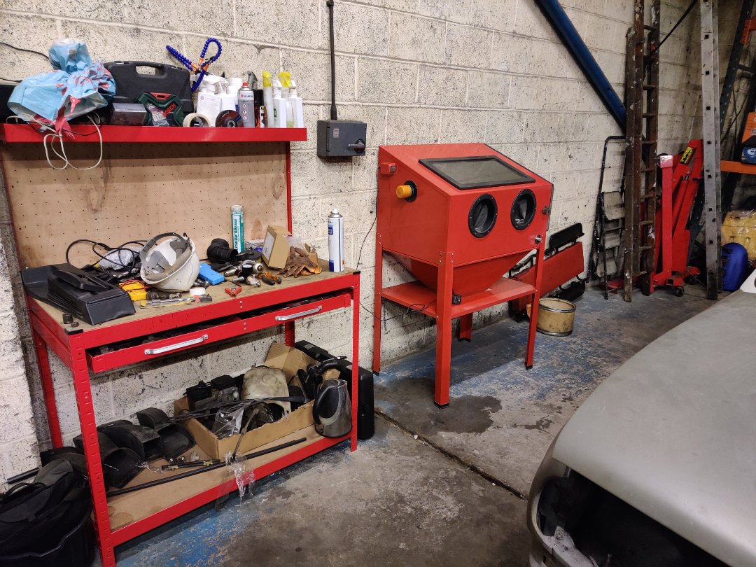

Got around to the front suspension this week. I've got the workshop clean enough and organised. Enough space to work on the E30 comfortably.
I bought a sandblaster for the suspension parts and I have all the new ball joints, top mounts, shocks, springs and rubbers to go back onto the car.
I need to clean the arches and undercoat them, I'm planning on painting the control arms and shock arms in black hammerite, I was thinking of thinning it and spraying it through an old gun to get a better finish.

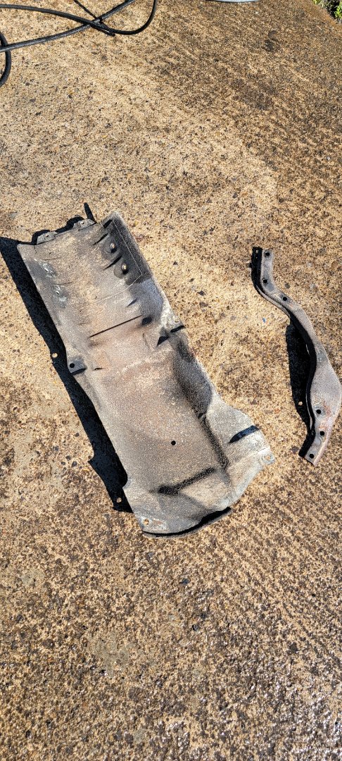

Does anyone know what this bracket is on the driver side arch

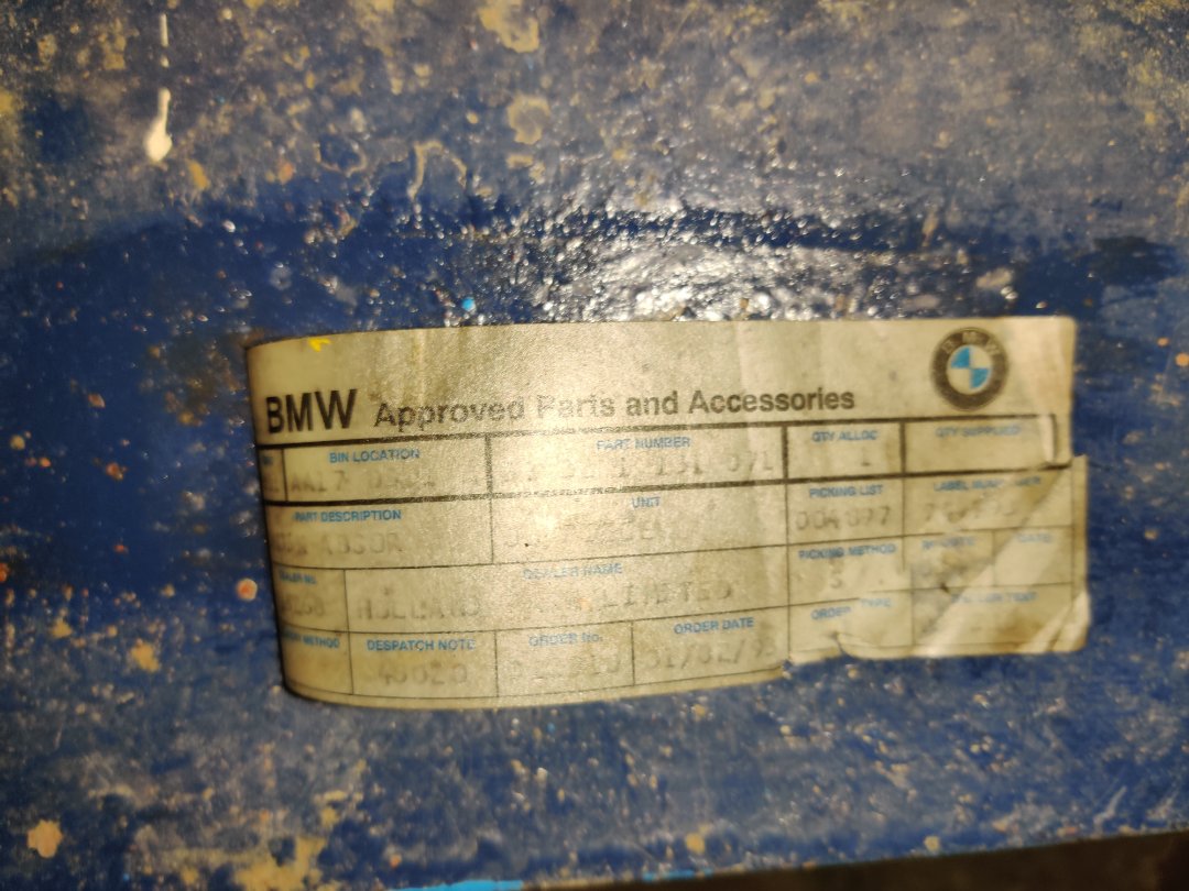

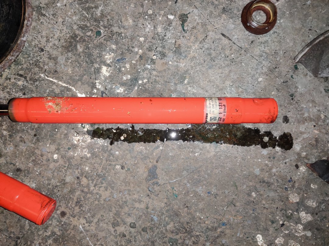

I stripped down both front struts, one wheel bearing nut was a pain in the arse really. Went well without any real issues.
It had original struts inside and I found a BMW order sticker with an order date of 1992 so these could be the original possibly.
I also tried out the sandblaster, it works well for about 10 seconds and then it seems as if the feed is blocked and no media is being blasted. So I'm planning on doing a gravity feed supply for the gun hopefully in the next couple of weeks.
I still need to order the front wheel bearings, anti roll bar links, tie rods and brake components to have everything ready on the front. But I have the parts to get the control arms and struts back together.

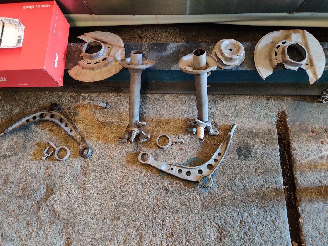

Got a bit done on the E30, all the front suspension bits are blasted and ready to be sprayed with epoxy primer and then black hammerite. Hopefully done next weekend so I can get the front suspension back together.

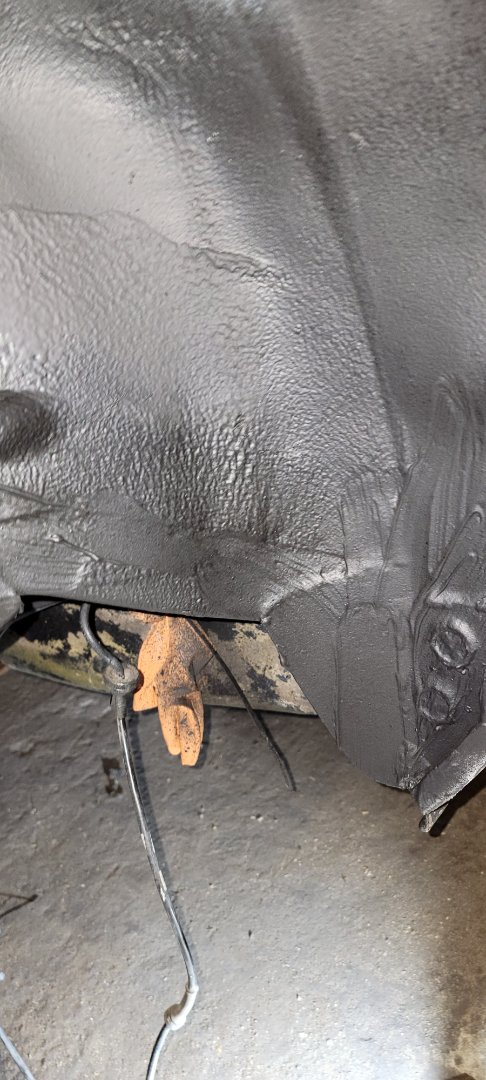

Both front arches have been cleaned with my steam cleaner, still need a final rinse to get the remaining dirt off. I'll possibly use a jet wash as the pressure washer was good in loosening the dirt but not too good at shifting it.
I did break a few of the threaded studs holding the arch liner in. How do I go about replacing those. Should I weld a bolt with the same thread or is there a replacement from BMW.

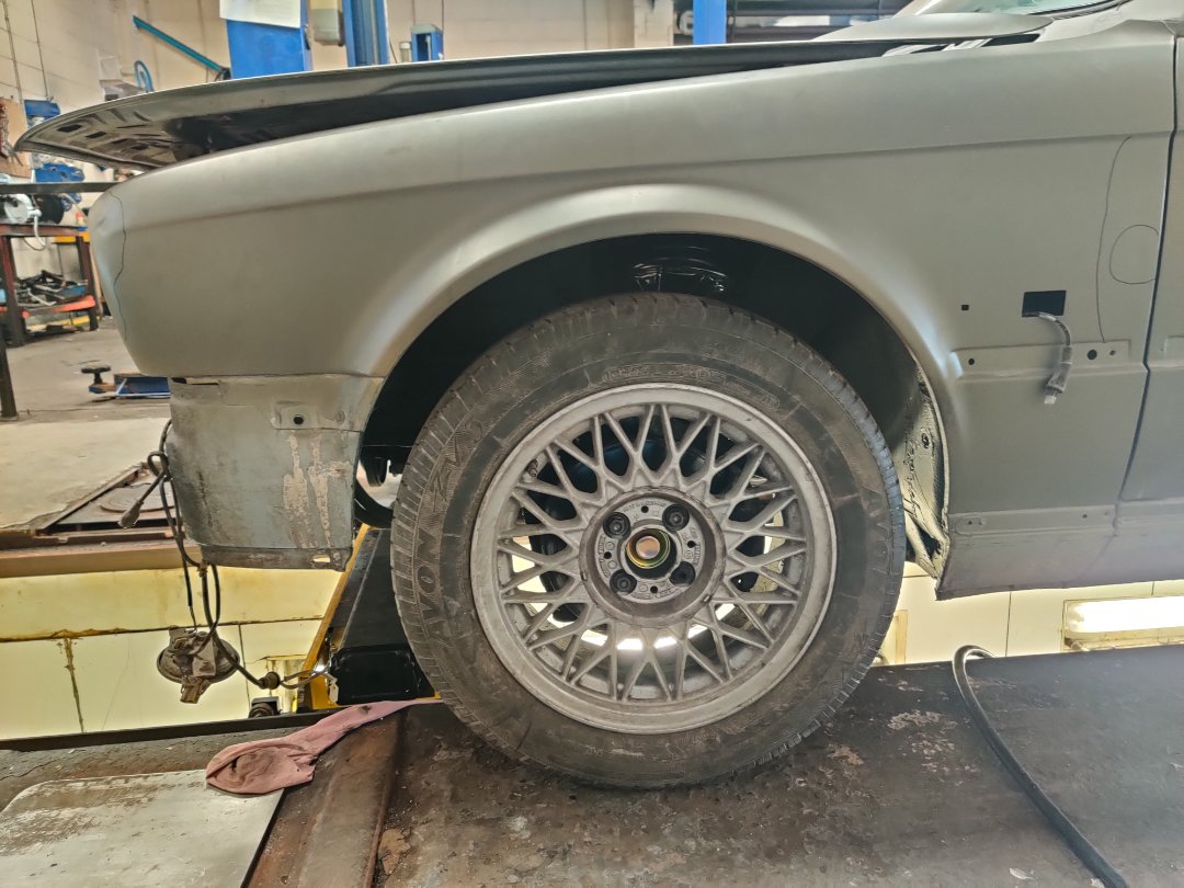

Some new wheels have been sourced and I'll get some pics when the suspension is back on the car.

Nice update
Loving the azev's, my own personal rim of choice, they look like a staggered set?

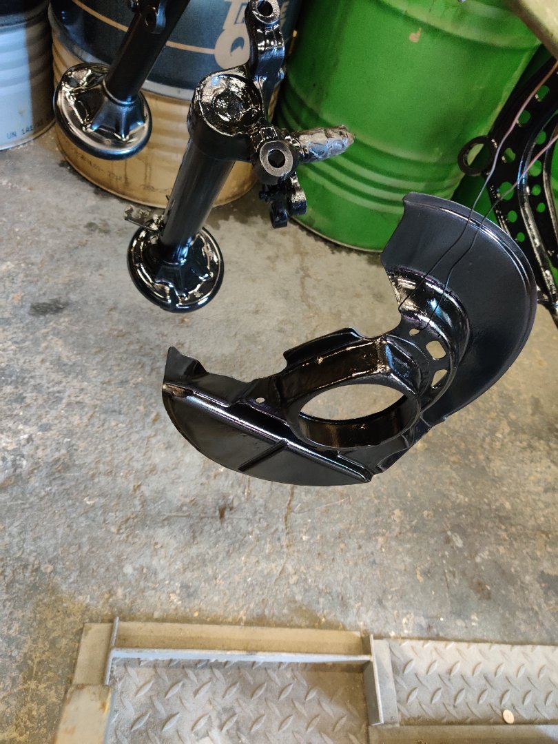

Got the arches cleaned a bit more and the suspension parts sprayed up. I'm hoping to get it back together this weekend and the car back on the ground.
After this, I only have the braking system to refresh on the front and the Z3 rack to install in the future sometime.

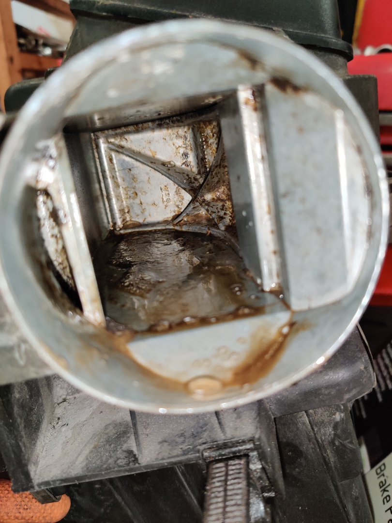

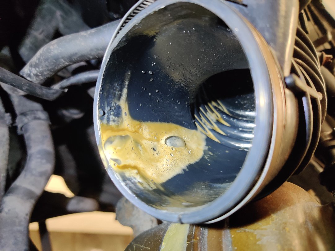

The car is still running rich so I thought I would check for air leaks again, I found a oily/water mixture in the intake pipe and similar sort of thing in the air box. I haven't started it for 2 weeks before this and this was after it was running for about 30 minutes. I'm not really too sure what's going on with it. I still need to change the valve cover gasket and the blind plugs as there is still oil leaking down the front of the engine. Possibly an air leak around those areas.
Does anyone know of any E30 specialists in Yorkshire?
- Brianmoooore
- Posts: 49358
An air leak into the inlet side, after the AFM, will make the fuel mixture weak, not rich.
Traces of oil/emulsion in the big hose are normal, although yours looks a bit excessive. Burning petrol produces lots of water, and some of that water will end up in the oil, where it will stay until oil temperature reaches 90 degrees or so. If you've been running this engine for short periods only for some time, there'll be a lot of water in the oil, which in turn, might be leading to the excessive amounts in the hose. I wouldn't worry too much about it until the car is on the road and getting fully warmed up.
If you have the valve cover off, try to clean out the area on the underside of the cover, where the vent pipe is. There's a labyrinth oil separator there, and if this is gunged up and holding oil, more will end up flowing out the vent.

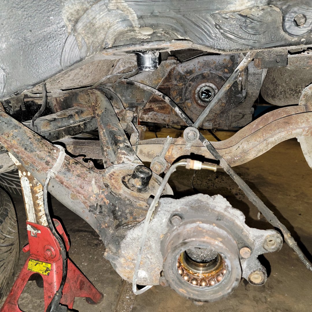

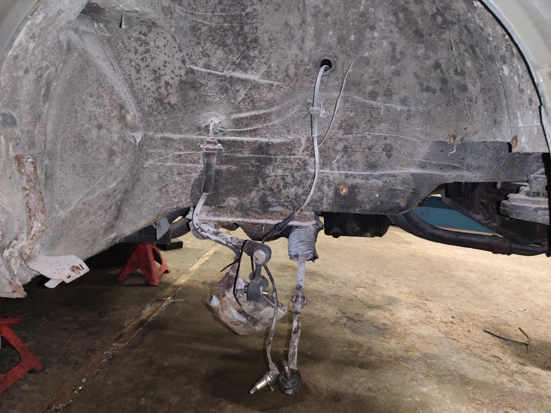

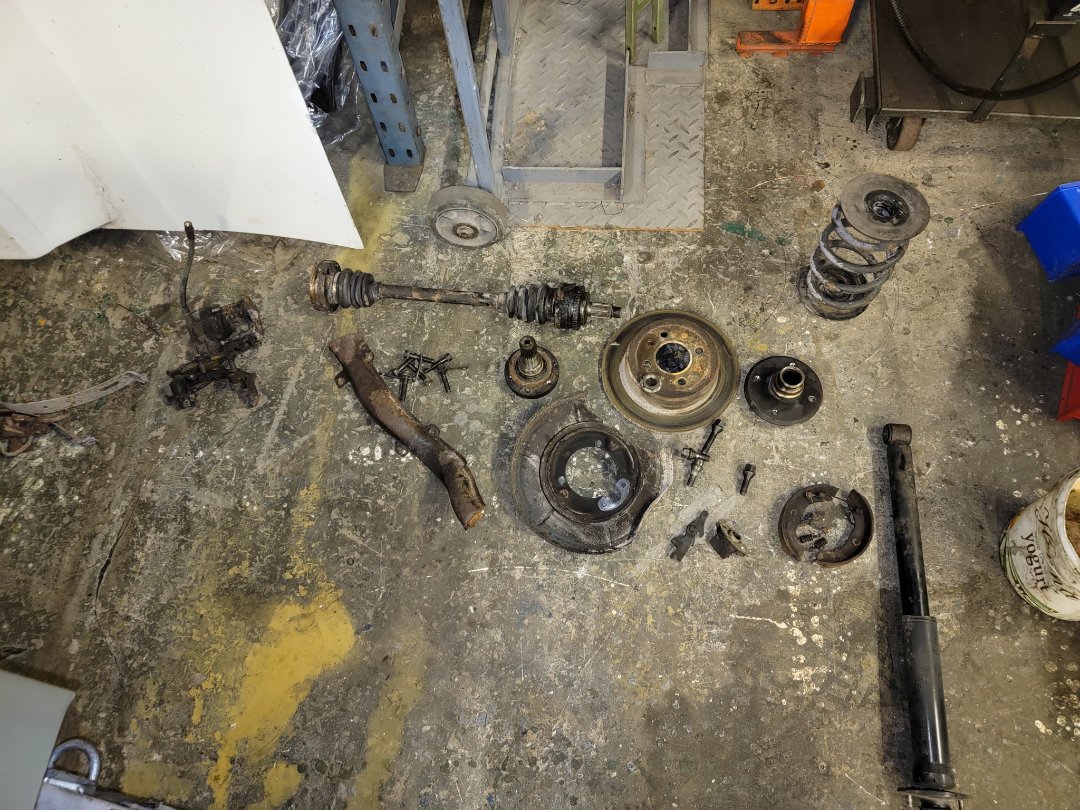

I got the majority of the rear suspension off today. I wasn't planning on dropping the rear subframe but it seems a lot easier than trying to undo the control arm bolts in place. So next week I have the exhaust and then the subframe to drop.
I'm trying to get some more pictures uploaded but it seems they're too big. I'll have to find a way around it

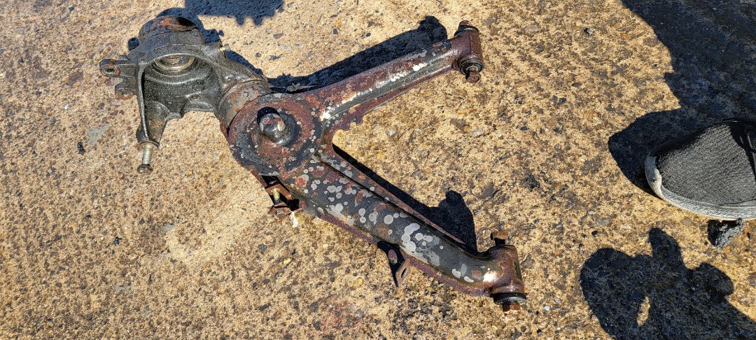

Anyway, one of the hubs took me about an hour to get out, a proper nightmare. Got it out with a lot of heat, slide hammer and using the wheel bolts on some metal plates.

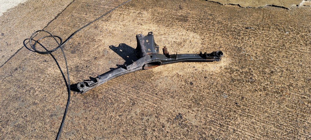

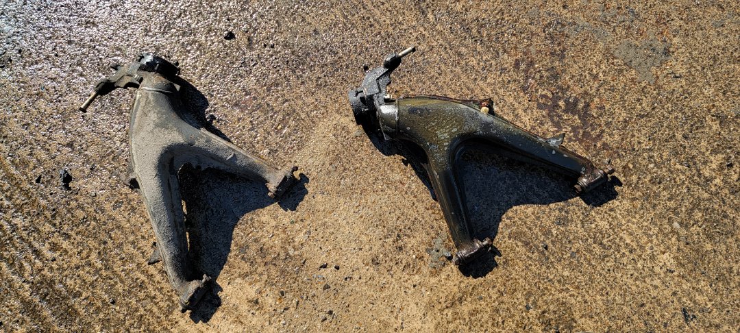

Rear subframe is out and majority has been blasted. The rear subframe is gonna need to be cleaned up by a wire wheel and take it from there.
Here are some before and after jetwashing and some 50\50 blasting. I never got any pictures after finishing the control Arms and heat shields.

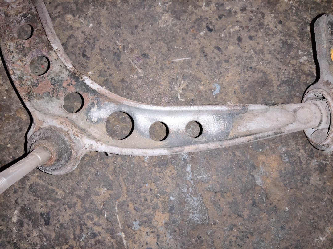

A before and after, not much progress, I'm hoping to get the rest of the parts blasted this weekend. One control arm, one bracket and the large heat shield left to do.

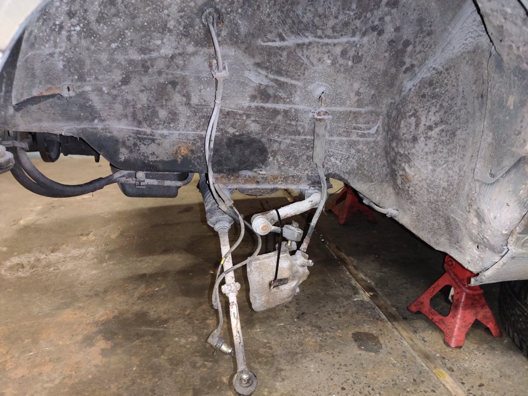

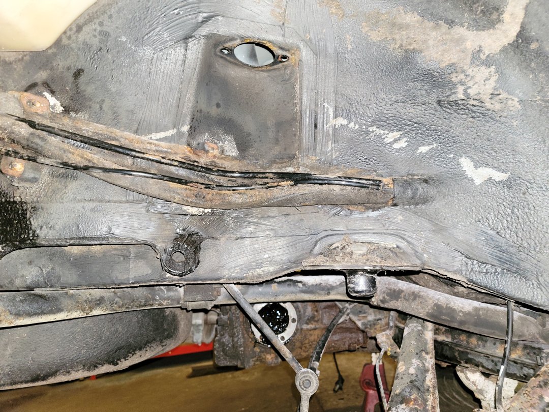

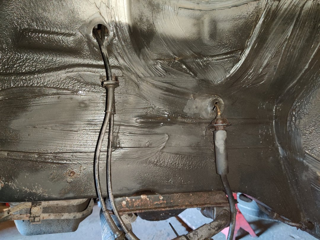

The rear is currently stripped, I bought a brake and fuel line kit made out of kunifer from eBay to replace all the lines whilst I'm there. I started bending the rear control arm lines and it seems they're slightly shorter or my bends aren't so accurate.
Anyway I'll wait to get it back ok the car before adjusting the bends. It is stripped bare underneath, the areas that have some surface rust have been ground down and treated with some deox rust gel. I'll be spraying some epoxy primer and then hammerite. Finally going over it all with wurth underseal as I did with the front. The control arms are almost done, one needs touching up with the hammerite. The bushes are in and once the underside has been coated, I'll start putting everything in place.

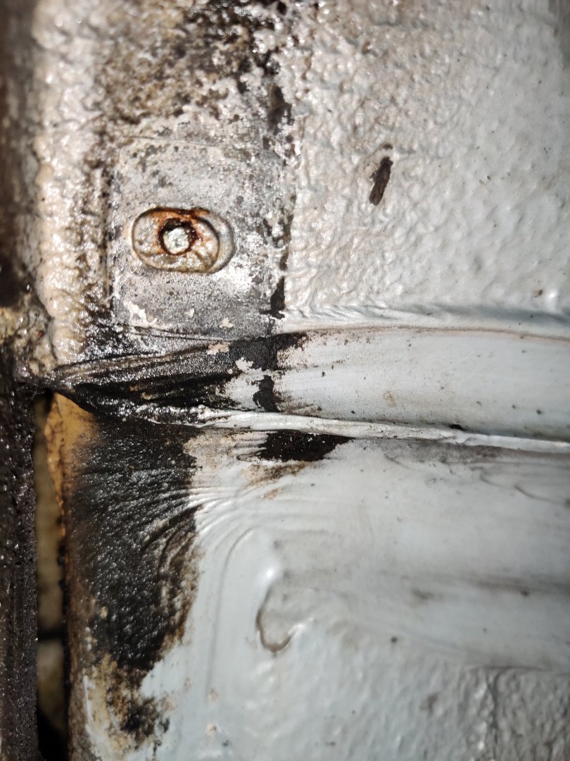

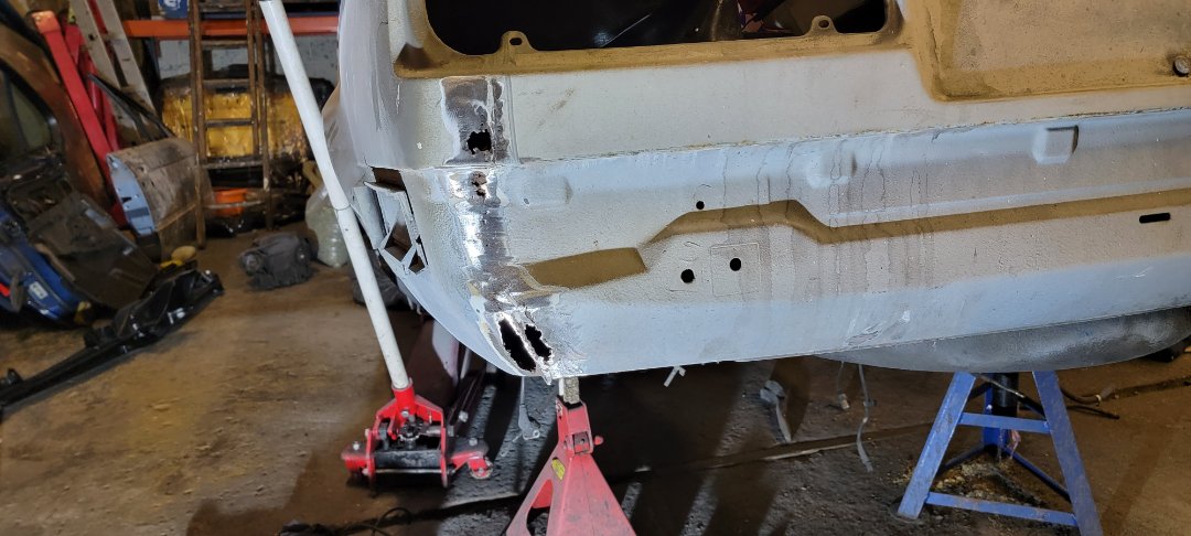

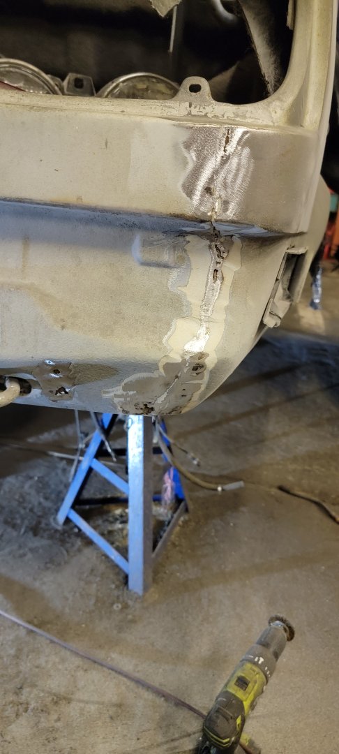

I discovered some rust on the rear panel, it's along where the seams are between the rear panel and the quarter. It is more on the passenger side. I was wondering if this is a common place for these to rust and how should I go about replacing it.
Anyway I've been reading up on the other builds on here and I'm determined to get mine back together this winter.

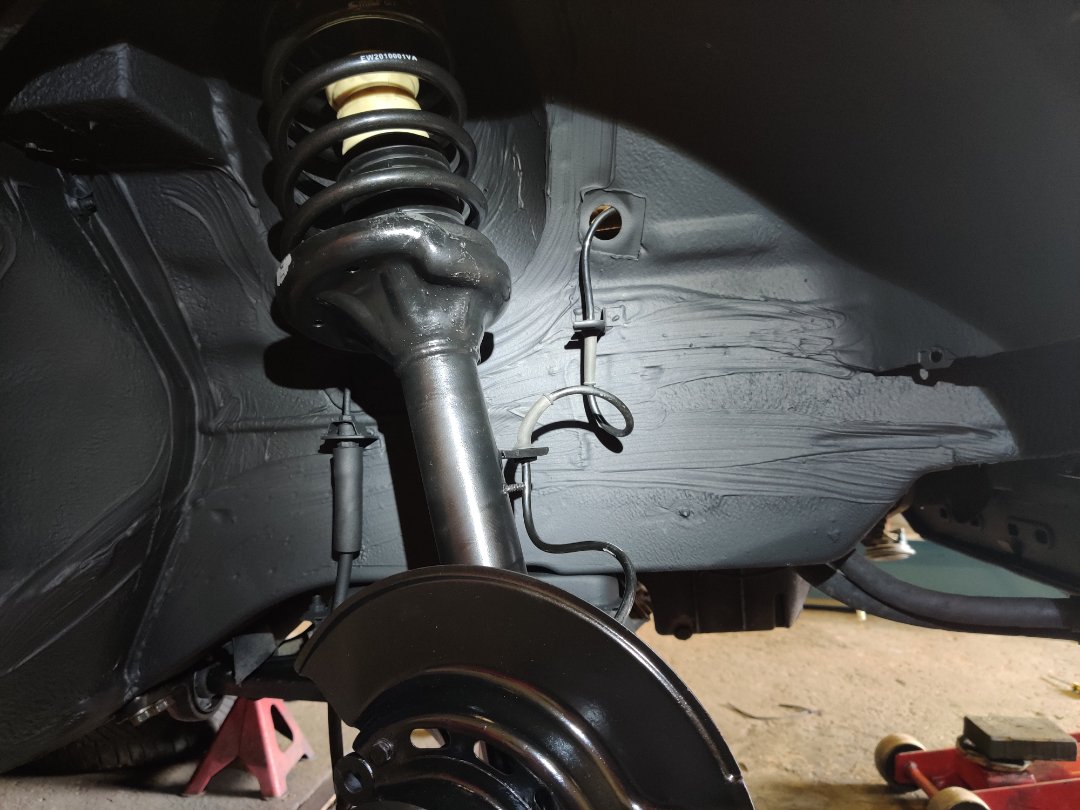

So the week is nearly over. I've got the small bits of rust on the underside wire brushed, treated with Bilt Hamber deox gel, then epoxy primer and black hammerite sprayed on top. The next step will be to undercoat with some wurth stoneguard which will finish it off.
I got around to getting the last of the bits and pieces sprayed in epoxy and then hammerite but I missed the rear subframe plates that go on the bottom and the plates that are mounted on the outer surface of the sill. So I need to get them sprayed over this weekend, I'm having to order the spacer that goes ontop of the subframe mount as I can't remember where I've put them.
I can't believe i missed one, I only found it when I finished everything else.
So hopefully I can start rebuilding the rear suspension next weekend. The brake line running to the front, I'm going to keep the original for now as it's a bit difficult to get it out with the angle the car is at and would be much easier on a ramp. So I'll do that when I drop the fuel tank, hopefully with the car on a lift.

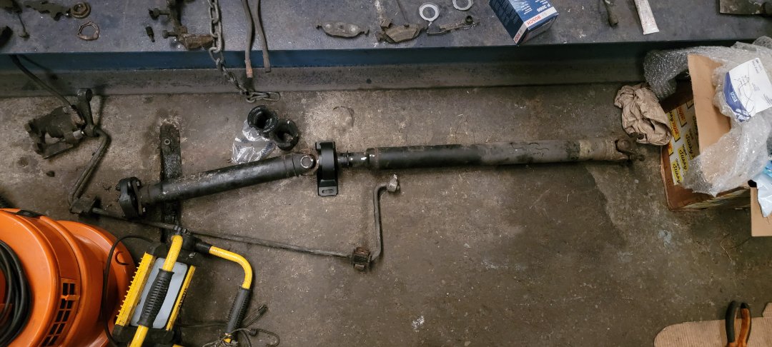

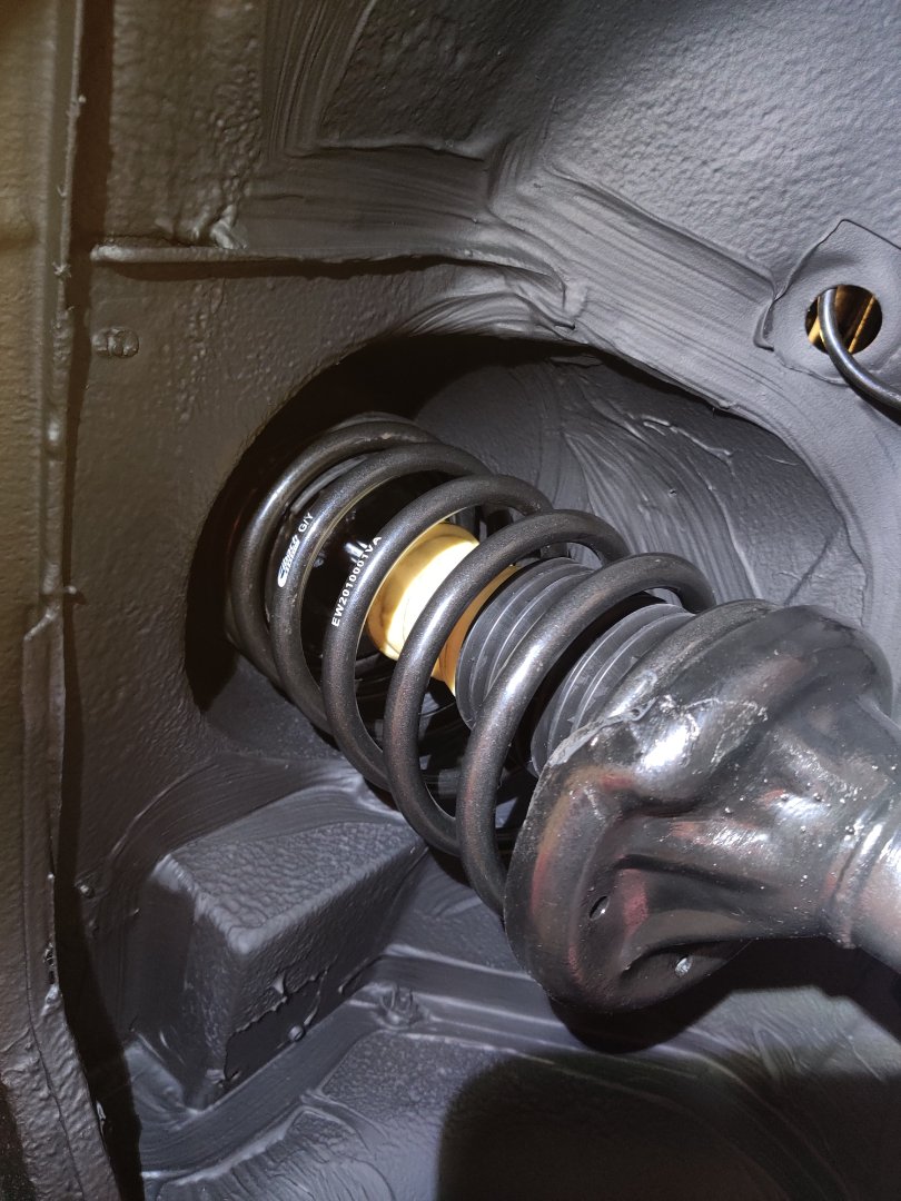

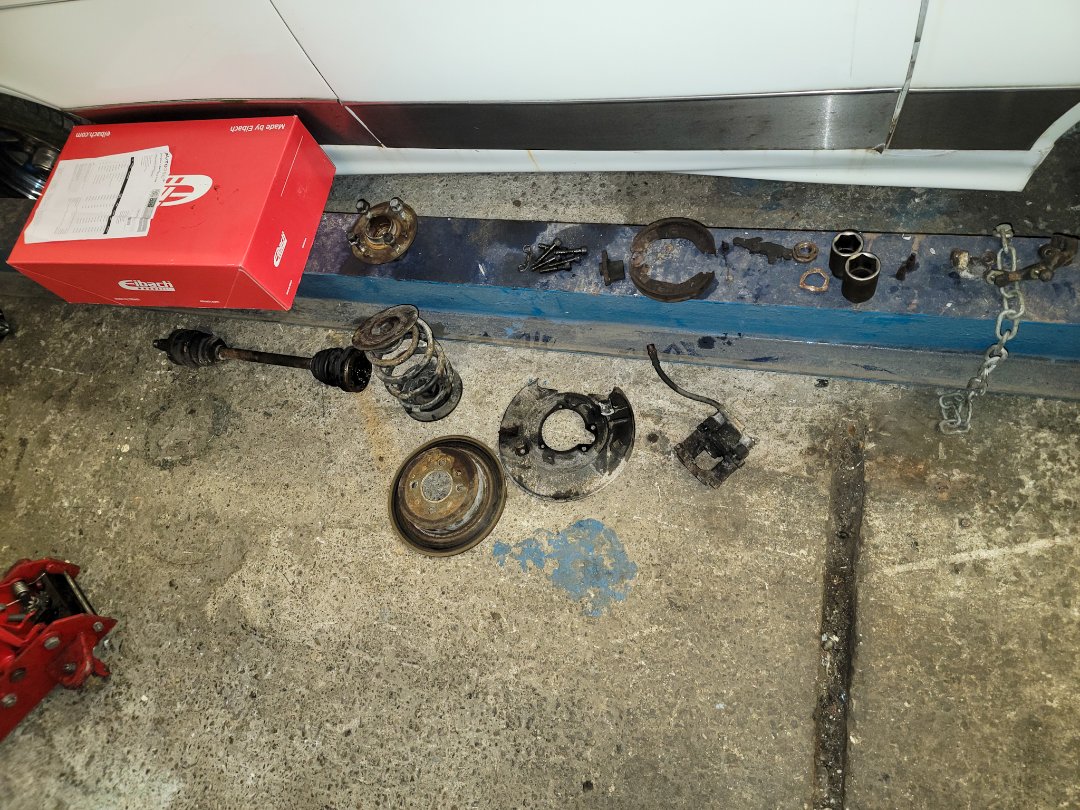

I started putting the rear subframe back together. I bolted the control arms to the subframe and am now waiting on the spacers from BMW and I need to spray the brackets that hold it before I can continue.
I changed the propshaft centre bearing and the vibration damper. I didn't realize they had a circlip on the inside but once that was off, it went fairly smoothly. That seemed to go well. Another job down.
I have a pile of brake parts to get on once the subframe is on the car.
I'll hopefully get around to spraying the last few bits and back on for the following week.

I'm in the process of refitting the back end, I've got the subframe back on, I've fitted the backing plates ,abs sensors. I'm hoping to get the hub and driveshafts in this weekend along with the handbrake shoes, discs , pads and callipers. I need to fit all the suspension and springs also.
There is a rubber piece that is in the screw on part of the propshaft which has deteriorated and broke into a few pieces so that's another thing I have to order before putting that back together.
The diff I haven't painted yet so I'm thinking of cleaning it up and giving it a coat of hammerite, I love the sprayed finish but I'm not sure how I'm going do the diff. I have a crane in the unit so I could probably hang it from the input shaft or rubber mounting point, not sure if that'll cause any issues or damage to the internals as it is quite heavy.
The underside has been undercoated now, I don't have many pictures as I keep on forgetting to take them as the job progresses.

The car is finally back on the floor and had a taste of snow for the first time in 11 years.
I started cleaning the underside in the middle section ready for new underseal. I broke out the steam cleaner and got to work, I removed all the old underseal that would come off and wire brushed any rust back. Covered it in Bilt Hamber and parked it back.
I'm going to etch prime and then underseal next week hopefully. I still need to change the center brake pipe running from the front to the back and fuel lines also.

I have been cleaning the centre section, here are some before and afters. There is minor surface rust, I have found a hole about the size of a 5 pence piece in the rear floor where there is a join, I'm going to etch primer all these areas and patch the hole when I've got access to a welder. I was thinking of fiberglass but I'd rather do it once and do it properly.
Still have the centre brake line to replace. I have fuel lines included in the kit also, but I would prefer changing them when it's on a ramp.
There is some rust on the front of the sills where the wing sits. I've seen they do commonly rust from inside the wing also. I've been thinking of removing the wings and treating it from the inside. I've got about 4 weekends left before I want to give it for paint. So shortly after the new year and it'll be 2 weeks for the kit to arrive from France.

There has been some work done over the last few months, the front wings were removed and the sills were stripped of their paint which showed some areas of rust. I have used Bilt Hamber deox gel on them repeatedly. I am still waiting to paint them in etch as my compressor was playing up.
The driver's side was by far the worst, both sides were blocked with dirt and debris stopping water flowing out. The driver's side had some small holes but the majority of it was solid, I will be getting the body worker to patch these also.
My washer bottle bracket also was rusted completely, i will need to cut this out and create a new one to weld in.
I got my Mtech 1 rear bumper off the shelf, it was crudely screwed into a metal bumper with self tapping screws. It is in one piece and should be okay after a repaint.
My front wings are also fairly intact, they will need some repair which my body worker is happy to undertake.
This is where we are currently, the car is on a lift where it can stay during the week as i only have weekends to work on it. The centre brake line has been changed and now I just have the fuel pipes remaining. Then etch and underseal the undercarriage. Once it is back together, I want to remove the carpet and check the floor for any rust and get it to the body shop.
And the pipe bends are not as nice as the factory ones but it was difficult due to having the rear subframe already in place. There was a point I did think to leave the centre pipe as it had no visible rust or damage but as soon as I undid the front joint it cracked in the middle without much movement, it was still in the plastic brackets.
