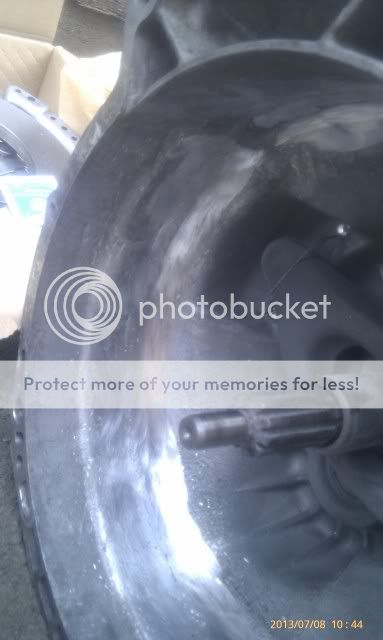

new donk arrives tomorrow,the gearbox is all welded up and ground flush,new flywheel lightened properly and the NEW sachs clutch is waiting.

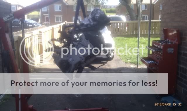

Mon Jul 08, 2013 8:29 pm

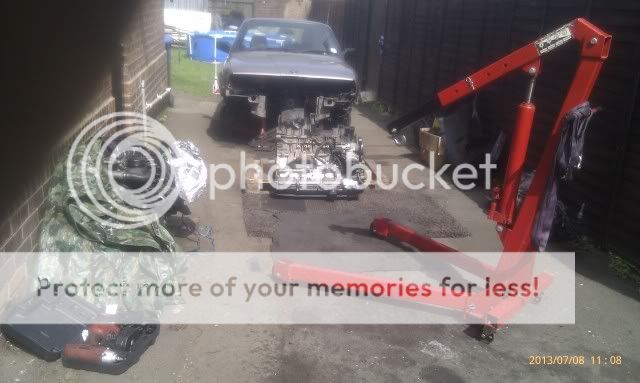

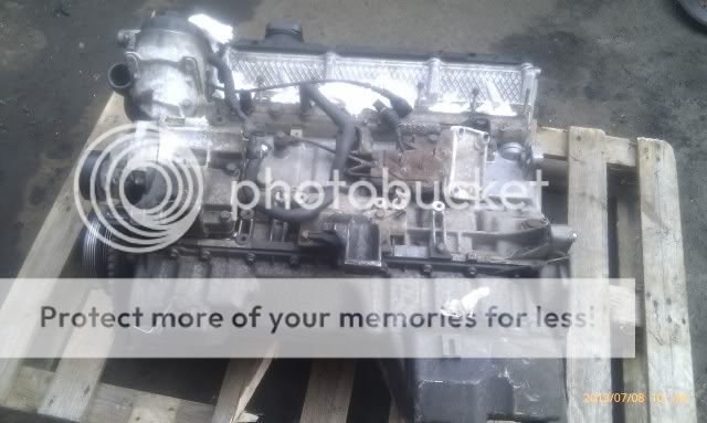

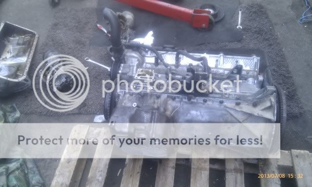

managed to get some work on the new engine done today in instalments,i never got as far on as i'd hoped but have other commitments to juggle with this........anyhoo >>>>>>>>>>>>
today's action .

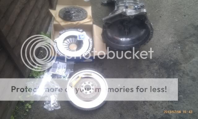

new clutch and flywheel bolts,new pick up pipe gasket etc
new engine :D
welded box
new engine ready for some sump action winkeye
sump fitted and swapping lots of parts out for all the known good ones from my blown engine.

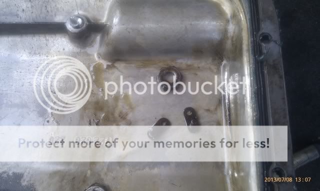

when i took the sump off my old donk i found these in the bottom of it :(
a couple of timing chain links and the nut off the oil pump sprocket so it looks like the nut came undone and the oil pump never pumped :cry:
nice view from the shade 8)

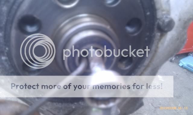

retrieving my new spigot bearing with the nut/bolt/Allen key trick

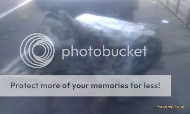

big lump of ally scrap .

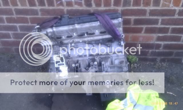

new engine all covered up ready to go in.......hope i can find it again :snigger:

i'm surprised by the oil pump nut I've just rebuilt the pump on my B3 and its the same. The thread is a left hand one, which makes sense as it rotates anti clockwise compared to the clockwise rotation of the engine. The crank nose nuts are threaded right handed, so neither should come off as the rotation keeps them tight.
I'd suspect someone has been there before? that oil pump nut is supposed to be 47Nm

Sounds to me like the crank bolt hasnt been tightened up, and its broke the woodruff key.
Will find out when Mick gets round to stripping it down

Oil pump sprocket nut coming loose is a common problem on the S50. When I bought my S50, the first thing I was told to do was undo the nut and loctite it back on. The nut was only just finger tight on mine 8O
Afaik, the advice was mainly for the S50B32, but luckily I checked it on my B30 anyway.
The M50/52 uses the same pump as the S50B30, so I always loctite the nut on just to be sure.

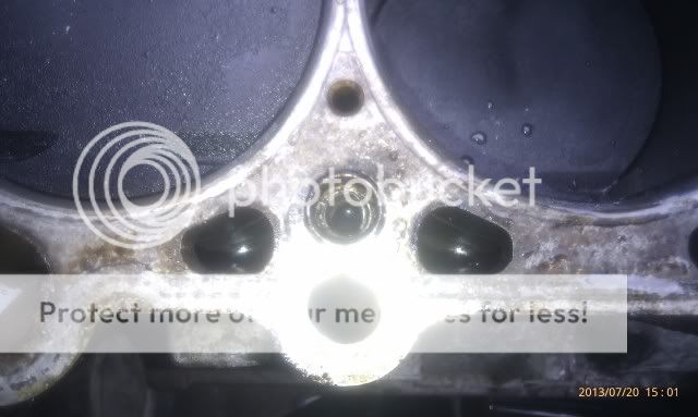

Sat Jul 20, 2013 4:41 pm

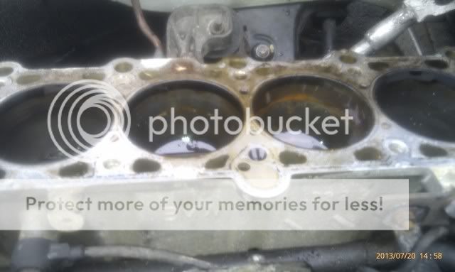

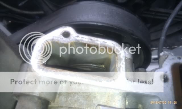

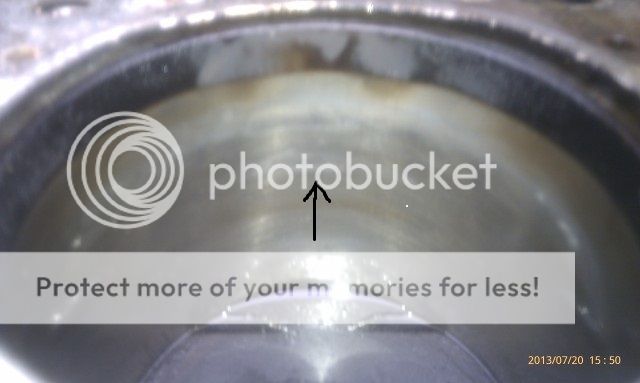

just got round to taking the head off today as my life [yes i do have one] got in the way of the cars work for a change .
it all came apart without issue and there are no visible cracks in the head :D
it looks like the head gasket has gone on cylinders 3&4.there were water marks in the cylinders here and a small amount of water in both .
Craigeeb inspected this [white mark/line] fully as his block was cracked here and it's not cracked and appears to be a water stain.
thanks again for your time today Craig :thumb:
the head will be delivered to Northern re-bore on Monday for a pressure test and skim and if all good then a new gasket and set of head bolts later i should be able to actually drive it instead of walking past it every day and driving the family bus instead .
