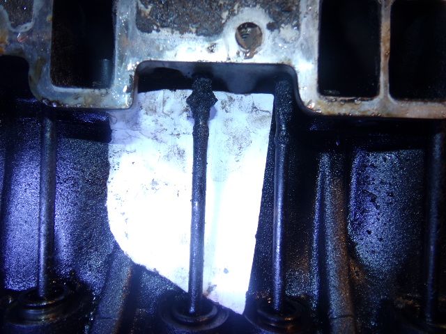

Interesting Mart, interesting. The cylinder with no compression has push rod issues. I turned the car over with just the rocker cover removed to see what was moving. Everything (to an untrained eye) appeared to be operating correctly, ie the rocker arms moved up and down.
See attached pictures of the push rods on the defunct cylinder, they appear to have heavy weld like deposits (none of the other rods have this.
The top end, in my view looks pretty coked up, though does appear to have oil being pumped up there which is promising.
Left Bank..
Right bank with defunct cylinder..
General overview, note all the masking tape notes, so many bloody connections I would never remember how to put it all back together!

Maybe just leaking valve stem seals. Perhaps try cleaning off the crud, particularly the 'weld' with gunk/paraffin/petrol and see how it responds...

Hell I have just looked closer at the pics and in my humble opinion , some one before you had this car had not looked after the oil.
They used to say 6000 miles or 6 months for a change but that was not enough for this engine and if it was not done it would hang on to "crap" like you see in the push rod pics.
People say "its only done 2000 in three years so it should be OK ? "
Wrong.
If you had to flush the engine now , who knows what shit it may disturb but it seems like there could be an oil blockage which may be affecting the lifters?

This is what I am thinking before pulling the head off, a bloody good clean up which it clearly needs and see what happens. I am wondering whether the lumps on the rods are affecting something. Not sure how it would affect compression though.
Are they hydraulic, tell you the truth I don't know, this is all a learning curve for me, I have only changed a head gasket on a Renault 5, and that was a doddle! All the rods seem to do is be pushed up and down by the cam in the bottom of the valley, I would assume by that, they are not hydraulic.
