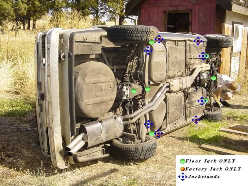

Oops! I guess it's a little late to show you this:

...remembering of course that jacking from the diff or rear beam centre is a bad idea, unless you're actually trying to screw the beam mounting and diff mount bushes!
i use a trolley jack on the plates over the beam bushes themselves as it can't slip off due to the stud sitting in the cup on the jack (if it has one).
that said, jacking from the sump is really really silly and is best avoided!!!! :D
