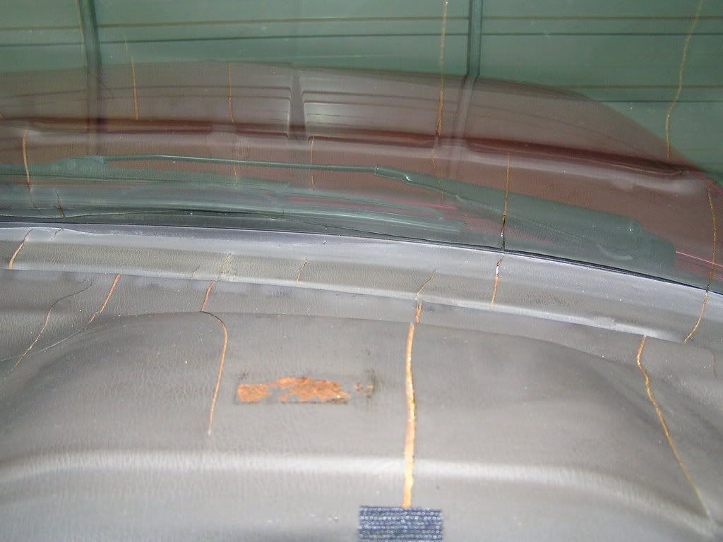

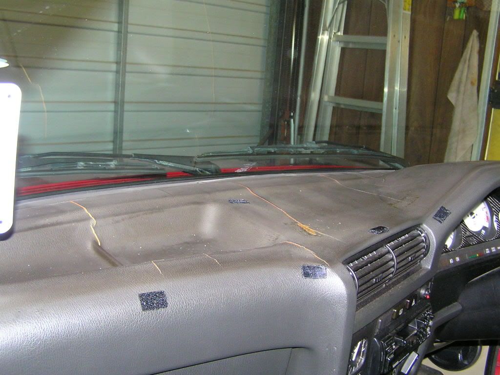

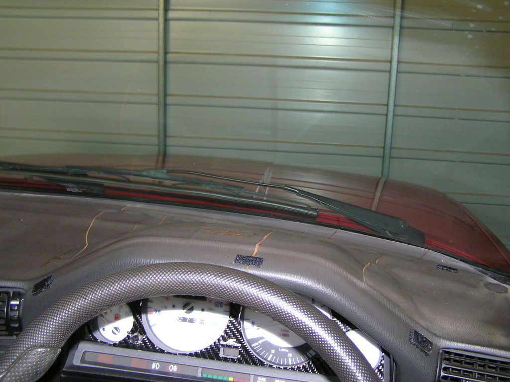

For those of you who are lucky enough to live in a more dashboard friendly environment and have never seen a cracked dash allow me to ruin your day...
Thank god for my dash mat which hides this horrible sight.

^^^Man, that's bad!^^^ Anyone seen a worse one?

That last photo is the worst that I have seen,where in the world are you?makes my 2in crack insignifiant!!

In perth which is on the west coast of Australia, it can get pretty warm in summer and i don't think it was looked after too well before i got it.

bwaterman_m20b23 wrote:For those of you who are lucky enough to live in a more dashboard friendly environment and have never seen a cracked dash allow me to ruin your day...
Is the actual "fibreboard" of the dash damaged or is just the covering vinyl?

E30 dash is made of foam covered steel.
