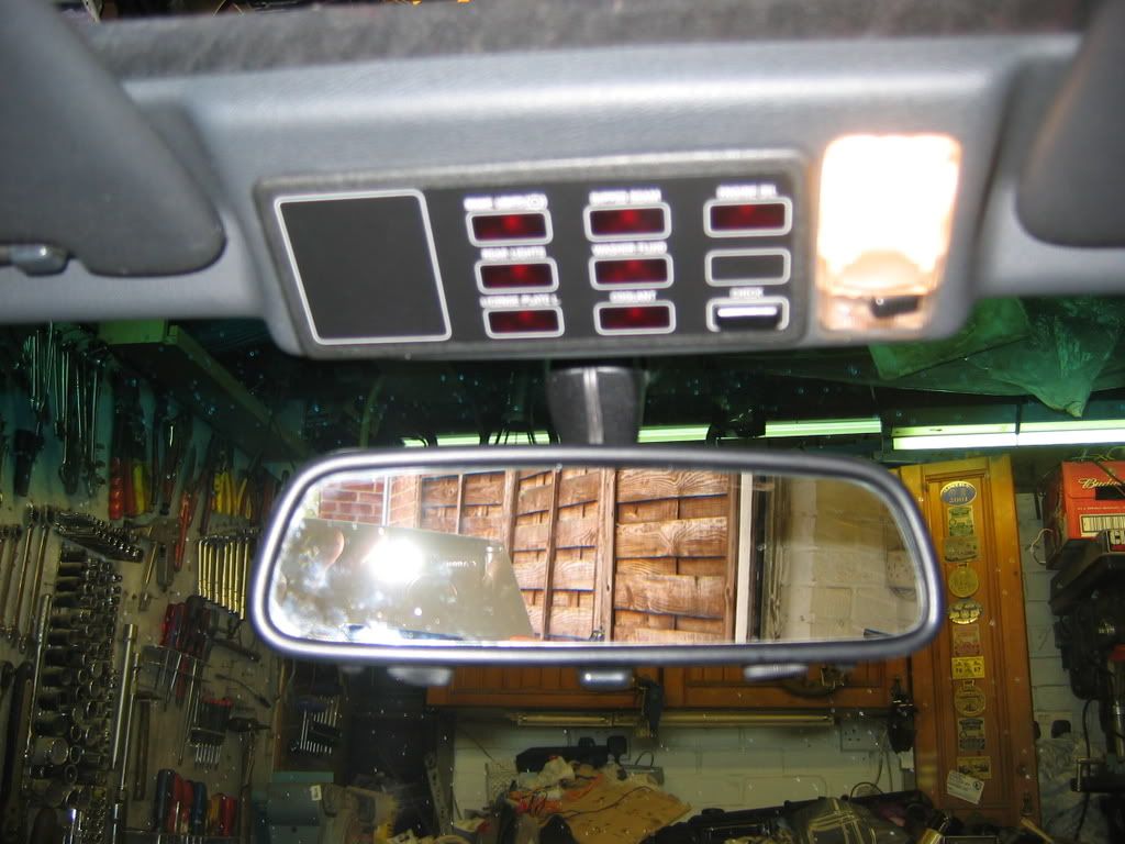

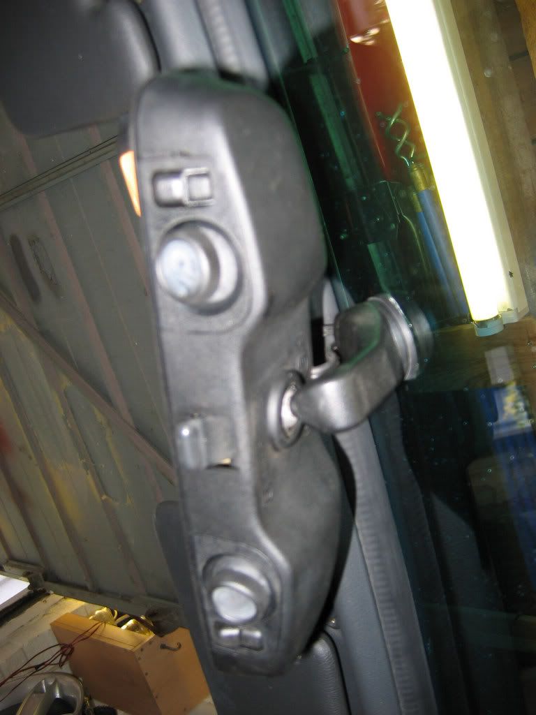

- Posts: 15846
Went for the map lights and it's in and working on my convertible. Peice of p*** as well. Had to change the arm that fixes to the screen from my old mirror to the map light mirror. The only difference is that on the sport the wires run through the mounting arm. I've had to run a descreet back wire into the header rail trim but it looks fine.
Well chuffed.
I'd like to sort the wire out so it's a bit neater but I'm thinking on that one.
