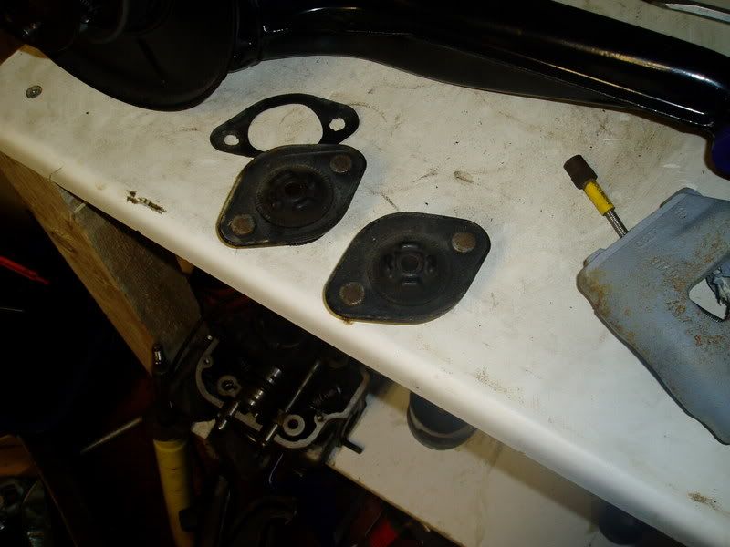

These were fitted to a customers car on their request!
The first two pics show the stock position of the top mount.
On the next two pics the car was jacked up on one side.
As you can see the actual rubber was being pulled trough the top mount and if it was'nt for the top and bottom washers the damper rod would just pop the rubber out of the mount.
These are OEM quality E46 M3 top mounts :roll:
So next time you think you're getting a deal think again!

i also found this as i had to replace mine 3 times in a year.not had a problem since i bought genuine ones.

These top mounts pictured are e46 M3 cabby top mounts, they are about £15 each from the main dealer
These ones pictured have covered 2 trips to the nurburgring on my old sport which was dropped a good 60mm and covered over 30 laps of the circut
approx 30,000miles road use
1 drift day at silverstone - need i say anymore about what happened to the poor car at this day?
They are as strong as when they went on the car new, these will go on the Alpina when she is ready to go, they were also on my 325i auto before she bit the bullet, RIP she went down the scrap yard today :(
So please,please,please tell me why we need to spend all this money on this rogue engineering crap!!!
The price of a pair of rogue mounts buys 6 of these mounts pictured and does the job no better
No brainer!

the ride will be worse with those rogue top mounts. The e46 mounts will probably last a good 100,000 miles too.
So how many on here will cover that in their E30? so they break after that period off i trot to the main dealer and buy another set knowing i'm still £30 up than if i had bought these rogue items?
All my point is the bmw ones will give a better ride, are cheaper and are good for lowered E30's, track work, drifting. Why do you need these top mounts seriously? You need to be an animal to go through 3 sets of these! before you have reached the price of these rogue top mounts!

And you want to know how you ensure that rubber top mounts never wear out? Turn the top cut washer upside down. It makes the top mounts virtually solid yet doesn't transmit any noise. I've even done this on old shitters with wanked top mounts to scrape them through the MOT...............
Nothing wrong with E46 M3 cab bits. The BMW dealer I go to have yet to replace any - what does that tell you?

I've had an e46 m3 rear top mount (genuine BMW) rubber pop clean out of the housing on my IS. Was very strange, was driving into the road I used to live on, went over a speed bump quite gently to be met with lots of banging. got it replaced on the 2yr parts warranty from BM though, so don't really have any complaints. and yes, they were correctly assembled as per the etk. the shock was a newish koni on its medium setting.

tim_s wrote:I've had an e46 m3 rear top mount (genuine BMW) rubber pop clean out of the housing on my IS. Was very strange, was driving into the road I used to live on, went over a speed bump quite gently to be met with lots of banging. got it replaced on the 2yr parts warranty from BM though, so don't really have any complaints. and yes, they were correctly assembled as per the etk. the shock was a newish koni on its medium setting.
This happened to me too, 2 days after the things were put in 8O I was shocked to say the least...I was unlucky that it happened in the sticks, but equally lucky that it actually happened next to a garage :) My shock was saved 8)
Touch wood, they've been ok since then :)
At the end of the day, you get what you pay for, it's just lucky the e46 one's are so cheap from the stealers...the RE must be good, the same as the IE one's...surely..
