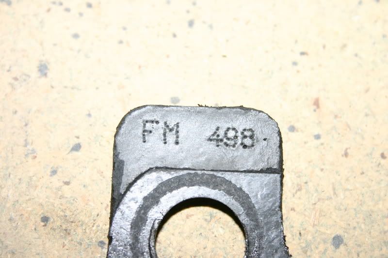

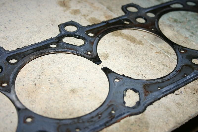

OT that BTB looks naughty with the heat wraps onTempl8e30 wrote:Doesn't look genuine to me, genuine Elring gaskets have red seals around the oilways (those are black) and have 2.5/2.7 on the little tab that has FM 498 on that one.

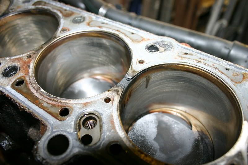

I'd suggest having the head re-faced before refitting it, the block could do with an inspection to make sure it's not damaged between the bores.

Teetee wrote:Didnt think it was. Any ideas on manufacture as I need to find the thickness really. Block and head look good on first inspection. Will be cleaning up and inspecting properly tomorrow.
Ok mate, do it!!!tee wrote:your ok rob. Checked the block and head, all ok. Think we should go for the thickest h/gasket to be on the safe side.
Cheers for that barnz, does not really tell me much about this gasket but will be usefull in the future.Barnz wrote:Teetee wrote:Didnt think it was. Any ideas on manufacture as I need to find the thickness really. Block and head look good on first inspection. Will be cleaning up and inspecting properly tomorrow.
Dont know if this helps but gasket manufacturers numbers for M20 are:
Elring - 694.011 Std (1.75) or 567.818 (oversize 2.05mm)
Reinz - 61-27035-30 Std or 61-27035-20 (o/s)
Ajusa - 10032500 (1.9mm)
Goetze - 30-025354-30 (std) or 30-025384-30 (o/s)
Payen - BL680
Hope this helps

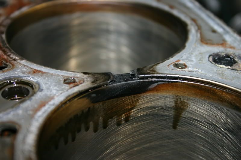

None!! One minute, all was spot on. Next minute, cruising on the m'way, it just lost power - and that was it!!adamS wrote:What symptoms did the car have before you pulled it to bits?
Thats a nasty crack!
