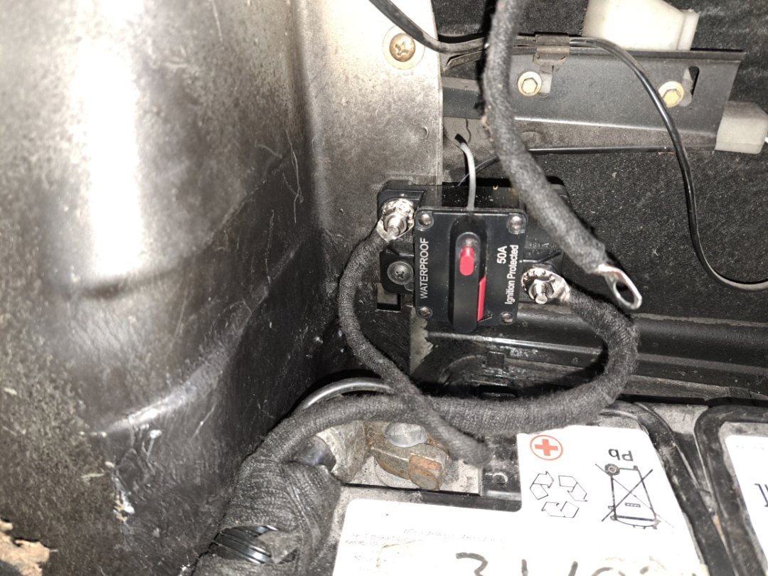

7/ optional approx 30 -40cm away from the battery is an inline 50 amp fuse under heat shrink on the smaller of the two cables, I cut this out and added a 50 amp cut out fuse accessible above the battery.

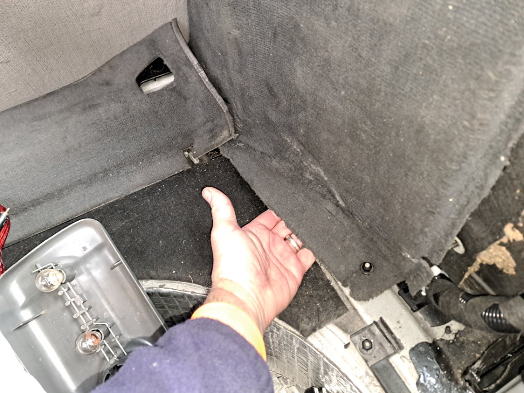

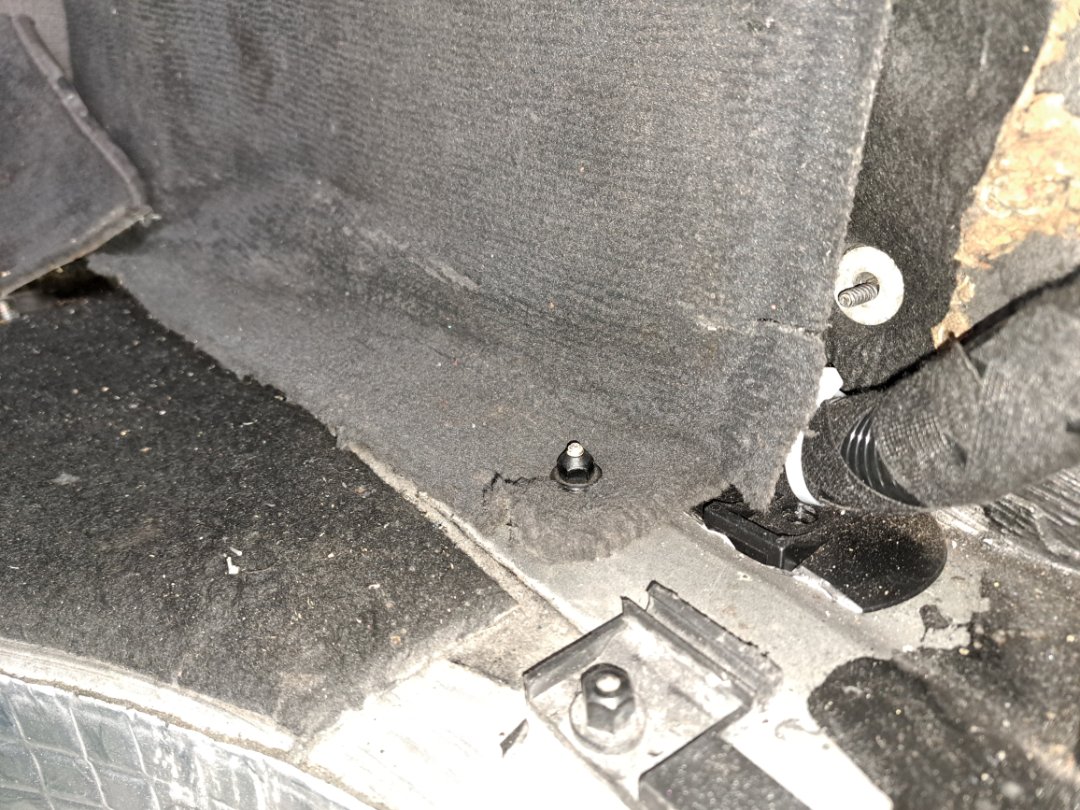

Thanks fixedwheelnut. That's really helpful! Do you have any photos of the hole you cut in the cross section behind the rear seats and how you routed the cable through?

Here you go

That's perfect, thanks :)
