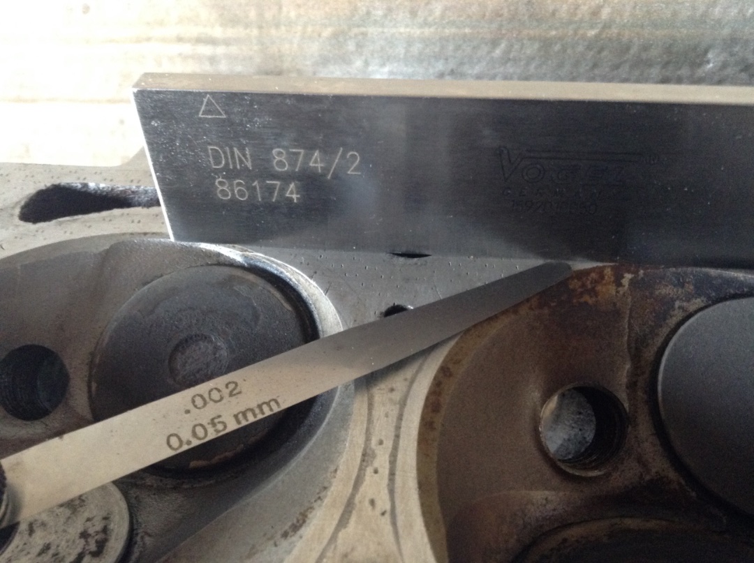

Wed Nov 14, 2018 2:00 pm
So the head is perfectly flat, no warp, good news!
Paul :-)
Checking flatness of head

I thought it would be but I was very curious to know "how" a block could warp and what some people would do to sort it out.

It's unusual, but can happen. Sorted by skimming, just like you would a head.
In an engine with an iron block but an alloy head, there is movement which grinds the head gasket every time the engine is warmed up or allowed to cool. Eventual gasket failure is inevitable.
I'd recommend a light skim for that head, lightly recutting the valve seats and checking for wear in the exhaust valve guides, but before doing any of that, remove the cam and carefully examine the two cam bearing journals near the back of the head for a crack running through the face nearest the head, just in case enough overheating occurred to cause damage, although this is much more rare with the 731 head compared to the 885.

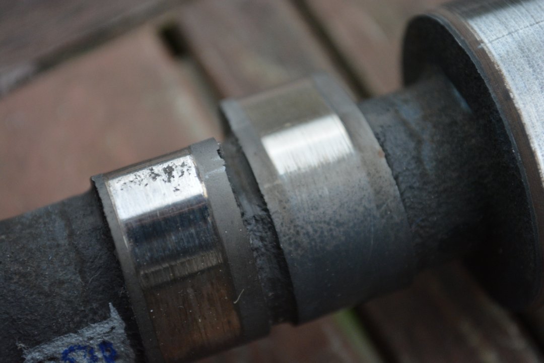

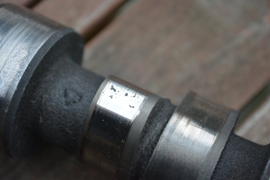

here's a couple of shots of the camshaft lobes:
Paul :-)
Posts: 6192
Tue Nov 20, 2018 2:59 pm
Hi Paul, they look well past it mate, do you have any pics of what they "work" against ?

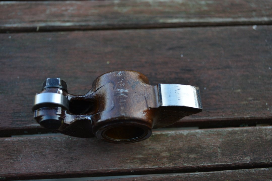

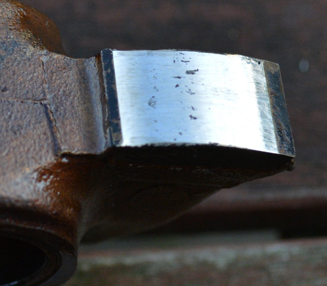

Wed Nov 21, 2018 12:27 pm
and here's a rocker which shows considerable pitting and the edges look very rough... meanwhile the eccentrics are perfect, they've covered about 5K miles.
Paul :-)
Brianmoooore
Posts: 49358
Wed Nov 21, 2018 1:32 pm
Reminds me of a 885 head I once rebuilt where the shafts had been hammered into place with so much force that the ends had 'belled' and would no longer pass through the D shaped cutouts in the head when I tried to remove them. I had to grind them down in situ.
