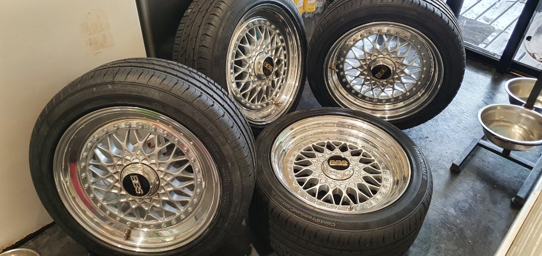

These are mine
The only RS wheel in 16" for the E30 is the RS003, ET25 and it possible to fit a 3£ dish on the rear, but you can't go low on the suspension.
These are mine
