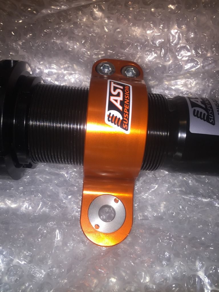

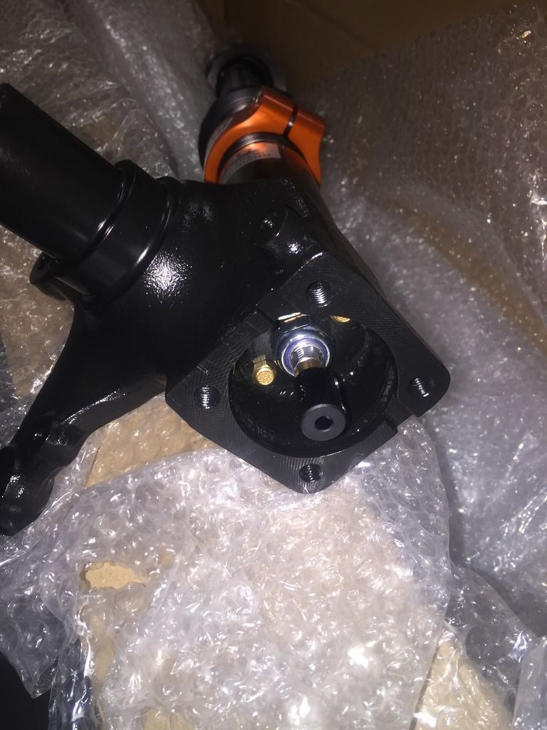

ajay
Posts: 1041
Post Mon May 30, 2016 8:06 pm
I bought the 5100 fronts & getting 5300 rears. I can't have a canister under the bonnet (bit too race car for me), but can hide them on the rears, i also have it on good authority that the 5100, will exceed my expectations.
