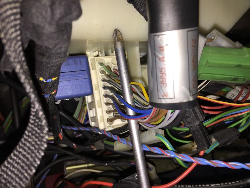

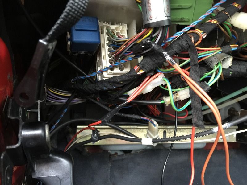

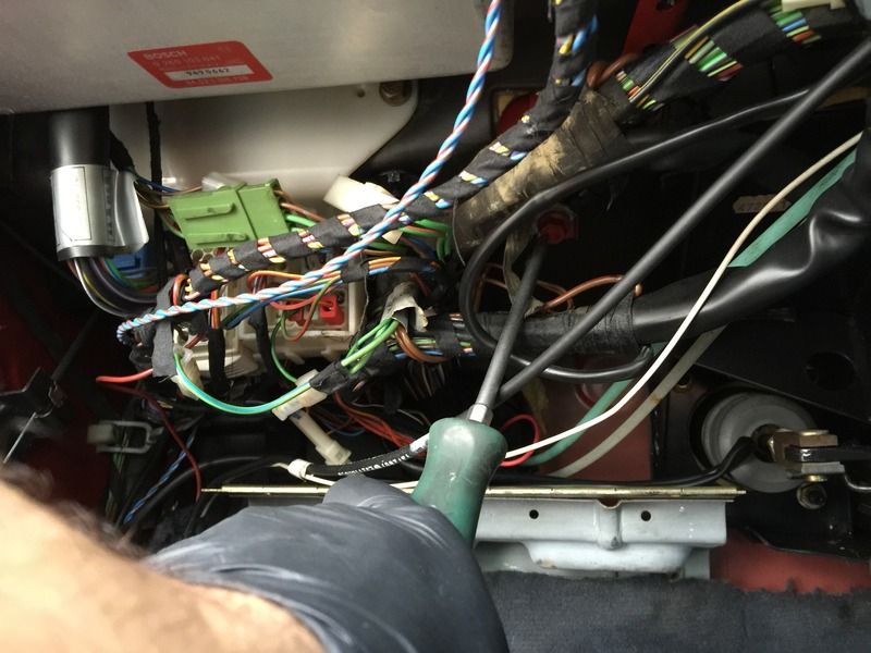

Connections for the rightclick keyless entry systems are:
Remove the orange and orange/black wires from the plug by pushing in the little tabs and pulling them out.
Connect the yellow, yellow/black, and black wires together and to a 6mm ring terminal. This goes to the earth stud at the back of the glovebox, where all the existing brown wires connect.
Red goes to 12 volts permanent live. This can be the red/yellow wire that connects to the accessories socket.
White (lock) and white/black (unlock) go to the lock and unlock request wires of the car, which are found behind the speaker panel, coming out from behind the speaker.
The two blue wires go to the blue/red and blue/black at the plug and socket beside the accessories socket.

Every wire you need to connect to is behind the glovebox area.

Just been reading some of the forum posts on keyless entry. I can see references to either two blue wires or two brown. I have the unit with on the one brown wire, so looks like no indicator option unless I use two power diodes.
jb1
Posts: 82
Joined: Sun Nov 28, 2010 11:00 pm
Sat Jan 23, 2016 5:39 pm
My mistake on the brown wire, there is a big heat shrink containing the diode splitting the wire into the two required.
Fitted the system earlier, very straight forward especially with the info provided in the above comments. Successfully installed behind the glove box and wired into the turn signals.

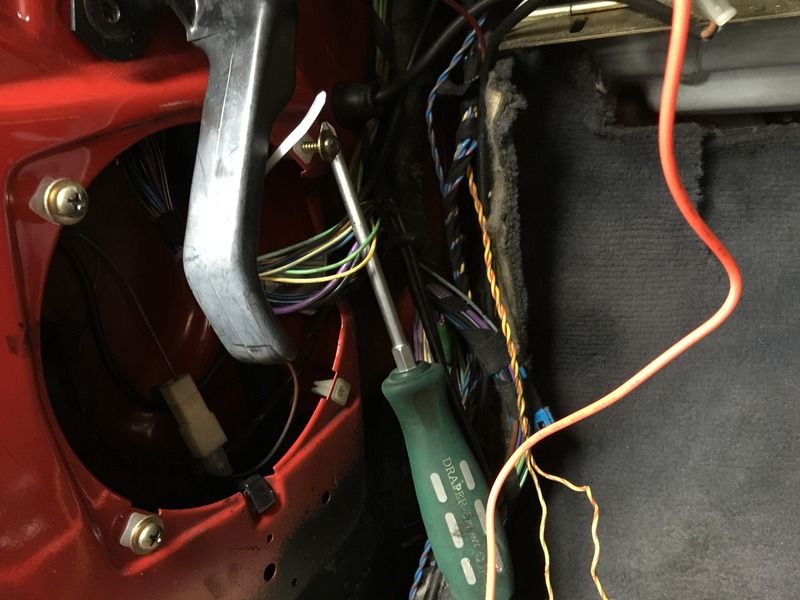

Some pics of the wires:
Earth point:
Central locking wires behind speaker:
Accessories socket to splice into indicator wires:
Spliced into the red/yellow live:
Kingswood636
Posts: 13
Joined: Wed Sep 10, 2014 11:00 pm
Fri Jan 29, 2016 8:29 pm
where have the pics gone?

Brianmoooore
Posts: 49358
Fri Jan 29, 2016 9:23 pm
A yellow/blue and a green/blue wire in the loom emerging from behind the passenger speaker.
Yellow/blue is lock request (I think).
You need to splice your wires to them.
