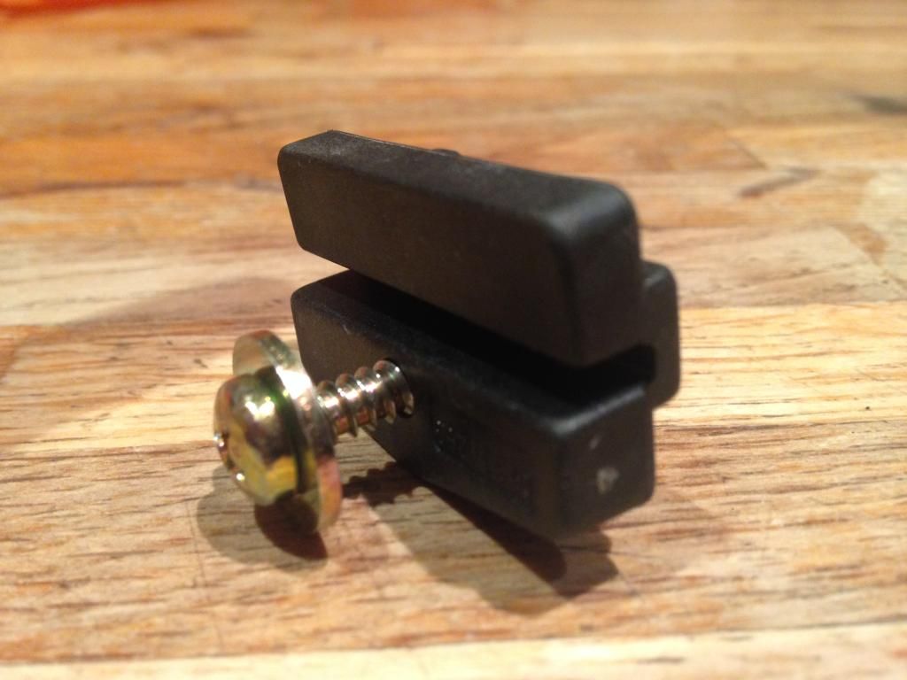

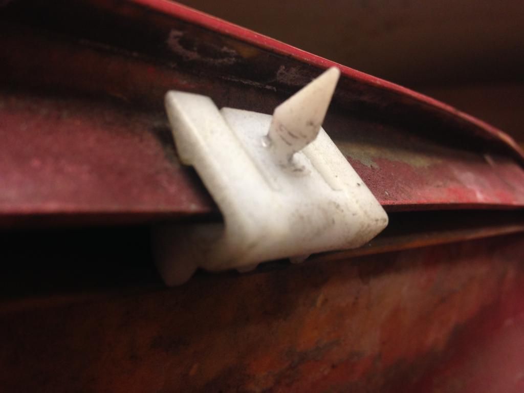

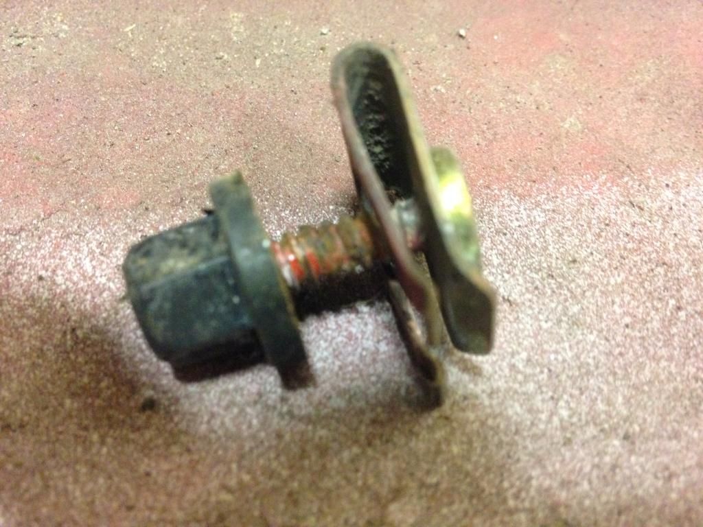

Got my skirts off so just checked. You need the following to fit 2 skirts.
14 of these
4 of these
10 of these
Jim.

14 x 51711936517
4 x 51711933719
4 x 16131176747
10 x 51711933125
10 x 07119907954

Convertible M3 skirts are different to 'coupe' skirts, as are MOST of the fasteners :(
The REALOEM diagram above shows all of the correct fasteners and quantities needed .
