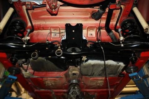

clean it may be.....
but its missing all the undertray cover parts, front and rear.

Post Thu Jan 08, 2015 6:15 pm
*spluff*
On a side note...
What does an M3 ARB droplink connect to then as it's going up...?

Post Thu Jan 08, 2015 6:23 pm
And is that rust by the subframe mounting bolt?
m3 arb mount is on the leg

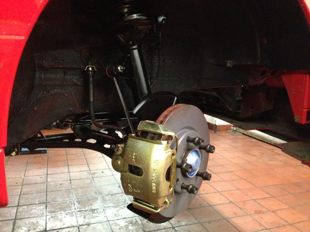

Post Thu Jan 08, 2015 6:43 pm
That looks similar to something I've just completed.

^^ Proper job

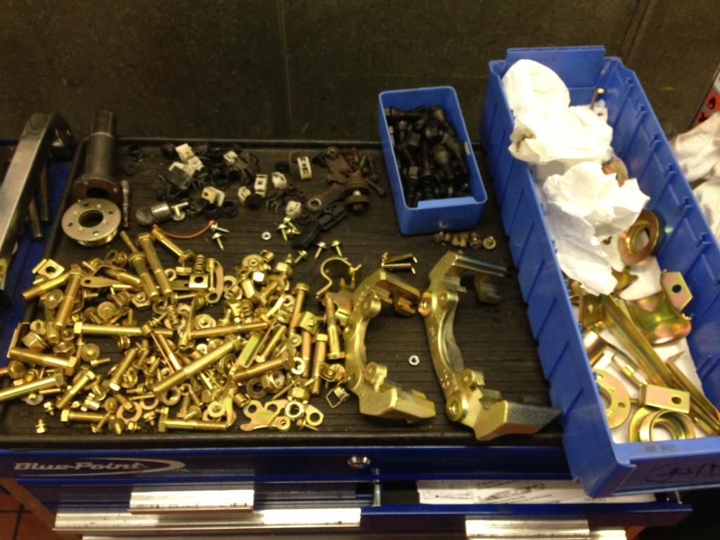

Post Fri Jan 09, 2015 12:11 am
Where did you get all them parts zinc coated?
Also its number 243 which must of been built next to my 245 in the factory possibly?

Post Fri Jan 09, 2015 12:16 am
I think Barry uses these guys
http://www.collinschemicalblacking.co.uk/
e30Passion
Posts: 232
Joined: Wed Jun 20, 2012 11:00 pm
Location: Netherlands
Post Fri Jan 09, 2015 2:27 am
That gold looks stunning! How did you do the calipers without coating the inside? With the pistons still in?
Posts: 24532
Post Fri Jan 09, 2015 8:17 am
That's the people I use Jim.
Most likely together Leigh.
And yes the Pistons left in while the main body is plated, Pistons remain unplated as they are not in contact with the main body, then once back from plating, new seals, dust boots, bushes and nipples.

Nice steel wishbones on that evo2 :)
bigbird76
Posts: 571
Joined: Sat Feb 16, 2008 11:00 pm
Location: Swansea Wales UK
Post Fri Jan 09, 2015 9:57 am
Theo wrote:Nice steel wishbones on that evo2 :)
All M3's were fitted with Steel wishbones up until 1989 if i remember correctly.
Posts: 24532
Post Fri Jan 09, 2015 11:05 am
Yep!
It still had the original steel ones on it when it turned up.
Theo
Posts: 10735
You're right - alloy wishbones from 09/88

milescook wrote:*spluff*
On a side note...
They could have stretched to new brake hoses on the resto :roll:
Those pictures have been on the net for a good 8 years +
