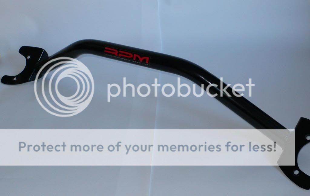

Mine looks like so, but has H&R branding instead of RPM branding, same shape/design though:

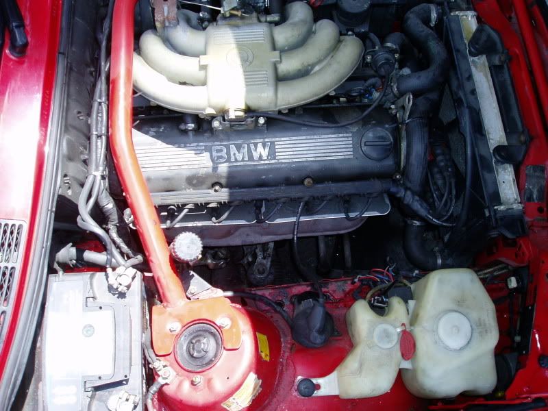

Avoid anything with a hinged mount like so:
Kind of defies the point. Otherwise, any one piece tubular steel strut brace should do the trick. RPM and Ultra Racing are reasonably priced.

Eibach one is hinged ! Have they got it wrong ?. I know the adjustable ones are a no no but why not hinged if done correctly...

If its hinged the struts can move one way or the other and the distance between them will stay the same.
/ / or \ \
As the hinge will just pivot, if its welded then it can't pivot so will stop this movment.

Hinged ones are okay as long as the hinge bolts can be done up good and tight. To be fair, modern shells are so stiff you don't really need one. I've never noticed a difference on a track day with or without one fitted. I have a one piece Ultra Racing one that does the job.

Ultra racing bars are shit! Oval holes and hobby mig welds?
Sparco M3 bar is what you need, the RPM bar pictured above is a copy of the Sparco M3, but I bet its not significantly cheaper than it
