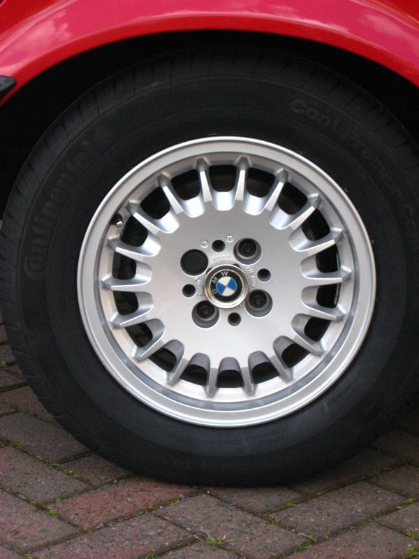

What is the grey colour that best matches the factory "Nagaro?" Finish?

Does anyone know where I can find a photo of some nogaro wheels? Thanks

How do you think my Cab would look in these, you may know it's totally OEM, would these ruin that aspect.

personally I think these are the nicest wheels for a e30. the grey gives the wheels more character. i might treat myself at some point too. but for now i may just spray the set i have myself.minesapint wrote:Yes can still buy new.matt86 wrote:Thanks.bss325i wrote:
