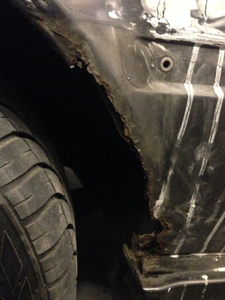

E30motersport
- Posts: 55
- Joined: Wed Jul 23, 2014 11:00 pm
- BHadley
- Posts: 902
- Joined: Sun Sep 06, 2009 11:00 pm
- Location: Newton abbot, Devon
- Contact:
Niiiiice pics!
Tech 2 pods hide a lot of grot
Other pic looks really bad too!
Sold my last e30 with gaping rust holes like that, (newborn baby no sleep and welding really wasn't going to mix)
It's taken the owner (or should that be hero) four years but its MOTed and taxed now!
Now back to the current turd ......
