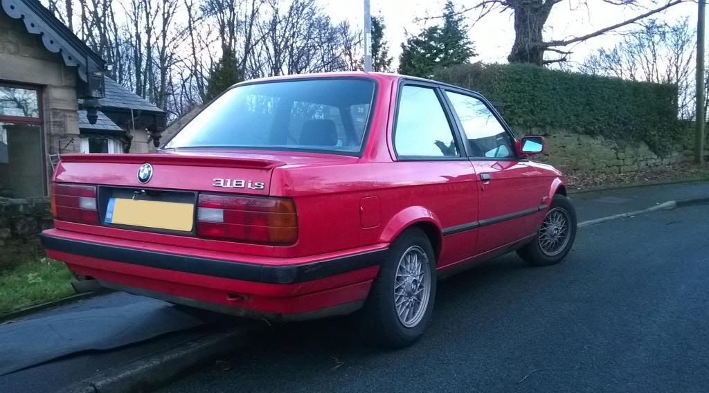

So, after a while out of the E30 scene i've finally returned to the fold with a 318is in need of a little love.
I got lucky on eBay and found a H-reg on 149k for very little money.
Now.. I have a bit of a dilema.
I'm going to restore it for use on weekends and trackdays, so i want it to be able to go as well as it looks... I'd love to own an M3 but that isn't going to happen any time soon - so i'd like to make my "poor mans M3" as close to the real thing as possible.
This won't be an M3 replica, more a well restored 318is with as close to the M3's power to weight ratio as possible without it becoming a stripped out trackcar.
I've read enough about the 318is to know that the secret to its comparison lies in its power/weight/handling balance.. Fudge this up and any relation it bares to the M3 is lost. So, what i'm proposing are modifications in this vein ideally while retaining the M42 engine:
A) Find a low mileage M42 (or rebuild my 149k engine) and Supercharge it with the GKD kit, adjust the cam timing, M20 flywheel then install a standalone ecu and have it mapped - This is the most honest route i can think to take while retaining the integrity of the 318is and the M42 engine.
Or (curve ball)
B) I have a E36 325 trackcar that i'm currently selling. Its in really good nick and only has 55k on the clock so the plan was to sell/break that to fund the restoration of the 318is. OR use the E36 and its M50 engine as a quick easy donor for the 318is...
Now, on the face of it this seams the easiest route to take as I already have most of the stuff for the conversion, however i am well aware that I have the iron block M50 and not the lighter weight alloy M52.. so it'll weigh a fair bit. Which compromises the power to weight and will inevitibly effect the handling dynamics of the car, which i really don't want to do as it strays away from what i'm setting out to achieve.
So my question(s) are thus:
- Whats the most reliable power anyone has seen from a supercharged M42 engine?
- Will fitting an M50 blunt the handling of my car as much as i'm imagining or can this be overcome with stiffer dampers and still make for an enjoyable car?
