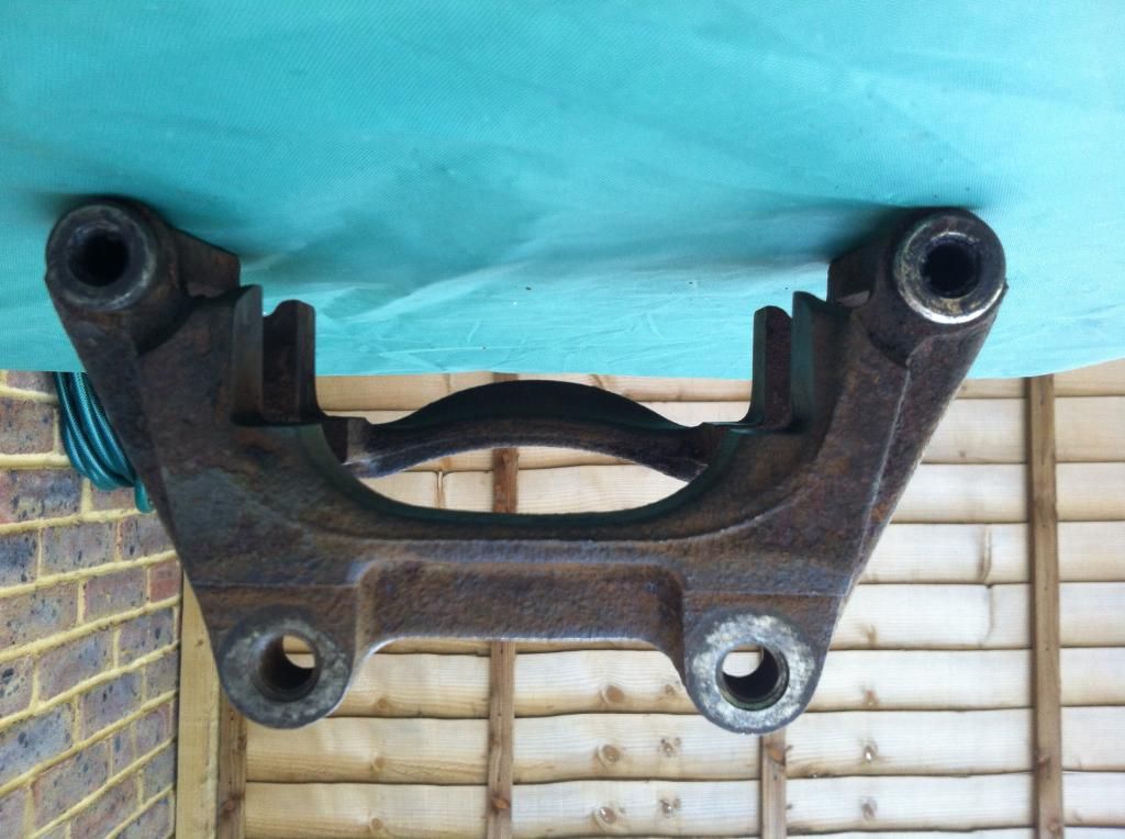

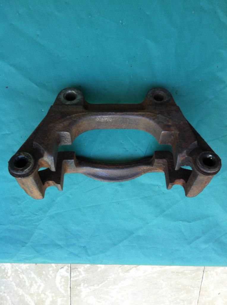

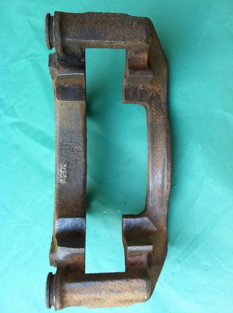

They are cast iron.

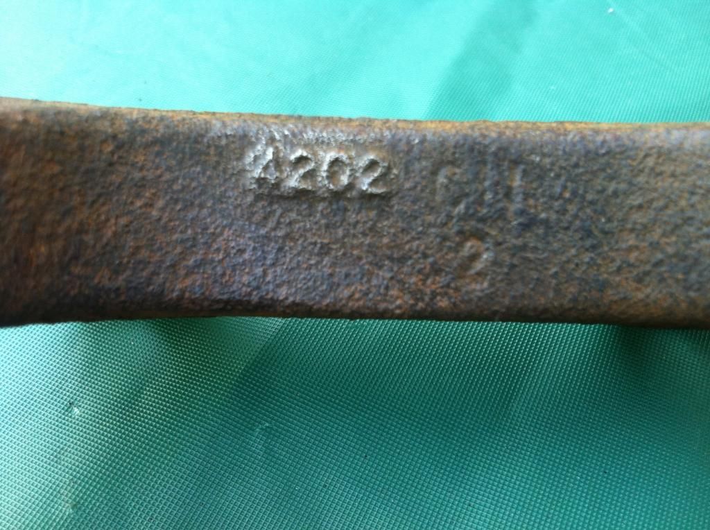

I'm convinced they are a standard Merc part as I borrowed one from pete and it had a partial Merc part number on it.
Merc parts like all BMW parts have group numbers so the first two digits are the main group (11 is engine for example) then the next two digits are the sub group.
The bracket had a Merc brake group number on it.
I took loads of pics of the bracket/ saddle and posted it on a few Merc forums but with no joy!
I also goggled the f uck out of the german translation for mercedes brake saddle with no joy.
I'll post the pics in a bit.

My 'alpina' calipers have two areas ground off them and I'm sure that's where the Merc badges go, so I'd agree they are Merc. I can confirm that they are not Merc 190 cosworth carriers, as I have a brand new one here and it doesn't fit !bss325i wrote:They are cast iron.

They're a girling caliper with the same setup as the 325's have but much bigger. I've always thought the caliper carrier was a special casting to get the merc caliper to fit the e30 strut. So imo there is no maching up a bracket to mount them. If they were ATE it would be a different story
The calipers are generic merc stuff. I've bought some recon ones for Steves car and mine and the exhange ones come with the merc logo on them! You can't see it when bolted on the car!
I'd post some pictures but my internet is having a slow night. I'm sure i've said all this before somewhere!

4202 is the same
got to be worth getting one to find out hey ?
