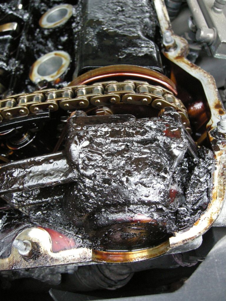

This is what happens if you don't change your oil. This had 147k on it.
