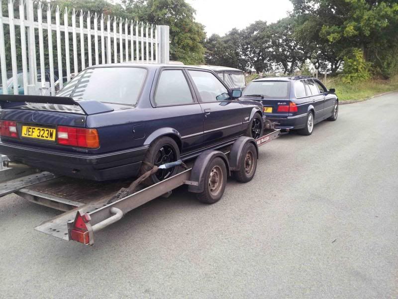

My dad and I use an e39 540 touring auto. We do a lot of type 2 camper vans and most need all four off the ground. Armed with tools and the like makes for an effortless drive home every time.

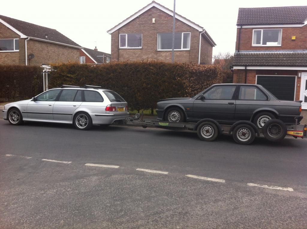

Another vote for an E39 towing barge. I've towed assorted trailers at assorted weights a few 1000s of miles with my 528 touring over the last couple of years and find it perfect for the job.
I actually return a better MPG when towing than in normal day to day driving.

My E39 weighs in at about 1800 Kg on the road, with tool kits, etc. on board.
An E30 in race trim is going to be in the 1000 - 1100 Kg range, so you've at least 600 Kg for a trailer before reaching 3500 Kg.

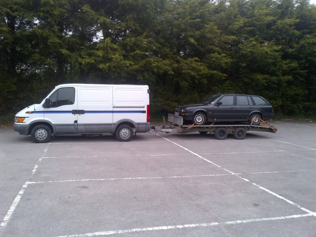

I know you guy's use cars to tow with but speaking from experience you need a setup which allows safe towing, you don't want the trailer wagging the car!!
I use either the van shown below or my Discovery, the trailer I use is heavy at 800kgs and then the weight of the car.

E39 towing limit is 2000 Kg, with max. 90 Kg tow bar load. It's 100 % stable at that weight at speeds well in excess of what's allowed in this country and in Europe.
