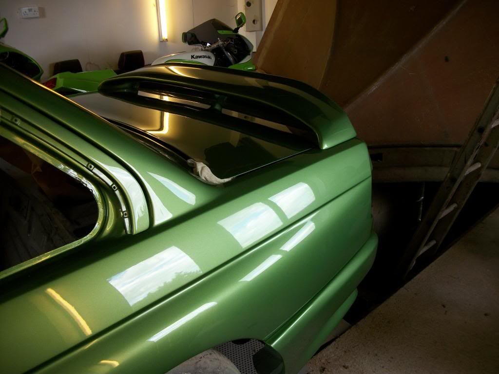

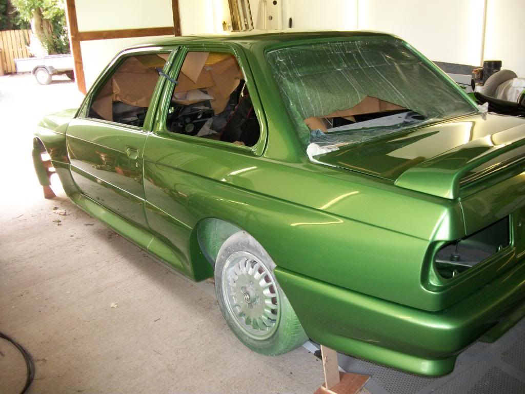

heres my m3 replica built from the same wide arch kit from pistonheads
I think the green one above will be ok because its bit trying to be an m3 copy. The problem with using parts that are supposed to look like m3 parts means you have to get it right in every detail or it'll look like a bodge job.
Going for wider arches which don't copy the m3s gives ou freedom with the rest to make it how you want it without being forced down the exact replica route.
