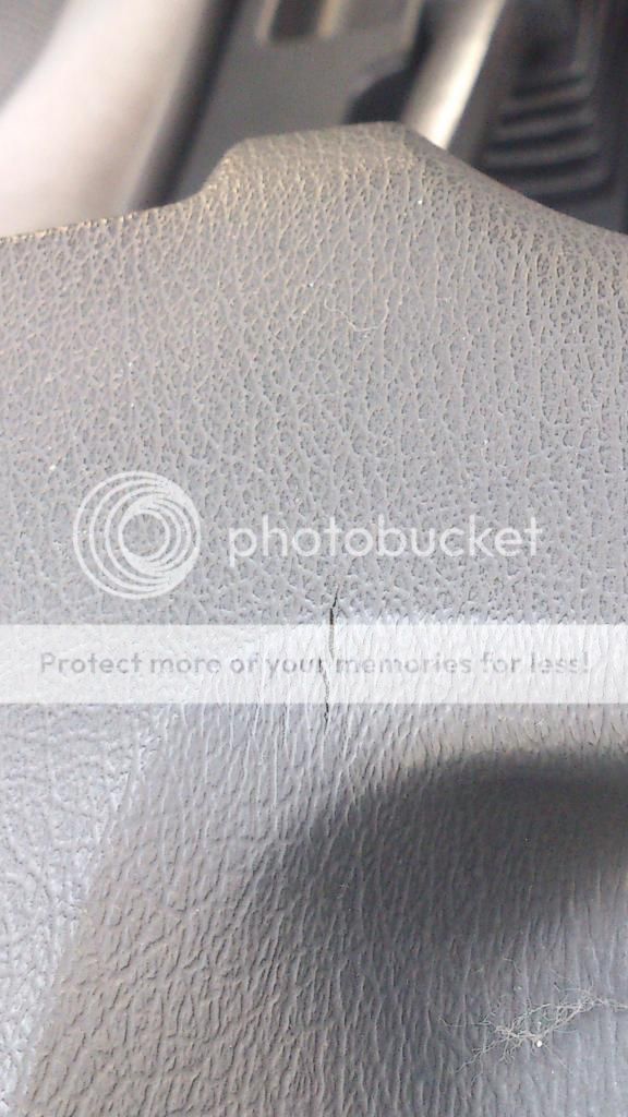

My interior is very clean on my touring, but i noticed this little crack which i missed when i viewed the car.
Was wondering can i use something to make sure it doesn't get worse & something that wont be noticeable??

Very,very difficult to obtain a seamless repair.
I have had some success,however,using Evostick applied with a matchstick,then painting to match.

Before I would fill it (though I've never tried the method above) i would drill a 2mm hole at either end of the crack which will spread the stress and load placed upon the crack which would normally make it larger.

Good idea to drill small hole at each end as march109 has said.
That is a thin crack but if you have wider cracks try the following:
In SA we get a Pratley product called "Wonda Fix" which is a flexable epoxy mix that comes in clear or black...if you can find it obviously get the black.
Now the trick is to try and get the "wrinkeled grain" pattern on the surface to match the rest of the dash as apposed to a smooth finish.
First trim the edges of the crack with a blade if they are protruding above the dash surface. Now take some flexible material such as Plastercine or "Presstick" which is a white gum-type substance that you use to stick notices onto a wall.
On a nearby section of the dash that is still in good shape..smear a thin layer of Vaseline on it (or Q40) and press a section of this Presstick over it so that the Presstick picks up the pattern from the dash.
Mix the black epoxy together and level it nicely with the dash....now spray a fine amount of Q40 on the patterned section of your Presstick piece and press it over the crack with the wet epoxy in it making sure you maintain the direction of the "grain" that the Presstick has.
An Hour later pull off the Presstick and hopefully you have reasonable patched area with a grain on it to match the rest of the dash!

Good :idea: to drill a tiny hole at each end of the crack,as the OP's was so tiny I did not feel that it was justified!
My main problem was finding/mixing paint to give a decent match...
At the end of the day,sourcing and fitting an unmarked dash is the best answer.
