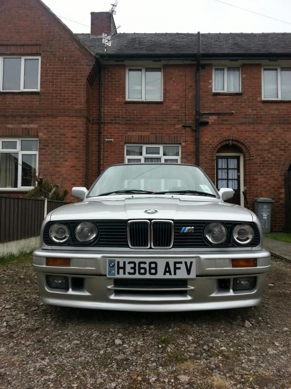

Hi Guys,
I fitted my car with the H&R Cup kit, 60/40 drop, and also fitted new E92 top hats, so expecting a 70mm drop, but it still doesn't seem that low at the front. The car hasn't moved yet, so may settle a touch, but can't see it being that much. I've even stood on the strut towers and bounced and made sod all difference and there wasn't much travel.
Now I also fitted H&R adjustable anti roll bars, which are on the stiffest setting, would these being so stiff have potentially stopped it dropping any more? Might sound silly but I'm just scratching my head with this one.

Is there definatly an engine in that?!
It will definatly lower more than that when its been driven a couple of miles....but cant see it being 70mm

Looks like a 40mm drop at the moment !

definitely not a 70mm drop bud, as you know, cant see how anti roll bars would stop a car going lower as thy are to control body roll.
how far is the sump off the ground? mine has 70mm drop and i struggle to get a pack of 20 under the sump.

I haven't actually checked the sump yet, I'll do that tonight. It's definitely a 60mm kit as I checked the numbers on the springs and they matched up, just baffling me. The only other thing that might affect the look at the moment is it's on it's arse at the back with the boot full of stuff. Just can't see even with emptying the boot and driving it to settle that it's going to drop that much.

With a driveway like that I think I'd want to raise it not lower it!
It will settle a lot when you drive it.
