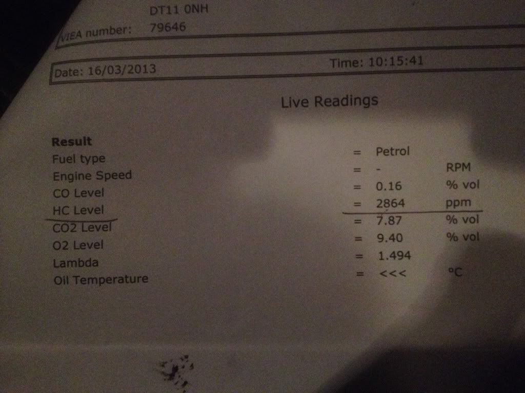

The cap covering the airflow adjust screw isn't there which is worrying. But I'm sure my old engine ran fine with the same one. Here are the emissions readings, they don't mean much to me without the pass limit of each.

That's not the results from an engine running rich, that's the sort of figures from one that's running lean. CO is far lower than it should be, and O2 is far higher than normal, showing that oxygen is passing right through the engine without being used up.

Ahh no it doesn't have a lambda sensor your right. Ok so I should be looking for vacuum leaks etc after the airflow meter?
