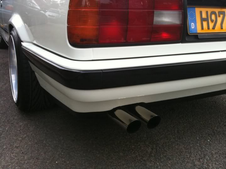

Anyone got any photographs of what Alpina exhaust on 325i looks like as they seem to be quite respected on here ? How much are they ? Does it reverb in narrow streets or tunnels ?
I know the stock BMW I think the exhaust exit the rear at an angle
